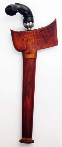

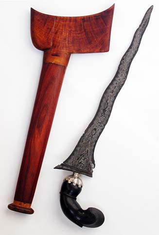

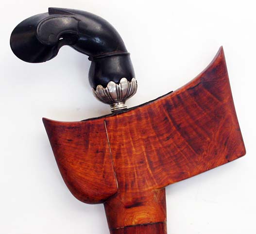

Dear All,
I obtained this (Bugis) keris this weekend. The blade and sheath, and separately the hilt, the hilt cup. I got too separately, six handles with motives. Is this Bugis with luks? I would like to have your comments, please...

Ganjawulung,
I hestitate a bit about this keris.
It is a lovely keris, that's for sure.
The sheath looks very Bugis to me, The ukiran is Sumatran but i doubt it is Bugis.
The keris itself isn't a Bugis blade but has a Javanese apearance.
Two possibilities. Javanese blades were highly apreciated and brought by sailors from Java to Sumatra. It is also known that keris blades on Sumatra were forged to Javanese origin.
That's why I hestitate to say this keris is Bugis. For the moment I would say Sumatra.

Hi,
Sheath is Sulawesi,
pendoko is Trengganu (N. Malay).
Hilt looks new, but there is a Sulawesi form like this as well. I think most forumnites must be thinking of the Riau Bugis form which is similar to this. But I think this form is more akin to Sulawesi. Jon posted a similar kind of hilt a while back.
Blade has been washed in hi-contrast manner akin to Javanese kerises, but I don't think it is Javanese. From the dapur, it could be Sumatran Bugis.

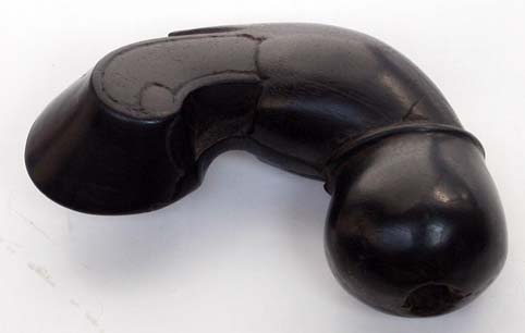

Ok, here's the hilt on the Sulawesi keris belonging to Dave Henkel, which was on Kampungnet:

Originally Posted by BluErf
...Sheath is Sulawesi,
Yes, BluErf,
I think this sheath is Sulawesi. Pretty sure, Bugis. Pendoko? This is something new for me. Thank you for informing, that this pendoko is Northern Malay. The hilts, I don't think this is a new one. I have cleaned it, with tooth-brush-shampoo and then with auto-polish . Really, this is not new one. I just think this is original. The blade? Sure, not Javanese blade -- from the forging of pamor, and the details of keris.
The pamor, in Javanese term we call it "pamor tritikan" and not "untu walang" (grasshopper-teeth). But not as fine as Javanese pamor.

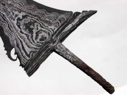

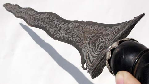

Ganja, would it be possible for you to do a close up of the sorsoran, and the pesi, I would especially like to see clearly the last , say, half inch of the pesi as it enters the gonjo.Thanks, Alan.
Yes Alan,
For the sake of the keris knowledge, this is the picture you wish to see...
Ganjawulung

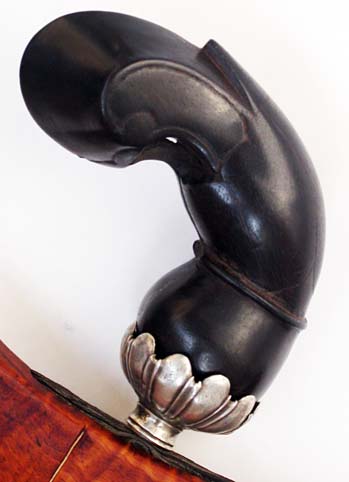

BluErf,

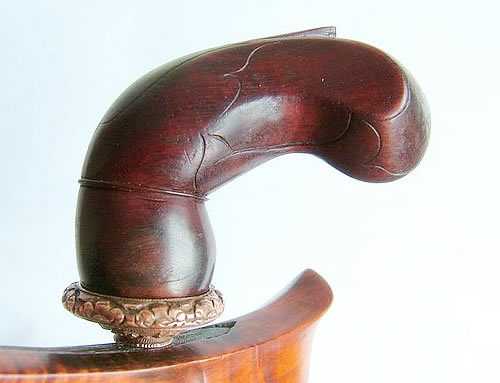

This is the sole picture of the hilt. And please regard too, to the other picture I took from Mr Hamzuri book, "Petunjuk Singkat tentang Keris" (Short Guide on Keris) published by the Department of Education and Culture (1973). Mr Hamzuri showed to the readers a Riau Lingga (Sumatera) keris which appearance looks like Sulawesi keris...
Ganjawulung

Hello Pak Ganja,
Very mean looking keris. I would think 10 times before engaging a combat duel with a person wielding it .
I think the hilt is of Bugis Sumbawa origin. The rest, except for the ferrule are either Bugis or Bugis influence.

Posts: 7,257
Thanks Ganja, you've put my mind at rest.
Don't think I've ever seen that type of blade with that pamor.
Thanks again.

Originally Posted by ganjawulung
BluErf,
Ganjawulung
Ganja, I've seen the picture from the book and had seen the hlit up-close, when it was loaned to Malay Heritage Centre (in Singapore), some time ago. Also featured on the front cover of the book, Court Arts of Indonesia.
The form is similar but not the same...
BluErf,
Ganjawulung
Hi Ganjawulung,
This keris you referred to is a famous keris, and it is an archetypal Riau Bugis keris. I would say it is the benchmark for all Riau Bugis kerises. Shahrial has a couple of Riau Bugis kerises with similar hilts. Perhaps Shahrial could post pics of his 2 keris hilts for comparison.
The reason why I think your keris hilt is Sulawesi rather than Riau was because of the pierced-through 'appendage' on the underside of the head and the more acute angle of bending of the head. The "appendage" is also present in the 2 examples I referred to above, but is not so obvious in Riau examples. The more acute angle of bending is a common feature in Sulawesi pistol-grip hilts.
However, I may be wrong. So if anyone has any information, references, please raise them. Thank you.

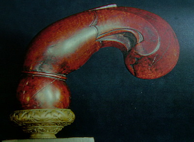

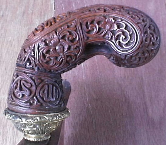

According to Suhartono Rahardjo in his book 'Ragam Hulu Keris Sejak Zaman Kerajaan' published by Lembaga Kreasi Penerbitan Masyarakat (LKPM) Jan 2003, the kemuning hulu (kerdas) shown by Ganjawulung is from Sumbawa island, derived from Bugis pistol grip hulu. The author himself is an avid collector of keris hilt.
For general knowledge, Suhartono Rahardjo's hilt book is good, but it does have its fair share of less accurate information for hilts outside Java. It should be taken with a pinch of salt. Perhaps, it might be due to hilt understanding from a Javanese standpoint.

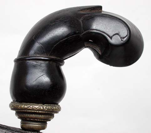

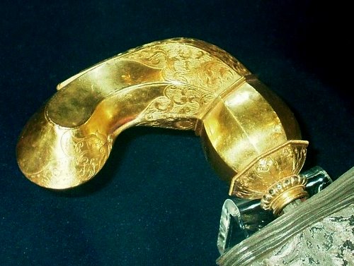

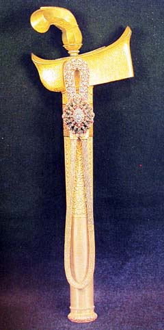

... This keris you referred to is a famous keris, and it is an archetypal Riau Bugis keris. I would say it is the benchmark for all Riau Bugis kerises. Shahrial has a couple of Riau Bugis kerises with similar hilts. Perhaps Shahrial could post pics of his 2 keris hilts for comparison.
An example of a hilt mounted on a Bugis Riau keris.
http://alamshah.fotopic.net/p31970087.html
Another example mounted on a Southern Peninsular keris.
http://alamshah.fotopic.net/p31948135.html
Compare...
Note: Throughout the Malay archipelago, there are many cases of mix and match with parts from other region.

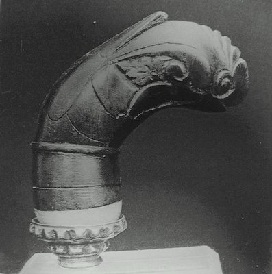

Default Sumbawa hilt example...
Example of one of Sumbawa's hilt form...
(Ref: Tammens - De Kris 3, Pg: 193, Fig: 194.)

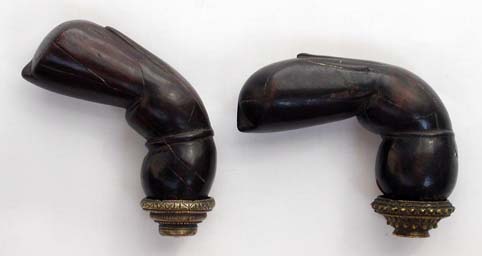

ganjawulung
ganjawulung's Avatar
Join Date: May 2007
Location: J a k a r t a
Posts: 991
And different with these other Sulawesi hilts...

Dear Pak Ganja,
Your hilt looks like from Sulawesi Buton if Mr Suhartono is right. I think when discussing Sulawesi (keris, sarung or hilt for that matter), we ought to remember not to confuse Buginese with Makasarese, though generally speaking they are from the same stock. I guess we shouldnt confuse Javanese with Sundanese either.
Thanks a lot, Penangsang,
And the two hilts, are they Buginese? Or Buton?

Pak Ganja,
About the other 2 hilts, they are not clearly stated by Mr Suhartono, but my take is.
the 1st one is makasarese because of the conic pistol grip type & the other one could be South Sulawesi Bugis. But I could be wrong too.
