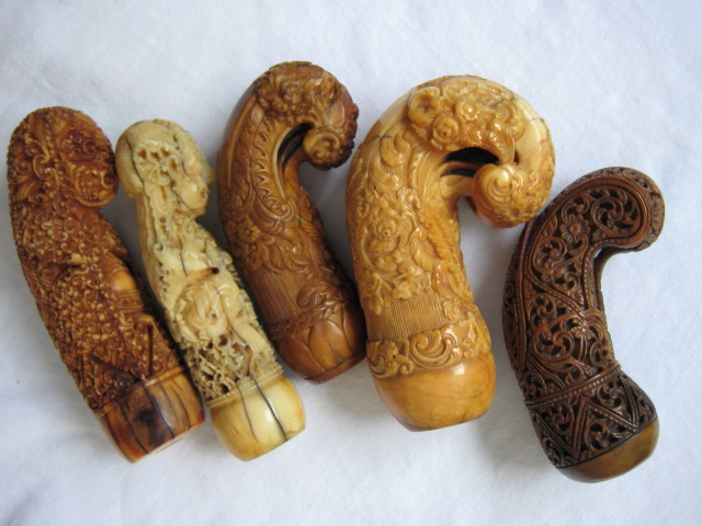

Hi All,
My first time posting and hope I get it right.
Appreciate if you guys can help give an estimate of the ages of these hilts.

Oh, Jonathan very nice hits!!.
My prefer is the first on the right.

Hi Jonathan, welcome to the forum. Whe're you from?
Nice hilts. Like Marco, I especially like the extreme right.
Deep, clean carvings. This is wood, yes? The rest looks like ivory.
Unfortunately, it's difficult to estimate from a single picture. Detail pictures from many angles would be nice, but still no guarantee. It's tedious and too much guesswork...

While the Sulawesi hilt on the extreme right catches the eye with its crisp carving, the rashaksa (or putro satu) hilt that is 2nd from the left is also worthy of attention. I think that hilt is stunning in a sublime manner. I think it is probably the oldest of the lot.

Yes Jon, i would also like to welcome you to the forum and thank you for posting these hilts. Very nice indeed.
If Kai Wee has met you and says you're OK then it must be so.
These hilts are very beautiful indeed! I would also agree with Kai Wee. They are all nice, but if i had to choose just one it would be the raksasa.
Shahrial, ive got a pretty hi-res monitor at work and i think that the Sulawesi hilt on the right is probably ivory as well. It doesn't look like wood on my screen.

... Shahrial, ive got a pretty hi-res monitor at work and i think that the Sulawesi hilt on the right is probably ivory as well. It doesn't look like would on my screen.
Earlier, I was looking from office... on my LCD monitors. Now, looking from home, with my big CRT monitor, I agree with you David, it does look ivory especially the base and the texture.

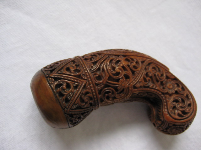

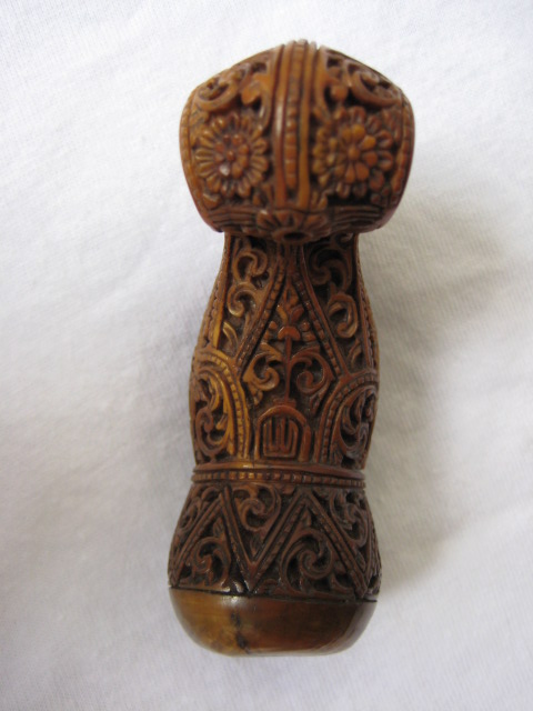

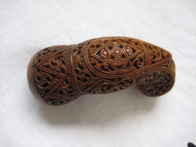

I've been looking at my keris hilts for quite some time now and would like to establish a close approximate of their age and the meaning/ significance of the forms and motifs carved on them. I'll begin with the Sulawesi hilt. I know it's marine ivory but not sure if its from a dugong or a whale's tooth. How do you tell them apart? Appreciate your input.

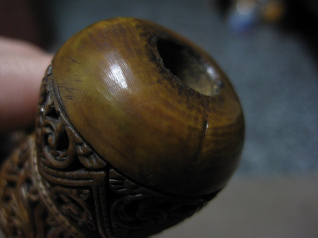

Posts: 6,441
Hi Jonathan, welcome.
Could you provide a shot of the base of the handle where the pesi enters?
I think that would be the only place that one could see any grain features.

Hi Rick,
Hope the pic helps. The grains/ lines are finer than those from a finger print.

Posts: 6,441
Originally Posted by jonng
Hi Rick,
Interesting stuff; it doesn't quite look like Elephant ivory to me.

This is a Sulawesi hilt. Marine ivory. An unusually upright variant of this form:
http://www.kampungnet.com.sg/modules...view_photo.php
Motif is very very similar to the piece referenced above too. I can only propose that the uprightness is due to limitation in raw material, or to acommodate a very long peksi. Some Sulawesi keris look like they have imported Javanese blades (high quality ones) to me, so could be that the hilt was made to accommodate the long Javanese Peksi. There could be other reasons.

Posts: 928
Maybe i don't see well but it seems from elephant (for angle's grain)

Posts: 7,303
I'm with Kai Wee on this...looks like marine ivory from Sulawesi (not necessarily the ivory, but the form ). The color and the ring patterns look correct for the marine stuff. As for whether it is dugong or whale, i am not sure if there is any way to be sure once it has been carved.
