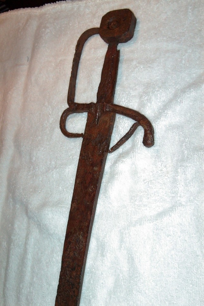

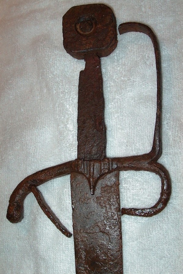

Dear Memebers,
What do you think about that sword? Any ideas of its origin, period and so on.... (things as usualy, i'm in a hurry right now

This is a breathtaking piece!! which appears to be an Italian form, prior to the fully developed guards and probably dates end of the 15th c. according to typological examples found. In "Rapier and Smallsword 1460-1820" (A.V.B.Norman, London, 1980) a similar hilt is shown as Italian c.1475-1525 (shown on p.82 as hilt form #18). Norman notes an example of this hilt is held in the Doges palace in Venice (catalog G690).
In "Armi Bianche Italiene" (Boccia & Coelho, 1975, pl.145-47) these hilts are shown as Venetian c.1475-80.
It should be noted that these assymetrical form hilts were the basis in general for the later basket hilts known as schiavona, and the pommel form also is key to those seen on the schiavona. The schiavona was of course the distinct sword used by the Dalmatian guards who acted as guards as the Doge's palace in Venice.

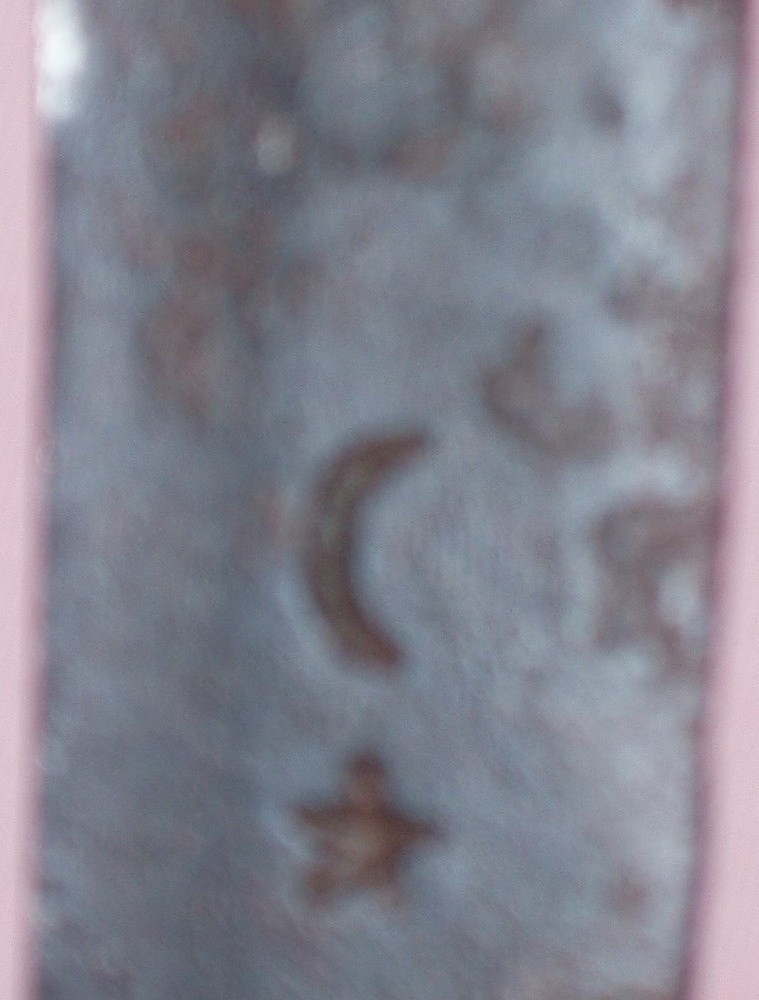

The interesting marks with star and crescent may be Italian markings. In Boccia & Coelho (op.cit) p.358 there are blade markings which include the crescent moon, although they appear with either one or two crosses of the cross and orb form. I have not yet found one with the star, but would not be surprised for this to be included in such markings. The markings described are both noted as from Venice c.1500-1510.
I know I have seen a similar sword to this, especially by the distinctly shaped escutcheon on the crossguard, but as yet have not found it.
Now....please tell us where you have found this sword!!!

Thanks Jim,
I also thought of a pre-schiavona type of venetian sword when saw the immages. Especially the pommel talks in that favour, beeing a predecessor of the typical Schiavona cat head pommel.
The sword is not in my possesion (yet). I'll do my best to get that medieval piece in my collection. Then I'll attach more photos.
It was found underground with a metal detector in the italian region of Northern Friuli (not so far away from Venice).

Crescent and star at the forte? What's that about, I wonder?
Old 10th December 2006, 08:11 PM   #8
Posts: 10,867
Hi Andrew,
I think thats where the initial heading for this thread came from, with the obvious association of the familiar Ottoman symbols. I think this marking is likely from the Italian maker, at least as noted in Boccia & Coelho (op.cit.) it is shown that the crescent did appear on Italian blades, in this case from Venice. Still looking for one that incorporates the star. The complexities of all these markings probably derive from workmans guilds, but later became associated with talismanic symbolism in varying degree.

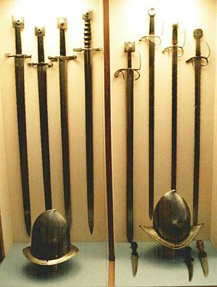

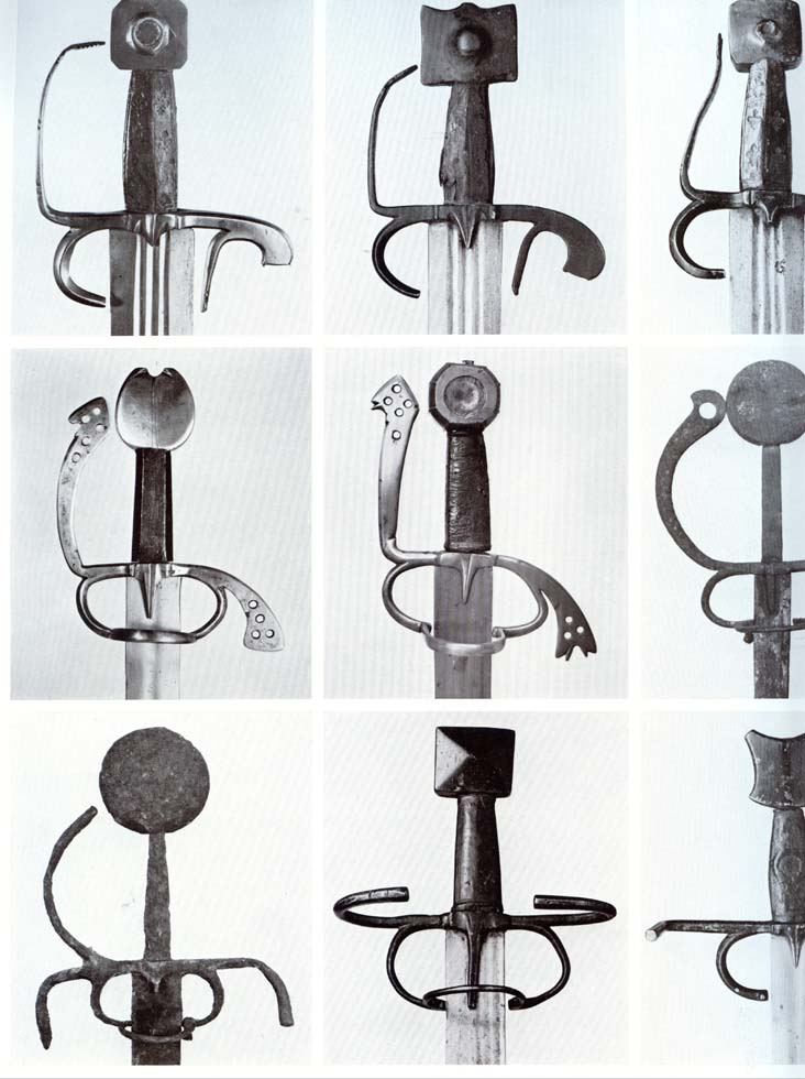

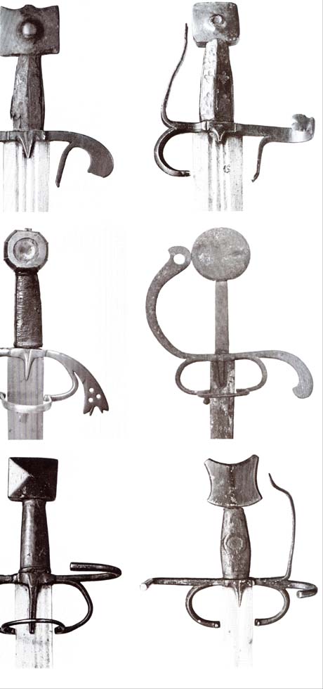

As Jim has sad, this is a Venetian sword, which is confirmed by your statement that it was excavated near Friuli. It is of Venetian make and dates from the late 15th c., ca. 1480-90.
You will identify your type of sword among a group of four displayed on the right in a photo from the Doges Palace at Venice; they are dealt with in Armi Bianche, 1975 (attachments).
