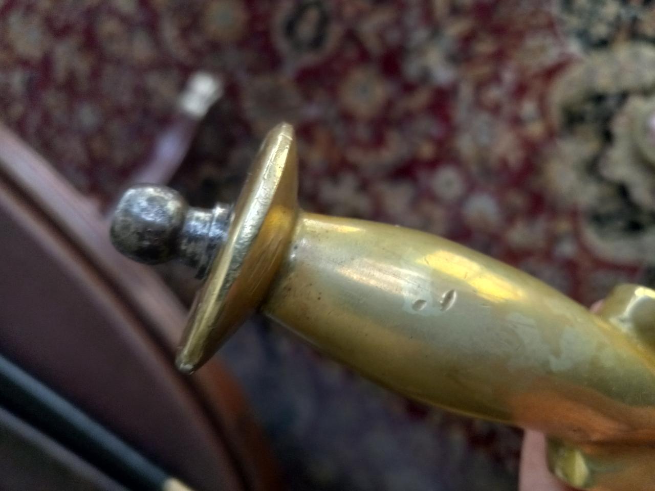

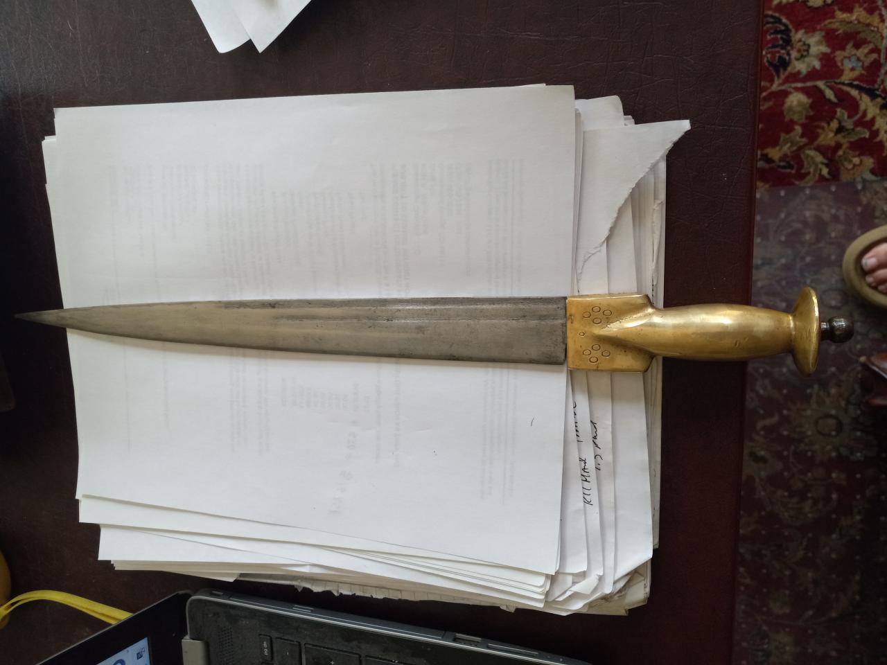

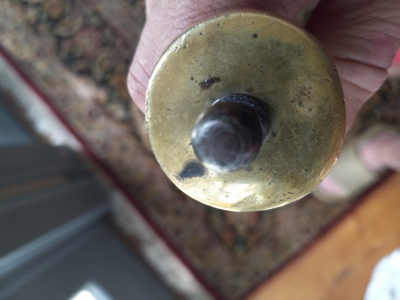

I recently purchased this all brass hilt dirk from an 80 year old individual who stated that it was part of her uncle's collection.
Having handled a number of 18th century/early 19th century brass pieces, this hilt seems to have the correct age/patina and lack of uniformity from modern brass. Has a nice weight as well.
Appears to be a sword blade with double fullers, perhaps a maker's mark
blade is slightly under 12.5 inches
hilt is 4.5 inches with pommel nut
17 inches overall
blade is 1.25 inches wide.
mgolab is offline   Reply With Quote

an additional picture
also overall weight is 1 pound, 3.9 oz

Wow, Mark! Very nice piece! It is in the exact form of a Scottish dirk and the brass does indeed look old. I'm no expert on these and will step back for the experts. The traditional form of these mostly had a carved wooden knotwork-type grip, but I imagine that this could easily be a more modern (ca. mid-late 19th c.) form. The fact that it is made with a cut-down old sword blade is again indicative of this type of Scottish sidearm. You do come across some amazing finds!

Naturally the Capn is spot on! This does appear to be a stylized version of the Scottish dirk, and quite old, I would imagine latter part of 18th c. as the capstan atop the pommel suggests. These all metal types seem to have been well known around end of 17th c. ("the Scottish Dirk", James D. Forman, 1991) and less commonly known are the pewter examples. The use of cut down sword blades, while popular, was not exclusively the case, however the well known quality steel of the German blades was preferred.
Officers of Highland companies of course typically bought silver mounted dirks while troops either bought their own serviceable 'brass mounted' dirks or these were supplied by the regimental colonels.
While in the post Jacobite period dirks and broadswords were gradually given up by ordinary soldiers from the time of the Revolution and after. However it is noted that the Black Watch (42nd Highlanders) kept their dirks until nearly 1830s.
In the pre Culloden days, the dirk was held in the left hand behind the target, and used as required in close quarter fighting with downward stab. The Highlanders learned the importance of the bayonet after Culloden, and with the musket the primary weapon, the bayonet became the immediate secondary.
It was often believed that during the proscription of Highland weapons, the enforcement was quite lax, especially toward the dirk. This was because the Highlander swore oaths and allegiance on the blade of his dirk, and that fiercely observed convention was sacred to him.

Wow Gentlemen, thank you very much for the analysis.
I had a good gut feeling about this one when holding it.
I guess this would be an enlisted man's dirk?
what is very interesting is that the dirk blade is sitting here next to the Thomas Gill blade from my other post and it is very similar, age wise and also spine and dimension wise.

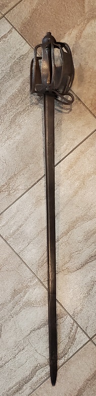

Pictured is a British dragoon basket hilt as made of Glasgow form typically by artisans near garrison towns and with one of these type blades. There is a form of fluer de lis stamped in the blade (English cutlers known to have used these, despite the French association) and blades with such marks were among those found at Culloden. Thus pre-1746.
The blade on this dirk resembles this type blade, and of course the cutting down of sword blades was common to mount in dirks. While loosely enforced, the proscription act forbade owning or bearing weapons unless for military service in British units. As previously noted, dirks were a very personal weapon to the Scot, and clearly, the men carried their own versions, as of this type, well known in late 17th into early 18th c. of brass.

I would expect that the abrasions on the blade derive from its original reduction and reprofiling from hanger blade to achieve the 'wedge' shape popular on Scottish dirks. I am unsure on the hilt, but I would presume it to be solid as this is a fighting weapon, and the capstan was placed to secure the tang.
Just as most sword hilts, they seem solid, rather than overlain brass sheet.
