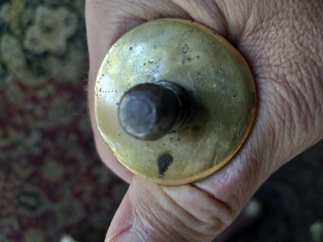

I recently purchased this all brass hilt dirk from an 80 year old individual who stated that it was part of her uncle's collection.
Having handled a number of 18th century/early 19th century brass pieces, this hilt seems to have the correct age/patina and lack of uniformity from modern brass. Has a nice weight as well.
Appears to be a sword blade with double fullers, perhaps a maker's mark
blade is slightly under 12.5 inches
hilt is 4.5 inches with pommel nut
17 inches overall
blade is 1.25 inches wide.

Wow, Mark! Very nice piece! It is in the exact form of a Scottish dirk and the brass does indeed look old. I'm no expert on these and will step back for the experts. The traditional form of these mostly had a carved wooden knotwork-type grip, but I imagine that this could easily be a more modern (ca. mid-late 19th c.) form. The fact that it is made with a cut-down old sword blade is again indicative of this type of Scottish sidearm. You do come across some amazing finds!

Really nice dagger
But can’t it be an african dagger made with an old european blade ?

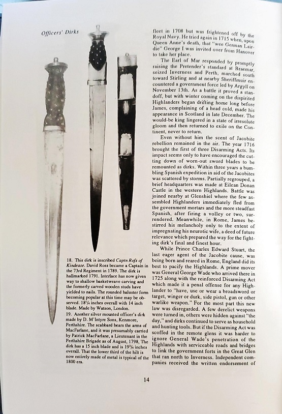

Naturally the Capn is spot on! This does appear to be a stylized version of the Scottish dirk, and quite old, I would imagine latter part of 18th c. as the capstan atop the pommel suggests. These all metal types seem to have been well known around end of 17th c. ("the Scottish Dirk", James D. Forman, 1991) and less commonly known are the pewter examples. The use of cut down sword blades, while popular, was not exclusively the case, however the well known quality steel of the German blades was preferred.
Officers of Highland companies of course typically bought silver mounted dirks while troops either bought their own serviceable 'brass mounted' dirks or these were supplied by the regimental colonels.
While in the post Jacobite period dirks and broadswords were gradually given up by ordinary soldiers from the time of the Revolution and after. However it is noted that the Black Watch (42nd Highlanders) kept their dirks until nearly 1830s.
In the pre Culloden days, the dirk was held in the left hand behind the target, and used as required in close quarter fighting with downward stab. The Highlanders learned the importance of the bayonet after Culloden, and with the musket the primary weapon, the bayonet became the immediate secondary.
It was often believed that during the proscription of Highland weapons, the enforcement was quite lax, especially toward the dirk. This was because the Highlander swore oaths and allegiance on the blade of his dirk, and that fiercely observed convention was sacred to him.

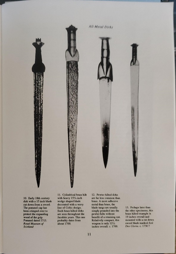

Apparently this tradition was around since 1700, look at the brass one on the page I posted from Forman (and in Forman, you KNOW its right!).
What makes the example posted here later is the capstan.....I feel like this could well be Black Watch enlisted or sergeants end of 18th c. (IMO).

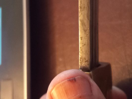

I also noticed these marks on the spine of the blade
either a "T" or "P" with a "V" and perhaps a small "M" above

Not sure if this is some kind of mark on the other side of the blade as well. Odd mark, looks purposefully made.
