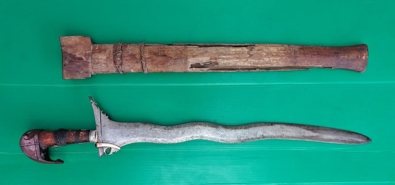

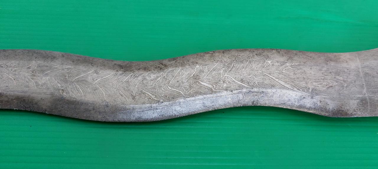

I got this from a Cebu-based (in Visayas area, Philippines) family with Moro lineage. 20.3in blade length, hilt pommel didn't seem broken (seemed like it was made that way, no junggayan crest). Rectangular tang tapering to a sharp point was just short (2.7in). The blade is on the medium side (not as light as other archaics I've held), it's rigid and non-flexible. There's a curious part to the blade where the damascus pattern starts way above the base of the blade, after a line (I've polished and etched the whole blade at least 3x, the 'blank' part really yields no pattern).
I haven't touched up the scabbard, it's as-found.
Comments on age estimate and ID are welcome. TIA!

Interesting find. The line looks like a "weld line", forming a carbide line. Really interesting construction. As much as the pommel.
As for age, i would guess it's archaic, it possess all the features.
Congrats !

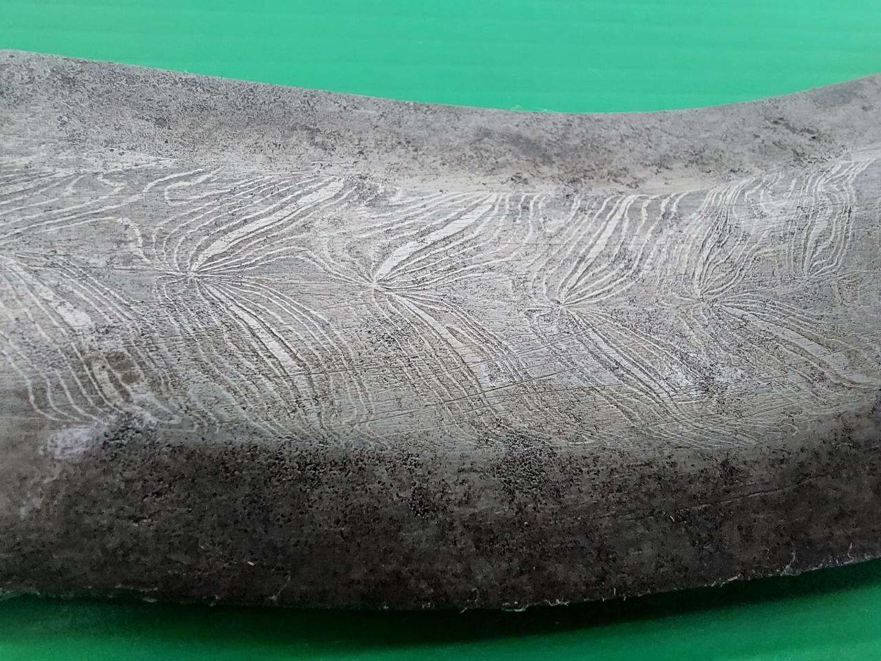

Yes I agree about being an archaic blade. The hilt appears later. As a whole it seems Sulu region in origin.

If it is lightweight, most likely is old, maybe 19th century? As new blade usually are heavier than the old.

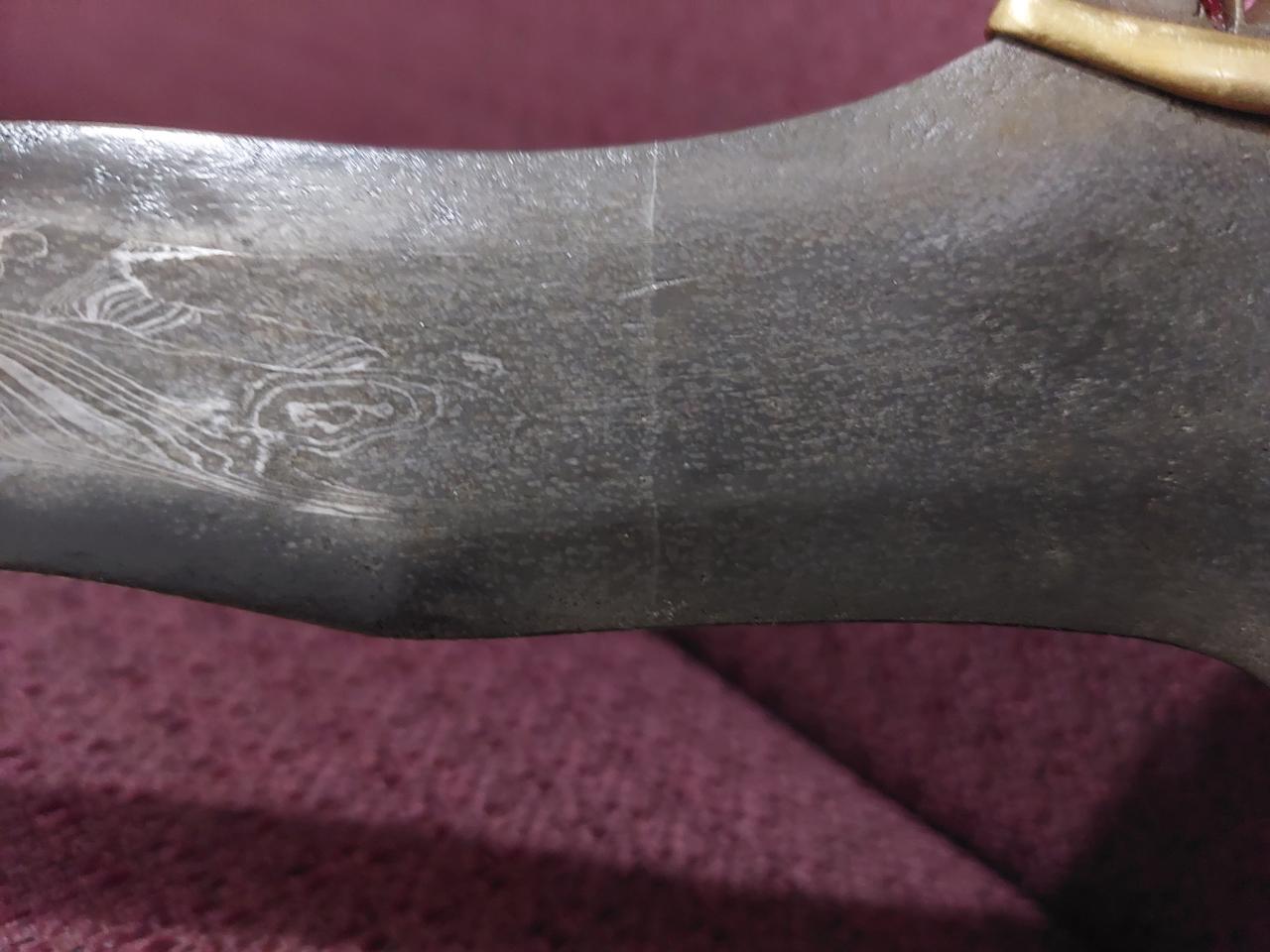

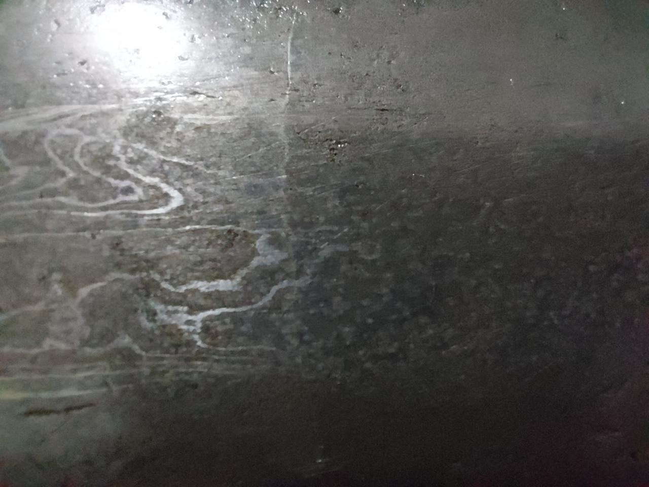

xasterix,
could it be possible to get a close up picture of the "line", on both side ?
Thanks !

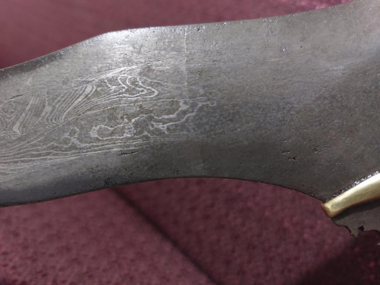

Originally Posted by JBG163 View Post
xasterix,
Thanks !
Sure, here you go

XasteriX,
Actually, that line is quite a mystery to me. You can see the pattern going through the line.
So, if the keris was broken, then welded back together, it would be almost impossible to have the pattern exactly corresponding.
==> So, it's not a weld line...
Other possibility... It's the quench line.... But i doubt it is.
I honestly grind my mind
JBG163 is offline   Reply With Quote
XasteriX,
Agreed a forge weld of a broken blade would show a scarp joint. Here are two random theories: 1. Stress fracture that opened and was welded (closed) during the forging process? 2. Silver solder of a break?
Bonus idea could the billet have been saw cut and had a sheet of the lighter metal inserted then forge welded together? Either partially cut and then heated or fully cut and upset?
Old 14th September 2022, 08:38 PM   #12
JBG163
Join Date: Sep 2019
Location: France
Posts: 209
The line is quite subtle is some area, i don't think there would be an inserted sheet of nickel or something.
The stress fracture could be possible but you can see the line cross the entire section of the blade. So i doubt it.
I also don't imagine a silver soldering, the result would not be like this.
If you check on the side of the twist, you can also see a line, resulting from a forge welding. Color and consistency are the same. That why i was thinking about a weld.
I will try to think about it tomorrow, with fresh idea

I appreciate the brainstorming guys! This is the only blade I have with such a mysterious line.

I'd bet on it being a quenching line: It's (unusually) sharp towards the thinner edges while it get's a bit blurry in the thicker middle section. This behaviour would be expected due to different cooling rates. With a high polish and an etchant allowing fine resolution, the crystal structures forming this line might become visible.
BTW, the steel of the pattern welding seems to behave very close to the steel utilized for the edges (central layer). Possibly a steel that responds very well to quenching. (Or the bladesmith perfectly hit the sweet spot for quenching this blade!)

Kai- thanks very much for your thorough metallurgical assessment and your gut-feel on age estimate!
Interestingly, you're the second person to posit that it may be a "revival" blade; a good friend of mine who's a museum curator had the same view. Compared to other archaic krises I've encountered- this kris has a pretty solid and non-flexible blade. It also has heft, unlike archaic krises which are usually light (sometimes ridiculously so).
I agree with your quench-line theory- that would explain why a bit of pattern in one of the sides still managed to spill over the line.

The best way to know would be to have it polished and etched. The difference of color would be blatant. I supposed earlier that it could be quench but, more test would be necessary to be perfectly sure.
Still, keeping it in his current state is also a good thing. Especially for datation. It's all a balance and up to you asterix.

If you plan to etch, a good préparation would probably be requiered as the bottom of the blade looks quite pitted.
Kai, do you have encountered any exemple with a quench line like this ?
Not that I can remember, not that crisp and all over the blade, i believe.
And regarding the dating: As said, it's more of a hunch and needs serious research.

I'm not a big fan of ferric chloride - etching with it tends to be quite brutal to the surface and it's acting so fast that fine structures tend to be missed.
If you intend to polish the blade anyway, a quick & dirty exploratory etch with FeCL3 could help to show some details before you start the actual polishing.
You need a good polish to reveal finer structures. And a gentle/slow metallurgical etch to bring out the details without dulling the surface. Arsenic trioxide used in a traditional rub-on fashion works as do a number of more available modern etchants. I'd probably lean towards warm sodium persulfate; I can't claim to have tested most etchants though - doing this side by side on a representative test piece is still on my ever-growing to do list.

From the pamor extending across the line, it seems safe to assume that we don't see any differences on a macroscopical level here. Thus, I don't think x-ray will be of any help here.

But an etchant would bring out the quench. And you would see a difference between the quenched zone and the "unquenched" one
Yes, any difference in final composition (steel alloy, heat treatments, etc.) will show up by etching/staining.

Originally Posted by xasterix View Post
I forgot that it was you that originally posited the quench-line theory- thanks for that again, and also for your kind words!
I'll be doing an FeCl etch in the near future- I'll update this thread by then with clear and close-up pics
Hello Xasterix, I was wondering wether you ever followed up with a FeCl treatment.
I am thinking of asking a blacksmith to do this with my Moro Maguindanao Kris and wanted to see what the effects are. I don't have the facilities to do this myself. How, if you did, did you you go about protecting the hilt from the FeCl?
I look forward to see your answer hoping that you get an alert from the forum after my quoting your post from last year

Hello Milandro,
As mentioned above (post #21), I'm not favouring etching with ferric chloride. The stain will often exhibit pretty warm colors (i.e. rusty), sometimes after some time only.
Even if one has experience in its use on modern pattern-welded blades, there is a chance that leftover chloride ions will keep nagging on a blade, especially with antique blades that are more likely to have crevices from cold shuts, eroded surfaces, etc.
Pretty much all Moro aficionados are nowadays utilizing warm diluted acetic acid. While the resulting pattern will be more subdued, it certainly seems close enough to what real user blades probably looked like.
(BTW, I see that I failed to answer David's post - will do ASAP)
