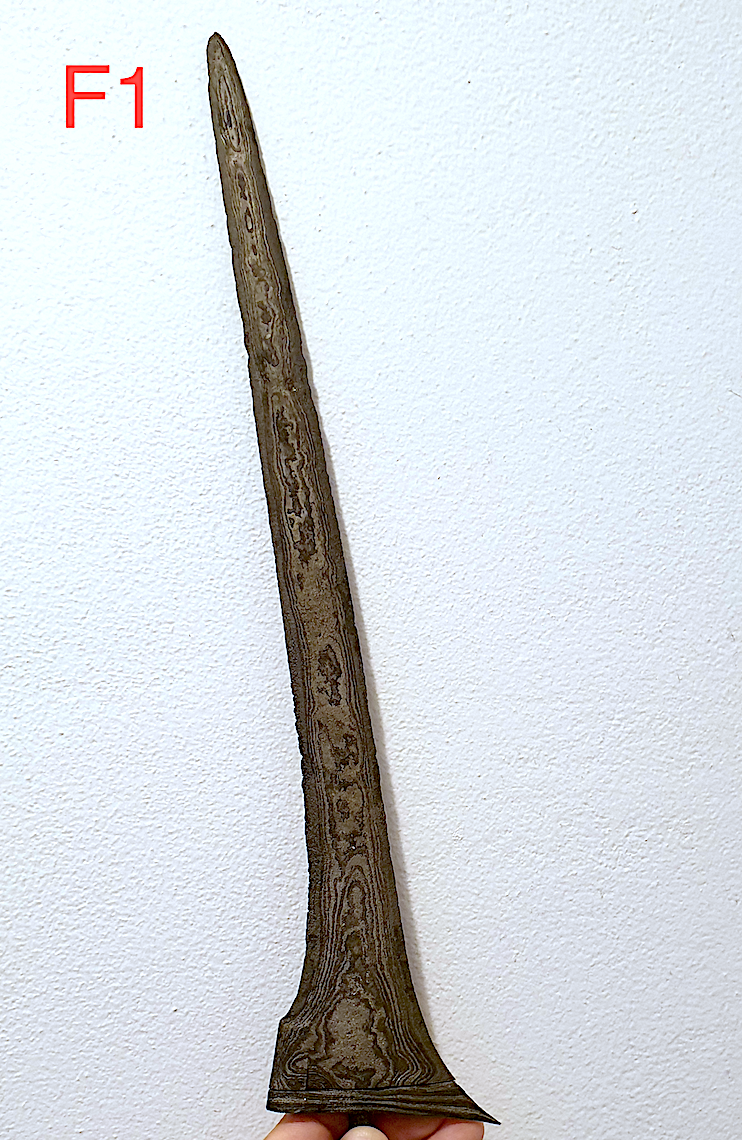

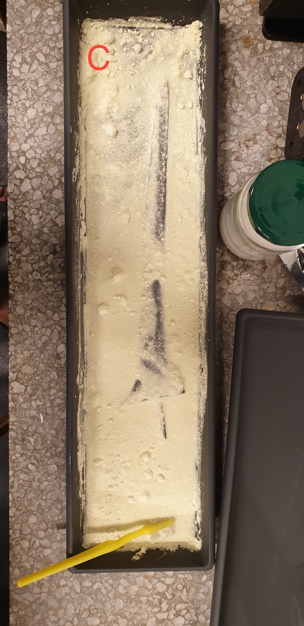

This post is to show the results of staining using a sulphur, salt and rice water slurry on a keris lurus Bugis.
I had attempted this in 2018, the year I acquired it, though I abandoned mission after less than 24 hours because I was a bit more precious about this item than I am now. You can see the results in post #27 here.
Now this keris has become somewhat of a learning vehicle for staining.
I had tried realgar and it did absolutely nothing so I wanted to try sulphur again but this time for a full 7 days.
I am quite happy with the result. It is a little patchy in some areas but I expected this to happen and controlled for it as best as I could. I would definitely try this again with another blade if I needed to stain it, and in absence of good warangan.

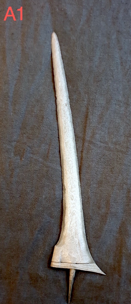

(A) Before the staining

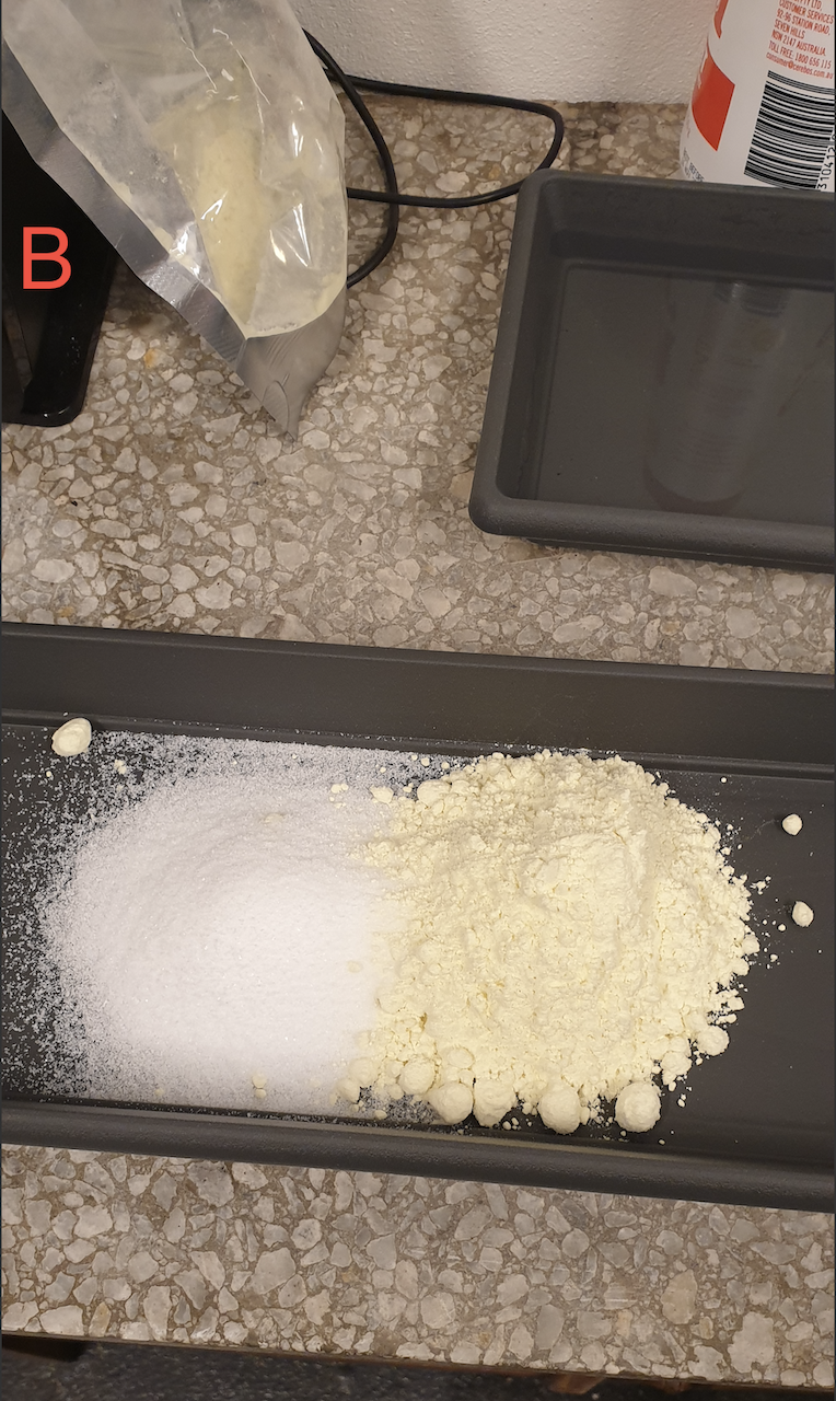

(B) The salt and sulphur in a plant pot tray. Roughly equal amounts.
(C) The consistency of the slurry after adding rice water. Sulfur seems to want to stay powder dry and it does not dissolve well. This slightly improved over the days.

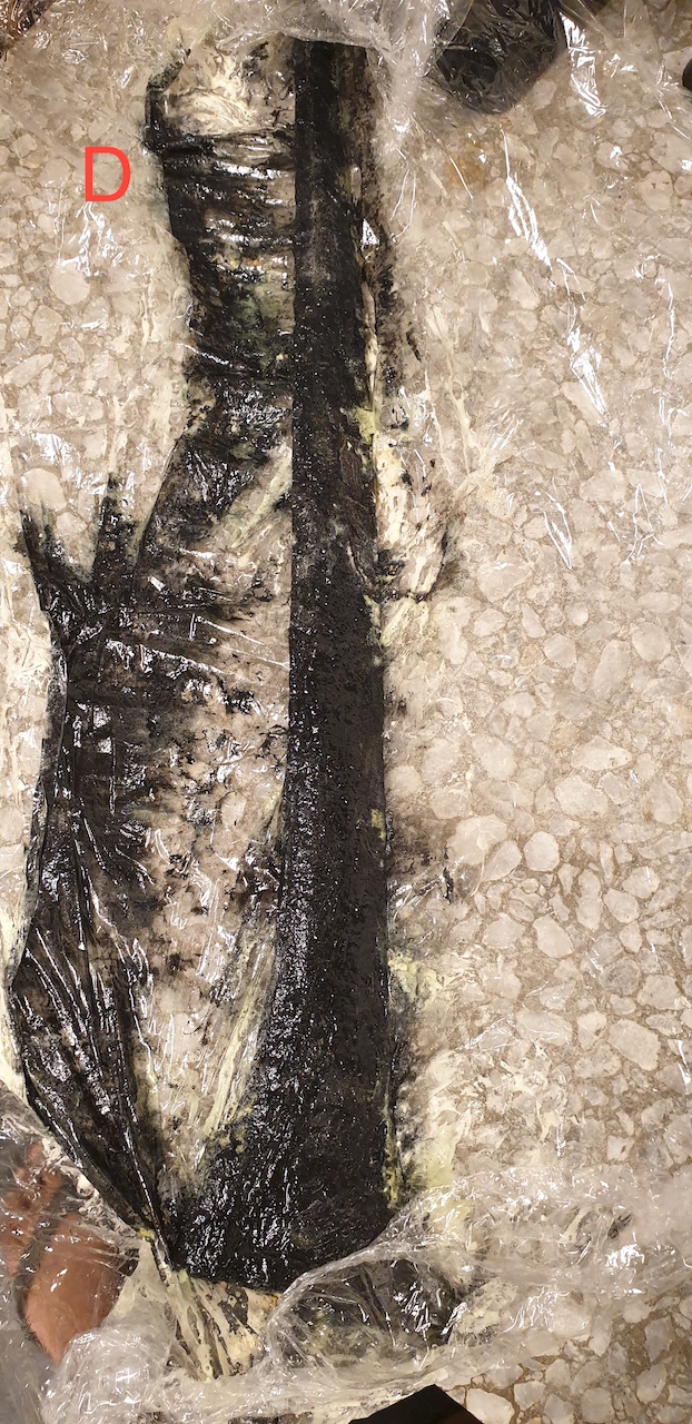

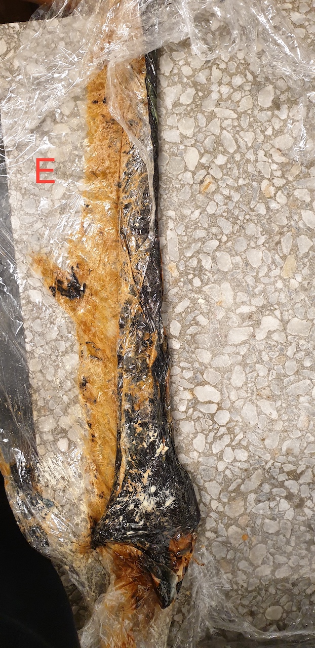

(D) After 24 hrs. Jet black thick ink-like substance. Some areas were a little more exposed so I reapplied the slurry using a tooth brush. From this point on there are no more reapplications.
(E) After roughly 4 days. A rust-coloured residue developed. I have not reapplied anymore since after day 2.

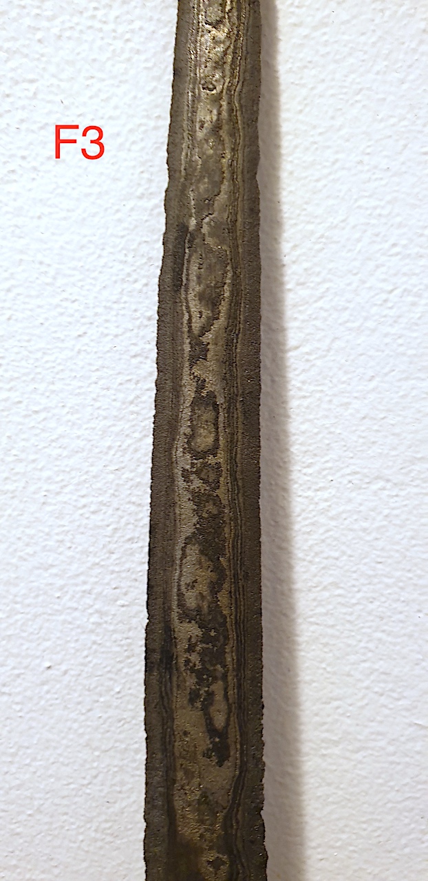

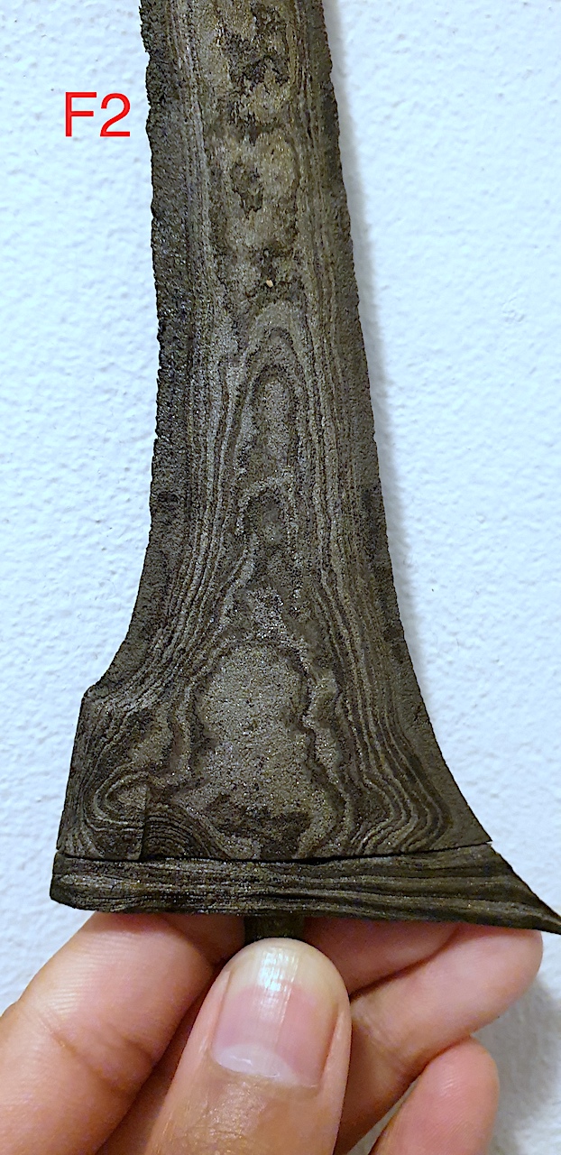

(F) Results after scrubbing (see 9-11 in the Method). As you can see in F2 and F3 there are tinges of surface rust starting to appear due to being exposed too long to air without an oil to protect it. I spent too long between drying and applying WD40.

Old 6th February 2021, 01:46 AM   #2
Posts: 7,257
Looks pretty OK to me.

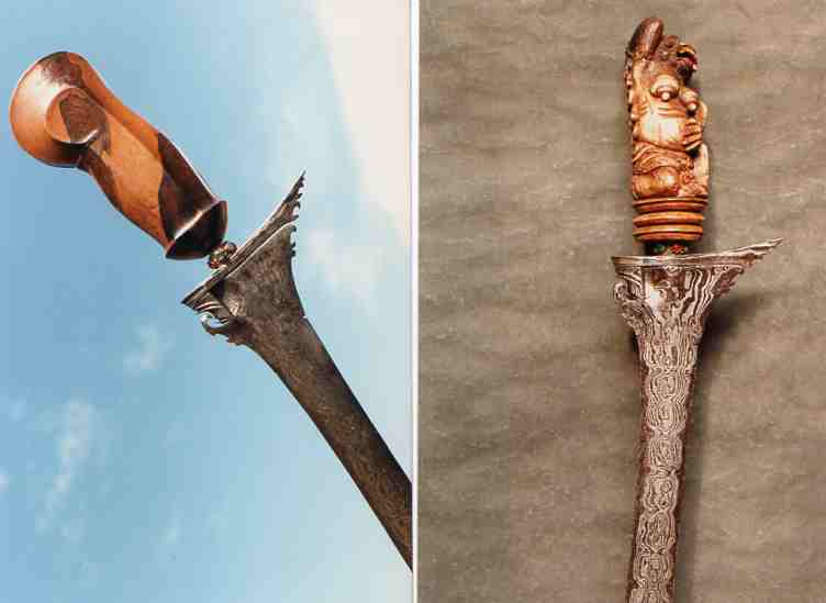

I tried this method with one of the very first kerises of my collection, more or less 35 years ago. I started with a Bali Keris with an almost undiscernible pamor and an uniform light grey colour. After one week treatment and a terrible smell all around, I found that the iron was corroded, while the nickel of the pamor was left intact and in relief, in great contrast with the blackish iron.
The result was good and there was no need to make further treatments to the blade, except rinsing and oiling. I have somewhere the pics taken before and after, shall publish them soon.

Here are the pics as promised. Please do not comment on the quality....

The "hilt" in the second pic is not a keris hilt.
