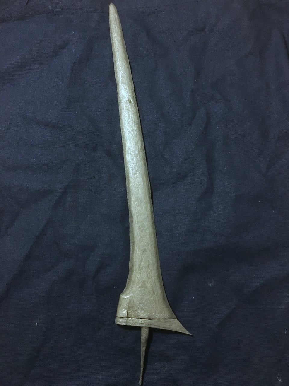

Hi all,
I won this keris in an auction (previous discussion in this thread, which was locked due to me breaking some rules - oops).
Based off contributions in the other thread, it is a Bugis sepokal/sapukala keris.
Here are some more detailed photos now that it's been delivered.
1) There is some kind of crater-like relief or depression clearly visible in the first photo. I doubt it's pedjetan, probably a defect or damage.
2) Significant corrosion towards the tip
3) Evidence of pamor?
4) Not a very pronounced sirah cecak, and quite a uniform gonjo until the buntut. The pesi is a little twisted at the end, but looks more exaggerated in the photo. Not sure if the oxidation where the pesi meets the gonjo is evidence of mechanically fixing the pesi to it, or something else. I tried to scrape bits off and bits of some fibrous matter seemed to come off with it, which definitely didn't seem like corroded steel but perhaps wood or cloth.

Hello Novan,
Congrats for acquiring your first Bugis blade - mind you, they tend to be addictive, too!
It might well be a defect from forging (i. e. missing layer of pamor) - this should be possible to verify once the pamor structure becomes clearly visible upon cleaning.
Looks like there's still enough metal to keep it as is. Of course, another option would be to re-profile the blade tip. Not something to decide now - clean it first...
Pamor is obvious from the layered structure. The amount of possible contrast would only be visible after staining; however, many Bugis collectors nowadays prefer to only utilize weak organic acids like vinegar or fruit juices (despite historic evidence of warangan having been applied to at least some Bugis-style blades (IMHO quite likely for those with complex pamor). You'll probably be able to see some inadvertent staining during any gentle cleaning process.
4) Not sure if the oxidation where the pesi meets the gonjo is evidence of mechanically fixing the pesi to it, or something else. I tried to scrape bits off and bits of some fibrous matter seemed to come off with it, which definitely didn't seem like corroded steel but perhaps wood or cloth.
Quite possible that these are textile remnants of an earlier pressure fit buried into the rust. You'll need to clean the blade thoroughly before being able to study the pesi-gonjo fit in any depth, I guess.
Ergo, 4 votes for gentle cleaning!

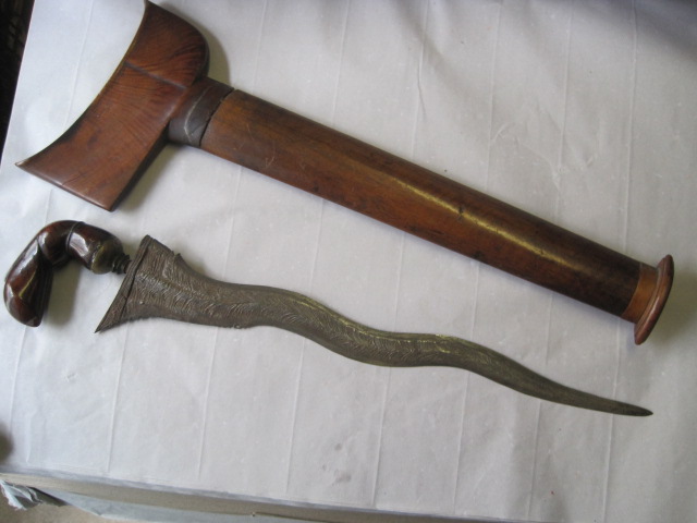

Location: Sydney, Australia
Posts: 295
Thanks for the info David, and for the photo of your keris. Nice!
So if I interpret correctly, it seems that the foregoing of warangan by some collectors is due to the (supposedly erroneous) belief that Bugis-style keris weren't arsenic stained. But is something else typically used to stain the blade and highlight the pamor, if not warangan/arsenic? Or will acids like citrus/fruit juice suffice to show pamor due to etching?
Seeing as I won't have access to arsenic any time soon (perhaps ever), then this is an option I'd be interested in exploring, especially for this keris.
jagabuwana is offline   Reply With Quote
Old 19th June 2018, 02:27 PM   #6
Posts: 7,299
Well, i do believe that fruit acids will reveal the pattern somewhat, but not to the extent that staining the blade will. There are numerous alternatives to warangan, some traditional (i believe if you read the thread i linked at least one using rice and sulfur is mentioned) and some not so traditional. If you use the site's search engine and look for staining methods you will no doubt encounter many threads on the subject.
Most folks will probably say that industrial arsenic works best for this in that it is the most controllable substance you can use, however, you are correct that it is difficult to obtain. But people have also used Realgar for years and crushed it up to create warangan. It is an arsenic mineral and as far as i know it is not regulated like the industrial stuff. I have never used it myself, but i believe other on this forum have so you might want to do a search for that as well.
https://en.wikipedia.org/wiki/Realgar
Old 19th June 2018, 06:34 PM   #7
Roland_M
Roland_M's Avatar
Join Date: Aug 2014
Location: Germany
Posts: 527
Originally Posted by David
I do believe it is fair to say that the currently accepted method of care for Bugis keris in general does not include warangan treatment.
I wonder, why they used pamor steel for Keris Bugis and never applied a staining? As far as I know arsenic must be added to the metal during the forging process to create the black phase of pamor steel after warangan. In my eyes it would make not much sense to add arsenic to the metal without later staining.
It might be interesting to know, that the staining is not really permanent. A little bit of metal polish is enough to remove the whole staining. This means the staining is not very resistant and need to be renewed after some decades or so, depending on environmental conditions and so on. Only under ideal conditions, in a collection for example, the staining can survive over centurys (in my hometown Dresden in the collection of the famous king August the Strong are two Keris from the 17ct. and the warangan is in very good condition. But that is an exeption).
Keris Bugis blades may had never been stained but what i can say for sure is that they were often or sometimes relief-etched. I hope someone knows, what etchant did they used? This would be very helpful.
Roland

Old 24th June 2018, 02:29 AM   #16
jagabuwana
jagabuwana's Avatar
Join Date: Jan 2018
Posts: 295
Update: This is the 7th day of soaking this blade in white vinegar (cooking sort).
I thought it was ready but after killing the acid with bicarb, gently scrubbing with creme cleanser and hairdrying, while it's mostly white, some either rapidly forms or becomes visible on some parts. Also some of the pamor comes out a glittering, slightly brass colour.
I was fairly sure I got the rust out from the crevice between the gonjo and blade, and it appears clean when dry, but rust appears again.
I am using a bristle brush to scrub it (slightly harder than a hard tooth brush) and when there were stubborn, harder chunks of rust I used a precision pick.
Is there something I'm doing wrong here, or is it just a matter of soaking for longer? I've removed from the soak, killed the acid and dried on days 5 and 6 also, and the same rust / brass colouring appears.
Old 24th June 2018, 04:47 AM   #17
Posts: 7,230
Novan, what you have related seems pretty OK to me, but here is the thing:- if the blade is white and clean with no specks of rust on it immediately after drying, then it is clean.
At that point I would either immediately stain it, which you cannot do, or spray it with WD40 and allow to drain and dry on several successive days.
It sounds to me as if you are seeing surface rust that has been generated simply by atmospheric humidity, or something in the surrounding air, or maybe there is still a slight residue of vinegar or moisture in the grain of the metal.
I'm guessing that right at this moment it is sitting somewhere, nice and dry and waiting for you to come back and get rid of the nasty yellowish tint that has formed on the surface. If so, just let it sit and wait for a few days.
If you think you can give some time to it next Saturday, put it back into clean vinegar on say Thursday. When you take it out on Saturday, rinse thoroughly under running water and dry it, kill the vinegar by brushing a slurry of bi-carb over the blade, let it stand for 5 minutes or so, then in the kitchen sink using warm water, a toothbrush and dishwash detergent, give it a really thorough wash, followed by a really thorough rinse. Pat it dry with a lint free cloth, dry it well with a hair dryer, then go outside and drench it with a WD40 spray. Lean it point down against a wall and let it sit till Sunday, drench it with WD40 again, and again on Monday.
If you still have a problem, PM me, and I'll have a look at it next time I'm in Sydney.

Hello all,
Below the photos of the keris Madura I was cleaning. This keris was covered in rust from top to toe, so I'm quite happy with the results. The bi-carb and WD40 have kept that brownish shine from coming back.
Like Alan suggested, I also used some fine steel wool to get rid of some specks of rust. The only area where there is still a visible amount of rust now is between the gonjo and wilah, and some rust in the pejetan.

Thanks for the tips Alan - I've done as you said and it looked a lot better. Here are some photos prior to my stain attempt with sulfur, salt and rice water - I'll have pictures of that in my next post.
Bjorn - thanks for sharing. Mine too was covered in rust. I think you might be able to get into those crevices with a pick to get the rust out.

First time staining attempt:
I made up a paste of
*1tbsp powdered sulphur
*1tsp salt
*Rice water
I brushed it onto the blade after cleaning and drying, and covered it in cling/saran wrap.
I checked on it this morning and it looked like black squid ink and rust in there. I got worried so I rinsed all the sulfur off and gave it a scrub with detergent.
I have a feeling that had I left it in there it would have turned very black. This is what it has looked like after roughly 20 hours.
Based on the above, what should I be doing anything differently or should I have stayed the course?

For that stain medium, I would be inclined to leave the stain at this point:- it is black, it is white, you can see the pamor; good enough.
Make sure all the sulphur and salt is off, WD40, dry, oil.

Yeah you're right Alan, I'll do that. Though a part of me wants to re-do it with a paste with far less sulfur, and apply it more conservatively to see if the result would be more even. Then again I'm also afraid of overdoing the cleaning in a short space of time.
Also I think in my excitement I forgot that sulphur is no replacement for warangan, and expected something much more striking. It was a good learning experience though.
Anyway, I think I'll put this one down for awhile Thank you everyone, particularly Alan, for the guidance and input.
