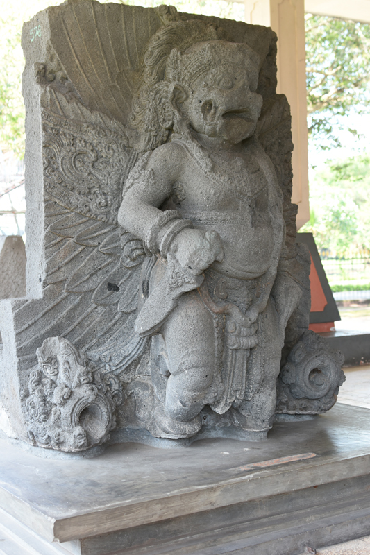

One of the perennially popular topics for discussion is the Mojo Keris. I might be wrong, but over the years I have formed the opinion that everybody who collects keris wants a genuine Majapahit Keris. The Real Deal. Something that was made in the old Majapahit kingdom, during the Majapahit era.

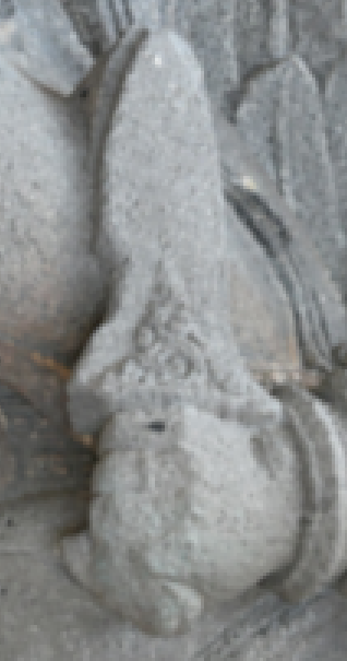

Well for your enjoyment, herewith a photo of statue in an East Javanese museum that is located within the bounds of the old central area of Majapahit. This museum specialises in the display and preservation of Majapahit relics.
The statue was produced during the Majapahit era, in Majapahit.
There is no real agreement on who the statue represents, some authorities claim Minak Jinggo, others Garuda, or Maha Kala, or even Bhairawa. Who it might be is perhaps not really important, but if we want to get an understanding of what the keris looked like during and before the Majapahit era, this statue can demonstrate that.

Very interesting indeed, the kris is still in "leaf" style (short & broad), not a modern kris. From early Majapahit period?
Old 10th June 2019, 09:55 PM   #4
Posts: 7,258
I don't know Jean, Mojo, certainly, exactly what time, no idea.
Yes, Anthony, interesting, and it becomes even more interesting when we trace the form of the keris through bas reliefs from the Central Jawa (Early Classical) period to what we can see in the reliefs and statuary at Candi Sukuh (+/- 1437).
There is much to consider in keris development.
Guilty as charged. Any example on which this stone-carving might be based would be perfectly fine with me...
Although the pommel is a bit damaged, the (reverse) grip is obviously the old style and apparently would not lend itself to any kind of pistol grip for optimized stabbing.
Mojo was a fairly short period (at least compared to the whole classical period during which this development took place).
Considering the pretty scant evidence, I'd expect that this earlier style was still utilized during a notable part of the late classical period. However, even if this sculpture could be reliably dated to the late Mojo period, it might be just a reference to an already obsolete style.

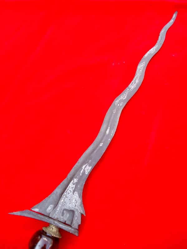

Honestly speaking, I am still confuse about how Majapahit keris looks like, till now. I always have impression it has less pamor, dark iron etc. Below link is just a sample.
https://pusakadunia.com/keris-majapa...tuah-ampuh_10/
Anthony G. is offline   Reply With Quote

Anthony, there is a very great difference between keris that some people might classify as Tangguh Majapahit, and the keris that evidence seems to indicate actually might have existed during the Majapahit period.
Tangguh ngak sungguh.
Old 11th June 2019, 12:48 PM   #9
Posts: 7,258
Kai, it seems to be generally agreed between those people who are supposedly expert in these matters, that where material objects exist in Javanese sculpture from these early periods, those material objects do in fact reflect what was in use in the community at that time.
As to whether or not this sculpture actually did originate during the Mojo era, it is as I have already said:-
it is in a museum that exists for no other reason than to preserve and display Majapahit artifacts
it was found in the central area of Majapahit, and noted scholars consider that it is Majapahit work.
I might be a little bit naive and perhaps too trusting, but all of that is good enough for me.
Most of us are wondering, I guess.
From statues and bas relief, it stands to reason that the keris buda (and possibly its ancestor, too) was at least well-known and very likely in active use by the ruling elite throughout (almost all of) the classical period. It’s the “modern“ keris which seems to make a really late appearance based on the extremely scant evidence.
These features most commonly referred to in (pseudo) tangguh probably are mainly due to extensive erosion of the keris blade and subsequent exposure of the slorok.
As Alan already mentioned, it hasn’t been established whether blades classified as Majapahit really originate from that era. Even if partly true, each member of nobility must have hoarded thousands of keris to account for the number of examples nowadays claimed to be Mojo...

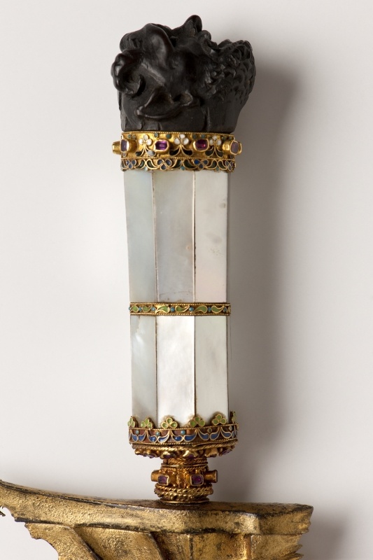

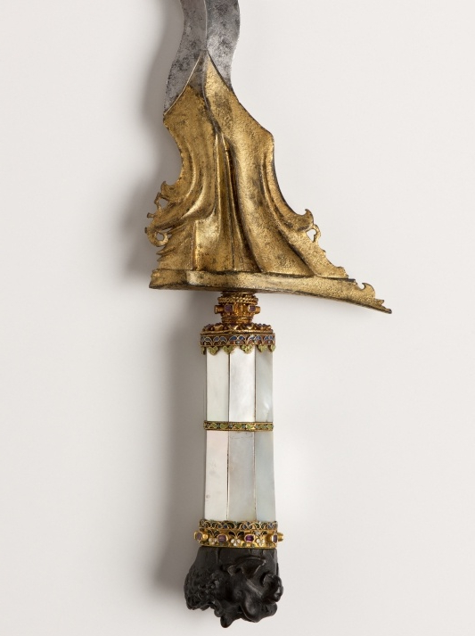

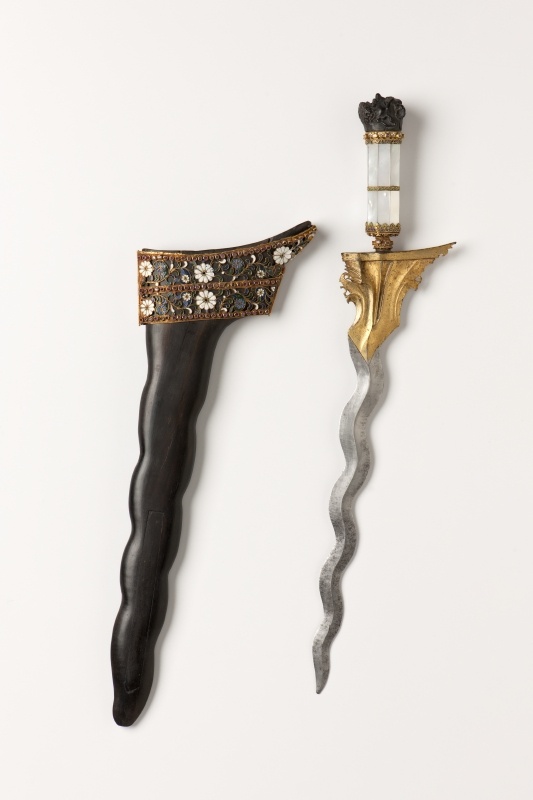

The earliest well-preserved modern keris are documented from European collections since the later 16th century. It seems quite possible that a small fraction of these may date to the late Mojo period. However, this could only be substantiated by destructive sampling and C14 analysis; any recycling of old steel might confound the results though.
Considering the ambiguous blumbangan, I‘d suggest that this is not the best candidate for a textbook example unless one subscribes to a very neoliberal tangguh approach...

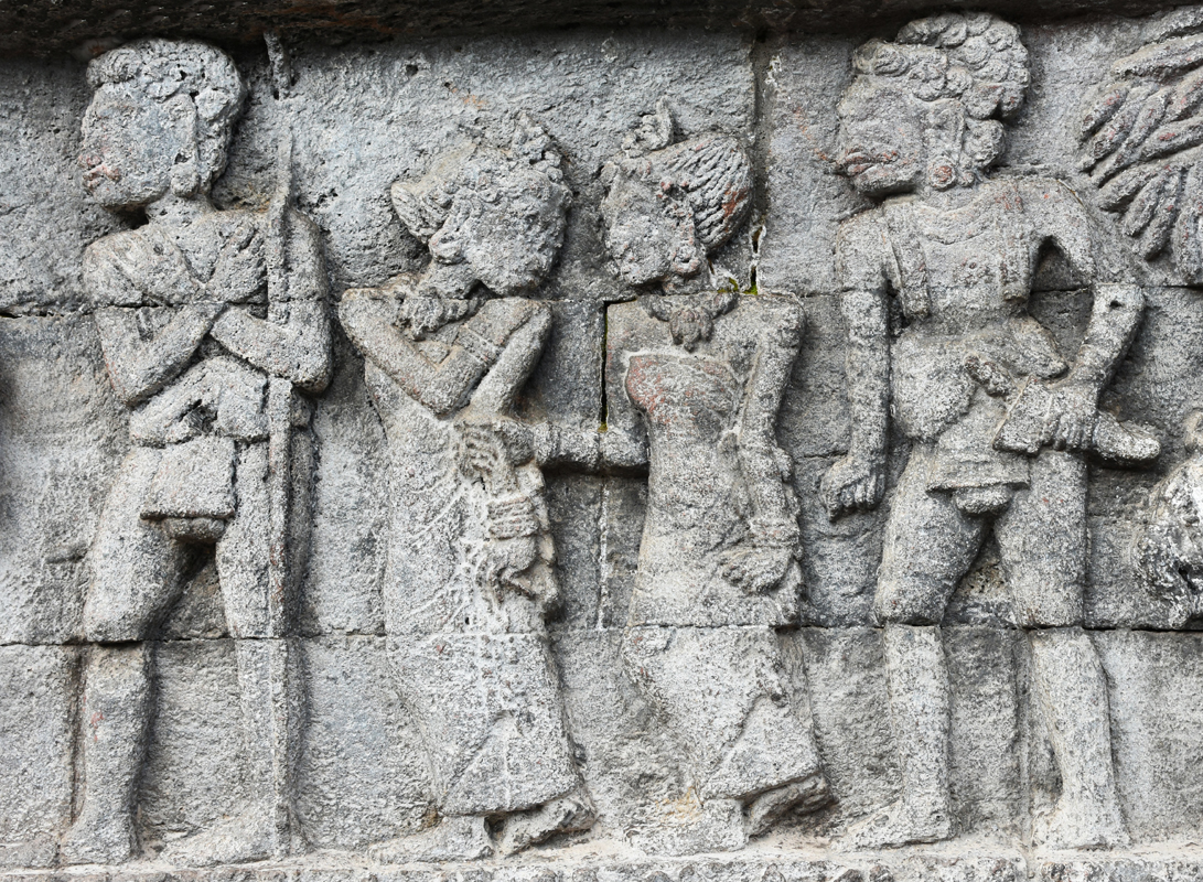

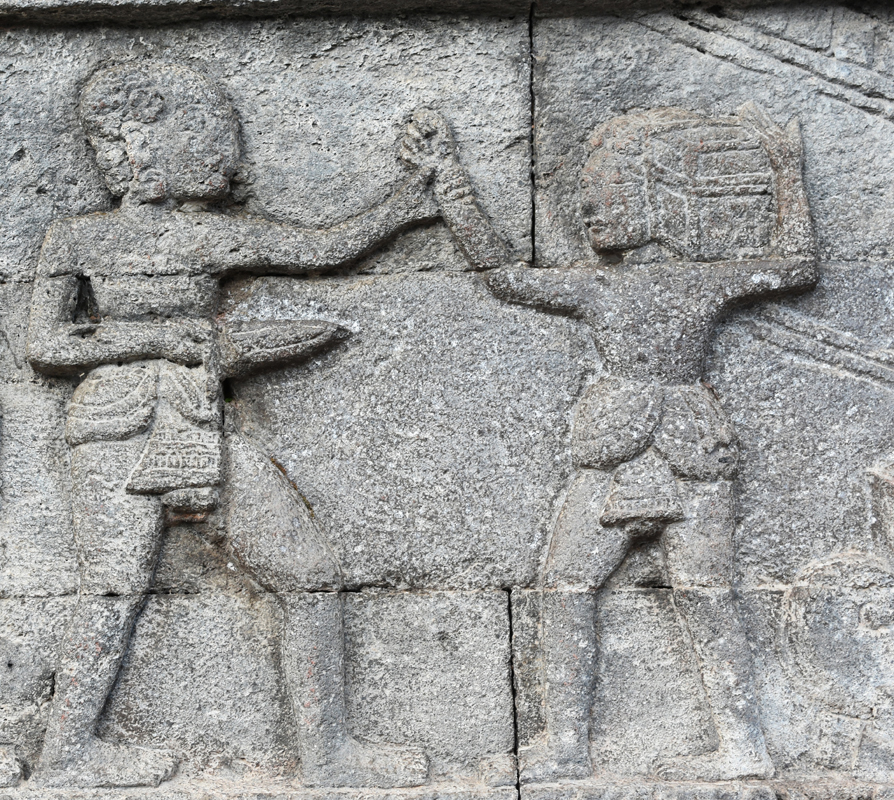

Here is another Mojo keris, this one is at Candi Penataran (Panataran), near Blitar. Penataran is mentioned in the Nagarakertagama as Candi Palah. Candi Panataran was built (approximately) between 1350 & 1389.
This is one of my favourite Majapahit keris representations.
These representations are not rare, nor are they singular Kai, they're all over the place. True, they need to be searched for, but if you're prepared to put the time in, they can be found.
I've spent a total of around two weeks at Penataran over the years, I've visited Candi Sukuh more times than I remember, probably about 50 to 60 visits, usually only of 2 or 3 hours, but that time builds up. Prambanan (Loro Jonggrang) I've spent a total of 5 or 6 weeks on, but during my early visits, the terraces were not open for viewing. Most other Candis I've only visited once or twice, and only for a day or so --- except for Borobudur, I've spent a lot of time there, but it is Buddhist, no keris nor keris-like daggers there. There is a lot of statuary that has been shifted from its original location and is now in museums --- these examples are not always easy to find.
This one is interesting because it shows the rapier grip, which means that it does not have the heavy Indian style pommel that most of these early keris have.
We call these weapons "keris" now, and they might have been called "keris" back then too, but perhaps only in generic terms, there are other candidates for an accurate name when Old Javanese language was in use, names like "tuhuk" & "tewek", which could well refer to the same weapon, but be a reference to mode of use.
Yes, this is a gem! I‘ve also spent considerable time at temples from the classical period in Asia (as well as musea). It’s a shame that many sites were heavily looted with many pieces ending up in inaccessible private collections.
I agree that a number of representations of the keris buda are extant (I realize that this modern term is a bit unfortunate in the light of its not unexpected absence at Borobudur). Even more common are representations of its ancestor and in quite a few cases it is not really possible to verify whether the blade may already conform with our current definition of a keris blade (which at that period likely was not a distinct style but rather variations of a theme).
What really is extremely scant are representations of any modern keris though! The famous forge scene at Candi Sukuh may well show one example; its details are not really clear though (maybe an issue of craftsmanship?) and in my humble opinion it is not possible to utilize this as a proof of a fully developed modern keris. It’s very important evidence but may also show an intermediate style rather than a full-blown modern keris.

Kai, the term "Keris Buda" has very little to do with Buddhism, it refers to the period:- Javanese people use the term "Buda" to mean the old times, before Islam. In fact, although we talk about Jawa Hindu, the fact is that Agama Jawa Hindu is actually Agama Hindu-Buda.
At Candi Sukuh there are two keris in the famous Sukuh Stele, one on the wall, one on the anvil, both are a Keris Buda form, not Modern Keris. In fact, the forge scene has nothing at all to do with forging, it needs to be understood in the broader context of Sukuh itself.
You mention the "ancestor" of the Keris Buda Kai, and that it is even more common than the KB. I must be missing something here, because although I do have a small collection of KB's, and I have sold others, I have never had the opportunity to purchase the type of early dagger that does not have the gandhik.In fact, I have never seen this style of dagger in Jawa.
Yes, you will not find any representations of what we can call a "Modern Keris" in any Hindu-Buda period bas-reliefs or statuary. None. We can find longer examples of keris-like weapons, and maybe I could be convinced that these belong in the keris basket, but in fact they are more like Balinese ligan or Keris-Pedang.

There are two details which visually caught my attention when I look at the picture of the initial post by Alan -
1) one feature of the dagger resembles the shape of the somewhat strange object known as the Keris of Knaud, I mean the concave shaping of the blade above Gandhik or where Gandhik should be.
It is the question if that feature is a damage or was intended.
2) the scroll (?) within the triangular symbol on the blade resembles the scroll found inside the 2 big Tumpal pointing upwards on the left and right side, and the 4 small Tumpal pointing downwards on 16th and 17th century figural hilts.
Of course it could be Bintulu (the image is just too small). Something we see also on Gandhik on later Keris.

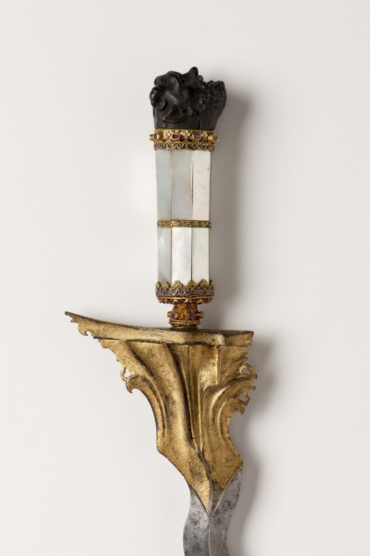

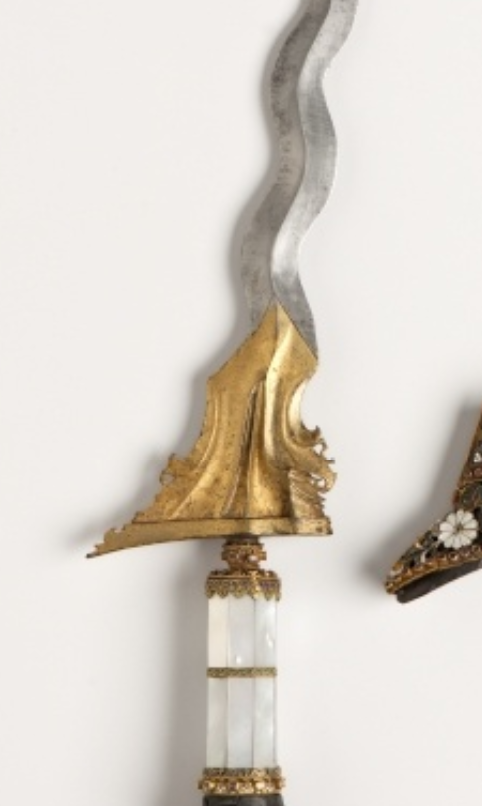

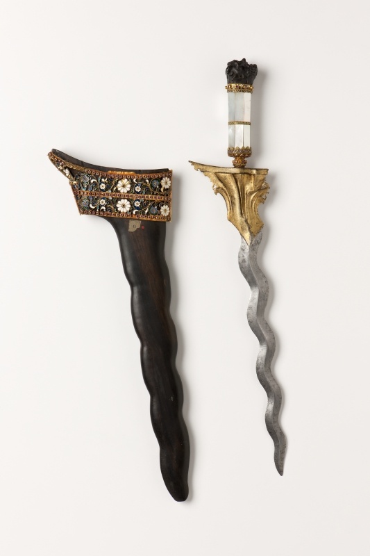

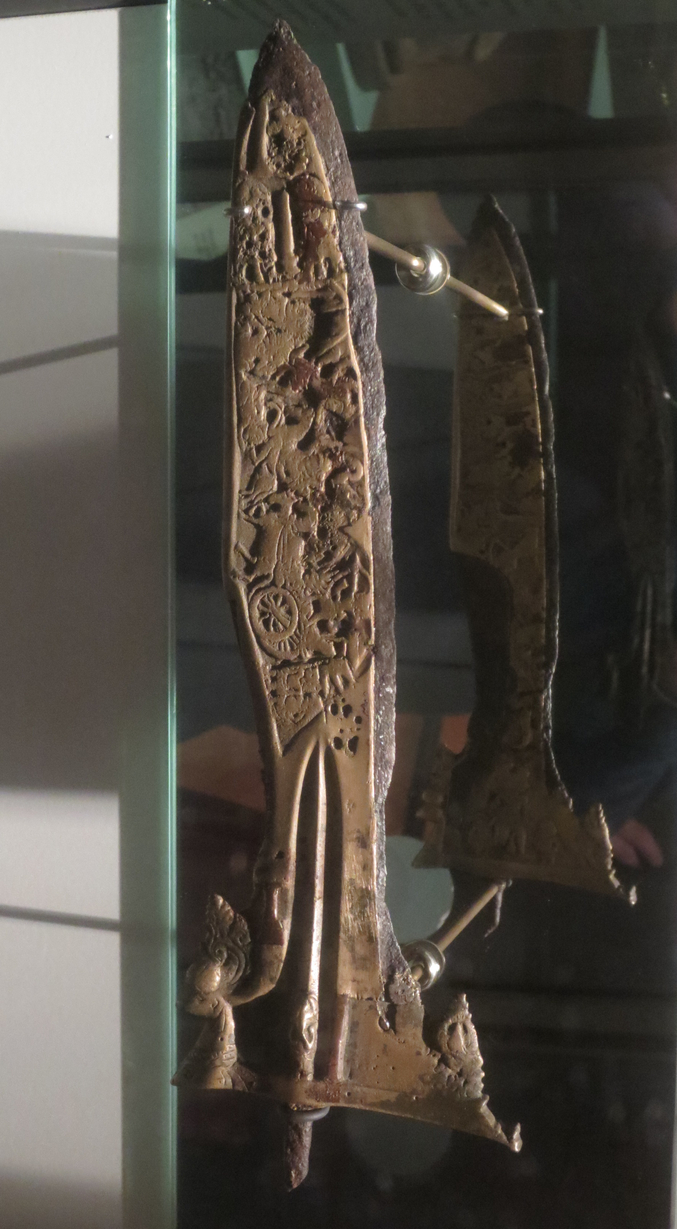

And speaking about strange and old KLO - there is a hardly known early Keris in Stuttgart. 1653 it came in to the Wuerttembergische Kunstkammer, but originally it belonged to the Johann Jacob Guth von Sulz collection. Johann Jacob Guth von Sulz lived 1543 till 1616, so there is some possibility it was collected already in the 16th century.
The sheath and hilt were supposedly made in Transylvania.
Blade is heavily reshaped, but there are some interesting and peculiar features on Sorsoran. The total length with hilt is 43 cm, so the blade could be 30 - 33 cm.
