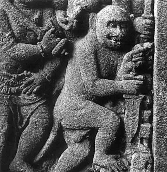

1. Prambanan I. A monkey warrior holding a Prambanan I style dagger. The leaf shaped blade is the great grandfather of the modern keris. Located at Candi Shiva, Prambanan Temple Complex, Central Java. The temple complex at Prambanan consists of the central temple of Shiva, flanked by the temple of Brahma (south) and Visnu (north), and 5 smaller temples. On the inside of the balcony wall of Candi Shiva, and continued on the balcony wall of Candi Brahma, the story of the Ramayana is carved in relief. The relief carvings of Candi Shiva contain at least three representations of weapons, which I shall refer to as "Prambanan I", that I consider to be forerunners of the keris buda. These weapons are daggers with leaf shaped blades, splayed blade base, and with a separate piece fitted to the blade base, as is the gonjo on a modern keris blade. All are fitted with heavy pommels, topped by a dome, in the Indian fashion, and are held in a manner which dictates an overarm stab, rather than a thrust.

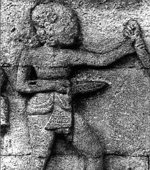

2. Above: Prambanan II. Laksmana holding a Prambanan II style dagger. All essential features of a keris are present, and the blade form is what is now known as 'keris buda'. The handle, with its heavy pommel, is designed for use with an overarm stab. Located at Candi Shiva, Prambanan Temple Complex, Central Java.

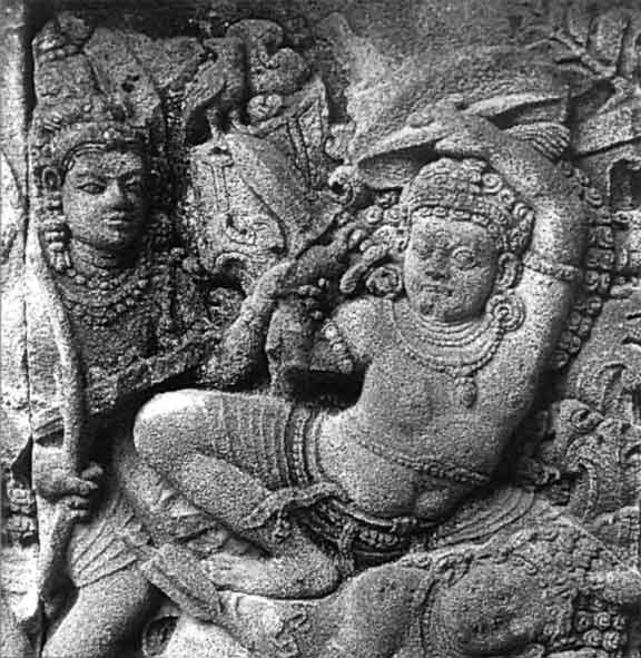

3. Right: Prambanan II. Close-up of the dagger held by Laksmana in the photograph above.The relief carving of panel No. 4, second scene, depicts Rama and Laksmana killing the giants which are threatening Wismamitra's hermitage (Moertjipto, Drs.). The dagger shown in this relief bears an asymmetric base, defined gonjo, kusen, and odo-odo; all features of a keris. I consider that this dagger, which I shall refer to as "Prambanan II", is a representation of a keris buda.

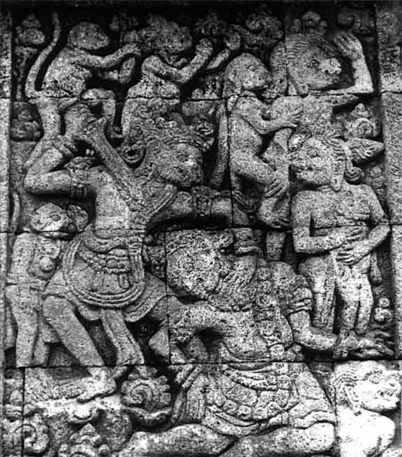

4. Prambanan I after the move to East Java. Hanoman, The Monkey King, shown using an elongated version of the Prambanan I style of dagger. Located at Candi Panataran, East Java. There are many representations of weapons in these reliefs, and swords, spears and daggers bearing blades similar to those found in the reliefs of Prambanan can be identified. Included in these representations of 14th Century Javanese weaponry is a relief of Hanoman using a dagger with many of the features of Prambanan I, and using it as an overarm stabbing weapon. However, in the Panataran relief, this dagger has become a little longer and proportionately thinner.
5. Prambanan II style blade, but the handle is without the heavy pommel, thus permitting the weapon to be used to thrust, rather than with an overarm stab. This is the first monumental appearance of the keris as a thrusting weapon, and is located at Candi Panataran, East Java. There are several representations of keris in the Panataran reliefs. Two of these representations are particularly interesting in that one shows clearly the manner of use; and the other the way in which the keris was worn. These keris are still represented as short and broad, however, the relief which depicts use shows that the grip has changed from an overarm stabbing grip to a grip which will allow a rapier thrust. Moreover, the relief showing the way in which a keris was worn demonstrates that the heavy pommel of Prambanan II has disappeared.

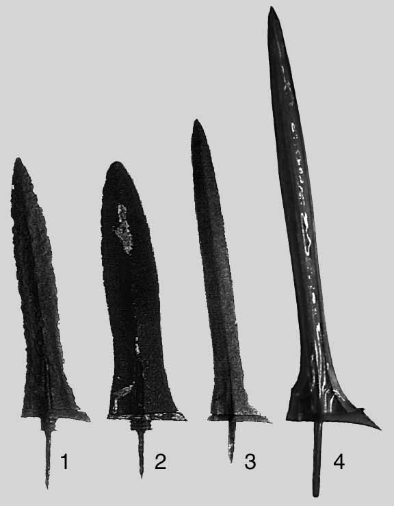

1 A keris buda from the period 11th to 13th Century. No pamor is in evidence, and the laminated construction technique has not yet appeared.
2 A late keris buda. The blade is of early form, but laminated construction was used, and pamor is in evidence. This keris was probably made after the mid 14th Century, as a copy of an earlier piece.
3 Transitional form of keris. In this blade the emergence of the modern keris has begun. Some features of the keris buda are still in evidence, such as the square tang, high gandik, and broad gonjo. However, the tang, although still essentially square has a slight radius on its front and back, and the blade has lengthened, and become lighter. Close examination reveals residual traces of black iron with what appears to be an inclusion of nickelous material. The bulk of the blade material is heavily grained iron or steel, and as it retains much of its original form, indicates that the laminated outer skin would have been very thin. This blade appears to be an early attempt at laminated construction, and probably dates from 13th to 14th Century East Java.
4 A modern keris, the blade executed in the Central Javanese Surakarta style. This keris was made in 1987.Examination of physical specimens of pre-modern keris and of early examples of modern keris, shows that on some pre-modern keris, a line drawn through the centre of the blade deviates from a line drawn through the centre of the tang by 3°, on other pre-modern keris, this deviation is 8.5° to 9°, and on the modern keris the deviation varies from 8° to 12.5°. The smaller angle of deviation found on some pre-modern keris, and resulting in a blade with a straighter presentation, is consistent with a weapon used to stab overarm, whilst the wider angle of deviation found on other pre-modern keris, and on all modern keris, is consistent with the thrusting style of use of the modern keris. The existence of two distinct angles of deviation in pre-modern keris would seem to indicate that even before the appearance of the modern keris, its immediate predecessor was being used to thrust, as well as to stab.
