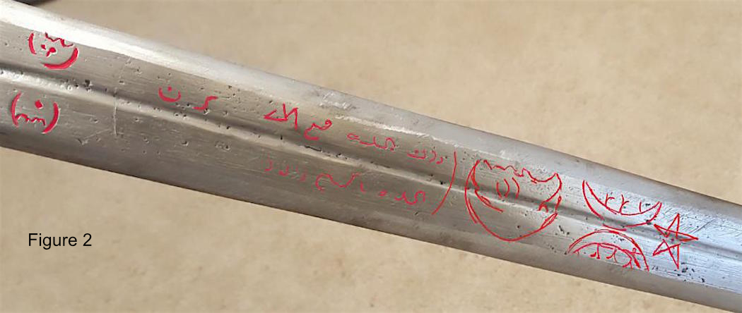

It's interesting to note that the scratch-engraved half-moon and star designs on the center blade of Figure 1 (see Figure 2 for its enhanced engraving) is almost a duplicate of the blade in Reed's Plate LVb (Figure 3). While Reed's Darfur blade has only a single narrow fuller, it was likely made and engraved in Kassala by the same hands as the example in Figure 1. This Kassala example was purported to have been “a Mahdi sword” supported by the talismanic moons and text engraving suggesting a high level of religious devotion.

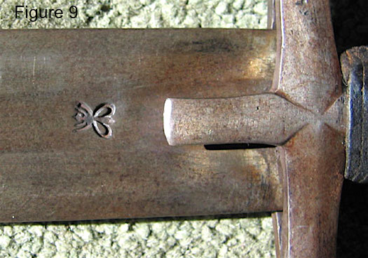

4. Dukkeri abu Dubban

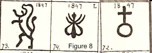

The blade has a short central groove and carries three marks known as dubbana, nugara, and 'asad.
The interpretation of this style addresses several issues we have long debated. Its name and descriptions correspond to the Solingen maker's marks for Peter Kull's Standing Cat, Orb & Cross (1830–1870, Bezdek) and Samuel Kulls' Fly (1847–1860, Bezdek) (Figure 8). The Dukkeri abu Dubban incorporates these three symbols (Cronau, 1885) and may suggest a mid-19th C origin of the type. Cronau's work, in German, can be accessed from this link: http://libmma.contentdm.oclc.org/cdm...coll4/id/29401
An example is shown in Figure 8.
Dukkeri. This may be Brigg's dukeri for crescent moon with man's face in profile. A Kassala informant said it meant “for men”. Swordsmiths there describe a sword called a duk'ri (my transliteration) and is decorated with an Orb & Cross and a Rampant Cat/Lion.
Dubbana or Duban. Fly. Likely signifies the biting fly that appears with the rains and is very harmful to camels. It's arrival prompts camel herding pastorialists to take their animals north out of its range. Dubban also means “thousands” in Hausa, maybe signifying the number of flies that swarm about. It also may indicate Hausa smiths possible role in applying this fuller type to Sudanese blades. The informant said it encourages “jumping like a fly when fighting.” (See fly symbol on Jeff D's sword, Figure 9. His sword also has a lion and orb & cross on it.)
Nugara means “drumming”. Informants used daluka for drum and (perhaps hearing the drum beat) say that it “builds courage”. The drum symbol they presented was the famous Orb & Cross. Among most northern Sudanese ethnicities the large copper kettle drum is central to their culture. According to Clark, p.13, it may only be beaten in mourning of a death in the chief's family, to summon the tribe to war, and at a festive occasion for the tribe. The tribal drum also is used in Darfur, of the Medieval Funj Kingdom, and may be universal in Northern Sudanese culture.
The Funj Kingdom (1504–1821) had its capital at Senner on the Blue Nile River. Its lands were mainly on the east side of the White Nile north into the Gezira and included the Butana Plain. Arkell (1932) reports that the Funj had a brand put on their beasts and slaves called Noggara wa Asiaiya. This means “drum and stick” and the symbol is O+, rotated 90 degrees clockwise (in other words, resembling the symbol used by biologists to denote “female”). This symbol looks the same as Peter Kull's Cross & Orb. It is conceivable that the Kull sword mark culturally replaced the Funj symbolism that had been abolished by the Egyptian conquest of the Funj, and it became highly valued on the kaskara blades. One culture often borrows from another. If a cultural feature persists for generations it has continued relevance. If not, it no longer has meaning. Steven Wood's sword has a properly oriented Funj “Drum & Stick” mark (Figure 10).
Asad means “lion”. The informant said it is for “brave men”. A full-bodied lion is often lightly engraved, maybe etched, on native blades, but the Rampant Lion/Cat in #73 above is sometimes seen. The informant said that the lion is placed on the front of the blade and the drum and fly placed on the back.

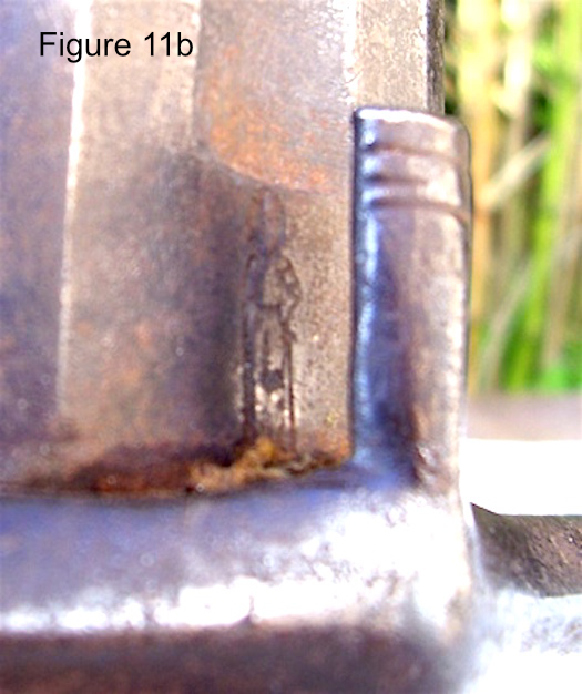

Several posts on the EAA Forum have exhibited swords with the three symbols apparently originally struck by Solingen makers as well as those etched on locally made swords. Katana/David's W. Clauberg marked (Standing Knight) Dukkeri is datable. Bezdek's German makers' marks book shows that the Standing Knight was used after 1847. David's sword is shown in Figure 11a, and the Standing Knight example in Figure 11b.

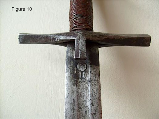

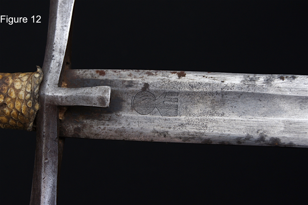

Mefidk/Chris blade with the crocodile skin grip has a W. Claberg Standing Knight (hidden) and the “enigmatic” mark (shown) (Figure 12).

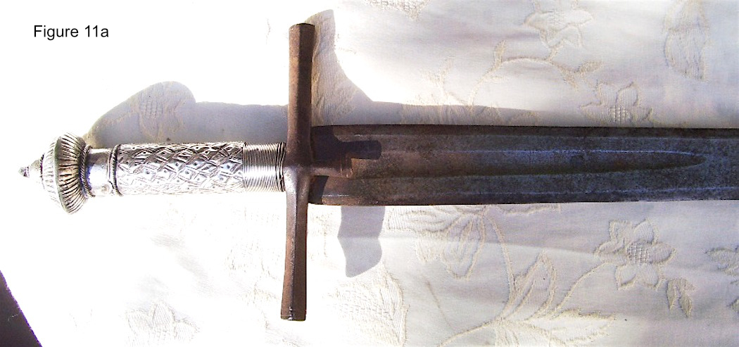

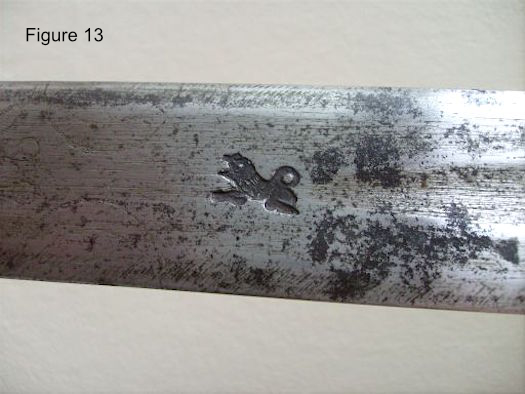

Steven Wood has a single fuller sword with a Lion mark on a single groove blade (Figure 13). It looks more European than native-made and does not resemble the Kull mark to me.
The Metropolitan Museum of Art has a kaskara (Cat. No. 1977.162.4) with a Dukkeri fuller. It is classified as late 19th C Sudanese with a late 15th–16th C Italian or South German blade. They show a Passaua wolf and a maker's mark of a seven-pointed star. If the attribution is accurate, this blade would date the fuller from a century earlier than Reed's LII.

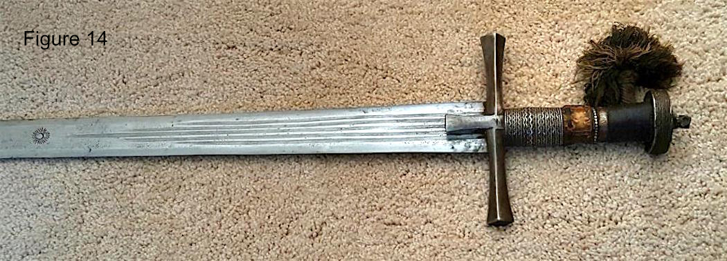

5. Suliman Makhummas
This type has five forged fullers of graduated lengths that extend about a third of the way down the blade. (Not in Clark's topology.) Khamsa is the number “five” in Arabic.
This is a rare blade with only five examples having been revealed so far. Two have a Sun symbol at the end of the fullers. The sun does not appear to be a maker's mark, but it likely has some unknown symbolic meaning. The informant called Suliman Mukhammas abu Shammish. (Shams is Sun in Arabic, Shammish may be some grammatical variation or I misunderstood the word.) None of the other examples have apparent maker's marks either. Images of three are linked below and the fifth has no image.
• My sword has the five grooved Makhummas with a sun at the end. Made circa 1914 in Kassaka. (Figure 14).

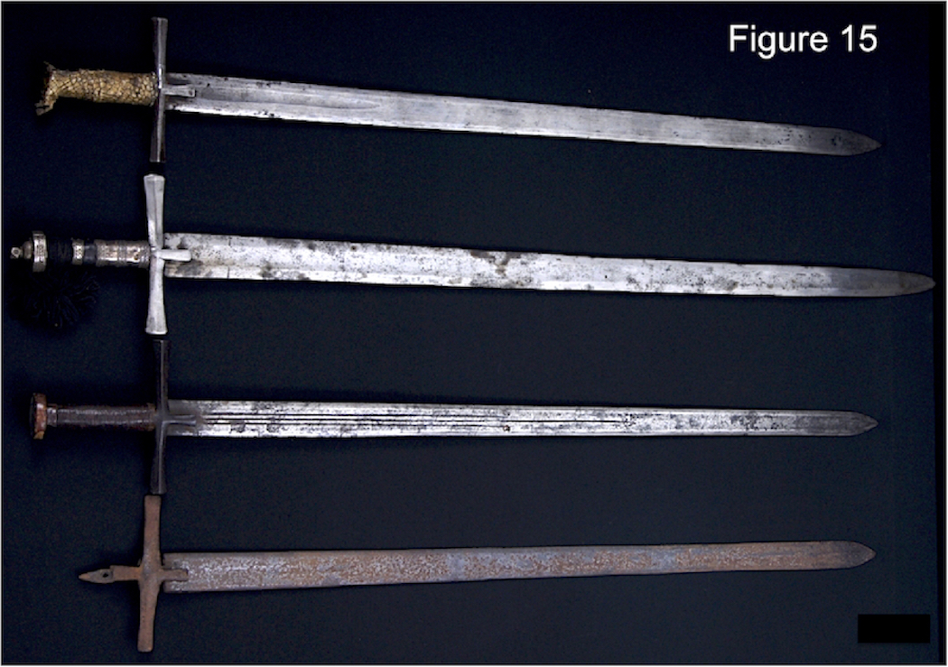

Chris' first image on Post # 20 summarizes the major contemporary types, top to bottom, first three: Dukkeri, El Kar, and Sulimani (Figure 15). We also can name and better understand the range of historic types we are likely to encounter. No doubt I have probably made errors and omissions in this discussion. I would appreciate readers’ inputs and comments.

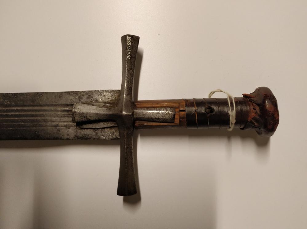

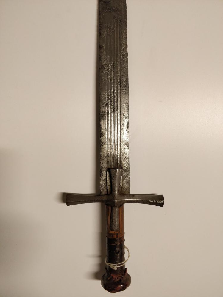

There is one more blade type with two or three parallel fullers of medium width and equal length, such as in the threads below:
http://vikingsword.com/vb/showthread.php?t=16092
http://vikingsword.com/vb/showthread.php?t=21372
http://vikingsword.com/vb/showthread.php?t=23900
In previous discussions these have been described as Eritrean, but the one I have is in a Sudanese dress. What is your opinion on these?

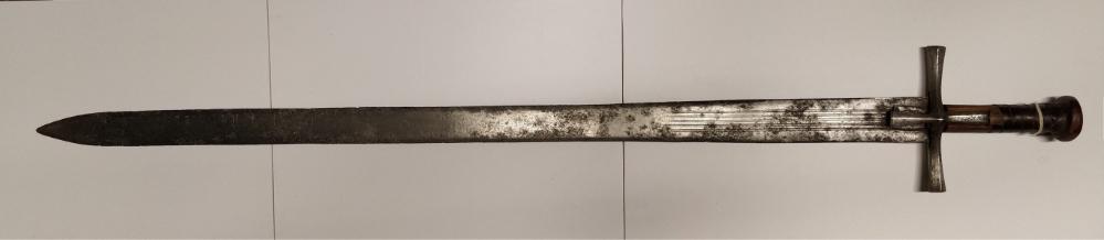

Default 1882 Suliman Makhummas
The images attached are of the Suliman Makhummas kaskara collected by the 4th Irish Dragoon Guards in 1882 as referenced in the RDGAC text linked above. They were provided recently for use by permission of the York Army Museum who requested notice of images copyright by the Museum.
This before 1882 sword is significant as it is at least a generation before the c.1914 Makhummas the example in Fig. 14 above. Also the quillon is similar to the 1914 example. There appears to be a blade reinforcing piece under the langet.
Special thanks to Aline Staes, Collections Manager, York Army Museum.
Ed

Posts: 433
I own a Kaskara very similar to fig.1 lower sword. What I find interesting is the two indents in the blade nearest the cross guard. They are only on the one side opposite each other and remind me of blacksmiths tong marks.
The blade is fairly thin and tapers evenly in thickness. Moon faces on both sides of blade appear to be stamped in. A very narrow leather strip like a thread or thin string winds over the grip.

Hi Ed.
I wonder if the added piece under the langet may be a repair. Perhaps a broken tang. I’ve seen similar additions on Moro swords for repairing damaged tangs.

Ian,
Yes, that was my thought as well. I have requested an oblique pic of that section and further assessment. A repair would be testimony to the common breakage of native blades during the Mahdiya period.

Broken or sometimes just too short
I've seen the same on Persian dagger tangs, two pieces of metal to hold firmly the blade.
Is it the same with the tabouka, you've sometimes two pieces of metal at the forte with rivets?

Kubur, you could well be correct. RDGAC's assessment of the tabs on sword #3 are:
Quote: "At said base are a pair of large tabs, seemingly forge-welded or similar to the flats of the blade, and presumably intended to broaden it a little and allow the cross-guard and grip a firmer attachment to the base and tang, though that's probably an erroneous presumption."
Ed
