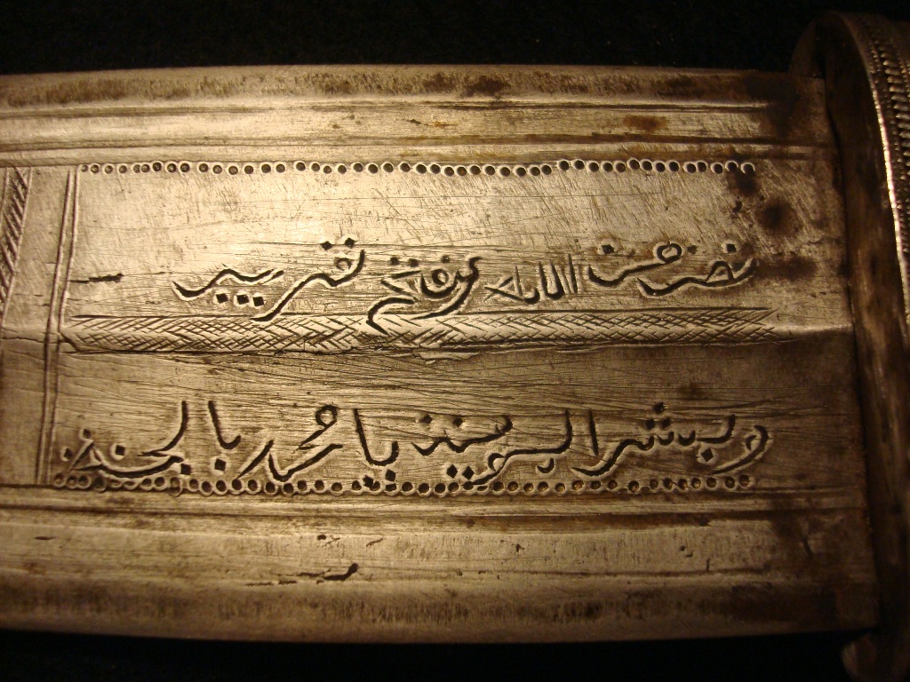

Posts: 327

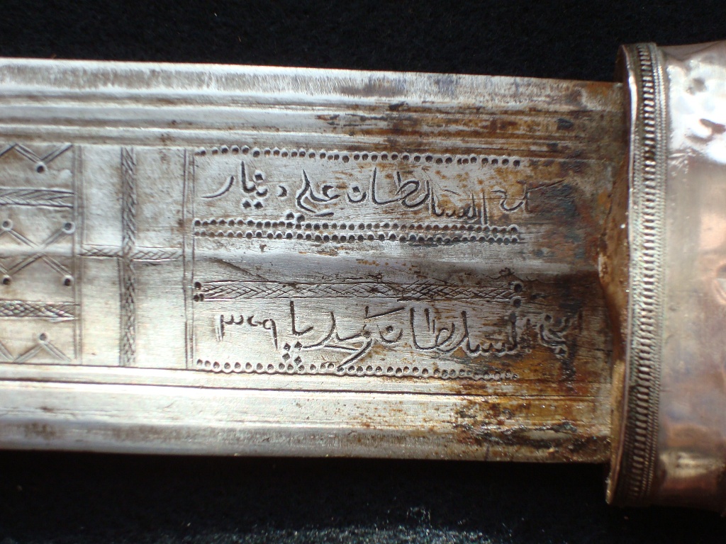

I need a translation, if possible............Dave.
Old 13th January 2011, 11:31 AM   #8
Dom
Dom's Avatar
Join Date: Oct 2005
Posts: 1,142
YES ... if possible
my sweet translator has a print out of the pic, and she's facing some difficulties
- hand engraving (not too good) in old arabic
- short part of a poem
- here in France, we don't have a computer with Arabic system, the search is much more complicated
- might be our answer 'll be doubtful, unfortunatly
à +
Dom

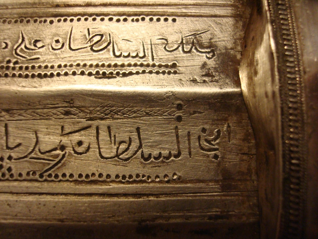

Hi Dave,
congrats....nice Kaskara. Are there any makers marks near the hilt ? The diamond patterning is similar to one of mine.
http://www.vikingsword.com/vb/showth...hlight=kaskara
Kind Regards David
Old 13th January 2011, 09:53 PM   #10
DaveS
Join Date: Feb 2006
Posts: 327
Hi David: No, unfortunately there are no makers marks or any other marks of
any kind except the script. The blade is 35 inches long with a single wide
fuller extending the full length to the tip. The blade is also very flexible. Even
though there are no makers marks i believe it to probably be German made,
based on the quality of the blade. I have nothing to base this on other than
a hunch.
We bought this sword over twenty years ago. The scabbard is of the
highest quality that one usually sees with this type of handle and blade, but
unfortunately the main carry strap is in bad shape. The main reason that we
trying to get a translation is because an arab historian that we took this sword to told us that one side translated to being the geneolgy of Ali Dinar.
At the time, this meant nothing to us, but now knowing a little bit of the
history of the area it is much more meaningfull. The other side of the blade
he was not able to translate but since then another person said that it
reads as follows "WHEN THEY RIDE ON THE BACKS OF THEIR HORSES THEY
ARE EXTREMELY DETERMINED AND COURAGES".
This Historian then offered us a large amount of money for the sword,
which basically blew us away. I don't know if this is an Ali Dinar sword or
not. I think you people here might have some insight in helping us identify
more about this sword...........Dave and Lonna.

David: Yes, it would be great if we could finally attribute this kaskara to
Ali Dinar. We have at least three more silver-hilted kaskaras that we hope-
fully will be able to post in the future. Two of the three have european
blades that are layered damascus. Another kaskara has one end of it,s
crossguard engraved backwards "Ali" with a date of i think 1896 though i'm
not sure of the exact date. It was used to seal important documents with
sealing wax..........Dave

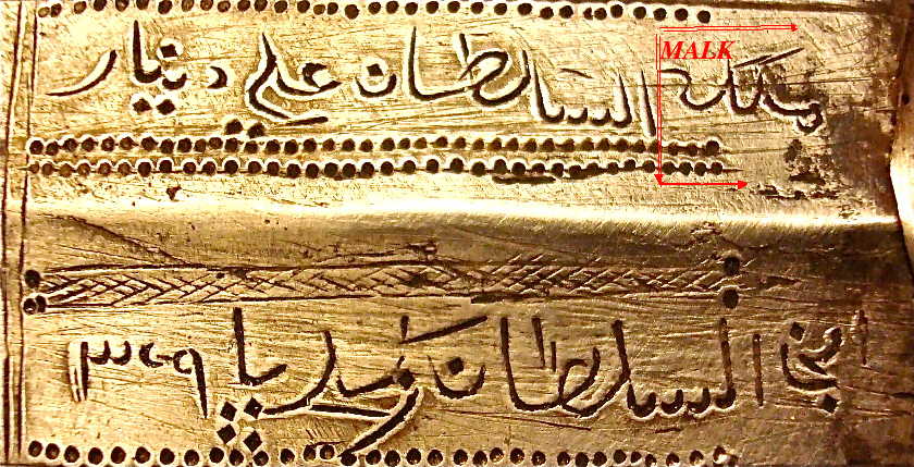

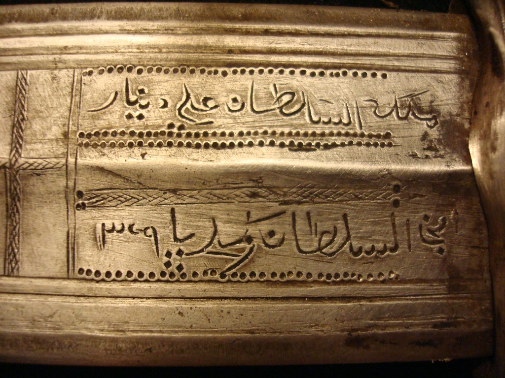

This is indeed a kaskara from Darfur, and likely of the period of Ali Dinar (Ali Dinar Zakariyya Muhammed al Fadl, 1856-1916). Actually the kaskaras with this hilt form with discoid pommel with filagree edges, domed pommel cap and silver repousse grip with 'harlequin' or diamond pattern motif are quite well established during Ali Dinars reign (1898-1916) and described as such in "Kaskara From Northern Darfur, Sudan" (Graham Reed, JAAS, Vol.XII, #3, March, 1987).
Ali Dinar was of the Keira Dynasty of rulers, and of Tama descent, with that monarchy suspended after the Egyptian conquest in 1874. After the Mahdists defeat at Omdurman in 1898, a de facto state was formed in Darfur with him as the Sultan, and the British appointed him agent for them. Ali Dinar was however of the Senussi Brotherhood, who was powerfully in league with the Ottomans and Germans and Turkish governors in Benghazi. As WWI came in 1914, the intrigue with Senussi following and the German alliance with the Ottomans naturally led eventually to Ali Dinar being declared outlaw as he led insurgencies against the British.
A British punitive expedition was mounted, with Ali Dinar being killed near Jebel Mara in Central Darfur October 7th, 1916. The only known photograph of Ali Dinar was at his death (attached).
I did research on one of these kaskara attributed also to having come from the armoury of Ali Dinar about 11 years ago. It was of course of the distinct form, the characteristic X on the crossguard, flared quillons, harlequin repousse grip and filagree discoid pommel. There was the usual puff type festoon attached around the pommel base.
In "Introduction to Islamic Arms" by Anthony North, p.30 (fig. 23 B) there is a kaskara attributed to Ali Dinar, which has gold grip in this pattern and the blade is heirloom believed of 18th c. This is also believed to be one of three possible swords which may have been his, and probably the one listed as Victoria & Albert Museum. In checking with Mr. North, he stated the sword was with its owner in Malaysia at that point.
Another of Dinars swords is said to be Royal Armouries Inv. XXVI.112S, and I do not have further notes on that.
The other is at the British Museum (#1932, 10-14.1) but is believed captured at Omdurman and of the Ali Dinar 'style'.
I interviewed a man who was a Fur, and now in the U.S. and actually knew one of Ali Dinars grandsons, but as Dinar had 120 sons, the grandson had little information to add to the research when I spoke to him by phone.
Returning to the Darfur kaskara at hand, the etched devotional panel on the blade is most interesting and it will be great to hear more on translation. I believe the blade on this may more likely be of Italian origin as many of these Darfur blades seem to have been (Reed, fig. L1 notes a possible Italian orig.). This would seem quite likely as the Senussi contacts in the branches in Libya would have had considerable contact with Italian trade with the occupying forces there.
In my opinion, these type kaskaras were widely produced in this period, but in this quality it is of course supposed that these would have been for prominant tribal leaders and chiefs (Omda). It would be presumed that many of these weapons would have carried inscriptions pertaining to Ali Dinar, and would not necessarily be his weapons, but associated with him and his forces. Regardless, these kaskaras are in my opinion the most desirable, especially when they can be attributed to this form and of the period.

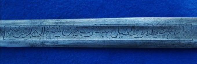

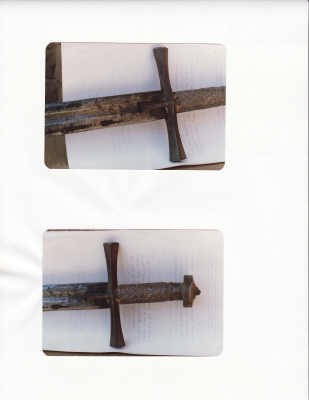

I thought it would be interesting to add this thread to the discussion as the blade on my example was also translated to Sultan Ali Dinar.
http://www.vikingsword.com/vb/showthread.php?t=12979

thank you for the further details . Been trying to find more information on the diamond motif...but so far have 'struck out' .
Hi Rick,
how on earth did I miss the thread you posted ...... I know I've been busy ...but .
Interesting sword ....again a sword seemingly associated with Ali Dinar .............with a diamond motif on the blade ?
Kind Regards David

Im with you David...how the heck did I miss this one!!!!!?????
That is phenomenal Rick, you are one amazing connoisseur (I love trying to spell that word !!!
Incidentally, David, the source on those diamond pattern motif is the one I noted published by Graham Reed in 1987. Ironically, it seems that our own Ed Hunley preempted Mr. Reeds visit to Kassala by three years! as shown in his outstanding treatise (1984)which appears on our site.
Actually that triangular blade form in a shorter sword version as seen here, in my experience has been attributed to Dongola regions in upper Sudan. As always, the inscription is key of course, and these sumptuous mounts are atypical to the hilts I have usually seen on these blades.
When the Anglo-Egyptian government took over in the Sudan in 1899, and Ali Dinar was recognized as the sultan of Darfur, the dar was very much left to its own affairs, but was expected to pay a nominal annual tribute to that government.
The outstanding quality of this sword and the potentially revealing inscription on the blade may indicate this was some sort of diplomatic gift to the sultan during his reign and associated with relations as noted. The incongruent nature of the mounts do suggest some cross cultural custom work, and the Chadic possibilities are well placed. It should also be noted that the Teda which are a Toubou tribal group in N. Chad (as well as Niger and Nigeria) also were well situated in Libya. As mentioned earlier, considerable Senussi (which Ali Dinar was profoundly an adherent) presence was situated in Libya.
While unclear how these elements might account for this somewhat hybrid sword, they seemed worthy of note.

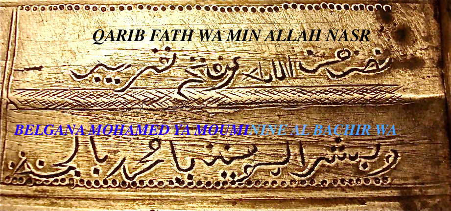

at least ... here we are
we got it
sorry for delay, but we found who wrote that poem, and we offer you not a translation, because ... how to translate a poetic spirit ... ?? ....
but what could be the sense of the verses
"the seat of the rider on the back of his horse is stable,
without regard to the fury and cries of his enemies,
and he did not need to be fastened"
the writter; El Iman Al Busiri,
born ° 620 Hegir,
he is accepted to be an Egyptian from Upper Egypt with Berber origins (Morocco),
he was in charge for a mosquee (title of "Iman")
ref according with: http://en.wikipedia.org/wiki/Qa%E1%B...%ABda_al-Burda
à +
Dom

Dom: Thank you very much for that translation. It does differ slightly from
what we were told originally, but the gist of the meaning was similar. Has
anyone had any luck with the other inscription........Dave.
not a genealogy as I read it, just his name according with Arabic I.D. record

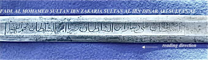

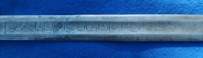

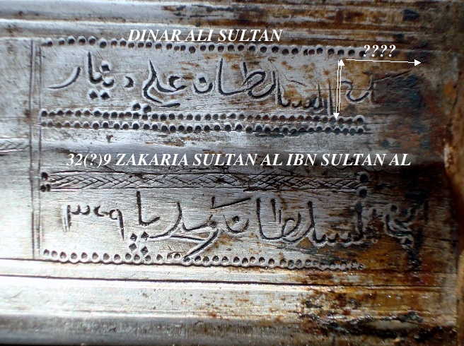

name (Mohamed al Fadl) + father name (Zakaria) + Grand-father name (Ali Dinar)
this way of recording the people is still yet applicable in almost of Middle-East countries, indeed Egypt or Sudan
the obverse of the poem gives
the Sultan Ali Dinar son of Sultan Zakaria son of Sultan Mohamed al-Fadl
the second pic,
1st lign, beginning word unknown, then
Sultan Ali Dinar
2nd lign
the Sultan son of the Sultan Zakariya
Darfur

see also this link
http://www.sothebys.com/app/live/lot...sp?lot_id=PXT2
the matter is .... sale for "A silver-mounted sword of Sultan Ali Dinar"
[group of swords, numbering less than ten recorded examples, which were made for the Sultan himself.
They have been described as 'the last truly distinctive commissions of Islamic edged weapons' (Paris 1988, p.147)]
question ... ??? yours, ist's one of the tenth ???

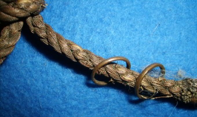

Dom: Again, thank you very much for your work in translating these inscrip-
tions. I wonder if there would be any information in any books on Islamic
arms regarding the two pieces of chain mail on the tassels. The man that
did the first translations had said that these represented to recent births
in the owners family. There's never been anything iv'e ever read that refers
to a practice like this. Has anyone ever heard of this..........Dave.

This is becoming a most interesting thread and thank you Dom for the translation assistance. I also appreciate the kind words from Jim and Gene. I was definitely surprised in my other thread when you guys didn't jump in! Hey, better late than never.
Dom, here are some pictures that are much clearer that I am hoping you can translate in full detail and I have also included an inscription from the handle that I hope you can make out.
It would be great to add these two swords to the reference material as possible swords of Sultan Ali Dinar.
Yeessss
and will be a good (a very good) news
just time to translate the Quran verses, and you will get it

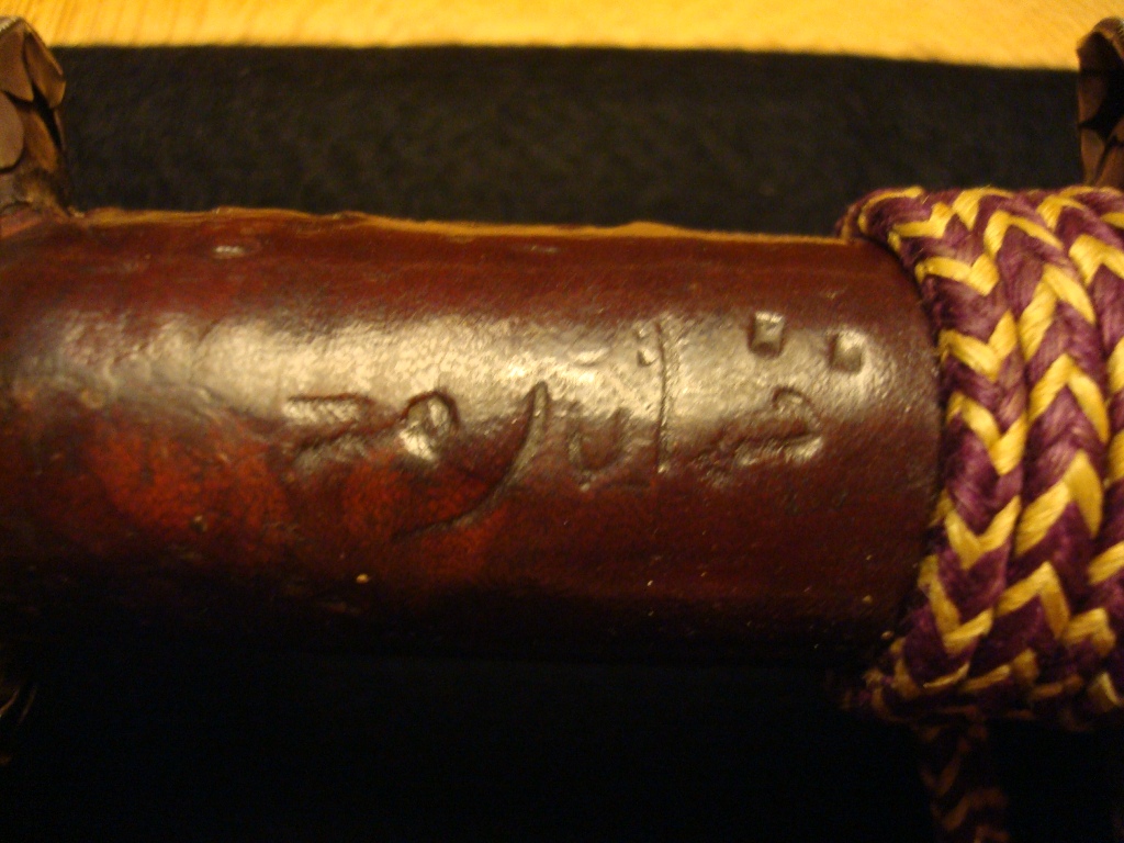

might you clarify a point, pls
- which handle ?? spear ? sword ?
because we reach a translation,
but not sure that it's matching with the concerned item,
specially, if we don't have idea about it
à +
Dom

Hi Dom,
Thank you for the translation assistance. All the pictures I provided in this thread are of the sword that was discussed in this thread
The last picture I show is of the leather portion of the handle of this sword.
Thank you.

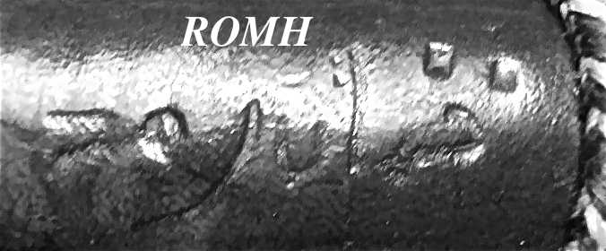

sorry, I zap completely your first request
and I'm discovering some very interesting posts, in fact I just completed what has been told, or wrote
here good news (but in fact you know it already, our Koweity friend translated correctly)
the unknown word for me, is in fact
MALK either in English OWNER or OWNED BY
in the very likely case that the mention is original, your sword is clearly identified "mabrouk" as we said in Arabic
concerning the mentions religious, here the transcription
NASR ALLAH MIN WA FATH QARIB either BY THE GRACE OF GOD, VICTORY IS NEAR
WA BACHIR AL MOUMININE YA MOHAMED BELGANA either (God requested to) MOHAMED (to annonce) THE BELIEVERS BE GLADDEN, THEY WILL GO TO PARADISE
now, what is a question mark for us ... the mention on the handle leather
ROMH either JAVELIN
end of the exercise
