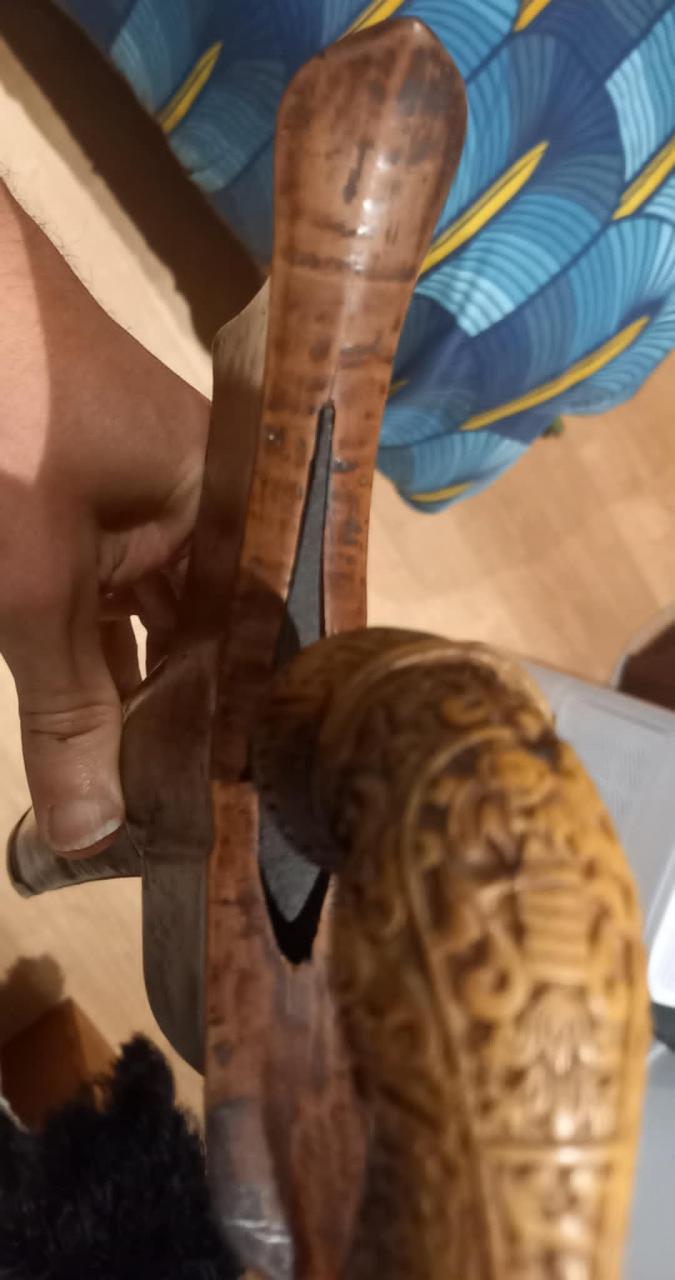

Nice keris. Could you make a photo of the blade in the sheath looking down from the top so that we can see the fit? Thanks!
Old 19th October 2025, 08:37 AM   #3
Posts: 6,378
A picture looking down on the blade inserted in the wrongko would be very helpful.

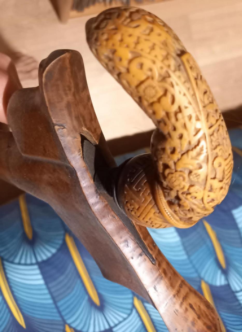

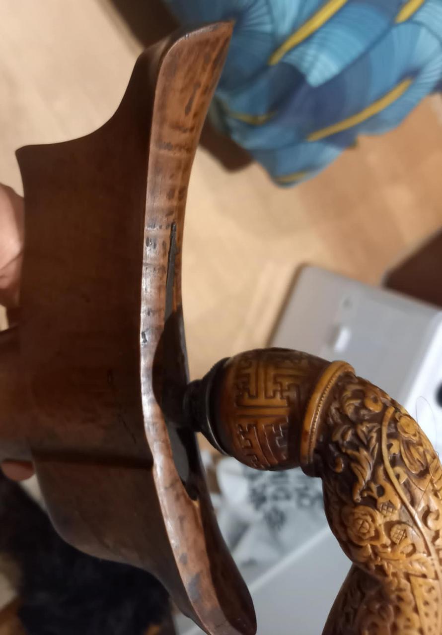

Here are photos of the blade in its sheath.
Old 21st October 2025, 11:49 PM   #12
Posts: 7,124
The form of the sirah cecak & the buntut urang is not typical of a keris that can be classified as Bugis, however, it is typical of a keris that can be classified as East Jawa or Madura.
If the blade does indeed carry flat faces, then we would need to consider the possibility of a gonjo replacement at some time in the (probably distant) past.

I checked, one side of the blade is very flat, the other is very slightly lenticular.
The blade seems a little thinner than more traditional Bugis blades with a hexagonal cross-section.
Old 23rd October 2025, 03:23 AM   #14
Posts: 7,124
That hex cross section is what I mean when I refer to "flat faces".
Does the blade have a hex cross section?
Old 24th October 2025, 01:11 AM   #15
Athanase
Athanase's Avatar
Join Date: Mar 2016
Location: Paris (France)
Posts: 432
I compared with Bugis keris and Javanese keris and... it's not so obvious, but it's closer to a hexagonal section, but the angle between the flat surface and the cutting edge seems to have been worn so it's not very sharp anymore (Too violent cleaning of the blade in the past?).
