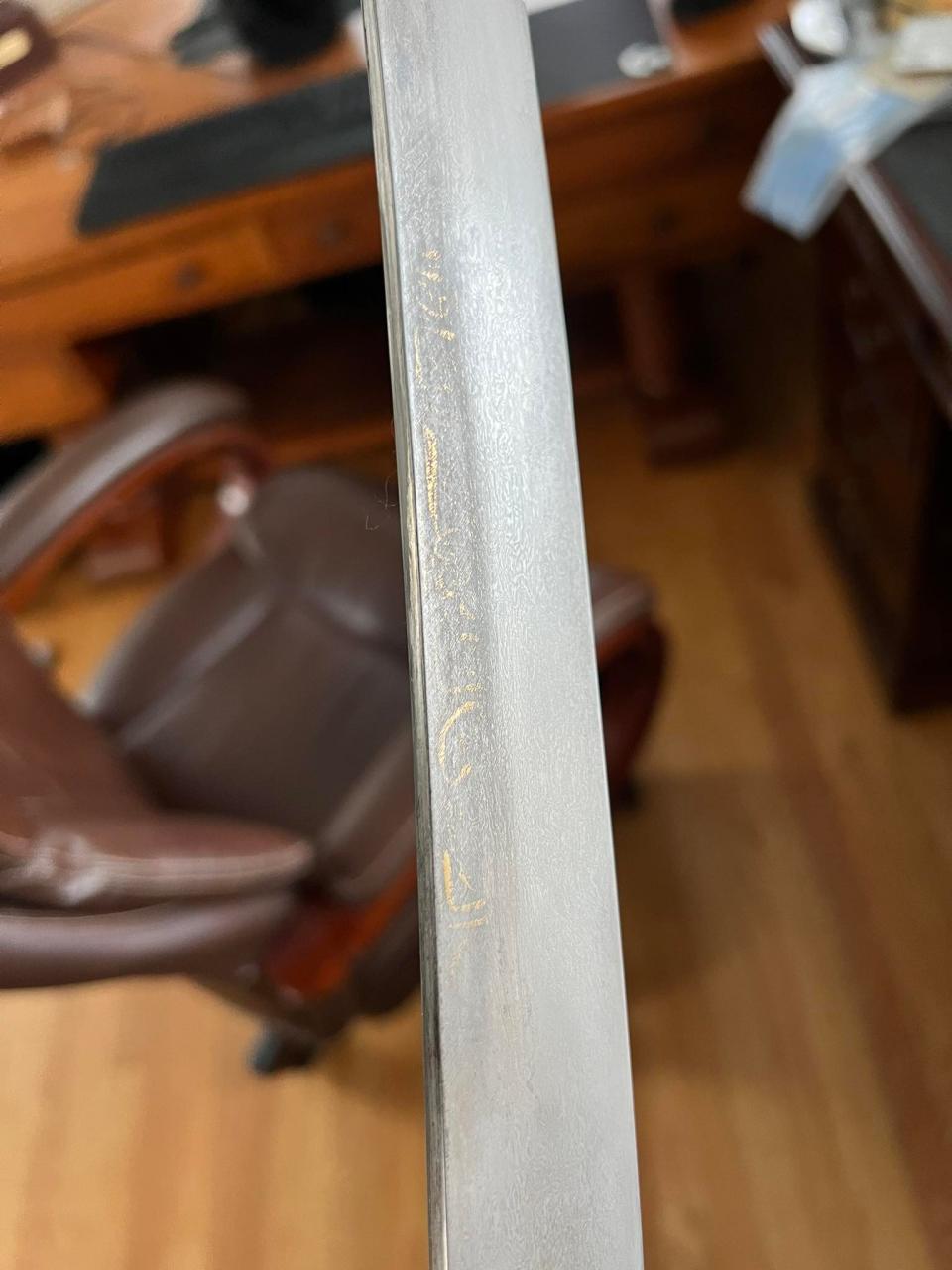

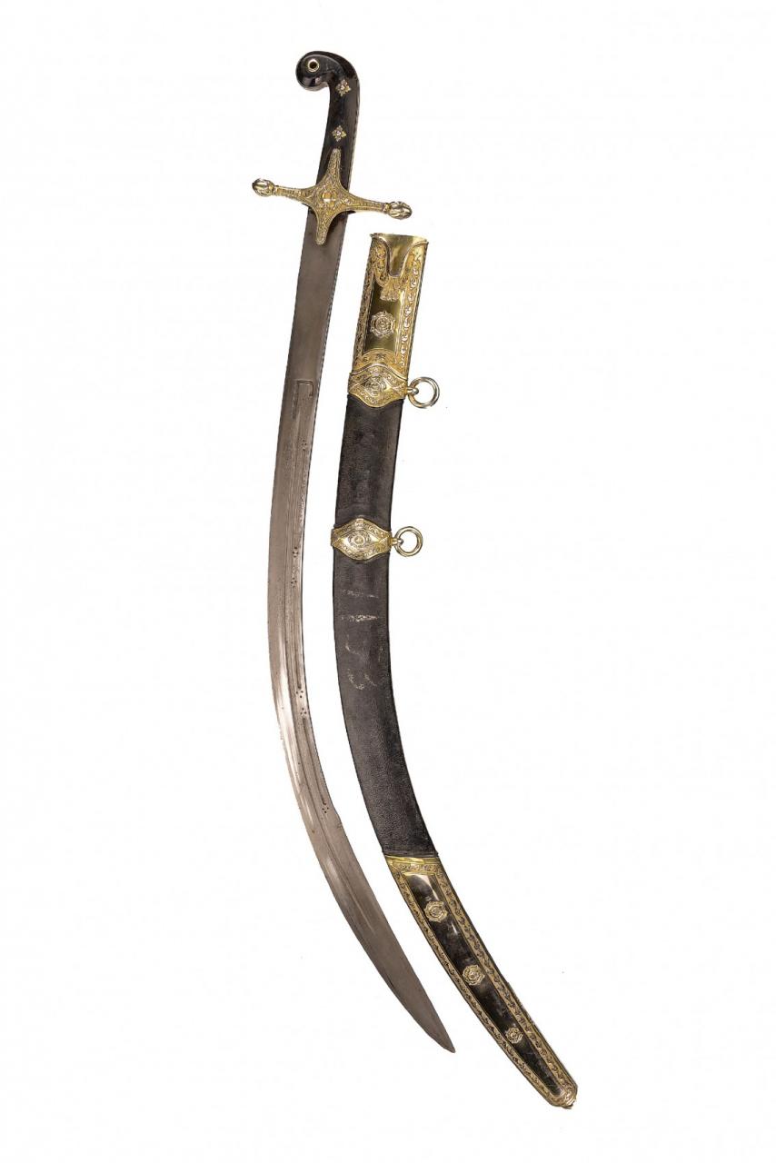

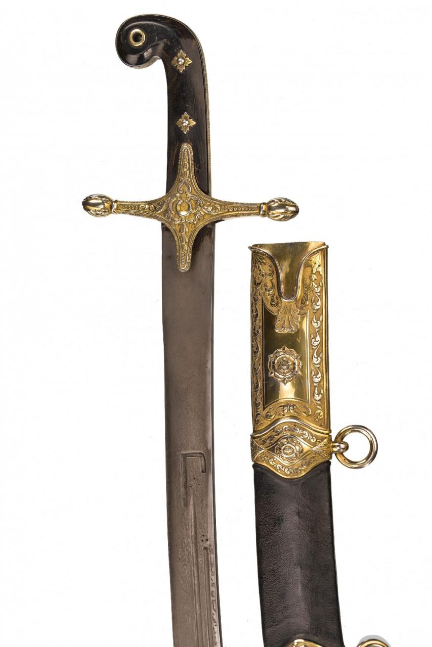

Jim the blade does have traces of gold writing on it, pictured below. The second picture was surely a maker's signature, only a faint piece remains sadly.
Osman is 100% sure it is Ottoman, I trust him on that point he is an expert on Ottoman blades.
As for the velvet, every single mameluke with this style of fittings I can find has velvet on the scabbard.
See Dellar PG 112 fig 12.9/12.10

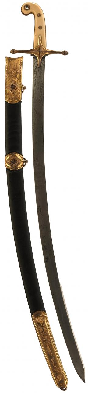

More examples of similar swords:
https://www.michaeldlong.com/product...l-dress-sword/
https://www.pinterest.com/pin/487936940879693718/
There are many 9th lancer's that look almost the same, hard to differentiate if its the same sword being sold over and over again.
https://bid.antonycribb.com/m/lot-de...F29%3Fpage%3D9
Take note of the fittings on the previous swords and my sword, they're very similar. It's impossible to prove that it is for sure a Lancer's sword but much in the same of "stolen valor" in today's garb I doubt another officer would copy the lancer's style.
A non lancers mameluke with velvet
As for leather I actually don't see many with leather, the vast majority are completely metal sheaths. The lancers generally seem to have velvet, but I still think the fittings point to likely a lancer's sword.
On the auction description Anthony Cribb points to a sword in Dellar pg 109 figure 12.2 as a similar sword. This one also has leather, an early make 1807-10 for an officer of the 22nd light dragoons. It is also entirely possible this is a pre 1822 regulation sword, hence the differences.

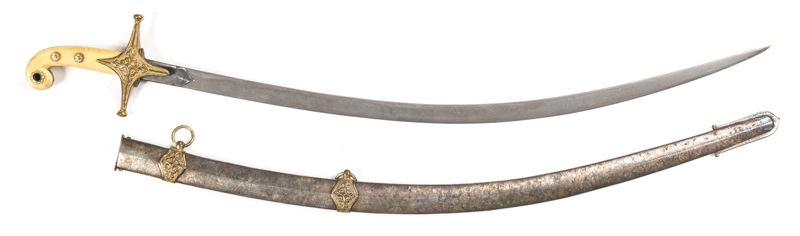

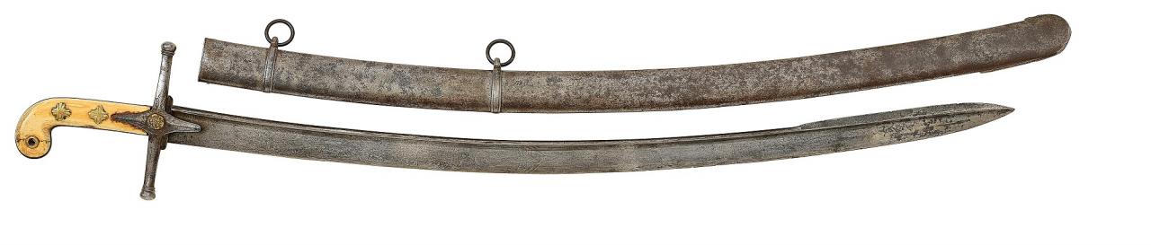

Here is another example with a Persian? wootz blade, silver gilt mounts and leather scabbard.
Cheers,
Bryce

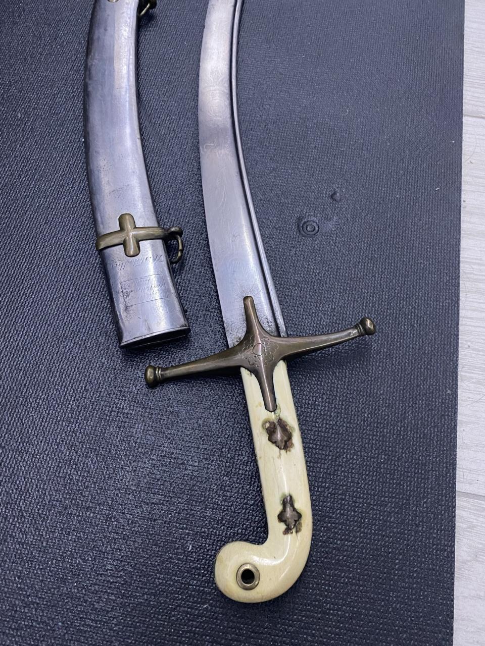

Here is a Infantry Officer Mameluke 1815-1817 thats how long the furbisher was around for so its easy to date.

G'day Calien,
I am very interested in early British pipe-backs. What more can you tell us about your sword? Who made it and who owned it?

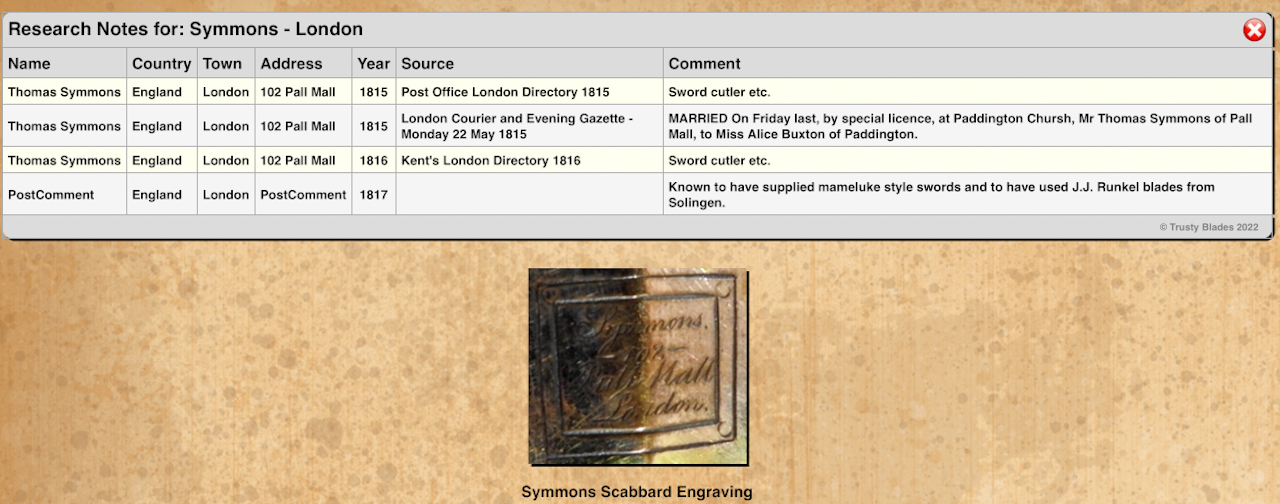

Old 6th February 2022, 07:13 PM   #56
Calien
Join Date: Feb 2020
Posts: 38
Originally Posted by Bryce View Post
G'day Calien,
Cheers,
Bryce
oh yeah sure, it was made by T Symmons out of London he was a sword cutler but was only active from 1815-1816. The sword belonged to a Hubert Tiballier, the son of Francois Huber de Tiballiert a French Colonel who was put in charge of taking Haiti back after the slave revolt, he failed and was on route to France to face trial (and probably the guillotine) when the ship was intercepted by the British and he was taken back to London where he professed his undying loyalty to the Bourbons(LOL). Two of his sons ended up joining the war against Napoleon one with the French Hunters on foot and the one that owned this saber with the 60th and then the 35th. The 35th was actually at waterloo (although it didnt see combat) but Hubert was not on the rolls so maybe he joined the 35th after.
Calien is offline   Reply With Quote
Old 6th February 2022, 11:38 PM   #57
Bryce
Bryce's Avatar
Join Date: Aug 2017
Posts: 201

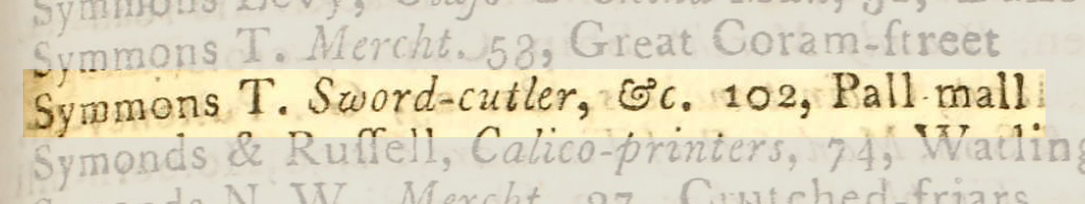

Thanks Calien,
Where did you find the information about Symmons? I have had a bit of a look for him, and have found a merchant and a brass founder, but neither at this address?
Cheers,
Bryce
Old 7th February 2022, 12:09 AM   #58
Calien
Join Date: Feb 2020
Posts: 38
I got a lot of info from a friend on Facebook, he runs Natural Acuity and has a ton of resources for British makers.

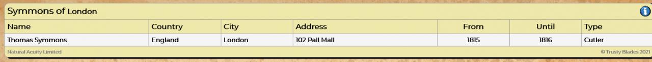

Old 7th February 2022, 12:21 AM   #59
Radboud
Join Date: Sep 2021
Location: New Zealand
Posts: 303
Steve Langham’s database is an invaluable resource and can be found here:
https://naturalacuity.com/SwordSearc...d-02f606c626ed
If you click on the i button it brings you to the sources Steve has for his entry One observation though, Steve only lists dates he has a period source for, so in this instance, if T Symmons was using blades supplied by J J Runkel then he must have been operating before 1808 when Runkel ceased importing from Solingen.
Old 7th February 2022, 02:56 AM   #60
Bryce
Bryce's Avatar
Join Date: Aug 2017
Posts: 201
Thanks guys,
He isn't in the 1814 London PO Directory or the 1816 PO Directory. It suggests he may only have been in business between October 1814 and October 1815. I wonder where the comment about Runkel blades came from?
Is there anything distinguishing in the blade decoration or is it just generic?
Cheers,
Bryce
