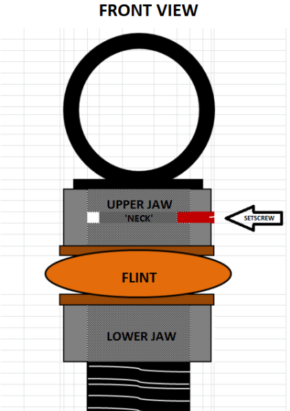

I disagree with you. The screw scree (flint screw) is in the same position, putting pressure on the upper jaw, whatever the extent of the stone (flint), and therefore the threaded hole for the "set screw" should be facing the channel (channel) pedrero screw (flint screw)
Affectionately, and despite the difficulties of translation, Fernando K

Ahora que estoy revisando todo, veo que en el arma del post numero 13, con el tornillo pedrero (flint screw) fuera de la mandibula superior, se vé claramente el canal (channel). La función del "set screw", sería la de mantener indisolublemente unidos el tornillo pedrero (flint screw) a la mandibula superior, cualquiera sean las vueltas que se de a aquel.
Afectuosamente. Fernando

Now I'm reviewing everything, I see the weapon of post number 13, with screw scree (flint screw) outside the upper jaw, it is clear the channel (channel). The function of the "set screw", would be to keep the screw pedrero inextricably linked (flint screw) to the upper jaw, whatever turns you on to that.
Affectionately. Fernando

Caramba Fernando, ahora te entiendo .
Now i get it
I realized the set(screw) was in a lower position, in order to lock the flint screw thread, with the purpose to prevent it to get loose and allow the flint to fall off.
Now i see that the (set)screw is in a higher position and penetrates into the flint screw 'neck', in a way that the this may rotate but doesn't fall off the jaw. I guess the reason why this is a (set)screw and not a fix pin is that, in this case, you may loosen the (set) screw and dismount the flint screw for maintainance or replacement, when its thread is worn.
I hope this is understandable ... both post text and attached drawing .

Yes, Fernando. Both completely understandable
