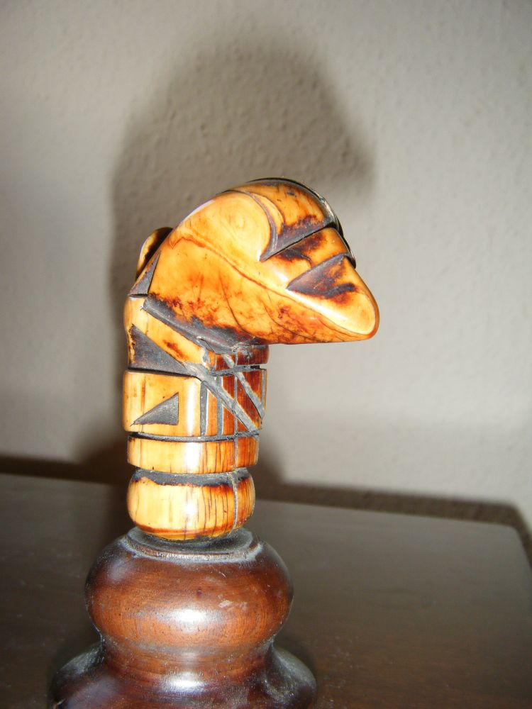

Default #1
Here some of my Jawa Demam handles. Please excuse the not best quality of the pictures and the dust.
The first handle is from ivory and my guess is that it is a North Sumatra handle, maybe Gayo.

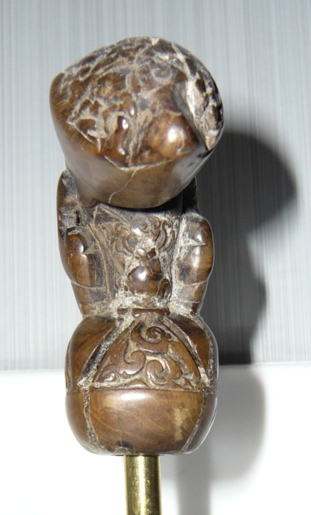

Default #3
An old ivory ornamental Palembang hilt.

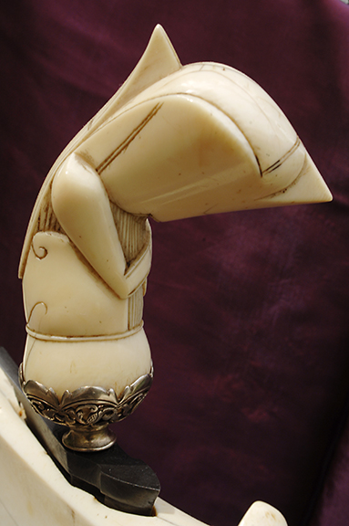

Default #4
A big ivory hilt with a hole in the head, maybe for a jimat stone.

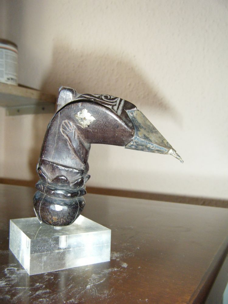

Old 9th May 2009, 02:14 PM   #17
Default #5
A wooden hilt from the nort cost from Sumatra with metal nose and eyes.

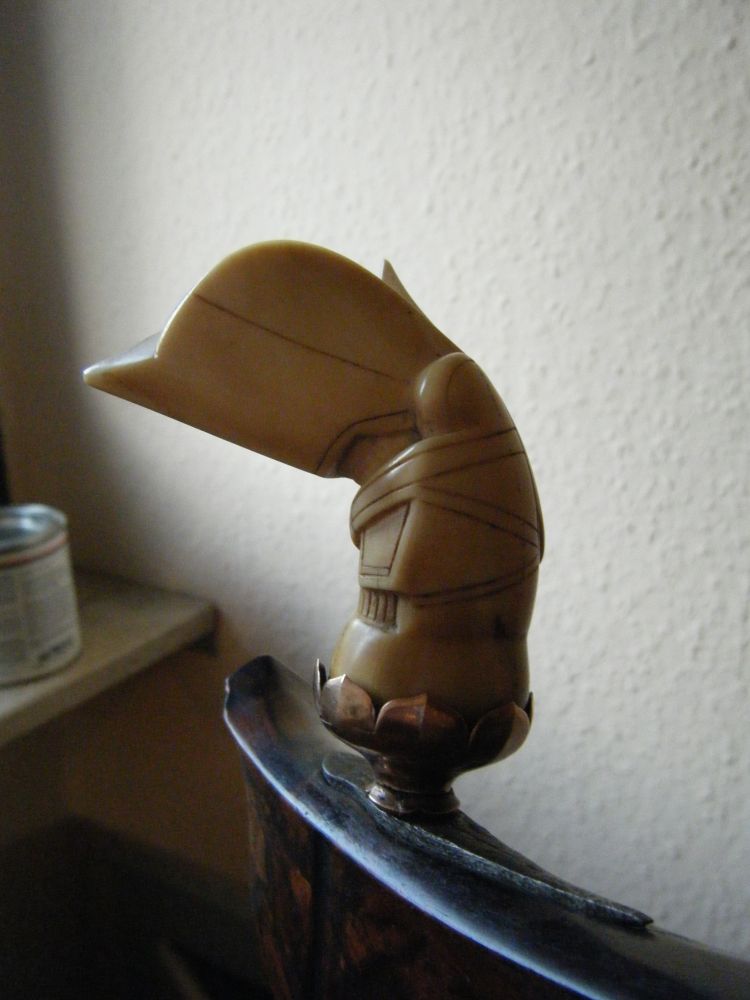

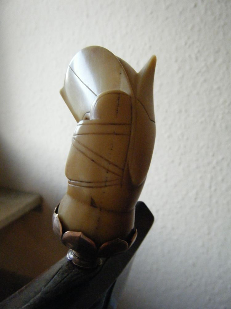

Old 9th May 2009, 05:56 PM   #20
Posts: 7,297
Hi Sajen. Thanks for the examples (and everyone else as well ) I have an ivory one that is sort of similar to yours so i made some quick shots for comparison.
Beautiful piece, it would be nice to see the blade, though. Looks like a malela or carita blade.
Yes, agree with Alam, beautiful handle. Is it also from Hippo? Will be nice to see the complete keris.

Old 10th May 2009, 02:49 PM   #23
Posts: 7,297
Thanks for the comments guys. I would rather not side track this conversation with blades. Let's keep the discussion focussed on hilt forms.
Sajen, i must admit that i just don't know the ivory source.I can usually recognize marine ivory, but i am afraid that distinguishing between hippo and elephant is not something i am very good at. I was going to ask you how you knew yours was hippo.
