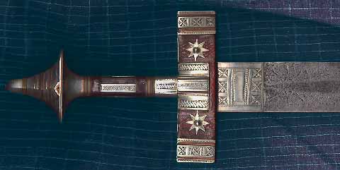

 An unusually luxurious takouba hilt mounted in silver with contrasting copper trim reportedly characteristic of work from Agadez, Niger. The condition of the leather and silver work on the hilt and scabbard (not shown) suggests that it is very recent work. As the blade shows evidence of age and use, it has likely been remounted.

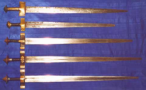

 A group of more typical takoubas; the two above [A] [B] being of the "southern" type and the three below [C] [D] [E] of the "central" type. Detailed zoom views of each sword may be viewed by clicking over the appropriate part of this image, or the numbers in brackets.
Briggs (1965) describes two forms of hilt: a "southern" form having a wide guard covered in brass and a thick pommel with a rounded upper contour (as in the upper two swords above) and a "central" type having a leather covered guard and a flat pommel with a stacked pyramidal tip made up of alternating brass and copper (as in the lower three swords above). A representative scabbard is shown and described with the details on the bottom sword [E] above.
