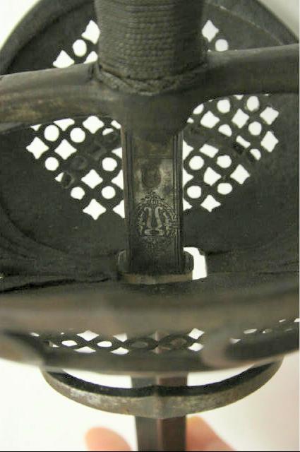

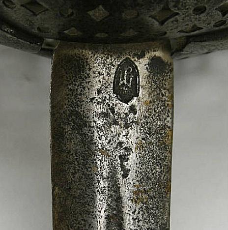

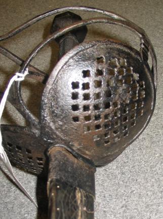

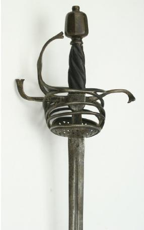

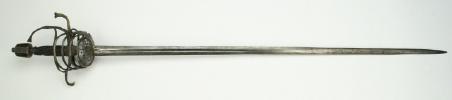

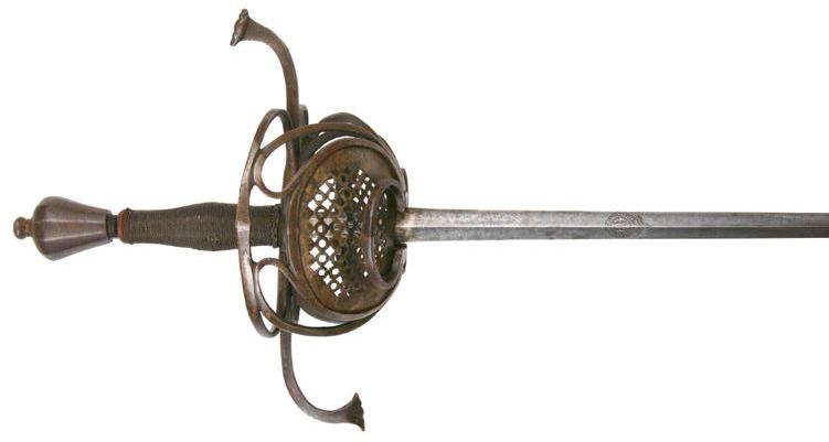

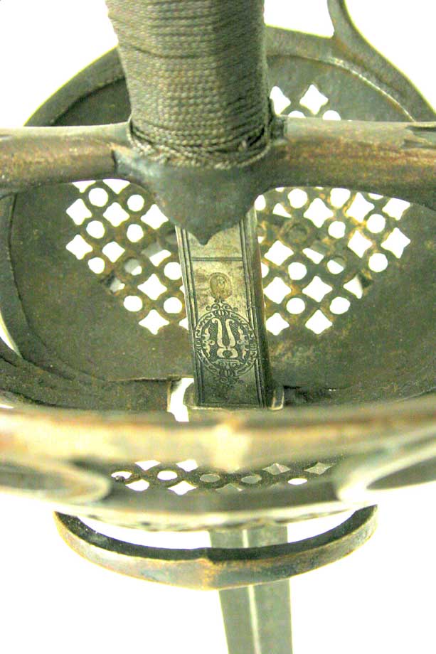

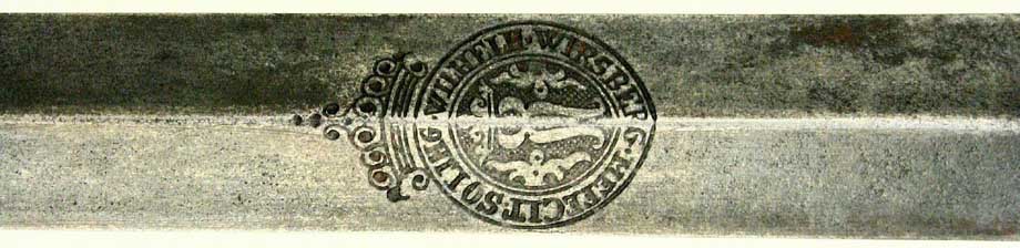

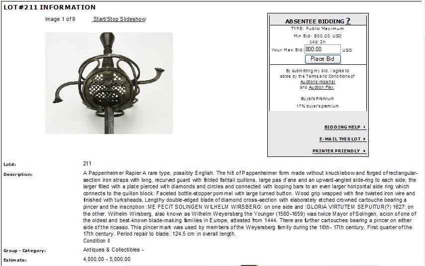

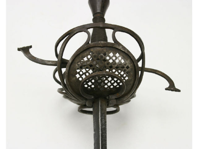

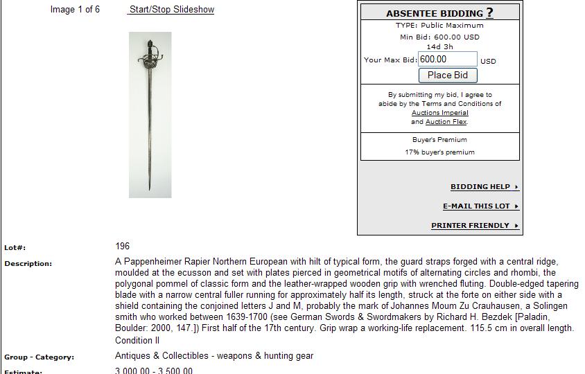

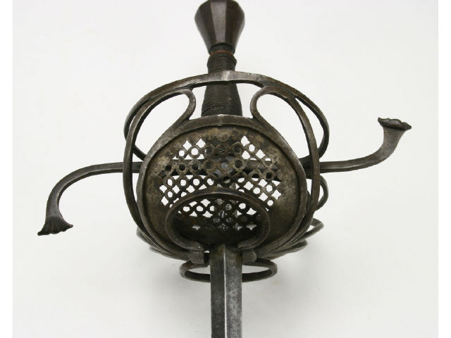

This one was sold at Auctions Imperial one year ago. Although it was described as 'English' it was actually a German piece, the blade dated 1627. The only trouble was that the blade seemed to have been repaired in its working time.
The blade was inscribed by its maker:
ME FECIT SOLINGEN WILHELM WIRSBERG.
Michael

The rest.

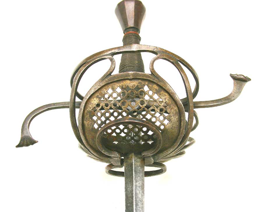

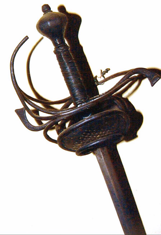

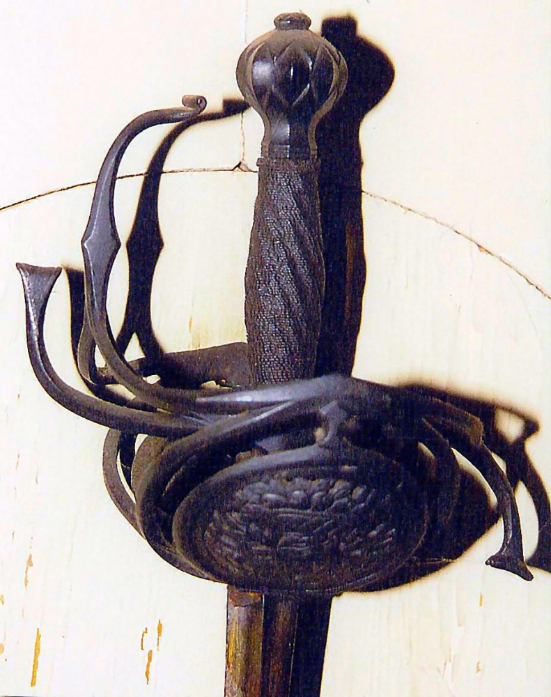

The next one was also sold at Auctions Imperial, March 15, 2008.
Michael

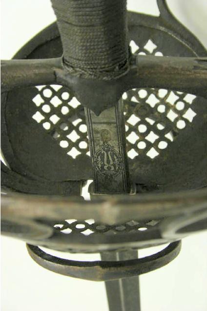

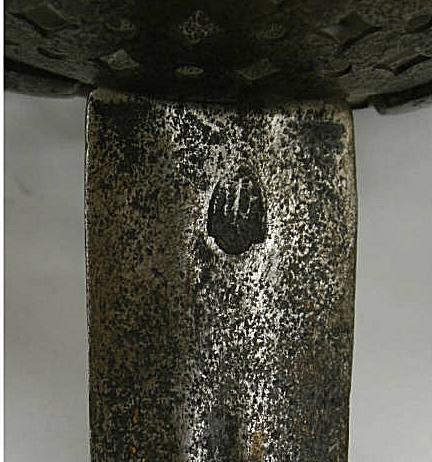

And an absolutely fine and important piece retaining its original sheath, sold Bonhams, ex-Visser Collection, in 2007, to a friend of mine.
Michael

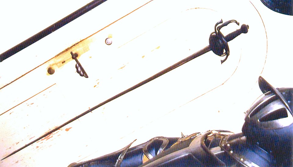

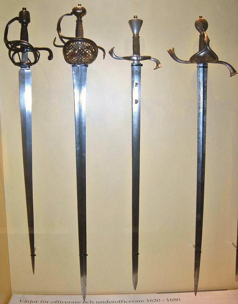

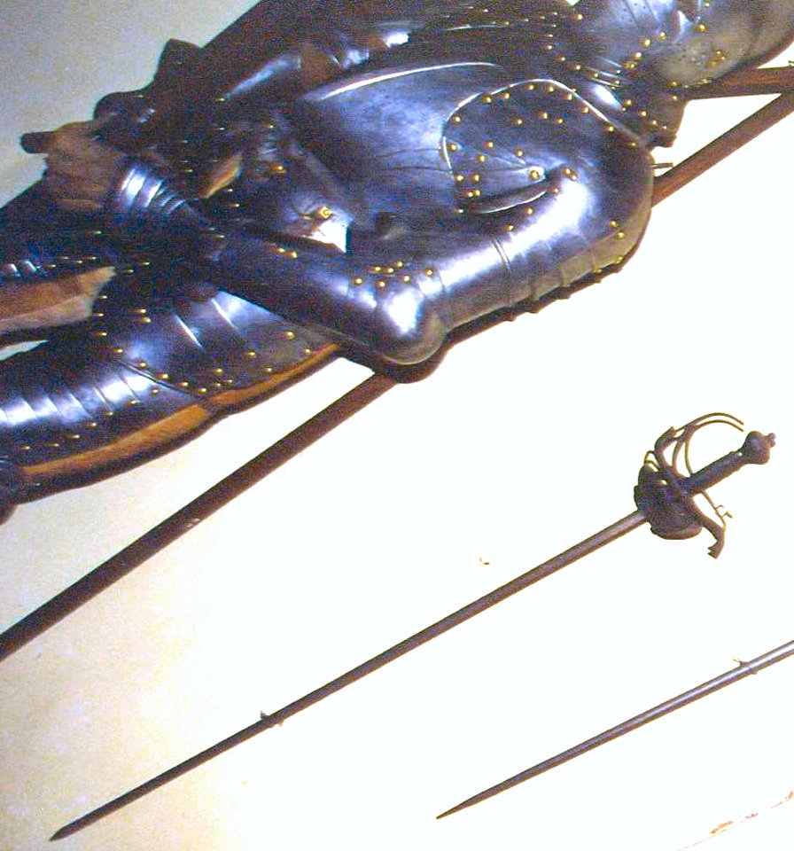

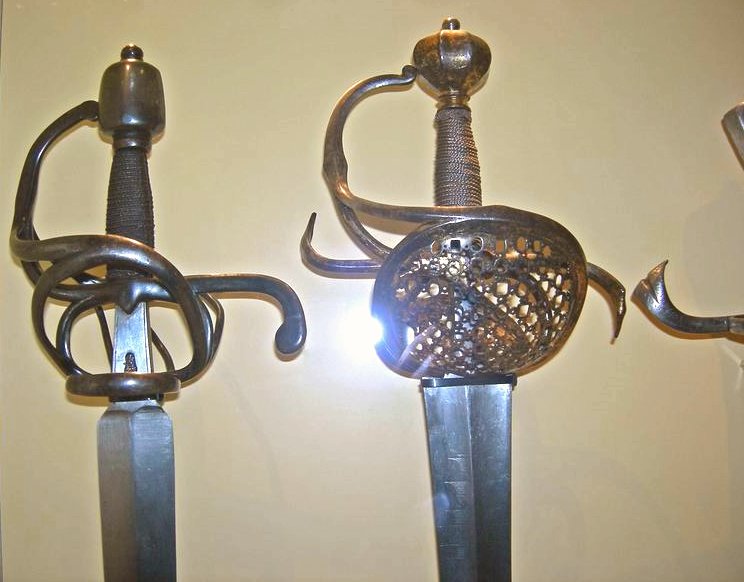

Default A Variant Pappenheimer Rapier at the Army Museum Stockholm
I owe two photos to kisak - thanks a lot, kisak!
Michael

What is the first sword from the left?
Muenchnen town watch?
Old 5th May 2009, 06:09 AM   #7

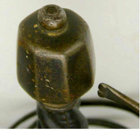

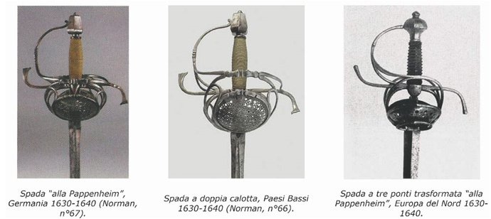

I have been interested in why the first example shown in this thread was identified as possibly English, so I spent some time tonight checking into this.
While this example is obviously German, and does correspond with the hilt example found in "The Rapier and Small Sword 1460-1820" , A.V.B.Norman, 1980, #67. The pommel also is similar to #64 ( Norman, p.268) described as the type typically found on these 'Pappenheimers'.

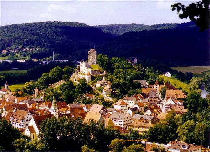

May I add that Pappenheim is a small country town in Central Franconia (part of Bavaria), with the Schloss of the Pappenheim family still there.
According to the sign in the museum, it's a "värja" (sword/rapier) ca 1600, "of a type used by Pappenheim's cavalry in the Thirty Years War".

Actually Schloss Pappenheim, situated in the romantic Altmühl valley near Eichstätt, is partly open to the public but does not have a museum, at least no weapons. I was there once, on the occasion of a Thirty Years War reenactment about 15 years ago.
http://www.altmuehltal.de/pappenheim/pappenheim.htm

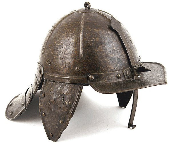

Default Pappenheim and Lobster Tail Helmets

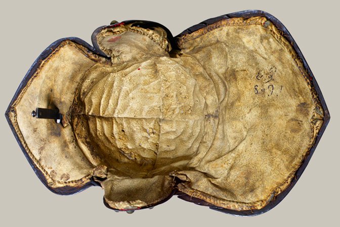

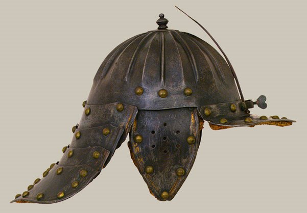

It seems interesting how much influence there was between the Continent and England, and it seems that during the English Civil Wars there was a great deal of equipment besides obviously the swords, used by the forces involved. If I am not mistaken, the 'lobster tail' helmets were of Continental influence, and I believe a number of them were German.
Exactly as ever, Jim,

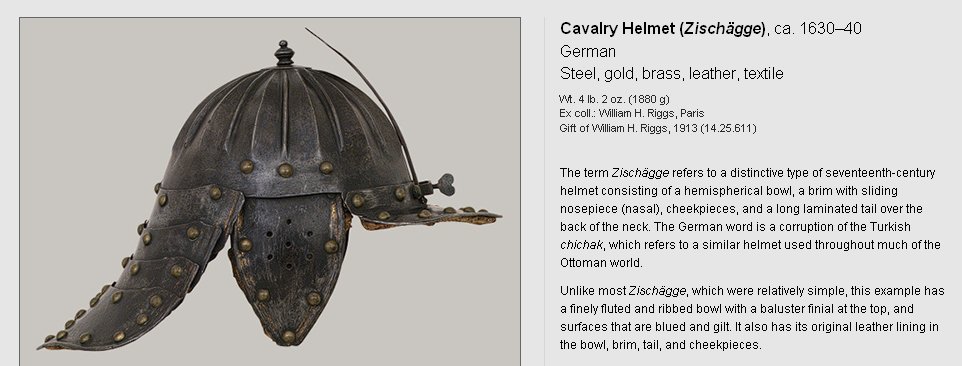

A great number of Thirty Years War lobster tail helmets were German indeed although they seem to have originated from the Oriental part of the world and are also often connected with the Polish cavalry.
I attach two details of a German lobster tail helmet (Zischägge) from the Met collections and another sold at a previous Christie's sale.

Furthermore I attach a few views of the town and old castle of Pappenheim, plus two of the Pappenheimer rapiers illustrated by Norman and quoted by you.

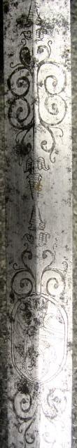

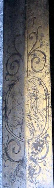

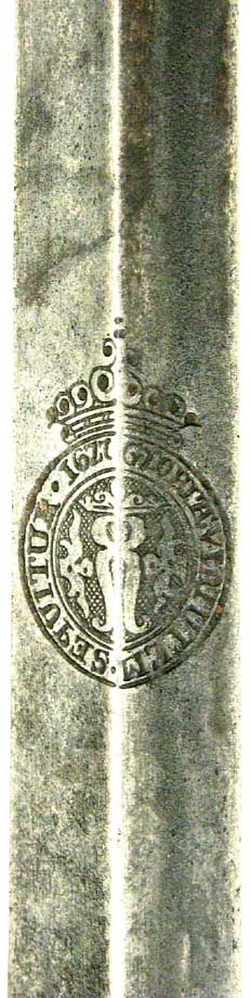

I just seem to have discovered what may be a small sensation:
It seems as if the above posted Pappenheimer rapier retaining its orginal scabbard, the blade engraved with the portrait of a noble man and the Latin inscription Soli Deo (and) Gloria, belonged to a guardsman of Gottfried Heinrich Graf zu Pappenheim (1594-1632). It is now in the collection of a friend of mine.
The portrait on the blade is very similar to the Graf Pappenheim portraits posted.
Anyway, I'll repost them.
Michael

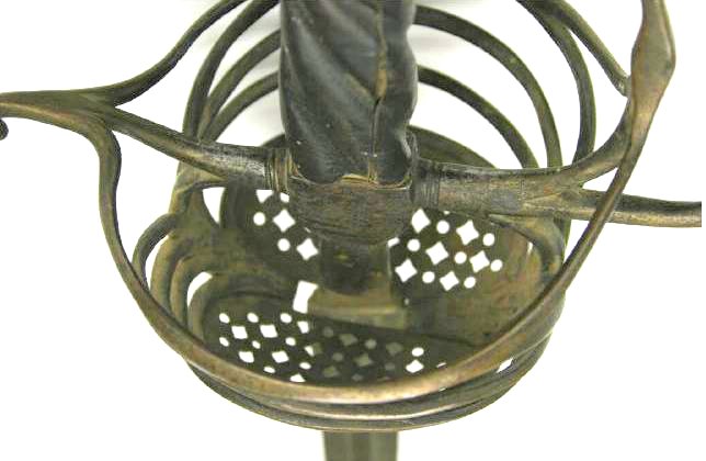

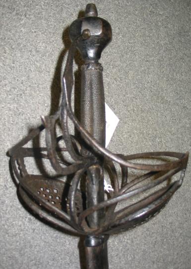

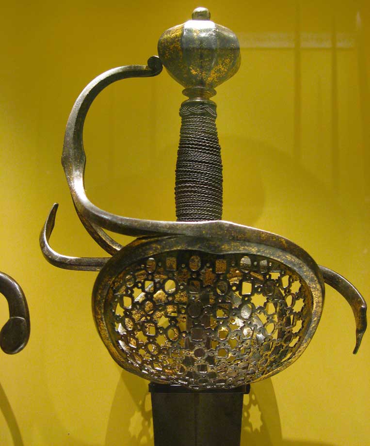

Two Pappenheimer rapiers, ca. 1630, preserved at Schloss Braunfels, Northern Germany.
Author's photos (2005) and copyright.
