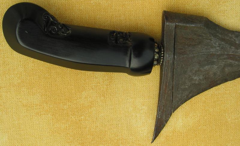

Dear Kerisophiles,
Since we're getting so much valuable input on Keris from Java I'd like to throw in another example. It still keeps amazing me how much can be gleaned from all these Ricikan details. However, I'd really appreciate to get more hints on how to approach Keris with less elaborate Dapur which I happen to like as much as many of the more fancy ones...
Let's start with the plain blade first (I'll add pics of the sheath later). Thanks for your contributions!

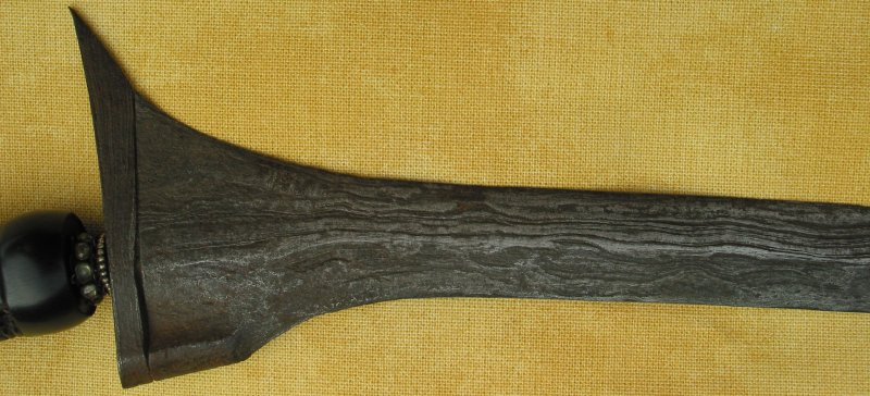

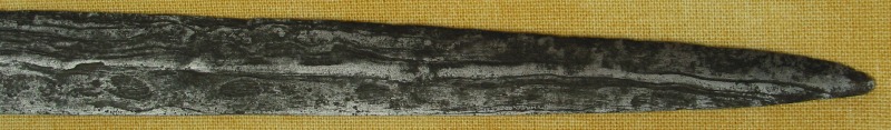

Close-ups from the right side:

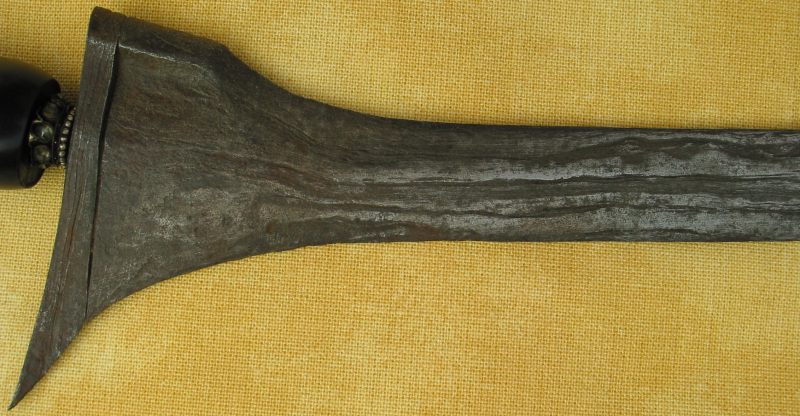

Close-ups from the left side:

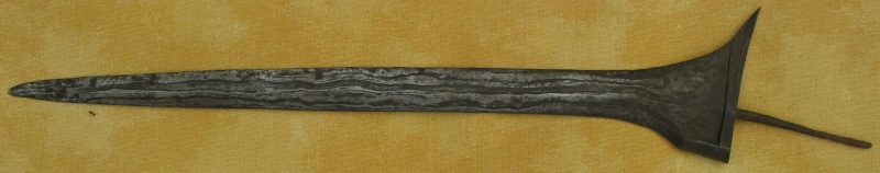

Old 24th June 2005, 02:38 PM   #4
Cool Forgot to add measurements:
47 cm (18.5") total length
42.4 cm (16.7") Keris without sheath
38.5 cm (15.2") and 14.1 cm (5.5") Warangka [sheath] length and width, respectively
34.0 cm (13.4") Wilah + 6.7 cm (2.6") Pesi [blade + tang]
7.64 cm (3") and 2.1 cm (0.8") Ganja and blade width, respectively [the latter measured halfway from the tip]
8.2 cm (3.2") Ukiran [hilt]

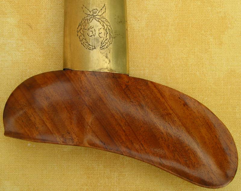

Question Can anybody verify the initials of the former owner?
T.v.E.?
Hello Kai,
Your keris is old and looks so interesting. I think the dapur (shape) is Tilam Upih with pamor (damascan) which called Adeg (vertikal lines). Made in good ironwork, so that why the blade still intact.
The sheath (Jawa = Wrangka) in Gayaman Jogjakarta (Jogja) style made from Kemuning (yellow tree) wood. Also the handle and pendok in Jogja style.
Nice collection.

Kai, it seems unlikely to me that the inscription in the wreath would be oriented this way. It's upside down. The bottom of the wreath should point downwards. This also puts the sheath in the direction in which it is usually viewed. In that direction this might be a number....309 or 319?
So any keris lurus with only these 3 features (Gandik, Pejetan and Tikel Alis) is always dapur Tilam Upih - no exceptions or subcategories? That would suit my simple mind well...

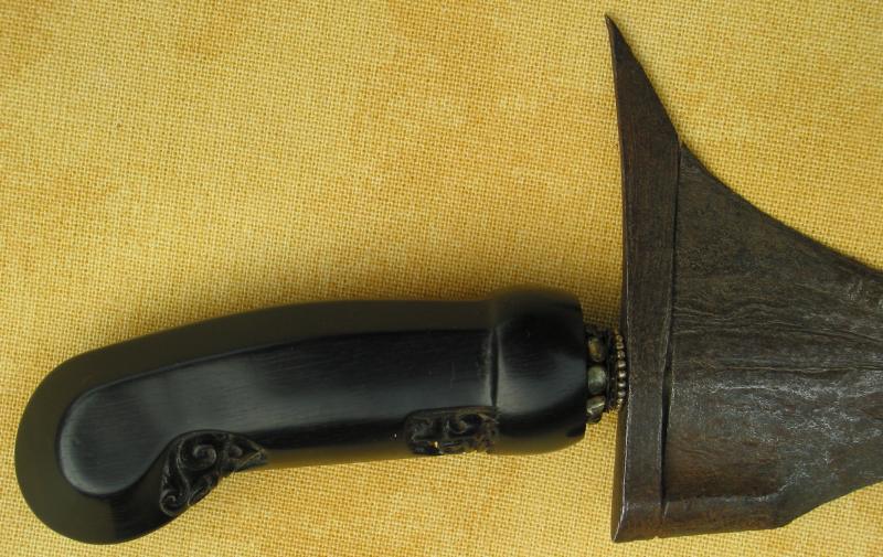

The ukiran still feels nice in my hands (which are not too large) although it is pretty small compared to other handles I have. Is this small size still within the usual range or does it indicate an owner of rather small stature?

Thanks, Nechesh! I should have checked sheaths with decent inscriptions first...
Looks even more illegible this way...
Are there any conventions what might be specified in this place?

Numerology is very common in Java. The number 319 might hold a very personal significance to the original owner, one that we will probably never decipher.
I have found this Djogya hilt form to be generally smaller than it's Solo counterpart, so i don't believe this is due to it being made for a smaller hand size, just the style.
.... So any keris lurus with only these 3 features (Gandik, Pejetan and Tikel Alis) is always dapur Tilam Upih - no exceptions or subcategories? That would suit my simple mind well...
Yes you right, that if the keris has characteristic/feature (Jawa = Ricikan) of Pijetan and Tikel Alis is called Tilam Upih. If the keris has just Pijetan, can be called as Brojol, etc. It all are name of shape (Jawa = Dapur) of keris which each Dapur has the different feature.
About the handle (Jawa = Deder / Ukiran), indeed that all of the ukiran in Jogja style are small size as nechesh wrote.
And the number at pendok in the back side, commonly, Javanese Mranggi shown the day, month and years of the wrangka made. Not just at the old pendok. So, the 309 can be mean that this pendok made at September 30th.
And, about Jogjakarta - Yogyakarta - Djogjakarta, it all same. it just the speeling.
Has anybody gathered data on hilt lengths for Keris Jawa? Any estimates in case of missing data? I'd like to get a feeling for the usual size ranges for the respective styles if possible...

Thanks for your valuable info, Mans!
So determining the dapur of blades with few features is straightforward (I have those charts) and only with more elaborately carved blades do we get those difficulties to determine the correct dapur as often shown in discussions, for example on this board?
Weird to put rather mundane info on such a fairly prominent place. The inscription is also very rough compared to the other engraving (cp. the foliage around it) - I'd expect more consistent quality if done by a specialized artisan... (Even if the pendok were a relatively recent replacement.)
Is there any cultural reason why the day of manufacture would be more important than the year? (Considering the lifespan of a sheath, I'd choose to inscribe the year rather than month/day if there was not enough space for a complete date.)

With more forumites posting on keris Jawa, I'm trying to fish for additional info on this keris...
No tanguh expected from the pics but any opinions or hints welcome! (Feel free to express them via PM if deemed too speculative/etc.) Thanks!
