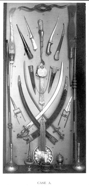

In Indian Art in Marlborough House, case A, Heldley shows one being no 1, and writes it is a present from H.H. the Nizam – so now we have moved to Hyderabad, and not the Hyderabad in Sind. It is not exactly like the first one shown, but very much alike.
