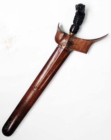

Hello Ganja,
I also think that this hilt is from Madura or North-East Java. I also can show some examples. But this one is very nice and unique.

Originally Posted by Marcokeris
IMO is not from Sumatra but it comes from Madura area (floral style)
At first I thought like you, Marco. But then, confused myself when I notice the 'different' style of the ornaments. Visually different with most maduran ornament...
Originally Posted by kulbuntet
I dont know were its from..but the keris wears a yogja wranka.
Yours is Maduran style, as Marco mentioned, Michel...
