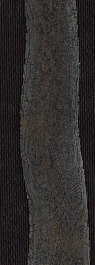

I'm very glad to have found this forum. My name is Lee and I live in Texas.

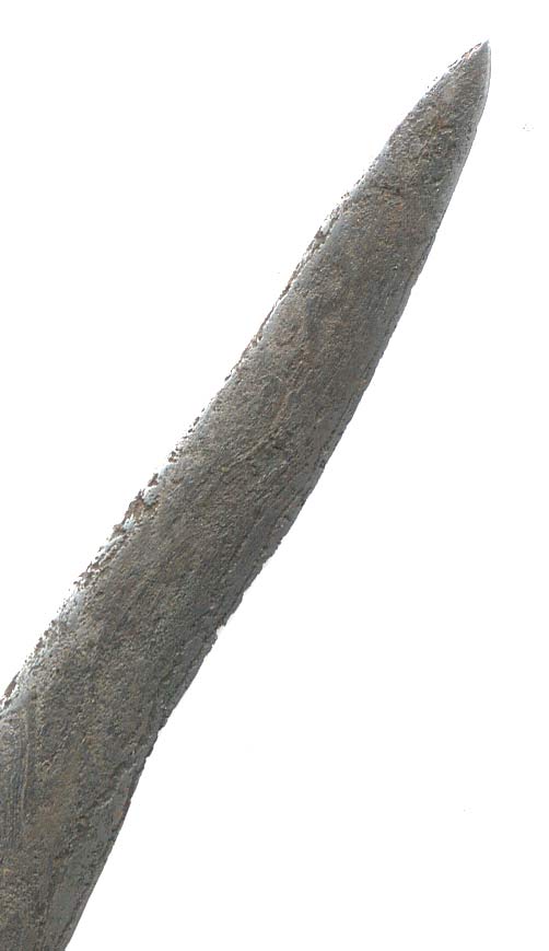

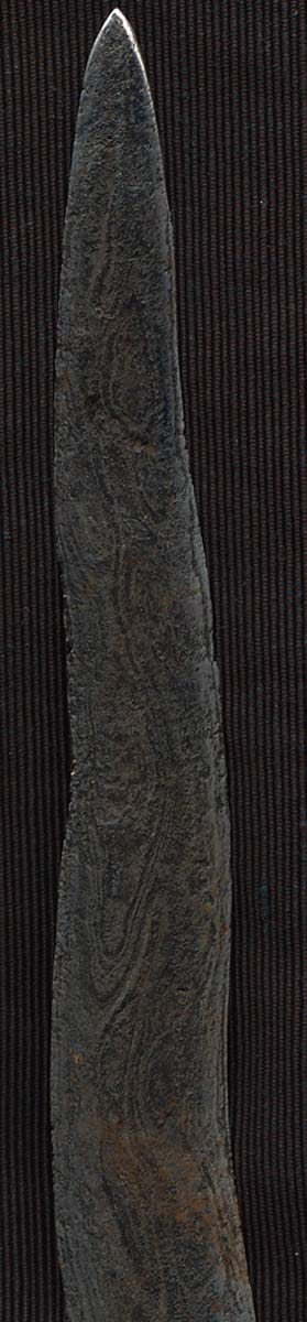

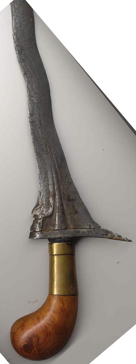

Not long agp I was given this keris as a gift. Unfortunately the sheath was lost some time before I got the knife.
The previous caretaker had been under the impression that it was forged with meteorite iron, which I had thought fanciful until my fiancee found the info on these.Wow, it is possible.
I always try to find out as much as I can on my own, but need more help from experts, whoever is willing.
So far, I have ascertained that it is likely pre-19th Century due to the separate ganja and tang (?).
The balde is 14" long, and the handle is somekind of burl wood
This knife spent a long time in Iceland and was passed down through some generations there. An erroneous notion that it had been forged there was developed along the way, but I'm sure this is native Malaysian.
My questions that remain are:
What kind of Pamor is this, and the esoteric meaning?
Can the presence of metorite iron be determined from the appearance?
Any rough guesses on the date of forging?
On the pamor detail image, I enhanced the contrast to make it more visible.
Any help at all would be appreciated.While Paul page is amazingly informative, I could not determine the pamor from the descriptions.
Thanks!
Last edited by littledirtnap; 30th May 2005 at 05:23 AM. Reason: trying to get other pics to show

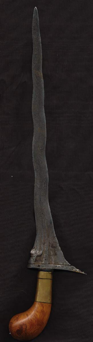

The blade looks more Javanese than Malaysian due to its long slim profile.
The handle is unusual for a keris. The pamor is quite nice but is not clearly visible. First impression, looks like pamor wos wutah variant. The kembang kacang, (on the left side of the blade) is broken.
A full picture of the blade would be nice, so as to determine the dapur.

littledirtnap :This does look like a very old and authentic knife ,but the hilt and blade dont match at all, the hilt looks like a gunong grip from the Philippines.
As to the meteorite question, this is one of those things that got mentioned one time in a book and now everybody thinks all keris are made from meteors.Aside from some testing of the content of the steel I dont think there is any way to tell.I seriously doubt that there are many keris that were actually made from meterites,and by many I mean very ,very ,very few.

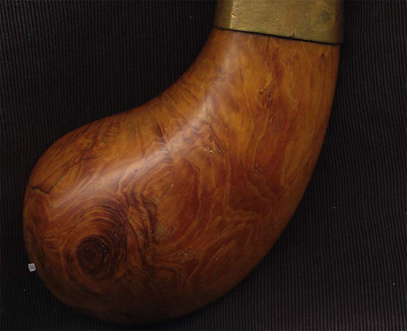

the handle is most likely moro. it's posssible it's made out of banati wood. to be specific a gunong knife handle. there are some recent threads pertaining to gunongs. looks nice, tho...

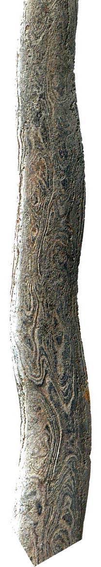

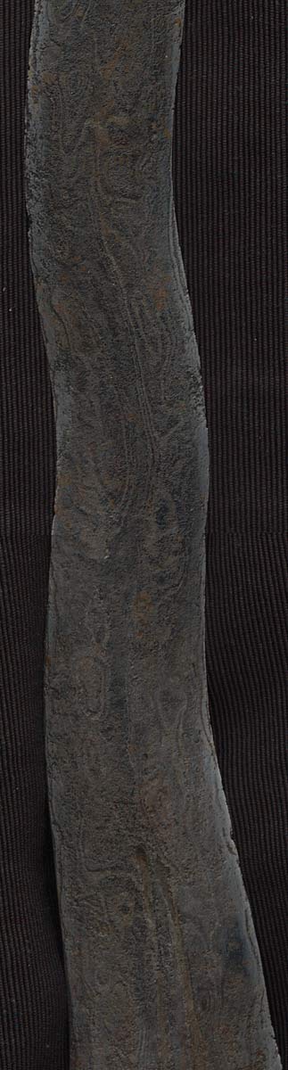

Here is another try at decent images..hope this helps!
I'm dying to know what this pamor means, and the number of waves.I'll also keep reading on my own (thanks for the recommendations)

Sure does look like a Moro gunong handle. It's possible the "assembly" was made in Iceland, but it is worth noting that there is a thick layer of some kind of black substance between blade and hilt, and it sure does look like boiled down pitch. European cutler's pitch I've seen has a "blond" colour. I propose that this is an Indonesian blade traded/stolen/whatever to Moroland and hilted by a Moro?.....

There is no doubt that is a Moro gunong hilt and a nicely figured one .

Well everyone is giving you fairly correct info so i don't have much to add. This looks like an old Javanese keris with pretty good age to it. Unfortunately much of the ricikan (features) have been lost to erosion, probably from extensive washing.
Definitely a Moro gunong hilt, but i'm not sue if i agree with Tom that it was hilted by a Moro only because i think a Moro wouldn't find a blade like this all that useful. It is relatively frail compared to Moro blades and really only effective (this one at least) as a stabber. But then, who knows.
I agree with Rick that your pamor would have a specific "meaning" per se, but rather a more general nature.
Interesting mismatch of hilt and blade. I would suggest you get a "proper" hilt fot it, but then there seems to be some history working here, no matter how muddled, that should probably be preserved.

well, i know it's a 50/50 chance, but at the least whoever attached the gunong hilt on the blade had the knob facing the "right" way...

Good point. Certainly someone had a sense of what they were doing here. Though it seems they used far too much pitch to attach the blade.

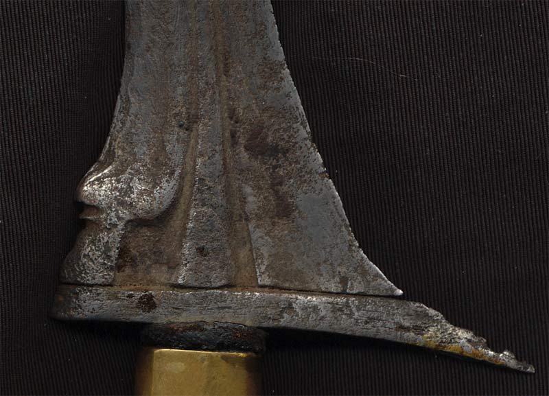

very interesting, 14" blade, "beak" instead of an elephant, the brass work on the ferrule is odd. the keris blade looks very old to me. wonder why the "spacer" between blade & ferrule, you would think the person that re-hilted it would have deepened the hole for the peksi, I would think if someone was going to use it for a weapon, they would have. if this keris did end up in Moroland, it might be Bugis, as the Moro were fond of the bigger keris they produced.

Bill, i'm pretty sure this isn't a "beak" instead of an "elephant trunk", but a case which is very common where there "trunk" has eroded away. The blade doesn't look particularly Bugis to me, the blade is too narrow and the gonjo too long, but then you never know. I believe the "spacer" between the hilt and blade is overflowing pitch.

The blade has 11 gentle luks, with pamor wos wutah or scattered rice variation.
Pamor wos wutah is believed to enhance the owner's material well being.
A proper washing in lime juice would bring back the visibility of the pamor pattern. However, with the hilt secured with thick pitch, it may be difficult to remove the hilt for a normal bath. Alternatively, it could be done with the hilt attached in a vertical position.

....Definitely a Moro gunong hilt, but i'm not sue if i agree with Tom that it was hilted by a Moro only because i think a Moro wouldn't find a blade like this all that useful. It is relatively frail compared to Moro blades and really only effective (this one at least) as a stabber. But then, who knows......
I'm not sure I agree with me, either, especially if that is a leather spacer, which is an European custom. On the other hand, if it is just thick hard pitch resembling leather, as I can envision it doing, I still vote Moro mounting. In contrast to barongs or kris sundang, Moro gunongs often are rather thin-bladed, and though there are also thicker ones, I am not convinced that this relates directly to authenticity/intent to use/etc. So use of the relatively frail k(e)ris blade like this may not be inapropriate. I have seen also dagger sized Moro kris, of pretty Moro looking work etc. but have never read or heard much about them; just that I know there is a tradition of dagger sized kris in Moroland. The only other thing I'd like to add is that I think a deeper understanding of gunong and some pedangs is that they are lower-teir versions of k(e)ris; they could typically be made by any smith (kris and k(e)ris often had laws and traditions restricting this), carried by any person (ditto), used for any purpose (ditto), made without the rituals or complications (seperate gonga, okar) of kris/k(e)ris, and of simpler materials, but with much the same handling style.
So, very broadly it is a proper hilt, and for all that the cavity is likely much wider than the tang, and perhaps shorter (I don't think the handle was made for it, or it would fit all the way in; I think the assembly is after market for both parts), I don't think I'd rehilt it if it is solidly together, at least. Now, I'm back to look at the ferule, and see if I agree that there's something unusual about it; I don't remember anything....

Ferule looks pretty normal to me?
Only the lightest of etches, probably a wipe with vinegar or half a fruit (wash, dry well, and oil afterwards), would remove that light rust; the surface is basically clean and clearly etched already. To bring up the pamor significantly better would involve staining, so some layers are black and others silvery. This is a process involving arsenic Some forum members have some knowledge of the matter though, and can maybe advise you further.

Now that you mention it Tom, that could indeed be a leather spacer. I was unfamilar with the European tradition. Thanks for the info.

The spacer is unmistakable as a small circle of leather, soaked in pitch(?).Of this I am sure. It is clearly layered from a first hand view, and has the fibrous characteristic where worn, and worn to lighter brown in small areas.
I will be leaving the hilt as is, as it is tight and I have no desire to change anything. I will, however, carefully clean it.

Sorry to contradict an expert but this blade is not from Jawa. It is either Bugis or Sumatran. As for the pamor, it seems to be Pedaringan Kebak (Full Airing Cupboards) which is the same as beras-wutah, kulit-semangka, only with even more 'pamor'...which in the case of Sumatra and Bugis blades, most often is pamor Luwu, from nikel-rich iron mined since old times in Luwu, Sulawesi.
Hi Kiai Carita,
No contradition here...
After gazing the blade for a long time, I don't think it's a Bugis blade. However, I do agree that it might be a Sumatran blade due to its gentle luks and the shape of sogokan depan, sogokan belakang, janur and bungkul (the centre portion of the lower half near the base of the blade). Thank you for the update, Kiai.
