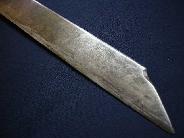

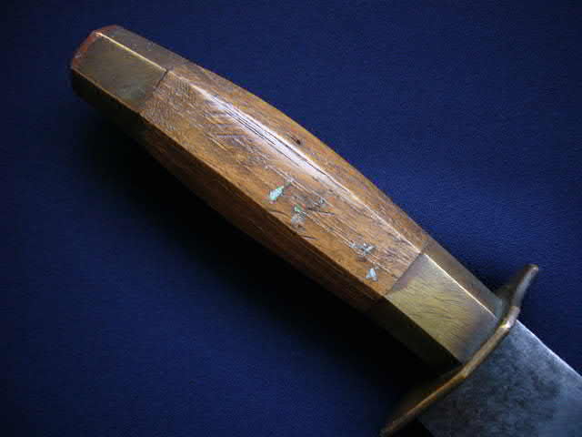

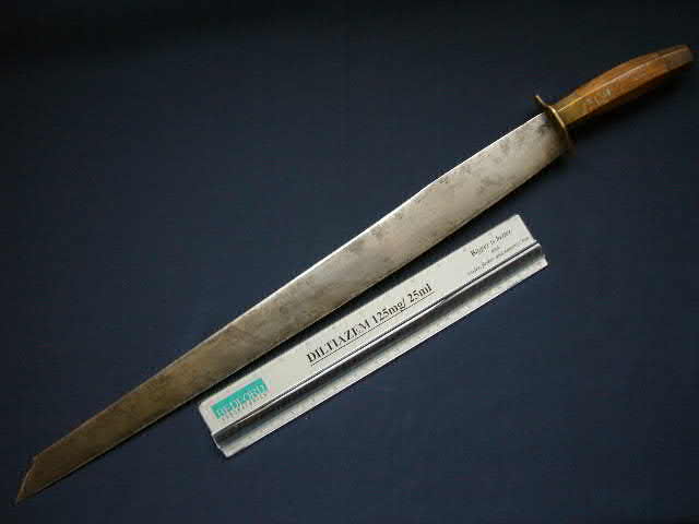

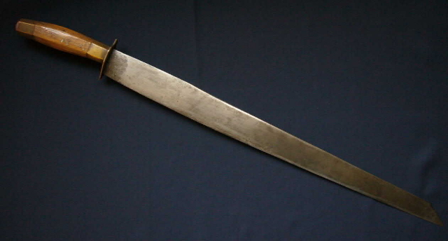

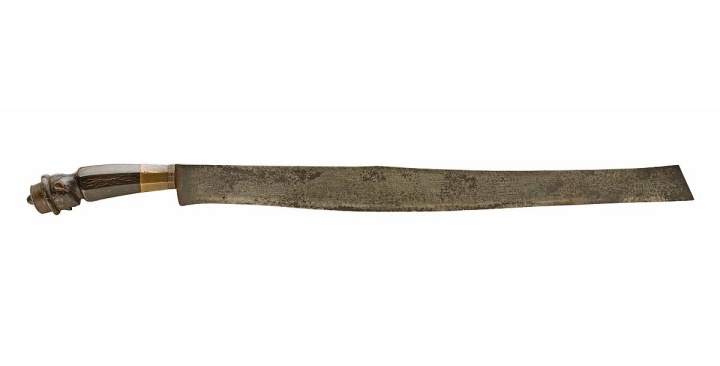

Hilt is made of Narra wood and is offset from blades center like most of the Spanish influenced Filipino swords I've seen.The blade is shaped kind of like the style of a Kampilan? I have never seen one of these Spanish influenced swords with this blade shape before. I would guess its origin to be from Luzon. I don't have any measurements as it is not yet in my possession. Going by the pictures if the object shown with it is a ruler I would estimate the blade length to be about 20 inches with an overall length of about 25 inches. All in all a very interesting sword that I am very happy to add to my collection. Thank you Albert and I hope you don't mind my using the pictures from the Swap Forum here. Any comments on the age or any other information on this sword would be greatly appreciated. Thanks.

The sword arrived today so I can give measurements.
Blade length 23-5/16"
Blade at widest 1-3/4"
Blade at thickest just under 1/4"
Total length 27"
The more I look at this sword the more the blade reminds me of a Tabak with the tip of a Kampilan. Any comments on this piece would be appreciated. Thanks.

Since no one has weighed in, I guess I will. It looks like a form of tabak from Pampangas, and I would say early 20c.

Thank you Jose for your help with this. The strange shape of the blade tip is what was throwing me off on this one as it does have a point and could be used to stab with. At 23-5/16" it also has the longest blade that I have ever seen on a tabak. I have another tabak like bolo that I will put in its own thread later that is just as strange, as the slanted tip is sharpened. Again I thank you for you help.

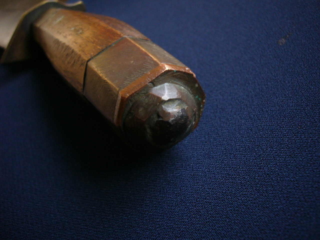

Would that be the tang protruding on the hilt's butt end? If that would be the case, then perhaps that would mean that the sword is from Luzon, like Pampanga as what Battara mentioned. The other possibility I guess is that it is from Batangas. Both provinces are just about 100 km (60 miles) from Manila -- the former is to the north, while the latter is to the south.
At the recent Macao exhibit, there's a similar sword [pic below] described as:
212. Luzon Tabak
Period : Post 1900, Katipunan Era
Hilt : Carved carabao horn in the shape of a human figural head with hat/cap. Hilt with octagonal brass ferrule and cap with peened tang construction.
Blade : Long clipped tipped blade. Typical blade shape used by Katipuneros.
Scabbard : Not available
Origin : Southern Luzon, Batangas
Overall Length : 65.2 cm [25.7"]
Blade Length : 50.2 cm [19.8"]
Handle Length : 15 cm [5.9"]
Scabbard Length : No Scabbard

Yes, I remember that one. I'm not sure I agree with Batangas though.
Any way, yes the Spanish did forbid points on the blade.
Also a good point Migueldiaz (every pun intended ) about the tang protrusion - it is a Luzon trait.
As far as talibon are concerned, they come from Cebu and that is farther away from the centrally controlled regions around Manila like Batangas, Pampanga, etc. Cebu is farther away from Spanish control and so is Ilocos for that matter (another source of pointed daggers). This is my thinking anyway.
