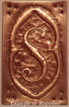

repoussee:
Repoussee, as correctly identified, is using the same chasing tools, but instead of hammering on top of the sheet metal, it is hammering at first from underneath the sheet metal. This pushes the metal out from underneath, buldging it into forms. After that is done, then the artist flips it onto the other side and chases or hammers from the front to bring crispness and more detail. Here some examples, one of a copper plate, and one of a silver coconut bowl:

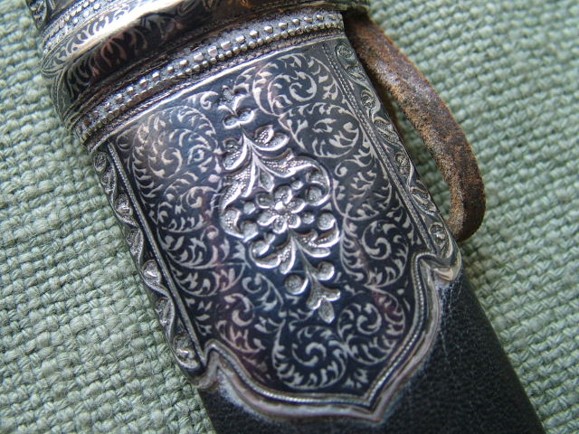

Gentlemen The throat of the scabbard of a caucasian kindjal. Chassing in center, niello all around
Yannis is offline   Reply With Quote

Yannis, that is some beautifully repoussed and neillod work. Excellently executed. Thank you for sharing this.

Ops! I thought it was "chasing" because it is hammered from the front side. I am not good student after all

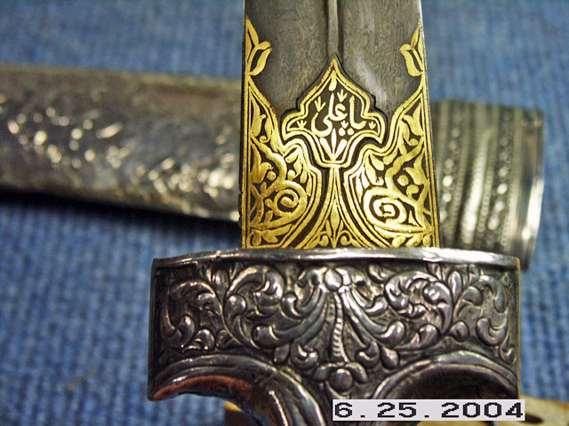

Default Help
Yannis
Thanks for the suggestion to share our good stuff for review!
I was going to make an attempt to say just what type the inscription was, after studying you information, but chickened out! Would you please tell me what type the inscription on the blade is and maybe even the hilt and sheath in the back ground.
Thanks
Mare Rosu is offline   Reply With Quote
Old 19th December 2004, 08:15 PM   #20
Posts: 7,412
Yannis
My apologies. I think I was seeing an optical illusion (or a senor moment ). From this other computer screen, I can now see that in fact it is chased. You're right in that chased is exclusively from the top down onto the metal.
Mare Rosu
Your inscription appears to possibly be a bismallah ("name of God") and done in gold koftgari with some line engraving around the borders of the bismallah. You can even see a little of the koftgari wearing at the edges. Overall, excellent condition of koftgari.
The scabbard in the background is difficult to see. If you could post clearer pictures, that would be helpful. I would take a stab at a possible mixture of soldering of silver pieces and silver stylized wire with perhaps some chasing, though again, I would need clearer details.

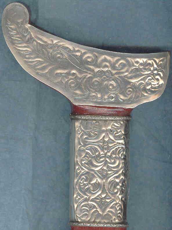

As you can see, one can be fooled because the metal is pushed back in parts allowing only the none hammered parts to remain looking like they are pushed out. It can become very confusing at times.
Another note: to repousse something one needs to use thinner sheet metal. Chasing, on the other hand, can be used on almost any thickness.

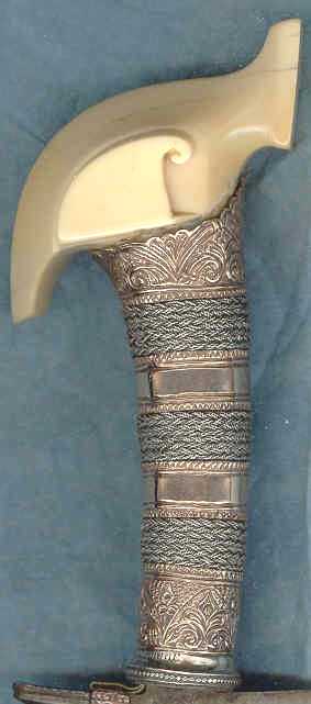

Old 19th December 2004, 08:25 PM   #22
Posts: 6,438

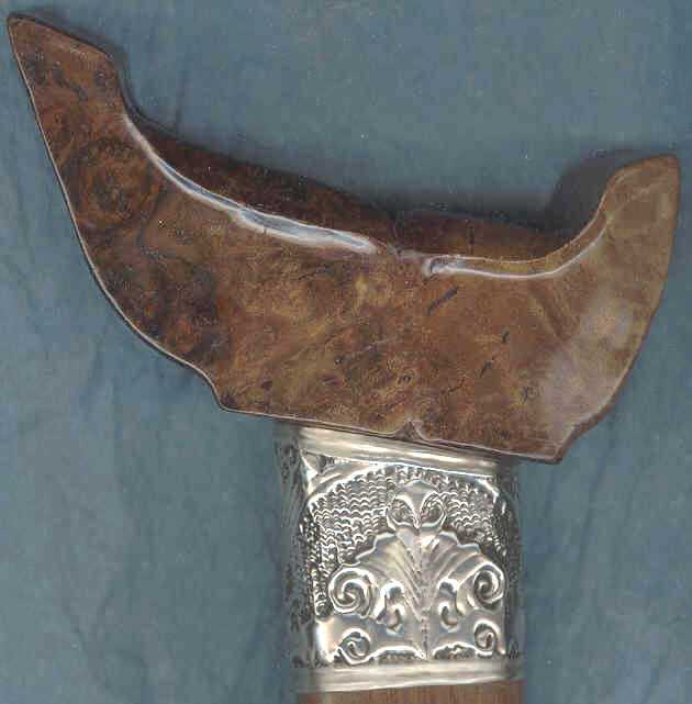

Thumbs up Nice Burl
What kind of wood Jose ?
I really like the design on the band also !

Default SCABBARD
Battara;
Scabbard for your inspection/opinion.
Thanks for your help!

No need for apologies. I have seen the same illusion myself, in photos and in reality under certain light Maybe because of the contrast with niello.
Someone told me that niello over flat silver may peel away, that's why it is more common the combination with chasing. Is this true?
In this particular scabbard niello is on flat silver and it looks high polished. The chassing in the middle is plain silver.

The wood is burled walnut on top. Thank you. I extrapolated the design from the kris hilt patterns in the kris shown as my avatar. I tried to match the theme done in swassa on the hilt:
Old 19th December 2004, 09:22 PM   #27
Posts: 7,412
Mare Rosu
Thank you for the clearer picture. I would say a mixture of hard soldering of patterned silver wire elements at the throat, then some repousse, then further down some embossing:
embossing : when first chasing the design onto the metal sheet, then afterwards flipping the sheet around and hammering from underneath. This makes a slightly different effect than repousse (where one hammers from underneath first .
Another note: it looks like the scabbard at least has Iragi influence and maybe from Bagdad.
