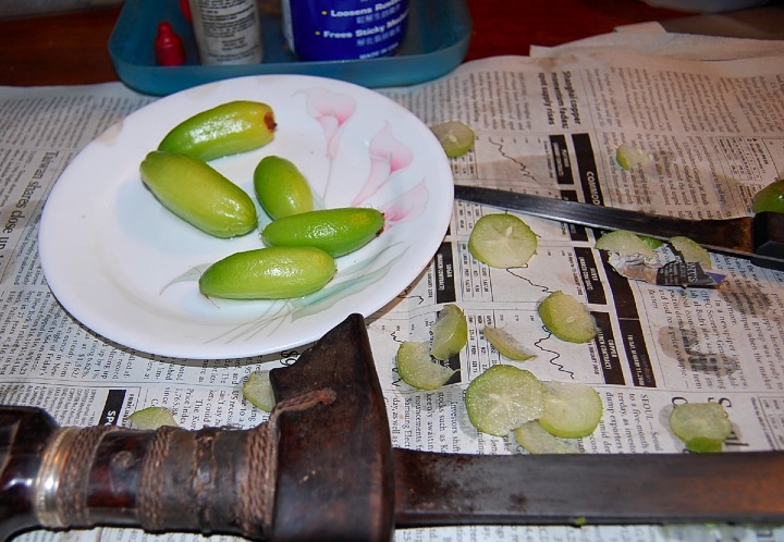

By the way, yesterday I've experimented using a local fruit called kamyas [come-YUSS], as suggested by Kino and the others.
Said fruit is the one on the plate in one of the pics.

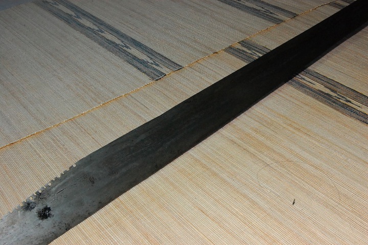

The result is encouraging. Whereas before that kampilan's blade doesn't have conspicuous lamination marks, after rubbing the blade with the kamyas for about 20 minutes, the laminations stood out much clearer.
The scientific names of kamyas are Averrhoa bilimbi and Hedychium coronarium. And the active agent in kamyas is oxalic acid.
