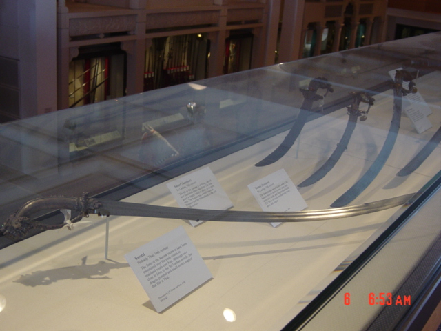

Also from my recent visit to the Leeds Royal Armoury.
Yet another example of cross-fertilization of different cultures

Interesting. If the museum is correct (not something I'm usually confident of--your pardon, Wolviex ), it might explain the painting we discussed on this thread:

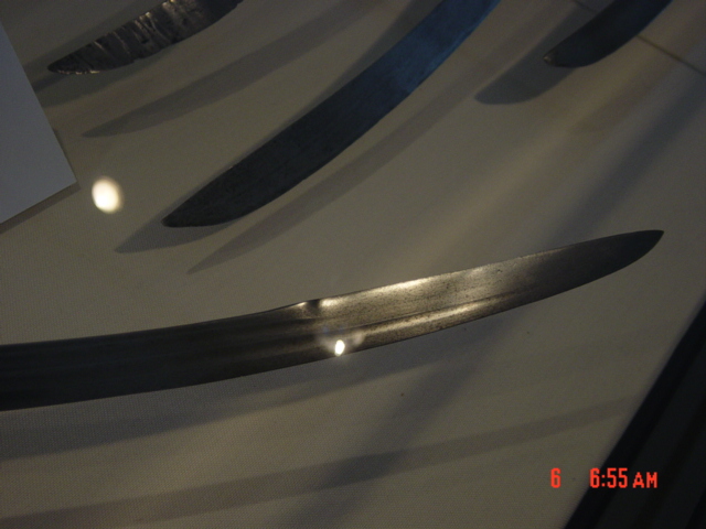

I'm also wondering if the blade is of Thai manufacture ; it looks like Indian work to me , or possibly Persian .
Possibly the only thing Thai about it may be the hilt .

I agree with Rick,the blade looks very 'tulwar-ish' to me I wonder if this was made in India somewhere not to far from Sri Lanka.I do also have to admit though that the hilt looks a lot like the 'Vietnamese sabers' that have popped up here and there.

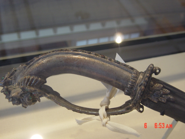

I would have to agree that the blade does look as if it may have come from India, while the hilt itself is truly oriental in appearance, as are some from SE Asia, including Thailand, but the whole feel is just wrong for the latter, somehow.

Does the blade not also resemble the type of parang nabur that has a yelman? The hilt has at least 3 characteristics that are very different from any other kastane shown: the knuclebow seems to connect at the pommel; the knuckle bow is more gradually curved, less angled (and closer to the blade/handle) where it angles up; the handle has a curvature in the part that is meant to be inside the hand, rather than being essentially straight with a hooked pommel, which is a significant handling difference. Also, the metal-covered(?) handle seems unusual (?) but seems to be occasionally seen in all times and places......Can't see the face too well, but it does not look like the usual face.
Old 24th May 2005, 01:48 PM   #8
Posts: 6,441
Question Really Thai ?
I'm kind of suspicious of this sword .
It could all be S.Indian after seeing some of the motifs in Elgood's Hindu Arms and Ritual i.e. pg. 99 fig. 8.64 or pg. 100 fig. 8.67 or pg. 175 fig. 16.26 .
If the hilt had a polish it might appear quite differently .
The fullering , and the blade itself is quite different than most parang nabur .

As far as the detail of the decoration, I do not recognize any Thai motifs, which tend to be a little more "flamey" or spikey. Nor have I read or see a kastane provinenced from Thailand. There were certainly contacts with Sri Lanka, perhaps more with Burma than Thailand. One other point to ponder is a royal edict issued in Siam at a time when Japanese blades were becoming common and popular, requiring that the use of such blades would be acceptable only so long as the fittings were Thai. So you see a fair number of katana blades fitted with handles having a round cross-section and a pommel. Based on that I would have expected a more Thai-styled handle on the blade, though in more recent times the knuckle-bow saber handle is common.

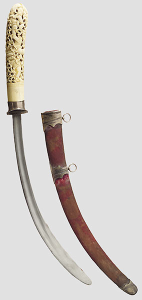

Coincedentally, here is a sword which was recently sold by Hermann-Historica, attributed to "Borneo/Brunei," but the handle of which to me strongly resembles that of a Burmese dha. Note the blade ...

To throw my hat in the ring, it appears to be of Sumatran Peudeung form. The hilt to me says Vietnamese made in Peudeung form.

The hilt appears to me to be a blend of Vietnamese grip and pommel and the guard design of the Hulu meu apet. Attached is a hilt image of my Guom, note the similarities in styles. Add a Hulu meu apet guard to this grip, consider different materials used, add some stones to the mane and flowing mane along the spine of the grip and there are many more similarities than any other regional influences to my eye. Don't stop searching the southern Indian regions though ;-)

The mask, mane and size of the hilt do say Sri Lanka, the blade, well there aren't many places Islamic type blades aren't seen...
