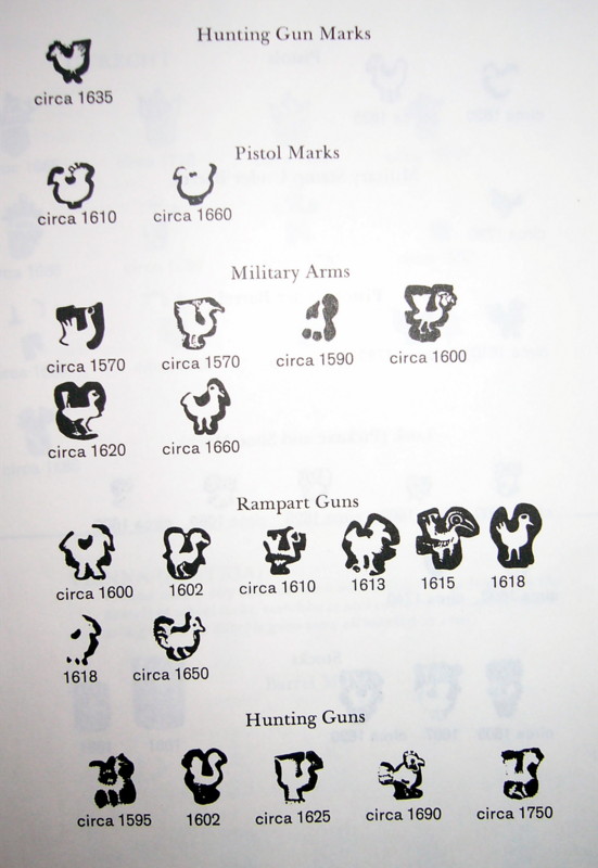

Smile WHAT DO YOU WANT TO KNOW? PROOF/CONTROL MARKS
I HAVE BEEN APPROACHED BY JIM TO START A THREAD ABOUT PROOF/CONTROL MARKS FOUND ON GUNS AND OTHER WEAPONS. I HAVE A REASONABLY EXTENSIVE LIBRARY, AND WOULD BE HAPPY TO TRY TO IDENTIFY ANY MARKS WHICH MEMBERS HAVE FOUND ON OLD WEAPONS. PLEASE POST YOUR REQUESTS ON THE FORUM AND I WILL TRY TO PROVIDE ANSWERS IF I CAN. BE PATIENT AS RESEARCH CAN TAKE TIME!
MEANWHILE TO GET THE BALL ROLLING I HAVE POSTED HERE THE CITY CONTROL MARKS FROM SUHL AND ALSO EARLY SWEDISH MARKS.
INFORMATION SOURCE "ONE HUNDRED GREAT GUNS" BY MERRILL LINDSAY.

Stu , thank you so much for getting this thread started, and for beginning with such a unique subject. In discussing firearms, it seems the focus is usually on British, then French, followed by Spanish then occasionally Portuguese, at least in my perception as an observer. Obviously German guns come in as well, but seldom those from Sweden and North Europe it seems.
I'm sure this order will be challenged, but basically what I am saying is that Swedish guns dont seem to turn up too often.
I very much look forward to this thread developing, and as I have mentioned before, it is great to see responses on our new forum with its scope including and encouraging antique firearms discussion. I hope this thread will present a standing resource for those researching these firearms to find information on the markings which hold valuable clues and detail.
It is interesting to find that Sweden had such an important firearms industry with Suhl, and its comparison to Solingen for sword blades. If I understand correctly, the sword blades used in Sweden were typically Solingen made.
I am hoping someone out there might have a Suhl made weapon to post..it would be great seeing actual examples as we discuss these markings.

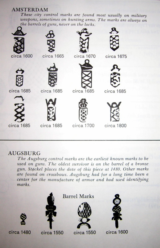

Thumbs up A FEW MORE OBSCURE MARKS TO LOOK FOR!!
Thanks Jim for the comments. Just to make things more interesting here are a few more obscure marks from the same source as previous.
I also would be very interested in seeing an actual weapon with ANY of these marks posted here.
Have fun Guys.

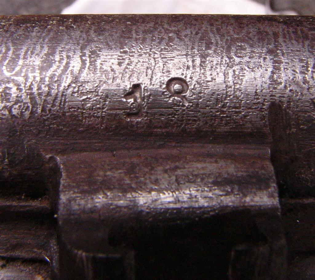

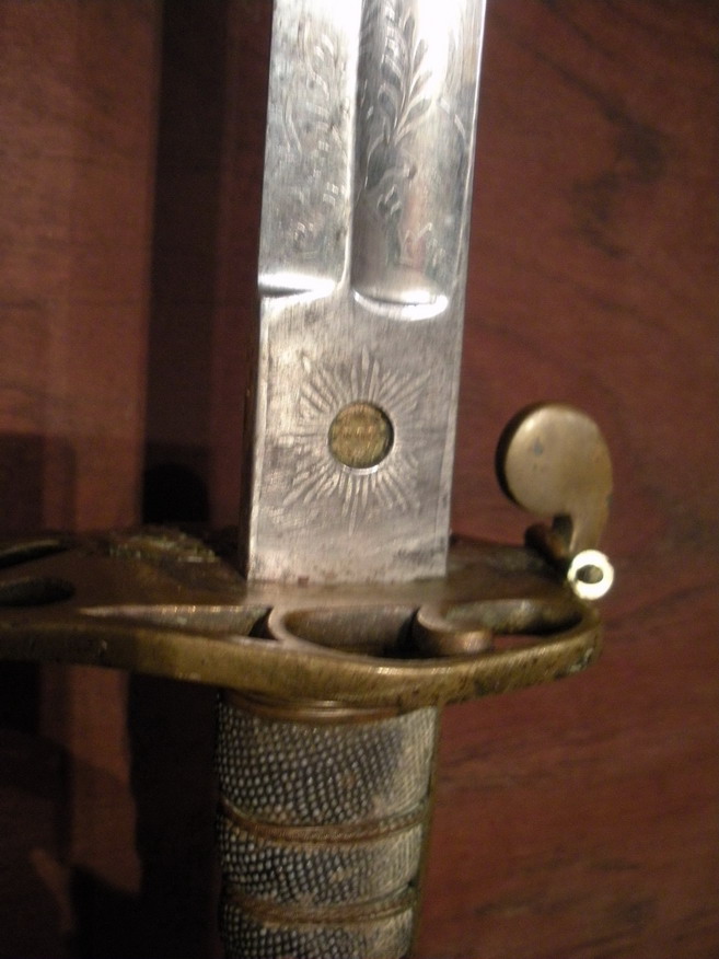

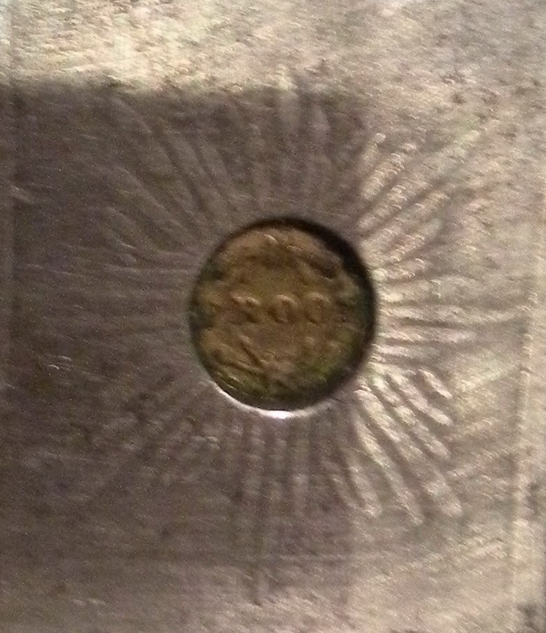

Hi Stu,
What do you know about this one?

Looks to be a proof mark of a blade maker. Is this on a sword or a gun? A clearer pic would help showing the total stamping and surrounding decoration. Also any other information of the item.
Regards Stu

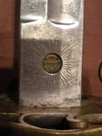

Ooops, my apologies. It's a 19th C. blade's ricasso mark. I'm having troubles taking good macro pictures of objects so small. I'll try to take another one.
Best
Manuel

What does the WHOLE item look like as that COULD probably give some clue as to origins. What sort of sword is it??
Regards Stuart

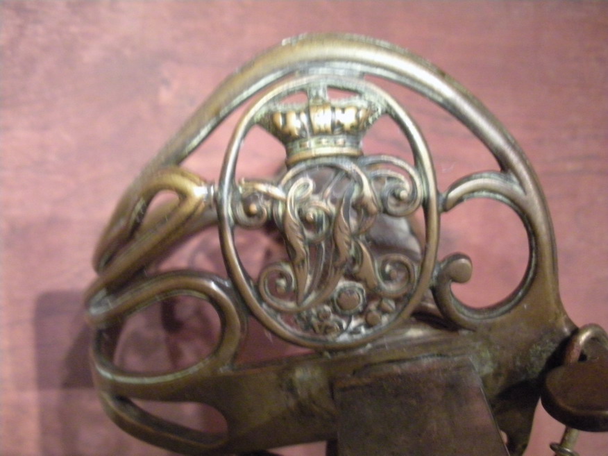

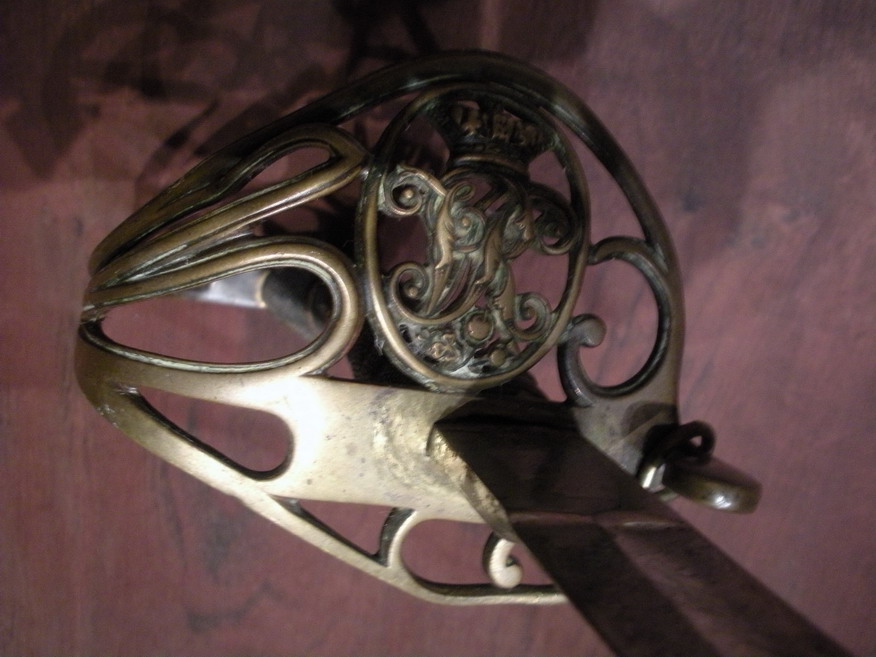

Regular 19th sword, see another pis of hilt...

Sorry Manuel,
You will have to post clearer and more informative pics. Looks to be a cypher on the hilt but you don't show it. What does the rest of the blade look like? Are there any other markings or inscriptions which might give a clue as to origins?
In reply to your first question----what you show is a proof stamp on a sword. Other than that I can not tell anything further from what you have supplied.
Regards Stuart

Hi Stu, I still don't own the sword. I must return to the owner's and get more pics.
I was thinking that perhaps it meant Austrian Republic , but it couldn't be. In German it would be Republik Von Ostereich, not Of.
BTW, is there in the forum anyone that can read cyrillic?
Best
Manuel

I do not have a great knowledge of sword proof, but I do know that the actual proof stamp itself does not necessarily give guide to the maker or origin . If you can get a pic of the cypher on the hilt, and any further cyphers on the blade, you SHOULD be able to at least arrive at country of origin and maybe even the cutler (maker).
Regards Stu

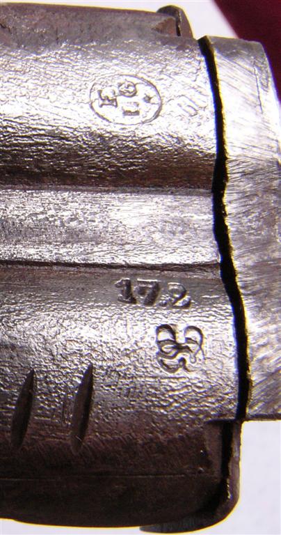

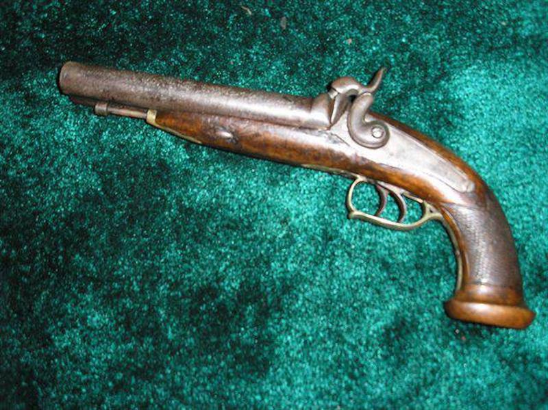

How about my howdah pistol. Double barrel about .70 bore, percussion. Gun shop guy said, "Belgium - 1835 to 1855."
Old 8th November 2008, 02:55 AM   #13
kahnjar1
kahnjar1's Avatar
Posts: 2,832
Default Howdah marks
Hi Bill,
Marks are Belgian Proofs as follows:
The oval ELG in use from 1810 and was the SOLE MARK until 1853.
The EL intertwined was introduced 1852.
The numbers, 18 and 17.2 are the bore size in millimeters. Introduced 1810 and until 1894 graduated in 0.2mm graduations. After that date in 0.1mm graduations.
So from the above, your pistol is likely post 1853 and probably pre 1895.
Not quite what the guy in the shop said, but the marks tell the story.
Nice piece by the way!
Regards Stuart

Found other pics, seems to be Victorian British
Hi Bill,
Regards Stuart
Wow Stuart! Thank you so much!
Great info! So could be anywhere between 1853 and 1894! I'll call it at 1853 1/2!
So one barrel is 18 mm and the other is 17.2 mm? Don't think that I would care to fire it with projectiles, but might try BP and wads.
I have heard conflicting comments about the strength of Damascus barrels. I know they were designed for BP, but some people say that over the years, cleaning fluids and residue get into the Damascus (mainly on the inside of the barrels) and can substantially weaken the walls.
Yet other people say this does not happen. Anyone have an opinion?

Hi again Bill,
Yes, according to the marks, the barrels are of slightly different bore. Regarding interior of damascus barrels. The most usual corrosive agent was black powder residue. OK before fired but when fired the powder residue attracts moisture and creates a real mess if left over time.
If you wanted to fire the pistol, check the inside of the bores with a borelight, after having scrubbed it with a bronze brush. ALSO CHECK THAT IT IS NOT LOADED ALREADY. Some years ago a friend of mine shot his TV with an old muzzleloader which still had a charge in it! The way to check is to put the ramrod down the barrel and compare the depth with the outside. The rod SHOULD measure right back to the nipple. If it does not, then draw the old charge with some sort of long corkscrew if you don't have the proper tool.
Regards Stu

Yes you have a British sword. Queen Victoria's Cypher. Can't tell you who maker is from Proof stamp but is there a name on the other side near hilt?
Regards Stu
