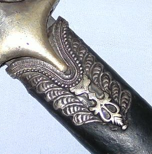

Hi at all,
I would known if on persian culture this symbol has a meaning?
Thanks

Can you show more? It looks vaguely Caucasian because of niello. On the other hand the form reminds Arabian Akrab. Need more info.

Strip tease or not its Arab work c 1850 Riyadh or Jidda

The device is the 'aghrab' which symbolizes scorpion, apotropaic in Arabian lore.

thanks ,scorpion is not symbol of war on arab culture ?

It WARDs off evil. Nice word Jim how much that cost you
Old 29th August 2008, 06:43 AM   #9
Posts: 10,872
Nice one WARD !! 'apotropaic' was one of my big dictionary words...two bits I think!! but OK, evil it is.

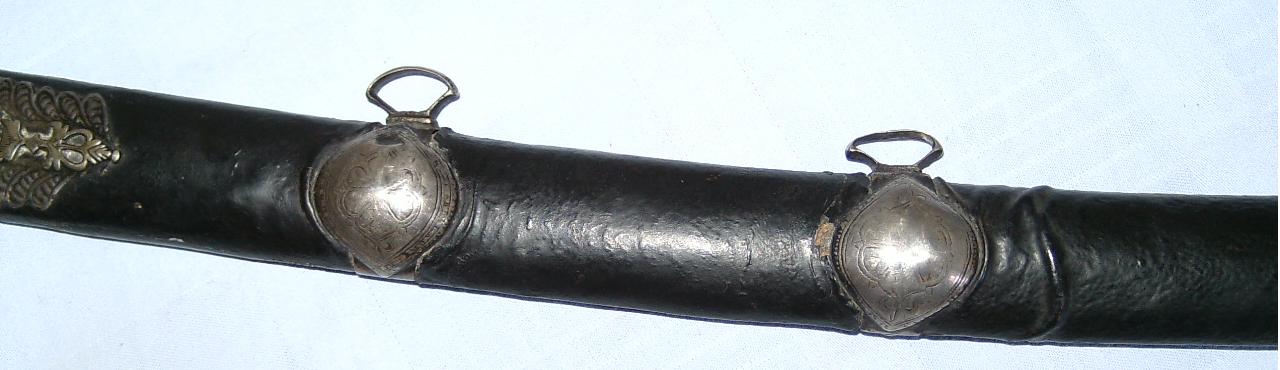

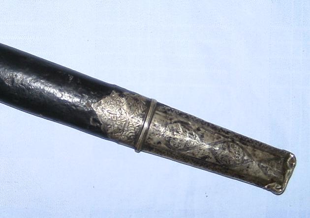

I hate to disagree with Ward, but it seems to me that there are 2 styles: silver fittings are Caucasian ( Circassian?) whereas the throat is much newer and obviously Arabian.
We absolutely need to see the rest.

Do I see a rudimentary yelman?
Close-up of the inscription?

Ariel where do you see caucasus work?
Old 30th August 2008, 02:26 AM   #17
middle fittings with the rings look circassian to me. never seen similar ornaments on arabian silverwork. same with the drag, but cannot see details well enough to be more certain. check astvatsaturyan's book.

I am referring strictly to the ornaments on the middle pieces: they look Circassian, with very sparse figures, petal-like. They look nearly identical to the decoration on Circassian shashkas and firearms.
The ones in the Elgood book ... I could not see any decorative pattern besides a very Arabian one on the drag.
