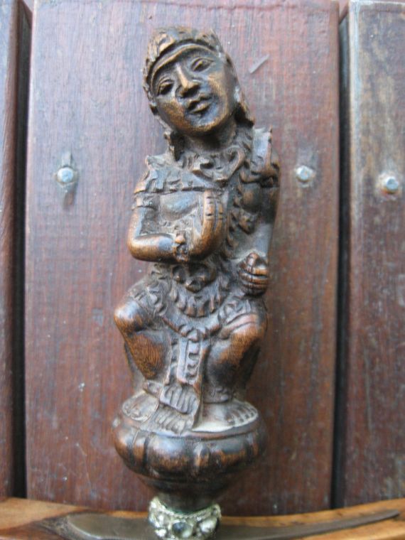

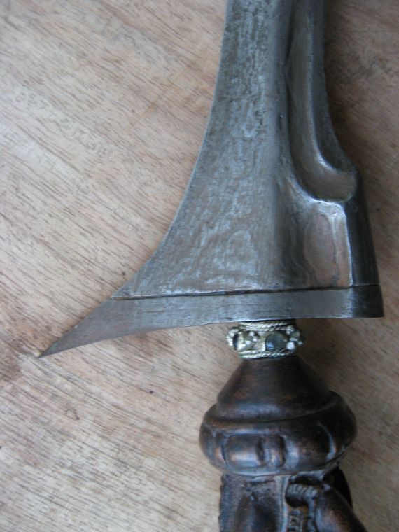

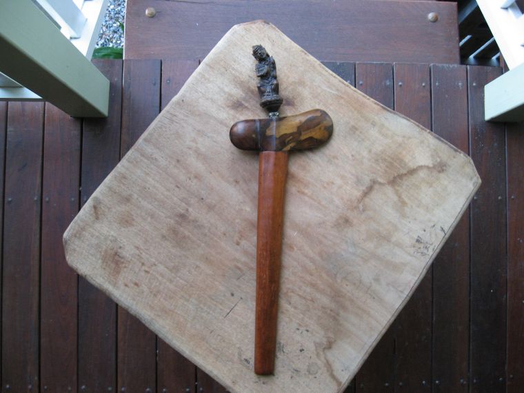

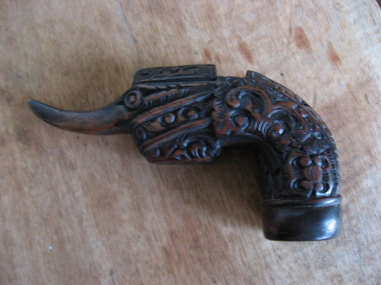

G'day,
I purchased this keris locally, I liked the way it felt in the hand and the blade looked old to me. Could this be a short Bali keris? I'm guessing the hilt and mendak are newer? The scabbard fits blade. I have also included a hilt that I guess is modern? Blade length from hilt 14 3/4 in. Blade thickness at hilt 1/2 in. Comments on age and origin would be greatly appreciated. Kind regards, Daniel |
#2 |
Location: Italy
Posts: 928
The two hits seems to be new
The mendak too (Bali) blade and sarong old |

It is certainly in Bali dress, but i am not convinced that the blade is Balinese. It looks more Javanese to my eyes.
I agree that the sarong is older while the hilt(s) and the uwer are new. Nothing wrong with that. Your Bali hilt is no great piece of carving, but it has a nice expression IMO. I like it. An older hilt wouldn't necessarily be all that different. There are countless styles of Bali hilts. |

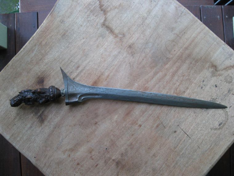

If it is helpful, here are some different blade perspectives.
I have given blade a light etch and can see a pamor? Cheers, Daniel |

Is the surface smooth or not ? How is the colour/aspect of the hole on the bottom ? |
#8 |
Posts: 1,209

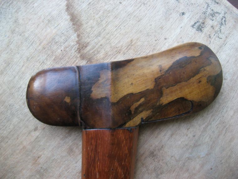

I think this keris is from Bali or Lombok.
The blade was rather neglected, but in my opinion it was a polished blade. An attractive ukiran. Hard to tell if it is an old one from the picture. Wrangka seems to have some age. The gandar is a more recent replacement. You better etch the blade with warangan to get the pamor out again. |

Posts: 96
I understand what you say about photos Marcokeris. I lack the experience to tell handles/ukirans age, It shows smoothness in areas of possible hand contact, whether this is thru handling or artificial, I can't say. Who does the figure represent? I had thoughts of a Balinese dancer or hindu deity?

I was hoping for a darker stain, perhaps I should readminister process? Any thoughts on pamor please? Random or planned, neither? I am liking keris very much Thank you in advance for your time. Kind regards, Dan

The handle is quite nice; I think I see the remains of a finish; is it painted or gilded Scratch ?
I can see pamor but it looks very minimal and scattered; or maybe it's just the picture ? What staining solution was used ? Warangan ? Rick Last edited by Rick; 18th August 2008 at 07:08 PM. |

The mix I used for staining was white arsenic and lime juice/warangan. I may have made the paste to runny. I sat mix for 15 mins. Left mix on blade for 15 mins, rinsed, then reapplied mix. Left for 15 mins rinsed, dried. This was my first attempt and any advice will be gratefully received. I had thought pamor came in both minimal and intricate forms? Indeed, My camera skills/tools are not the best, I do try. The handle may have had some black substance on it that has been removed I cant be sure.I have a Bali/Lombok piece that also needs staining. Thanks for your interest Rick Cheers, Dan

Yes, it is possible to find current era blades of dhapur pasopati, however, they will not look like the one I made, as this is my interpretation. They will have the same overall appearance, and they will have the same features, but they will look different. Its the same with any art:- ask 20 artists to draw a tree, and each of those trees will be different.
I've got a cengkrong around somewhere, when I find it I'll post a pic. The method published by Frey is in one of the later editions of his book. I do not know what he published, so I cannot comment. The level of colour you have achieved is sufficient to read the pamor, so its OK. Not yet good, but OK. |
