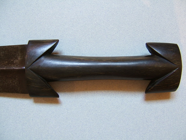

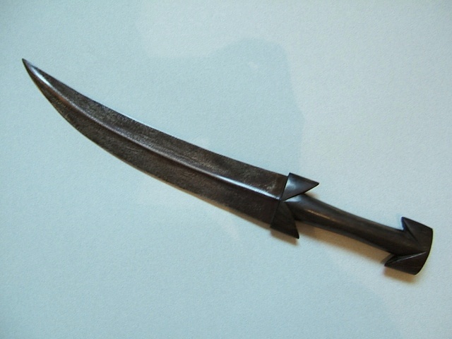

Just arrived the other day a large horn hilted Albanian jambiya. I sanded down the blade with 600and 1000 grit sand paper and etched it. The blade turned black instead of the normal grey but I don't know if I see any real pattern? So this is probably not wootz?

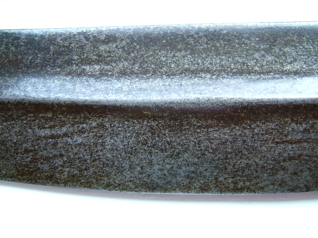

Ward
I sanded it again and used a weaker solution and I am definately seeing a wootz pattern starting to appear it shows swirls but seems low contrast it will need more coaxing.

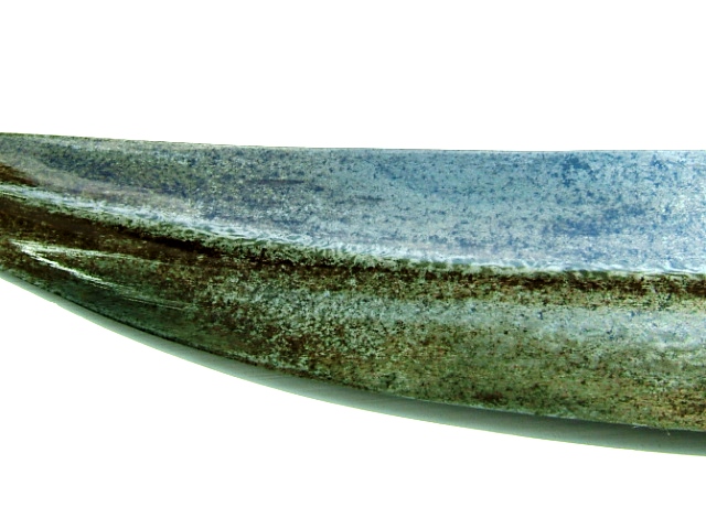

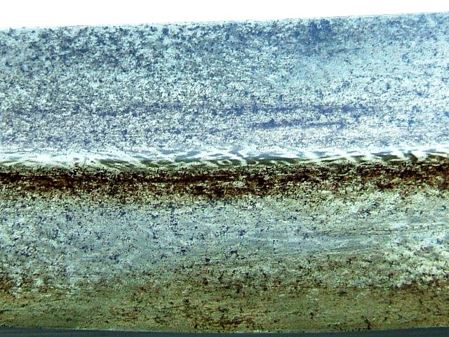

Old 26th July 2008, 08:27 PM   #5
Lew
Lew's Avatar
Location: East Coast USA
Posts: 3,191
Here is a better pic you can see the pattern but it's not high contrast.
