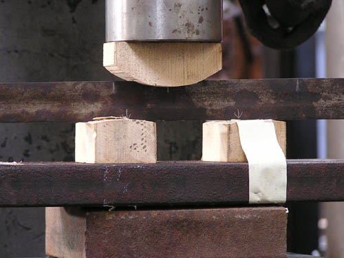

Jeff is it worth trying to rework that blade and straighten it out again before you polish it?
Old 1st August 2008, 05:17 PM   #14
Jeff Pringle
Jeff Pringle's Avatar
Join Date: Nov 2005
Posts: 189
It is to me, and it would need to be straightened to do the polishing correctly. Since the major warps were unfairly installed (if I’m reading the damage correctly, of course), and since with Japanese blades you can pin down the time and place of manufacture, even the individual smith, by looking in to the polished steel – it feels like the right thing to do.
It can be a risky operation, since you never know when metal fatigue will cause a blade with a long history of flexing to snap, but I was able to coax it through and it is mostly straight now, just a couple minor adjustments left.
Jeff Pringle is offline   Reply With Quote

No desire to re-heat treat the blade, since I’m interested in what’s left of the original heat treating and it feels like that would be a final insult to this blade which has already had a tough life. The hilt could get some surface-level help, but not ‘til after the blade is in better shape. I don’t think I’ll disassemble the grip, which will limit the scope of work on that area.
A photo essay sounds like a good idea, though this isn’t a front-burner project so it might go on for a while! The final result will be far short of the blade’s former glory, though, it is too far gone to be more than a shadow of its original self. I’m thinking of splitting the difference between a conservation and restoration, restoring it back to a possibly imaginary point just before it fell into the hands of people unaware of basic sword care – but there is a lot of deep rust and other damage that will remain.
I used a manual press to remove the bends and ripples, since it has good control at the high force levels needed to take out that curve. There were also a lot of bends, so it was helpful in isolating them one by one. I held the blade against a flat surface and marked where it touched, then used blocks of wood at those points to transmit the force in the right direction.

Jeff, would this method of straightening work on a very old Katana without causing damage to the outer steel? Most swords I have had to straighten I've just used a large copper mallet and some pine timber blocks.
I ask as a friend wants to straighten one and I am reluctant to use the blocks and hammer method on harder steel than what I am used to, maybe the press would be a better option, maybe there is another method you can suggest?
thanks

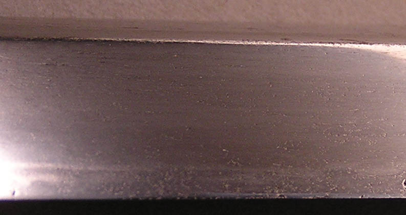

It is still resting comfortably on the back burner
I got the blade straight and cleaned it up enough to count the hagire (5) and polished the tip enough to see some nice dark koto-loking steel, decided that I should bring it to the local nihonto club and see what they had to say...then got distracted by some other artifacts
