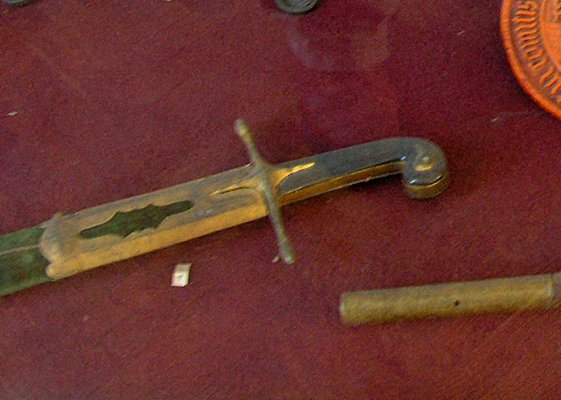

Hopping to make a your day better, I am posting this very bad picture (with very good intentions...) that I took illegaly at a museum in Timisoara, about Transylvanian history. This type seems to have been popular in the late 18th early 19th century in the Ottoman sphere of influence, in this case a border tampon region , like Transylvania or Banat. The blade and scabbard differs quite a bit from yours but the crossguard is much the same, specially the disputed material ...

Radu,
What is "border tampon region"?
I have a lot of thoughts flashing through my brain, but none are fit to print.
Old 23rd April 2005, 08:39 PM   #13
Radu Transylvanicus
Radu Transylvanicus's Avatar
Location: 2008-2010 Bali, 1998-2008 USA
Posts: 271
hahaha ... yes it sounds odd, I guess its a mot-a-mot translated expression meaning ,"buffer zone" a transitional region where influences from two or more larger powers clash or diverge ... dig it ?
