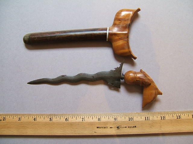

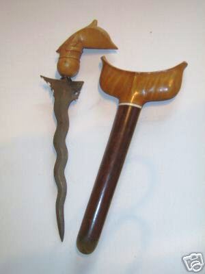

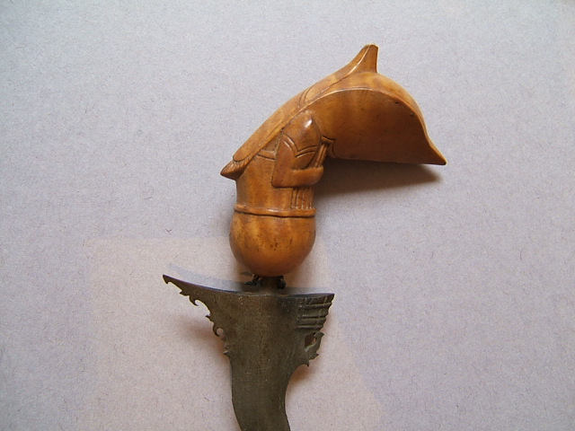

Hi All
Just won this little gem today. Can you let me know if you think it's a good one? I think it may need a mendak?
Lew

Lew, it looks like a peninsula piece to me so i'm sure that Shahrial or Kai Wee can put a better ID on it for you. The pics aren't too good, but it looks well crafted to me. Certainly worth more than you paid for it.
And what i think you need is a pendokok, not a mendak. Whatever is there in between the hilt and blade looks inappropriate to me.

Thanks Dave.
I just think there is some material coming up through the hilt and there is no metal there at all. Will post better pics when it arrives.

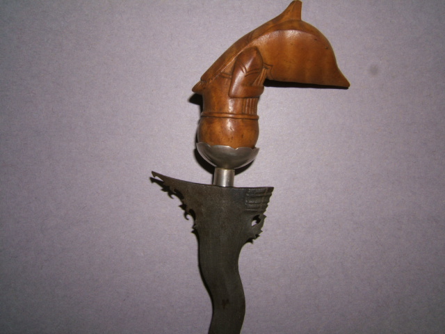

Here are some better pics of this small gem. It is going to need a nice pendokok to top it off.
Lew

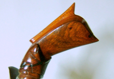

Just wanted too post an updated photo.
Lew
Old 20th January 2008, 03:29 AM   #6
Posts: 7,297
The pendokok still looks a wee bit too large, but i would imagine that it would be really hard to get a good fit with such a small keris unless you had one custom made.
All in all it looks like a nice little patrem. I am still assuming it is a peninsula patrem and it's the first i've seen from that area. Anyone else have one from there to show?

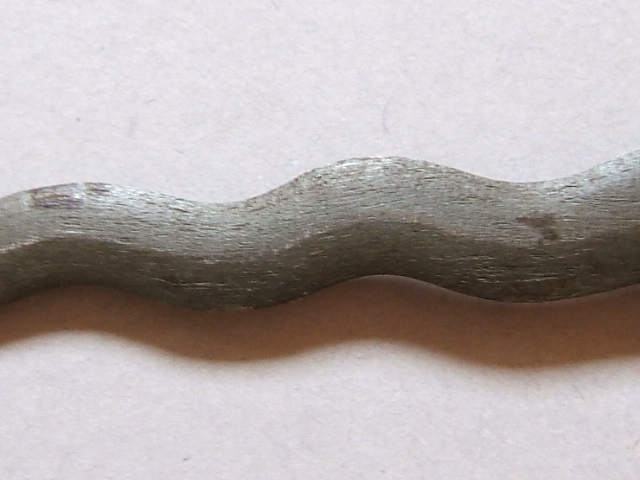

The greneng works perhap to reflect the artistic nature of this piece. Compare the other 'keris pendek', (short keris) with this. Btw, what I meant by 'hardening' is actually 'tempering'. Can you take a closer shot of the base of the blade (sor-soran) area, the whole blade and a close-up of the blade tip. Souvenir pieces do have varying quality levels.
David,
True, there are many pamorless blades in the peninsular. I didn't mean that no pamor equals to a tourist blade, by default. There are many excellent pieces out there which are pamorless. Let see the close-up before I comment further... I've been wrong before.

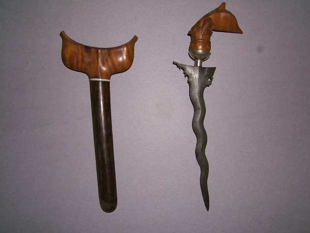

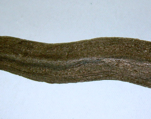

What is your opinion on the piece that I've attached?
