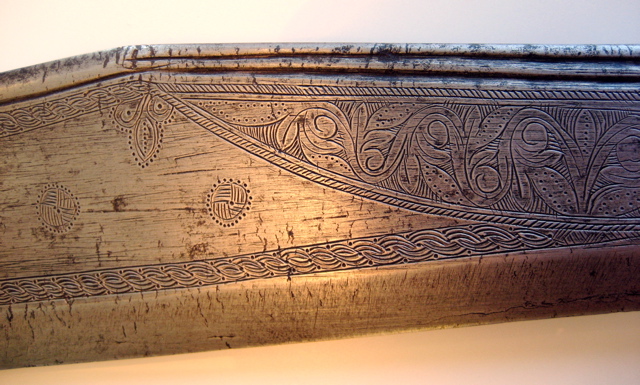

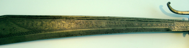

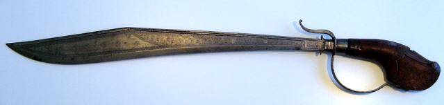

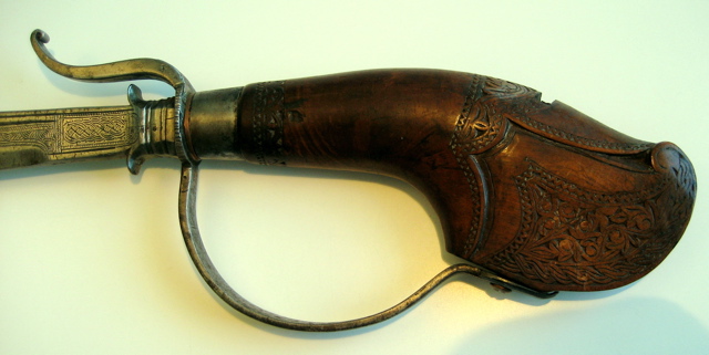

This tricky sword maybe some of you recognise from the Baltimore show?
I got it from Artzi and promised to share whatever I could find out about it on the forum.
My first impression was that it probably was from the Moluccas.
The blade looks a bit like Tanimbar and the hilt like those sometimes seen on swords from Buru and Obi.
But the quality is much better as well as the motifs didn't match that region.
I discussed it with Arjan who gave me the idea that it maybe could be Sumatran.
After some more research I think it probably is Mandailing.
That based on some related features on the few Mandailing blades I found in the Leiden archives (f.i. 769-23), as well as the motifs on this sword.
The Mandailing tribe are probably ex-Batak, but became Muslim quite early.
Here is a nice site about this people and some old pictures http://www.mandailing.org/Eng/indexeng.html
Michael

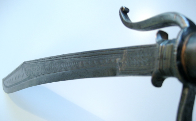

Hi Michael it looks to me more an malay / borneo influence weapon
can you make an close up just below the hilt off the carving
I did see similar blade in the depot off an museum but no handle on it
Ben

Posts: 1,637
Hi Ben,
Here you are.
Have you checked Leiden 769-23?
Do you have any pictures or references of the blade you had in mind from Borneo?
Was it a Parang Bedak blade without a hilt?
Michael

Michael,
Yes, a few of us did get the opportunity to see and handle this beaut at the Baltimore show. It is really a lovely piece and one of superior quality throughout.

Hi Michael is that an coin under the handle we see this a lot in Borneo the motif under the handle I never did see that used in Sumatra .
I will go back to the museum as soon as I have time to make an full picture.
If you visit the Netherlands I can take you to this museum depot that closed in 2004 .
It has an old collection never see weapons like it before.

Rick and Ben,
Yes this sword has a very nice weapon feeling.
Ben, no coin under the handle on mine as sometimes found on the Dayak parang.
Which one on the picture has common features like my sword?
The motif is found in f.i. Aceh aka three intertwined ropes (see f.i. B Leigh p. 82)
Thanks for the invitation to visit the museum depot with you as well as eat some good Surinam food.
I e-mail you when I find a date to come down to Holland.
Michael

Hi Michael the one in the front with out the handle has same blade shape .
And yes youre also invited also to eat some Surinaams food .
Ben

Hi Ben,
To see the blade shape of that sword for me is just as difficult as for you to see that it isn't a coin under the hilt - pictures you know...
I can't see the characteristic protrusions close to the hilt or the form of the tip.
Do you have more pictures of it or should we have a close look when I visit you?
Michael

Hi Michael we take a look when you are coming it is better to have it in the hand you have an close look at it .

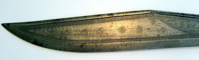

I must admit I do love the superb artistic engraving on that blade - very time consuming and expensive work - someone important owned that puppy!

Yes,
I haven't seen that much engraving before on a sword like this.
Michael
