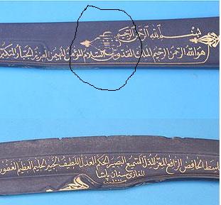

A close up of the inscription on the obverse side near the Yelmen:
Which reads: Al Mughazi Sinan Pasha Saneye 1000 (The invader Sinan Pasha the year 1591)
And:
Bisrasm Saheb al Dawlah (Ordered by the country's ruler)
And follows with: Bismella al Rahman al Rahim (In the name of God, the most Gracious, the most merciful) and than on both sides of the blade all the attributes of God:
He is Allah, the Beneficient, the Merciful, the Sovereign, the Holy One, the Peace, the Keeper of Faith, the Protector, the Majestic, the Compeller, the Greatest, the Creator, the Maker, the Shaper, the Great Forgiver, the Dominant, the Bestower, the Sustainer, the Opener, the Knower, the Withholder, the Expander, the Abaser, the Exalter, the Bestower of Honor, the Humiliator….. and so all the 99 attributes:
Sinan Pasha is a well known figure in the Ottoman history. For most of his mature years he was a high ranking commander in the Ottoman army under Murad III and Mehmet III, and five time appointed as the Grand Vasir until his death in 1596.
Was this his sword?? Why not. The blade is definitely old. The inscription is of top quality both in inlay technique and calligraphy and fits the period style. The blade might be even earlier: On the reverse side there are traces of an earlier cartouche.
So what do we have here: A late 16 C blade that was supposed to appear in the late 18 C. may be we should reconsider our knowledge on Pala swords??

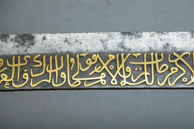

Just to demonstrate the quality of the gold inlay, see below side by side two works: On the left is a close up of the Pala blade in discussion. On the right is a section from a mid 19 C. Turkish Jambiya blade:
On the right image one can see the traces of the criss cross scratches on the steel. Also, the sharpness of the letters and the accuracy of the lines in the left image are quite evidence.

Have located 30-40 kilij sword with long inscriptions on the blade, the majority of these were done with the square kufic calligraphy. Most are not dated but some also have the name of the current ownt and when Sultan or Shah the time period of that hilting can be established.
The blades that a date can be determined are from early 16th century to the 19th century, with the majorty usung the suare kufic script.
This yataghan form a private collection I have permission to show:
http://turkishyatghan2.blogspot.com/
The gold is inlay, believe it to be with the Turkish techinque of a triangular punch overlay and then the gold applied.
The calligraphy has a similar vertical line, also the slanted accent marks, but no diamond shaped dots. Your kilij's calligraphy had the diamond shaped dots. So we have similarities and dis-similarities between these two examples. Look carefully at the signature on the yataghan...
The great majority of calligraphy I find on 16th century Turkisih kilijs has the square kufic script.
