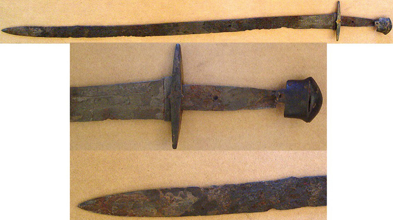

Here's a sword from the same family with the hilt intact. It has a narrow groove running down the blade, you can see it up at the forte. Got lucky on this one, some original surface still on it 88 cm long, blade is 75 cm.
Tim

Teodor those are some interesting swords especially the Bulgar one with the pommel. I have one sword similar but it was found way east of that area, it also has a tribal mark on it. Interesting that the pommel on that Bulgar sword isn't much different in shape than the one on my sabre in the pic above. Looks like there are 2 type pommels, this one with the dome top like a can of Coke somebody left in the sun too long and another one looks like a lightbulb, like on the Magyar swords in the next pic you posted. There is a lot of variation in the guards and blade profiles after the 10 century but the pommels don't change much at all.
Tim
