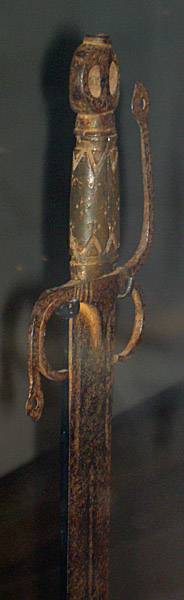

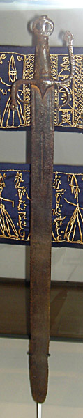

I thought I knew the London collections quite well, but know I tend to visit the same pieces and ignore the fields that dont necessarily interest me. So, I had never been to the African galleries in the basement of the BM. I happened down there today, in search of an answer to a friends question, and stumbled across a 16thC sword from the Kingdom of Konga. Severe Potuguese/Spanish influence (or even heritage, as the blade seems very European). Its hidden far behind glass, and is annoyingly displayed in front of patterned textiles, which confuses my digital camera.
But, it is definately very old and a sword with substantial presence. From its form and look, and have little doubt that the age attribution is correct.
Is anyone familiar with this sword, or ones like it from the same period in Africa?
The description card doesnt mention any provenance, and from the accession number, I think it a relatively recent aquisition. It just mentions the Portuguese in the Konga during this period.

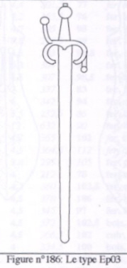

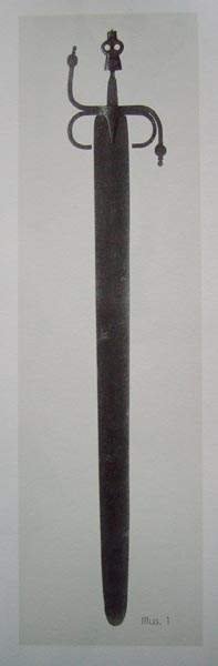

Hi Brian, is something like this?

Well done Flavio!
That is the sword! What information do you have on it?
I did take images, but havent had a chance to take the pictures off the camera. The images will be very poor due to glass and very dim lighting, but will post them anyway.
Is that Springs book? I have it at home, but dont know it enough to recognise an image from it. As his 'home' is the BM, I figure he would have something to say about the sword.

Posts: 1,243
Hello Brian, no this is Ijzerwerk van centraal-afrika (H. Westerdijk). This sword is from Congo tribe (tribe that is located near the congo-zaire river and the first that the Europen met when they "touched" the now a days Congo shores). For what I know these swords are 19th century old but for sure they copied the Portuguese older swords (see also this thread http://www.vikingsword.com/vb/showthread.php?t=4369) and they are more currencies than real weapons, but for sure there must be some older exemples that were the precedents of those that we can see today and that were real weapons
Edit: If I understand well (If the translator is correct ) in some examples the blades are imported from Europe and so at least some of these were real weapons and some still have some ivory pieces on the handle (and so no currencies at all). Where are our Belgian friends (Freddy!!!!) ???? The page is 66 (Groep X)

Hi Flavio,
It isnt my field, but I am pretty sure this is the real thing, and not 19thC. I couldnt get close to it, but it had all the asthetics of an old sword.
I think I will have to post the images later on, and maybe also get Marc and Fernando involved.

Posts: 6,006

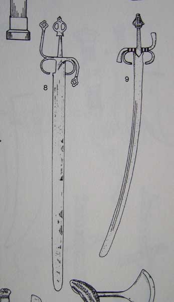

Some more from "Armes traditionnelles d'Afrique" Found around Congo and Angola. As mentioned based on old swords but not that old in themselves.

Posts: 485

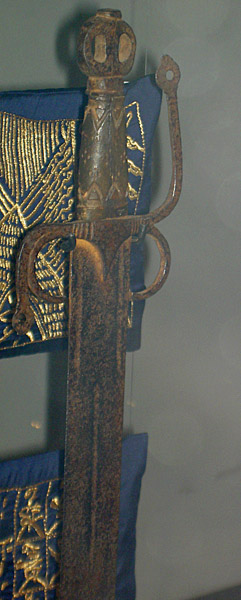

Very sorry for the delay.
Looking at it now, I have doubts of the 16thC attribution, due to the crude fullers. Look forward to other opinions.

Thanks for the pics, Brian.
The blade sure doesn't look european, 16th c. or else. If these were indeed produced since that time onwards in Africa, it could be from any date since then.
Funny... I wonder how many of the swords of that type presently labelled as "portugese" are in fact African...
Fernando, that bit of data about the portugese sailors making these swords for their personal use to explain their crudeness... ¿where it comes from? It would be good to have a reference for its origin.
Marc is offline   Reply With Quote

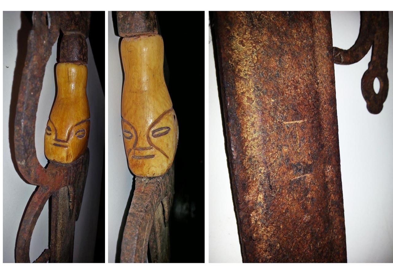

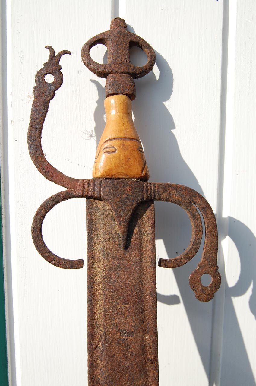

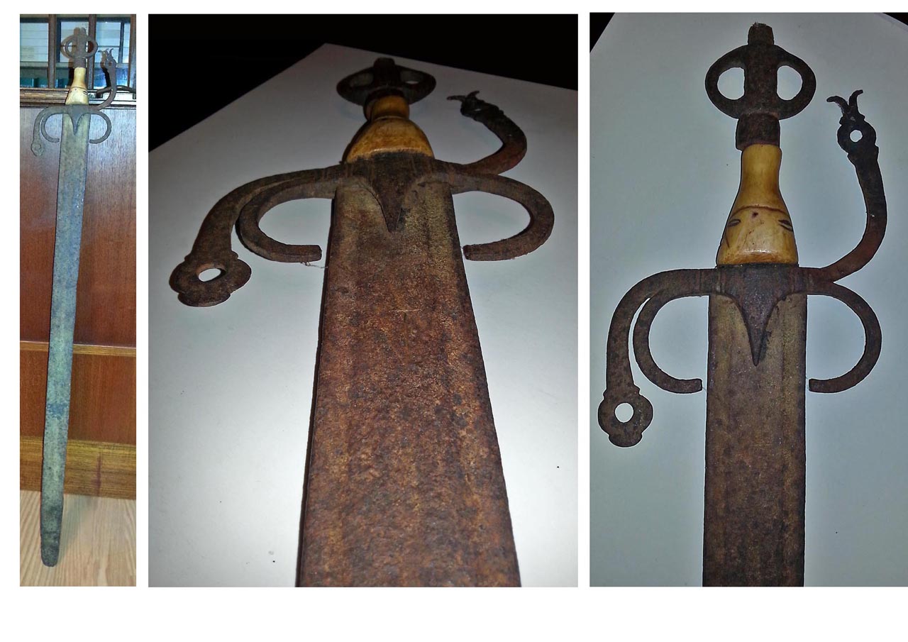

I just want to show you another example I recently obtained, "bought in Kinshasa in the 70ties". Probably a copy of a Portuguese XVI Century sword? Hilt is made of ivory.
Pieje is offline   Reply With Quote
Old 23rd October 2014, 12:46 PM   #18
Pieje
Pieje's Avatar
Join Date: Mar 2012
Location: Belgium
Posts: 143
Daylight pic..

Posts: 93
I've just searched the B.M. online database using the keywords Congo Sword, and there is an entry for it. The sword was only acquired by them in 1995 so strictly speaking the label should say "pre-1995", with maybe something added saying that the curators think it could be 16th Century.

Yes, it follows the same line ... except for the face on the grip
