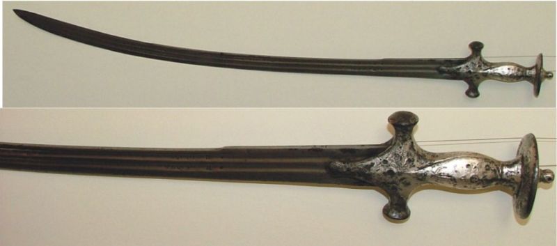

Dear Memnbers:
What is your opinion about the blade in this tulwar? Do you think it is European or rather Indian "mimic" work? The blade is non damscus, slightly curved 75 cm long, both sides 3 times marked GENOA. Thank you in advance for any comments.

Hi Husar,
I think it must be an Indian blade, as I don't think any European blade factory would have marked a blade three times on each side.
Nice tulwar and a nice used blade.

Posts: 80
I think you are right Jens, it look like somebody was trying to make this tulwar more expensive and went too far anyway I like it and it is well balanced

Posts: 2,658
Nice Tulwar....I have to agree with Jens ...I dont think this is a Euro blade either

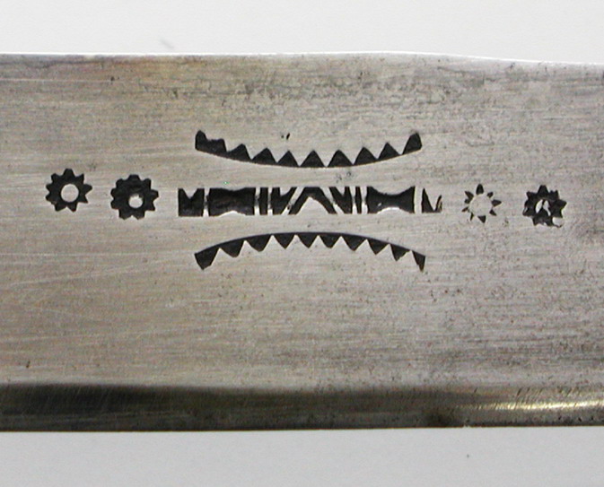

Old 2nd November 2006, 02:44 AM   #7
Rivkin
Posts: 655
As far as I know, "Genoa" is considered one of the possible "parents" of "gurda". According to Lenz "Marks on weapons" and Astvatzaturjan originally such mark was indeed placed on swords from Genoa, however then it was adopted by germans and later copied throughout the word.
The mark here does not seem genuine enough since "jaws" (two eyebrow-like lines) are too schematic. Locally made ?

Posts: 10,867
I completely agree with Jens, this appears to be a well made Indian interpretation of probably European sabre blades. The stepped blade near the base seems an Indian characteristic on some tulwar blades.
The 'Genoa' is an application often employed on numerous trade blades implying degree of quality and was often associated with the well known 'sickle' marks . These marks looking like toothed half circles in parallel often appeared with 'Genoa' or sometimes 'fringia' and without words as well, and are known to have used in Styrian and Caucasian bladeworks (where the term gurda denotes 'good blade' I am told).

Hello
Thank you for comments, now I`m more sure that this is not an European blade… According to GENOA marks or other mentioned by Jim please find some on the picture I have some blades on which is even wrong spelling as GNEOA and GANEA … Imported blades from Italy were very often used in Polish swords.

Hi Husar,
Yes it is a bit tricky, but thank you for the illustration. I am especially interested in one at the bottom to the right. Have alook at this one.

HI Jens
I just wonted to see blade construction, which reminds me european smiths hmm
the second mark near the hilt is with persian characters inside or?? I checked few of my books but I could not find the same marking I can only say that "stars" look simmilar to markings on one of my firangi swords.

Hi Husar,
The deep stamp close to the langet says 'Ibrahim', and at the back of the blade is another inscription.
