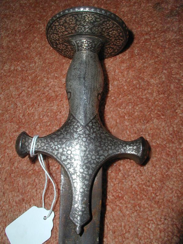

Been a while since I had anything new and then it all turns up. Traded for these three tulwars, all with silver decoration and would like to know any opinions on age and region by their style.
Cheers

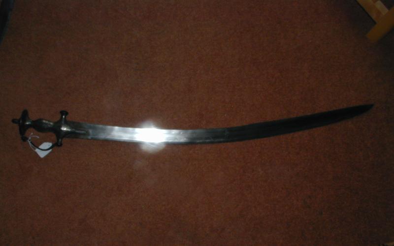

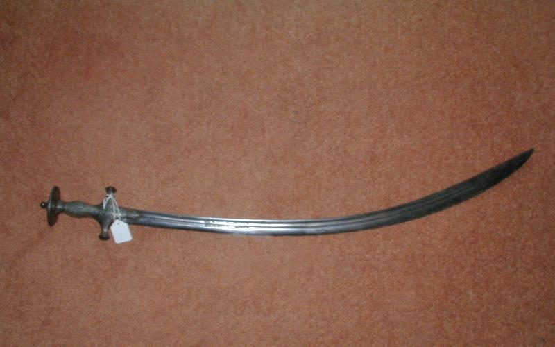

Default Blades
I hadnt botherd with these, as the blades arent always a good guide to the hilt, what with re-mounting etc
But as you ask, in the same order as the hilts.
Andy Davis is offline   Reply With Quote
Old 14th September 2006, 12:57 AM   #4
spiral
Posts: 1,712
Thankyou.
Very true, but I always figure the blade is the main & critical part , Its usualy the handles that come & go.
But others may see it differently.
I know nothing about them historicaly but I like blade one a lot. A great curve with well done fullers . very artistic.
I always think classic style is a good clue to value.
Thanks for sharing.
Spiral
