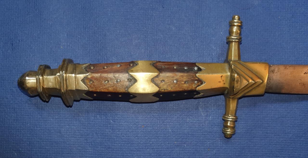

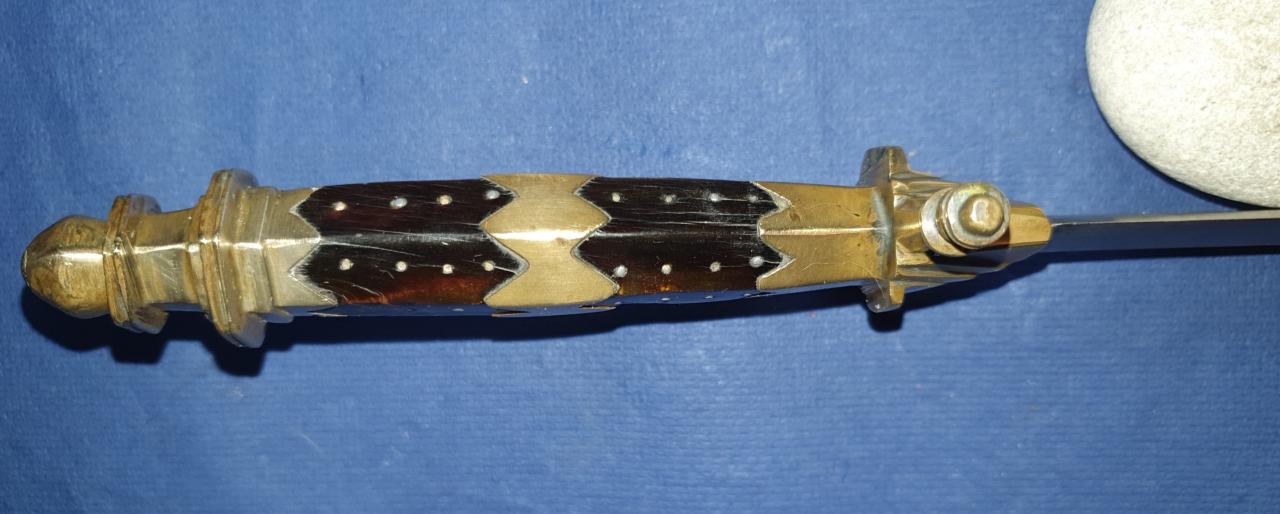

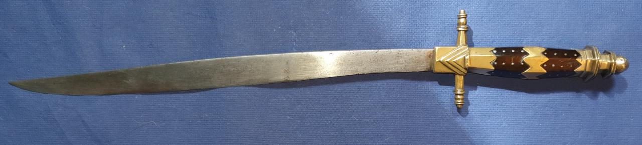

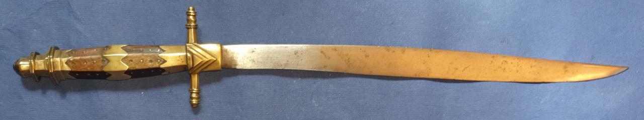

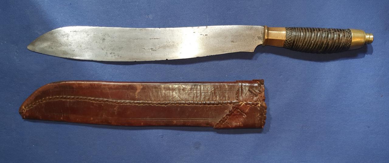

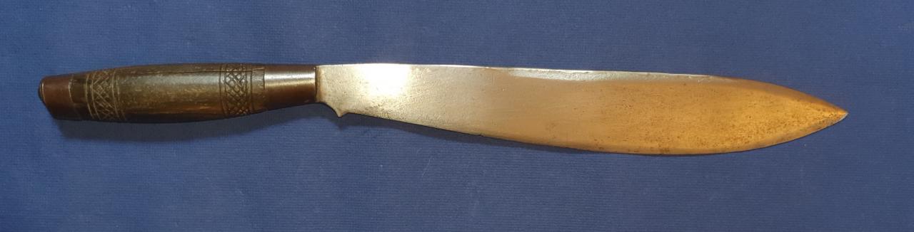

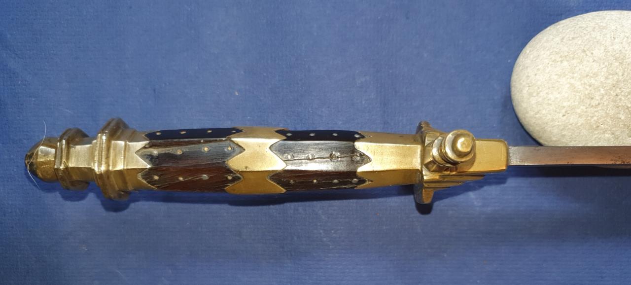

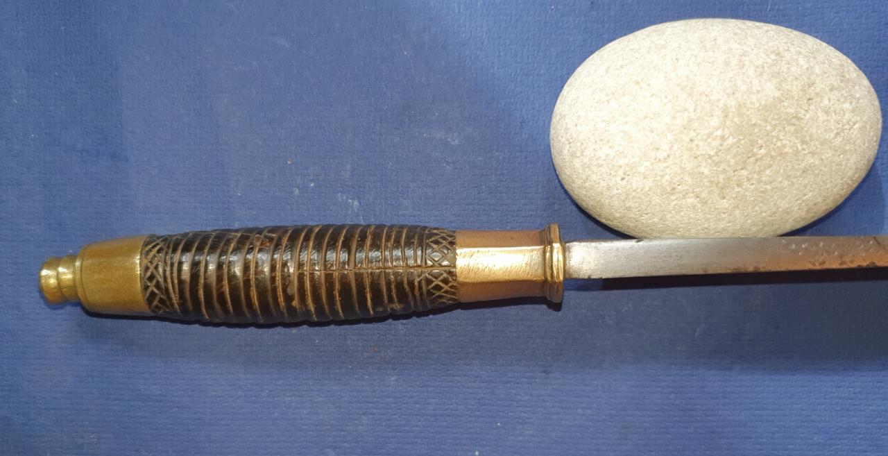

Here are two new additions to my Luzon collection. First a long dagger, 53,5 cm long, the blade is 36 cm long without the bolster, 7 mm thick at the spine behind the bolster.Horn handle interlard with metal nails and brass mounts. Maybe Ilocos Norte? Raymundo just told me that it comes from Rizal!

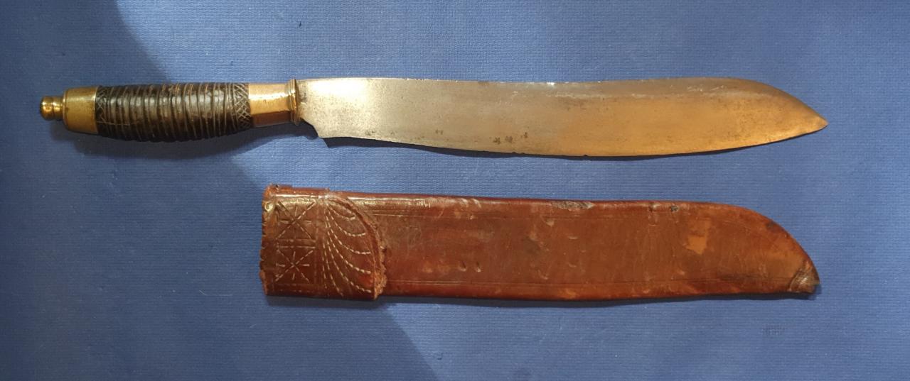

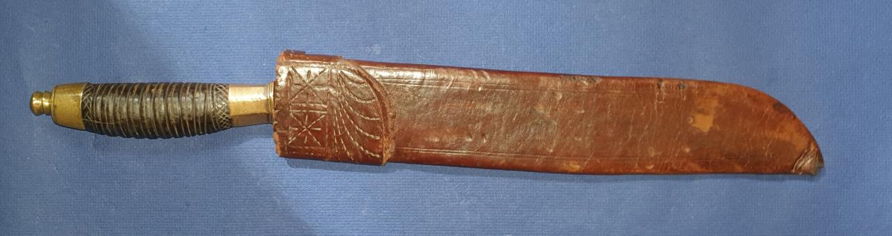

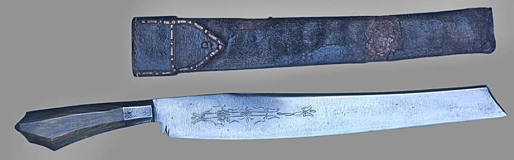

And here a nice heavy bolo from Meycauayan, Bulacan (my guess), mid. to end of the 19th century, I would call it tabak. 45 cm long inside scabbard, 44,2 cm without, blade 29,7 cm and 9,5 mm thick at the spine behind the handle. Horn handle with brass mounts. Raymundo just told me that it is either from Bulacan or Laguna.

Both are very nice. The handle of the top piece looks very heavy relative to the narrow blade profile, must be interesting to handle. For the second, is tabak a name for the style?
Old 3rd May 2026, 11:54 PM   #7
Thanks Jeff! Yes the weight is at the handle, it's a long dagger and can be handled like this.
Raymundo stated it!

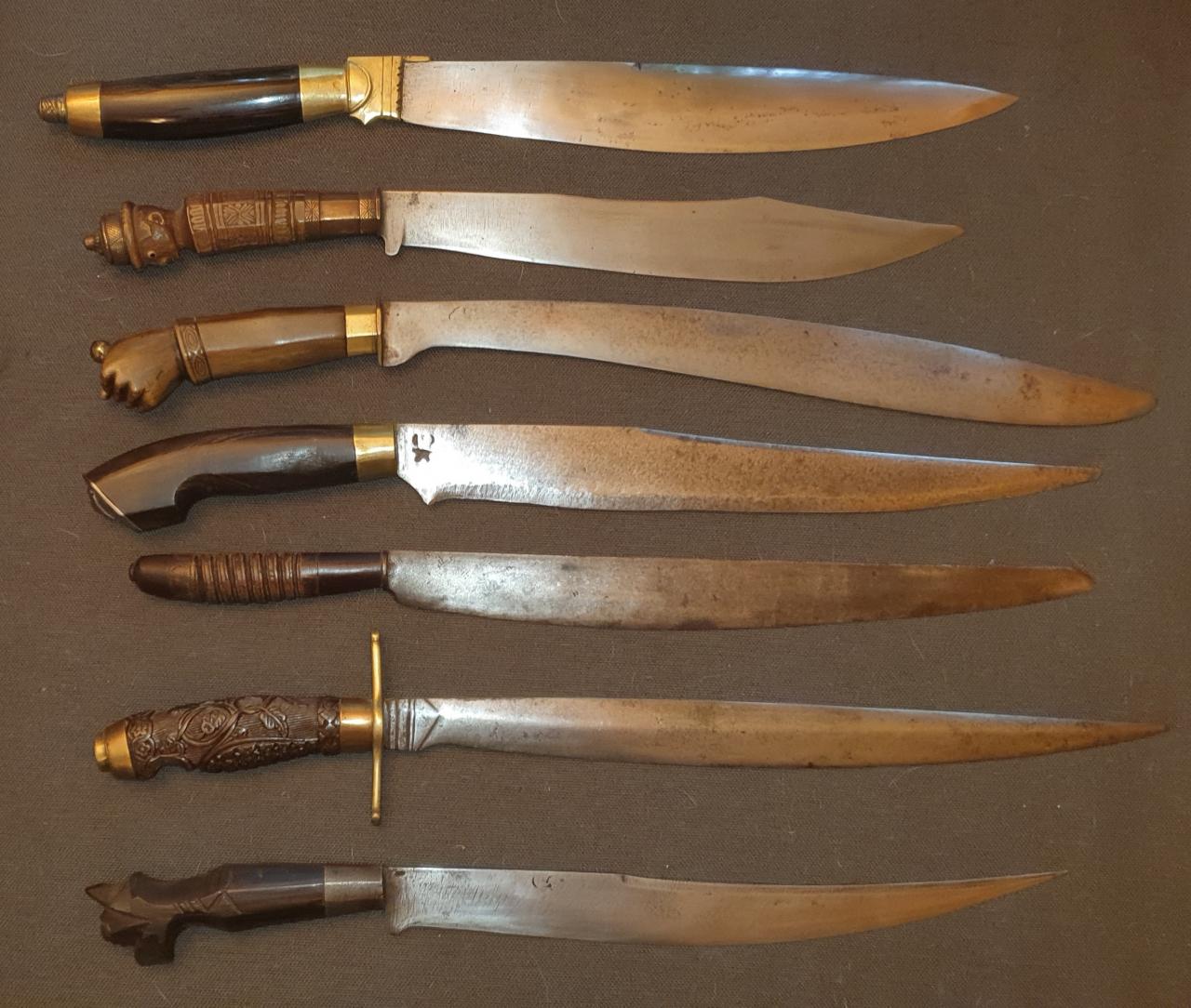

Here are several that you posted previously and I think it's helpful to keep them together because Xasterix added his expertise in assigning origins for them also. Here are the identifications that he settled on a couple of years ago:
1. Quezon
2. [correction] Pangasinan
3. Pampanga
4. [correction] Bulacan OR Pampanga
5. [correction] Northern Luzon
6. Quezon
7. Pangasinan
Ian.

More excellent additions to your Luzon collection of Spanish colonial knives from the 19th C. Congratulations!
1. Quezon
3. Pampanga
6. Quezon
7. Pangasinan
Thank you Ian,
Will soon post a new overview, there is also this piece in the pic, a Pangasinan katana, which will come to me tomorrow.

In looking at the pictures copied from an earlier post, I notice that items 1 and 7 are listed as coming from Quezon. Both have interesting treatments at forte. No. 1 has a brass overlay on to the blade that extends from the guard. No. 7 has file work at forte that includes transverse lines and a chevron.
Now look at the forte on your first post in this thread. It too has an extension of the guard down on to the forte of the blade, showing transverse lines and a chevron. It appears to combine the features seen on knives 1 and 7 from the previous topic. Quezon influence on the one posted at top of this thread?
It is VERY hard to distinguish local characteristics on Luzon knives.
Ian.
Hi Ian,
I think you mean No. 6 instead of No 7?
Ray told me that the triangle at the brass guard and the handle inlay are the give away for the Rizal origin.
Personally I think that these brass guards with decorations are a question of age and quality but that's my guess only.
Indeed!

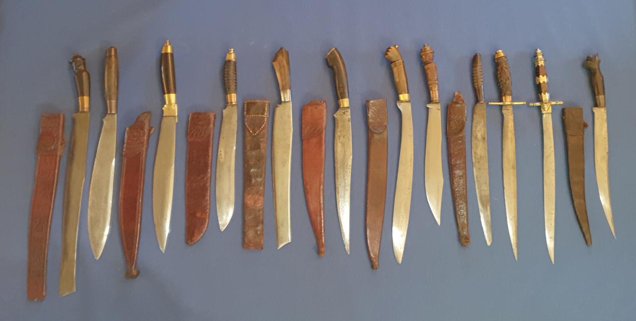

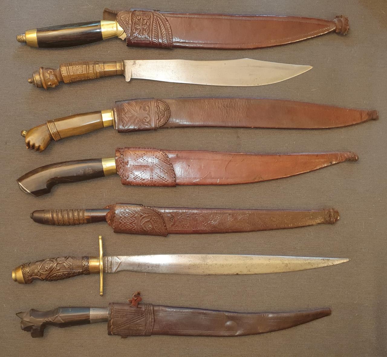

Here is the new overview, bolos and long daggers!
Description from the left to right:
1.: A long bolo or short sword from Ilocos Sur, Tabak, Katana with Sinan Kapitan hilt, 1. quarter 20th c.
2.: A bolo from Tayabas, Quezon, blade Dahong Buho, first quarter 20th. c.
3.: A bolo from Tagalog/Pampanga, around 1900
4.: A bolo from Meycauayan/Bulacan, blade Tabak, mid. to end of the 19th c.
5.: A bolo from Pangsinan, blade Tabak, mid to end of the 19th c.
6.: A bolo from Bulacan/Meycauayan, 19th c.
7.: A bolo from Apalit/Pampanga, blade Palong, 19th c.
8.: A bolo from Calasiao/Pangasinan, Sinan Kapitan hilt, around 1900
9.: A bolo from the Tagalog area, Rizal(?), blade Putol na Dahong Kogan, mid. to end of the 19th c.
10.: A long dagger from Tayabas/Quezon, blade Matandang Dahong Palay, 19th c.
11.: A long dagger from Rizal, end of the 19th c.
12.: A long dagger from Calasiao/Pangasinan, blade Barang, around 1900
Again a great "thanks" to Raymundo who shared his knowledge with me!

I would add that from left to right, #7 with the fist is probably Katipunan with albino carabao horn.
Old 11th May 2026, 07:51 AM   #19
Hi Jose,
Yes, the handle is from albino horn like by #8 also. And yes, possible Katipunan.
