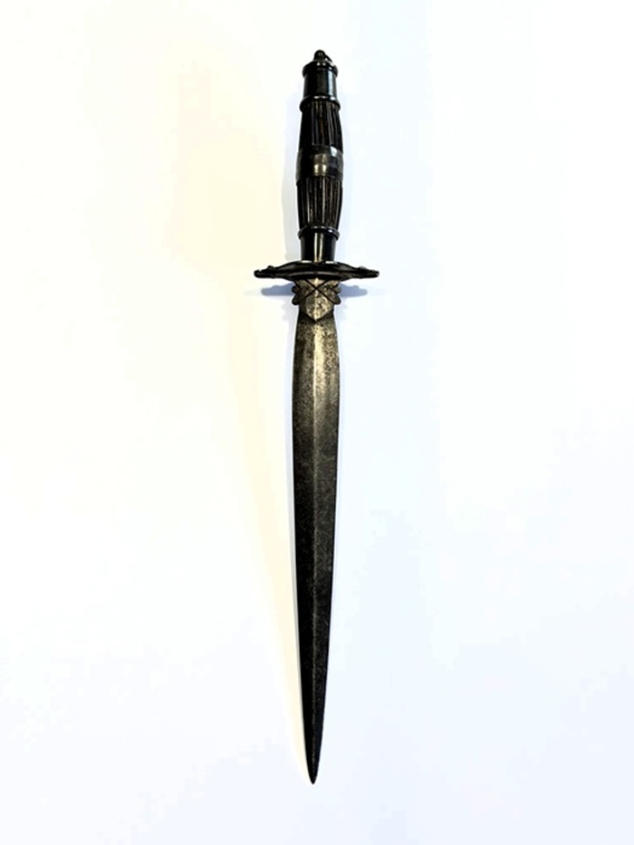

With that being said... below are 3 such pick-ups. I believe all 3 are Asian(?) in origin, but I'm not 100% sure. I've only been able to "ID" the central piece as that of being from the Philippines(?) circa, 19th C. The blade is steel and the grip and its mounts are made of horn and silver (tested positive as such). It's 14 inches in length and is the largest of the group.

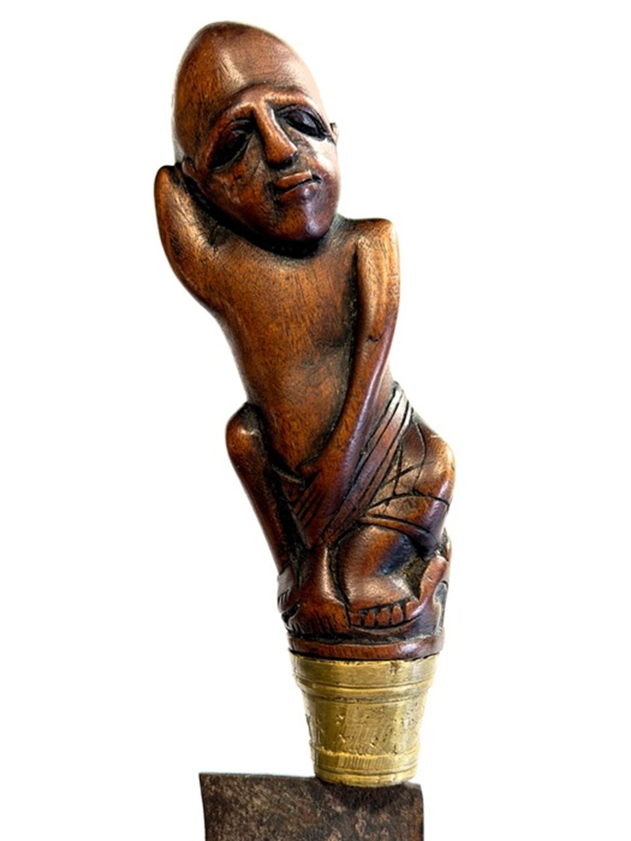

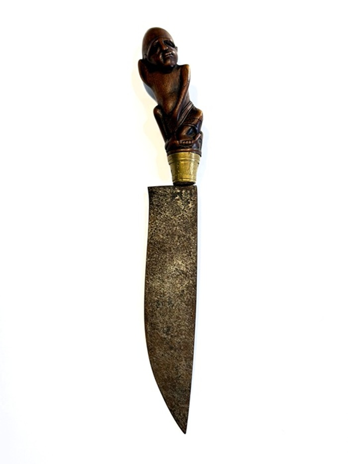

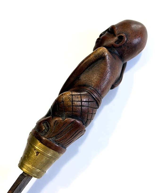

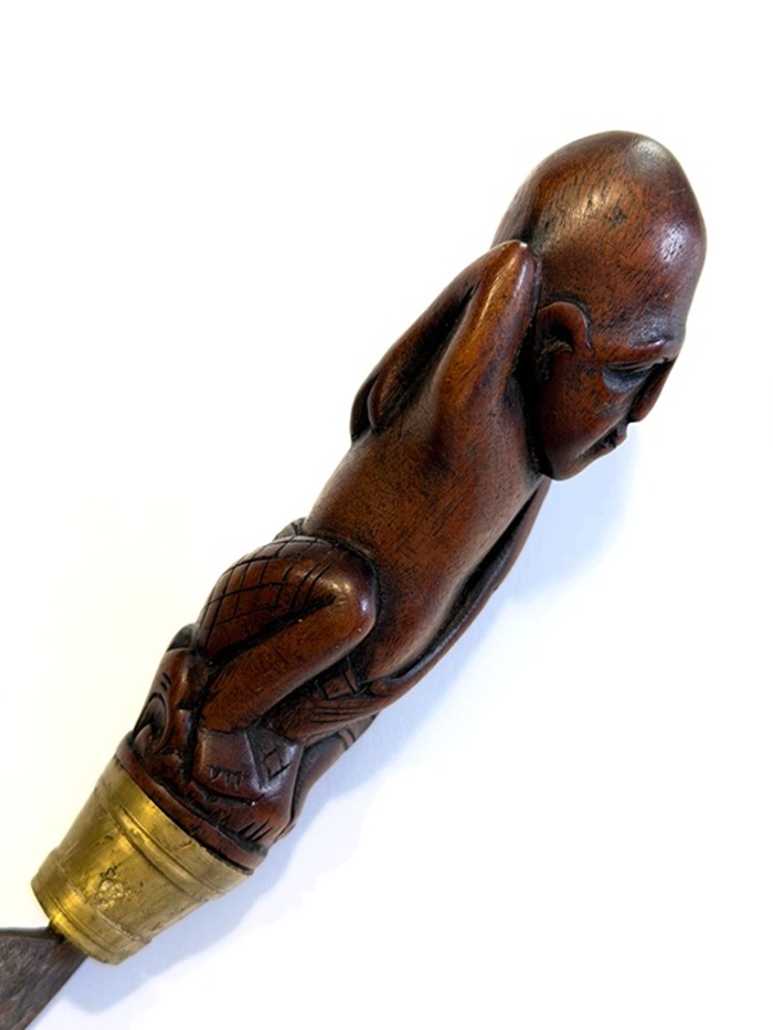

The other having a metal blade, with the grip being in a figural form, made from carved wood and brass.

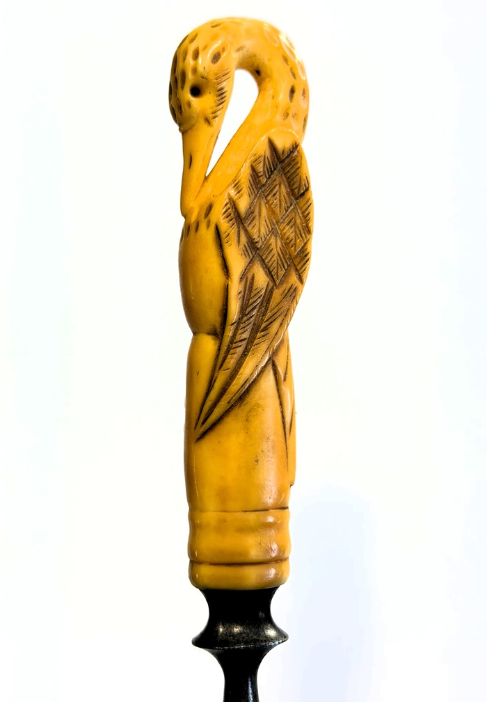

The last has a spike-like octagonal steel blade with a carved bone(?) figural grip of a bird. It appears to once had inset stone(?) eyes but are now lost.
Can someone please help me ID the who, what, where, when, etc. of these daggers? I'd very much appreciate it and your time. Thank you all in advance! Kind regards, Jo

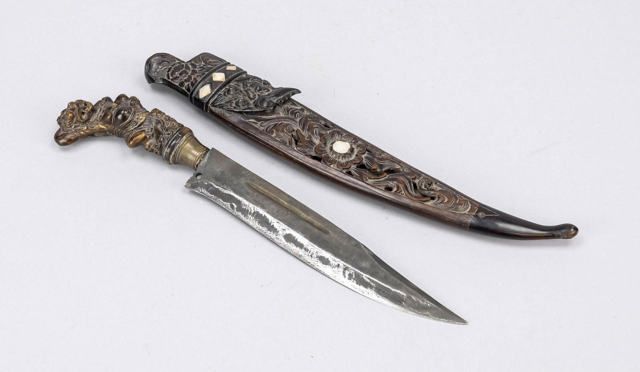

Old 14th February 2026, 09:13 AM   #3

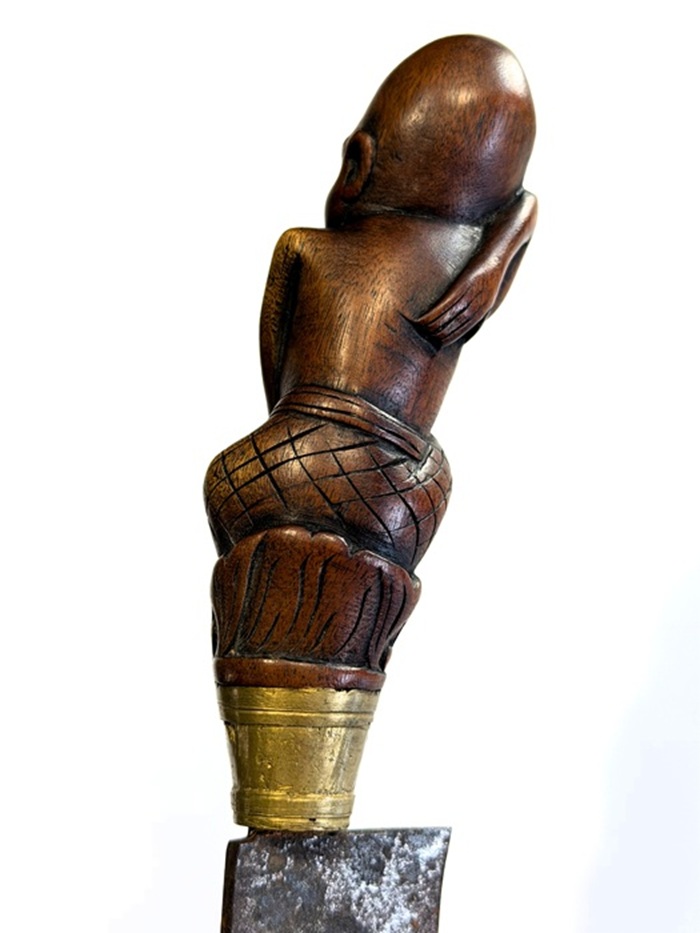

Hello Jo,

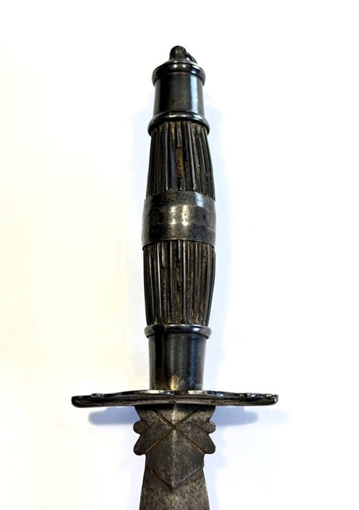

Yes, you are correct, the middle one is a Luzon dagger, a very nice one!
The one on the left isn't a dagger, it's a knife from Bali, I would say that it's belongs to the tiuk pengentas family, see here: http://www.vikingsword.com/vb/showth...=tiuk+pegentas
I've attached a similar knife from my own collection.
Can't say something about the third knife.
Old 14th February 2026, 01:36 PM   #4
Posts: 4,738
hi Jo,
I agree with Detlef about the one on the left and the one in the middle.
The central one is a Spanish Colonial knife dating from the 19th C or a bit earlier. The quality of workmanship is good and the blade might be Spanish, but probably made locally. The hilt is of a Spanish style from the late 18th-19th C and matches many Spanish/Spanish Colonial knife hilts of that period with its three part form (full tang, ferrule-grip-ferrule) plus a cross guard. This knife is most likely from the Philippines, but Mexico cannot be excluded. If the knife came with a sheath it would provide a clue as to region of origin.
The third one is harder to place. The blade is, I think, a former spear head mounted with a hilt. The blade appears to be well forged, and considerably better than village quality. My first thought was mainland SE Asia or Malaysia. The carved bone (?) hilt representing a bird reminds me of Chinese representations of herons in art works, although the bird in your piece seems to be a swan or duck. I'm hoping some of our long time collectors of SE Asian weapons might recognize it.

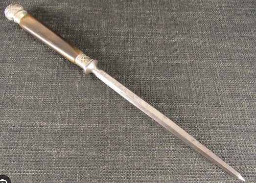

Love the middle one! And for what it's worth, my first impression on the faceted spike was a sharpening steel. Usually round/oval but faceted and even somewhat fullered do exist.

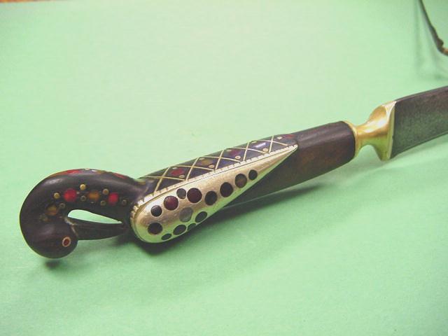

Default Looks Familiar
Quite like a Lebanese handle.
http://www.vikingsword.com/vb/attach...1&d=1771021532
http://www.vikingsword.com/vb/attach...1&d=1236642174

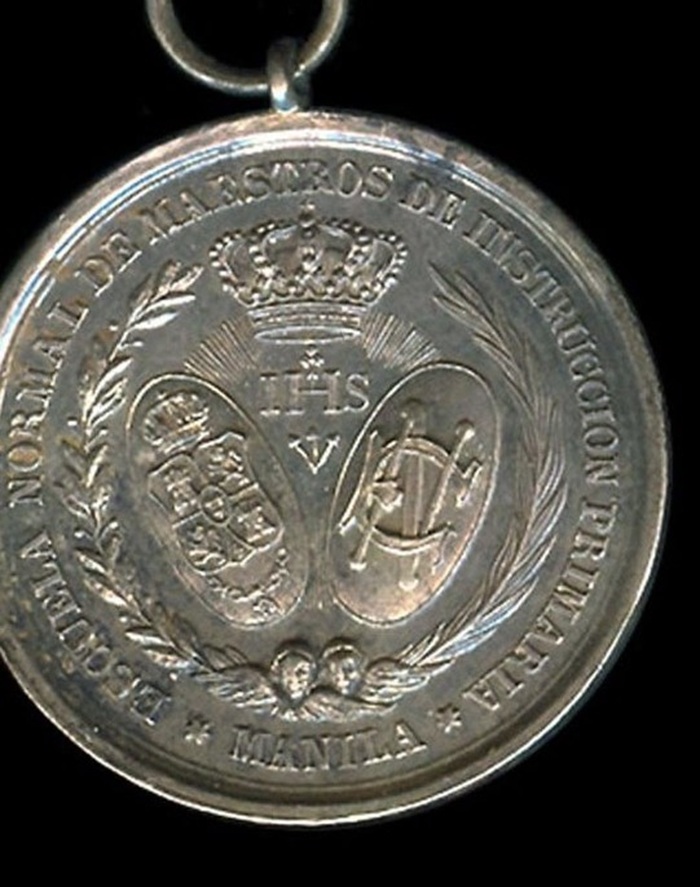

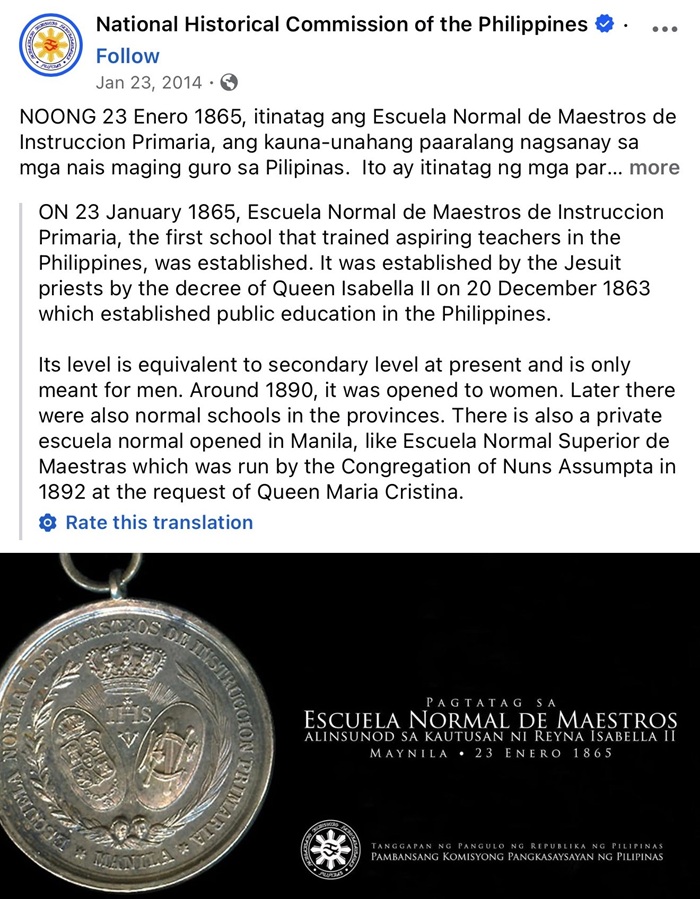

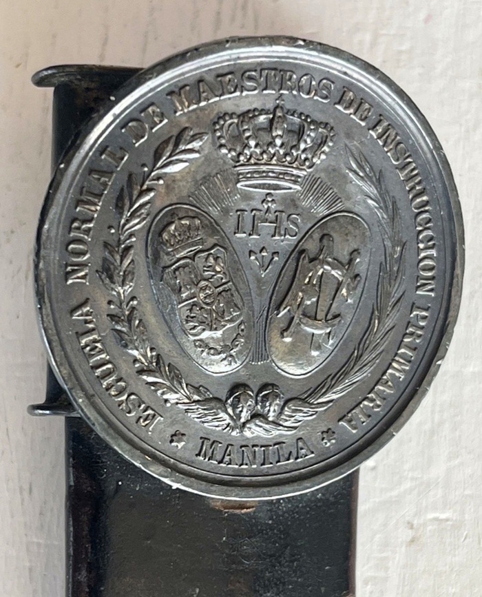

"If the knife came with a sheath it would provide a clue as to region of origin."
The Spanish/Philippines example was the only piece that came with a sheath (silver mounted hide, partially damaged), but I didn't want to post it as I didn't want the latter(?) attached silver medal (as seen below) to distract from the overall evaluation of the dagger itself. Meaning................... I didn't want board members to focus their attention on the medal as opposed to the overall construction and craftsmanship of the dagger itself. I wasn't 100% sure if the dagger was/is Spanish/Philippines until I got confirmation from a group of experts such as yourselves.
The medal appears to be a later(?) attachment or possible original(?) given as a gift of achievement or honor, not really sure.
JISX is offline   Reply With Quote

A sharpening steel is an interesting suggestion, although I don't recall seeing such an acute point on a carving steel before.
Just to follow up on the Chinese-influenced suggestion on the third hilt, attached are artistic representations of cranes. The circled examples show the head and neck in similar positions to the carved hilt. I'm not suggesting that the head on your hilt is that of a crane, but simply that the artistic style is similar. This is not uniquely Chinese, as Rick has shown with an example of a pheasant on a Lebanese knife hilt.
Regards, Ian
