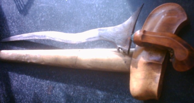

Please, could you ID this keris. It is real weapon or touristic thing?
The blade is very slim.

Thumbs up Real weapon...
Looks like a real weapon to me (of the Kodi variety), Javanese Surakarta form.

A real weapon also for me (mybe a patrem..)

I doesn't appear to be a "tourist" type keris at all, though it does seem unusually thin at the gonjo (could just be the pictures).
Since we don't have any demensions i am not sure why Marco would suggest this could be a patrem (women's keris).
What are the demensions of this keris.

Originally Posted by David
It doesn't appear to be a "tourist" type keris at all, though it does seem unusually thin at the gonjo (could just be the pictures).
Since we don't have any dimensions, i am not sure why Marco would suggest this could be a patrem (women's keris).
What are the dimensions of this keris.
I guess Marco suggested that it's a patrem, due to this blade length is only approx. 2 times the size of the hilt.

A Fairly old keris in my eyes.
based on this photo's:
Its old, and not a tourist piece.

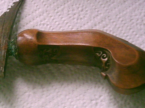

The dress is indeed a surakarta style ( Solo ). Looking at the form and shape.
Although the mendak(ring between the handle and the blade) seems to come from Madura.
With old keris, you can almost never speek of original fittings, but i think it is important that the blade fits good in the sheeth.
The dapur: The name of model of this blade with 3 curves is (according to Tammens) : Lara Sidua,Note that second curve must be in the middle. I cannot good tell from this photo's

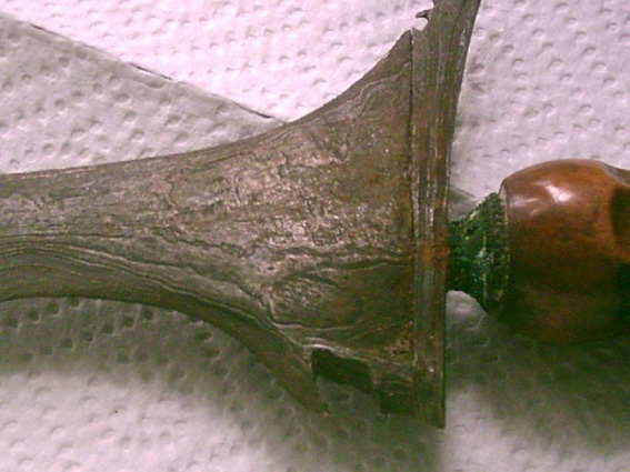

The patrorn Welding (pamor) of the blade is good visuable.
The name of this pamor is Kulit semangka ( watermellon skin)
So, a real keris...of course a keris can be used as a weapon, but has developped itself during the centuries as more than that.
The owner who let it make could have other intentions than buying a waepon, for example status symbol or Talisman. But thats a different discussion.

Hi Simatua, it had been quite sometime... since last post.
Looks Surakarta to me, mendak Widengan.
The dapur: The name of model of this blade with 3 curves is (according to Tammens) : Lara Sidua, ...
The name of this pamor is Kulit semangka (watermelon skin)
The dapur does looks like Lara Sidua. Picture is too blurr to determine the pamor. The left side of the blade seems to have straight lines right to the tip of the blade, though.
As simatua said, better picture would help to give more details.

Lenghth of the blade - 34,8 cm
Lenghth of the hilt - 10 cm
Thikness of the blade at the hilt - 8 mm
Sommelier is offline   Reply With Quote

David, you are correct. A standard sized keris. Free trip to Bermuda Triangle or Hotel California...
