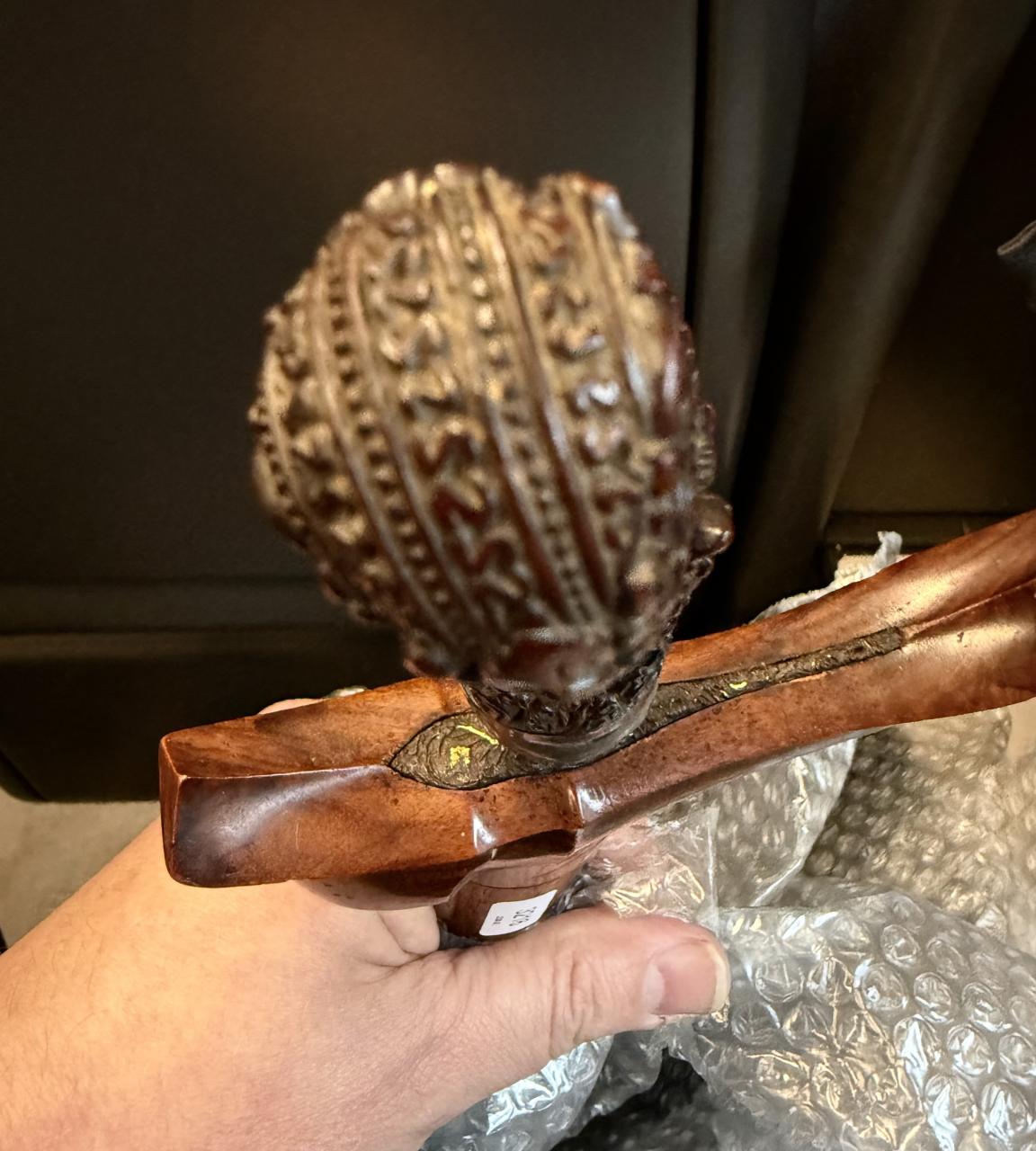

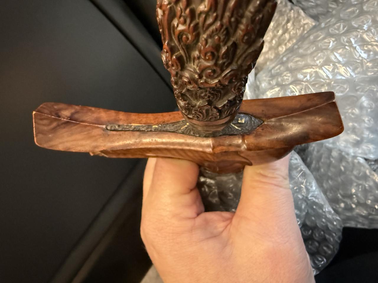

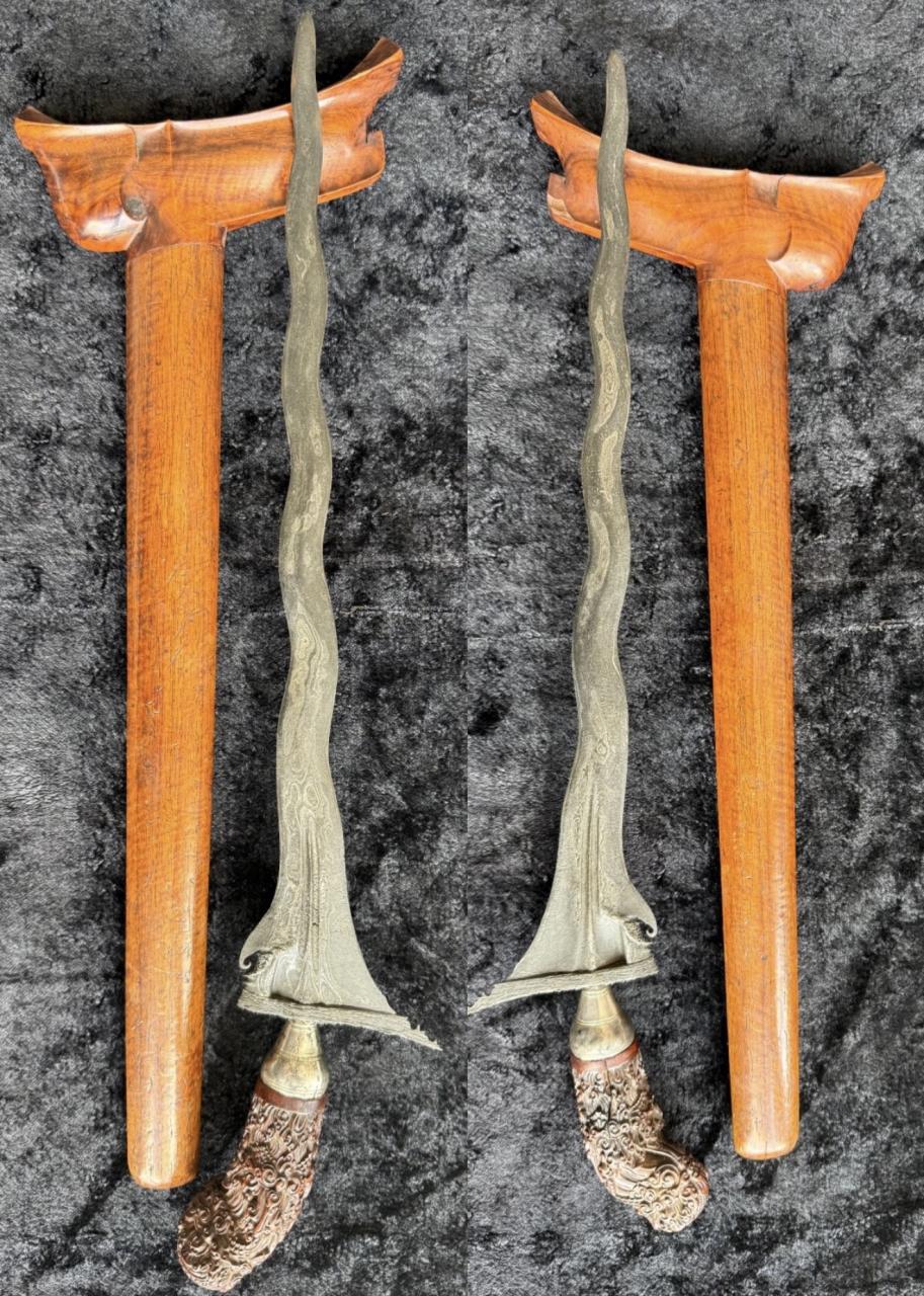

I like to share two pictures of the keris that i won tonight in an auction and will pick it up end of this week.
It was stated Indonesian Keris but the dress is Palembang, and the ukiran is imho Madura
So the blade is in need of a washing, is the blade Madura too? Or is this a mariage ?
Hope to hear from the experts.
Regards, Martin

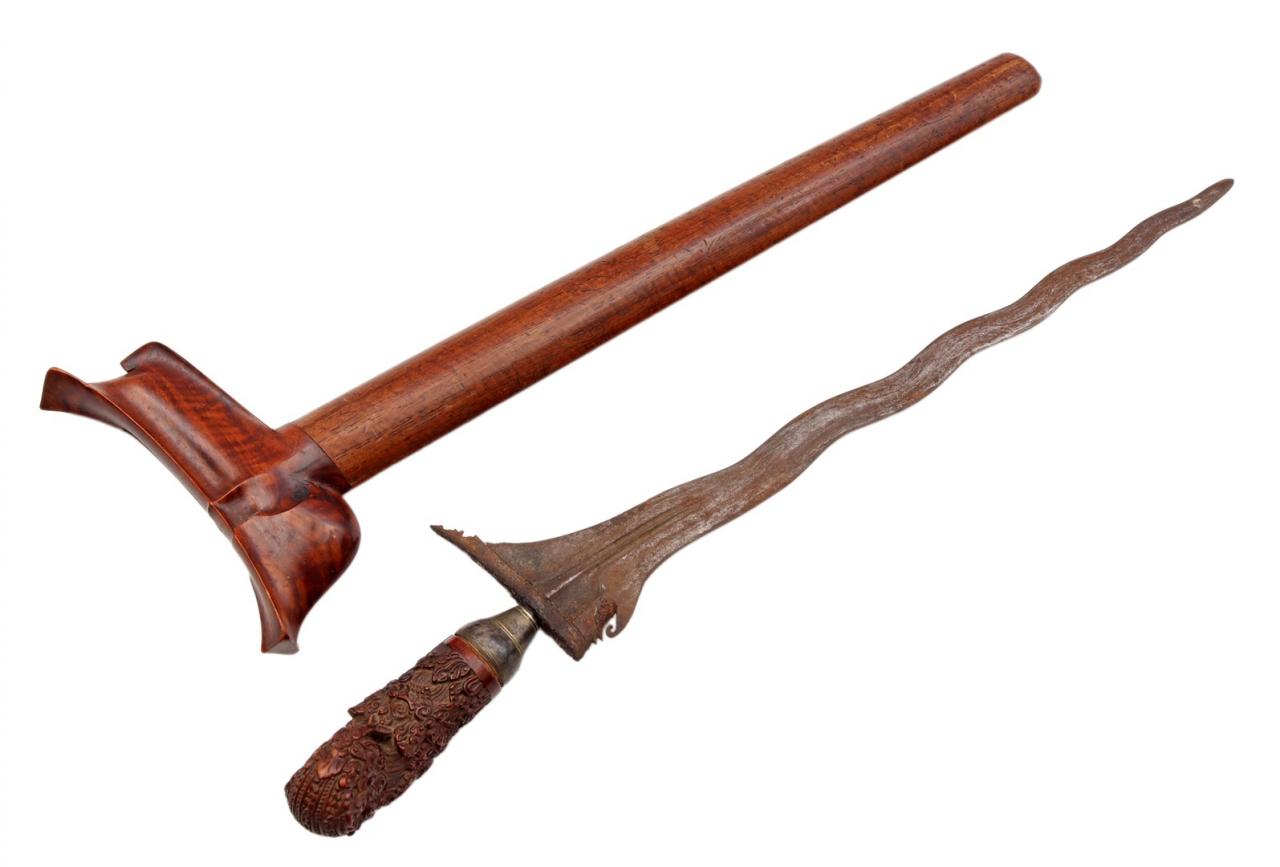

Hi Martin,
Now I know who bid me out! The blade is Palembang too IMO. When you look close you will see that on top of the gonjo and the gandik area had once kinatah. The hilt is North-East coast of Java, not typically Madura.

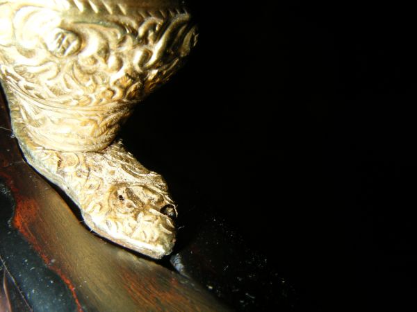

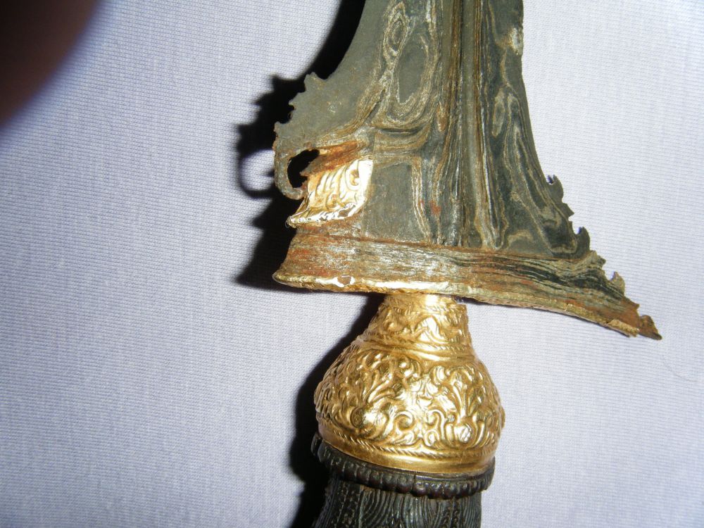

The kinatah work will have looked like this.

Yes, I agree that the hilt is North coast Jawa, & tending towards the east, however, the selut is typically Palembang.
Historically there have been very close ties between Jawa & Palembang. Palembang Keris blade style follows Javanese style very closely, & frankly, I cannot tell from a photo the difference between a blade that might be Palembang, or that might be Jawa or Madura. I would need to handle it & even then I might not be certain.
This keris could be a marriage, but then we need to consider the historical ties and the fact that it is in a Palembang wrongko. Maybe it is not a marriage. If it were mine I'd leave as is. Lots of mix & match examples of keris exist that are true to the area from which they come, not put together somewhere else.
There is something else too. In recent years current era Indonesian collectors & dealers have been trying to promote the recognition of a "tangguh Palembang". In my opinion this is a total impossibility, for the very simple reason that there is no uniquely Palembang blade. A genuine keris Palembang, in the sense of a keris put together in Palembang for wear in Palembang can have a variety of different blades used, including Bugis, Javanese, Peninsula & still be the real deal. The old Javanese tangguh system does not recognise a tangguh Palembang.

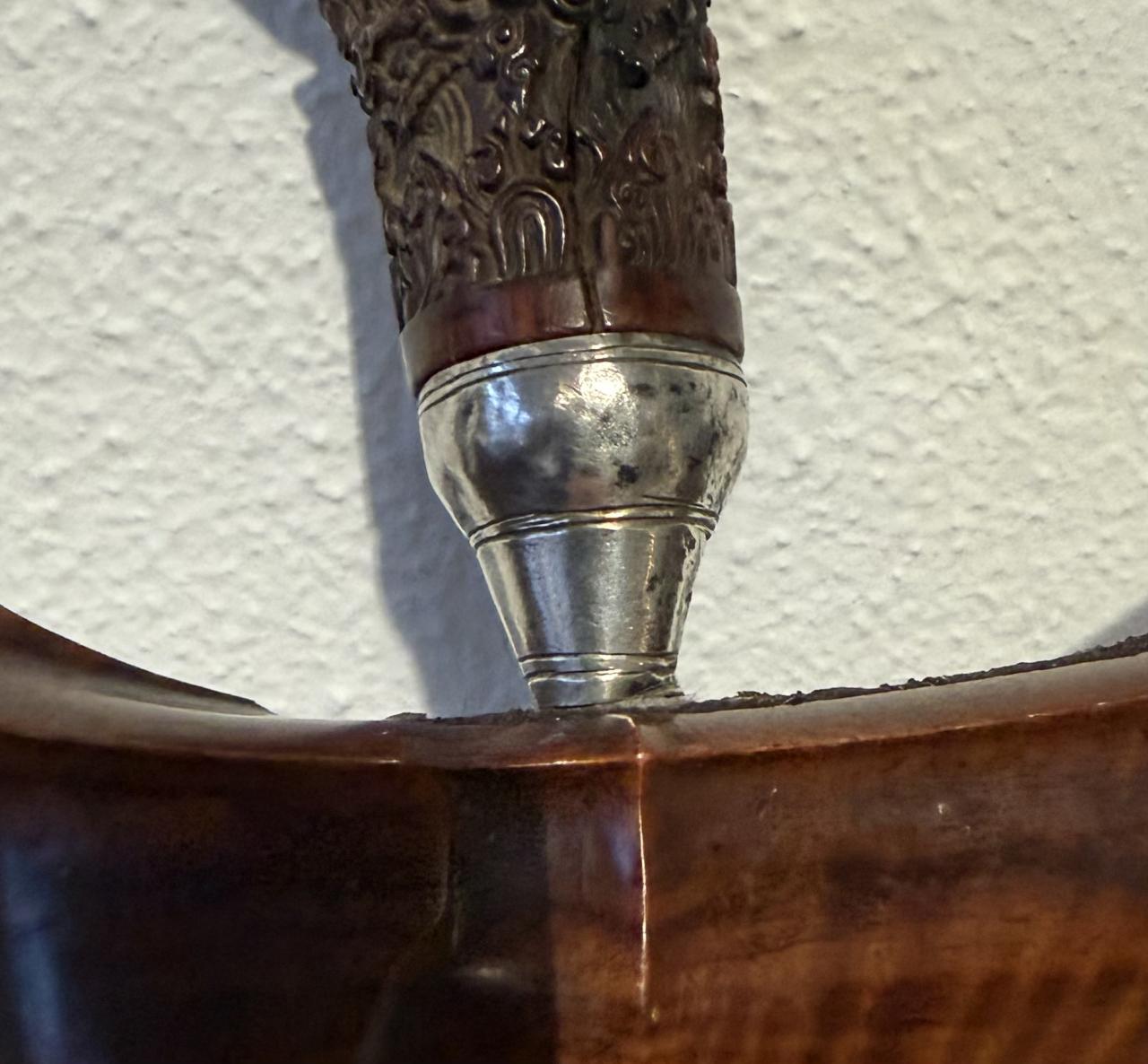

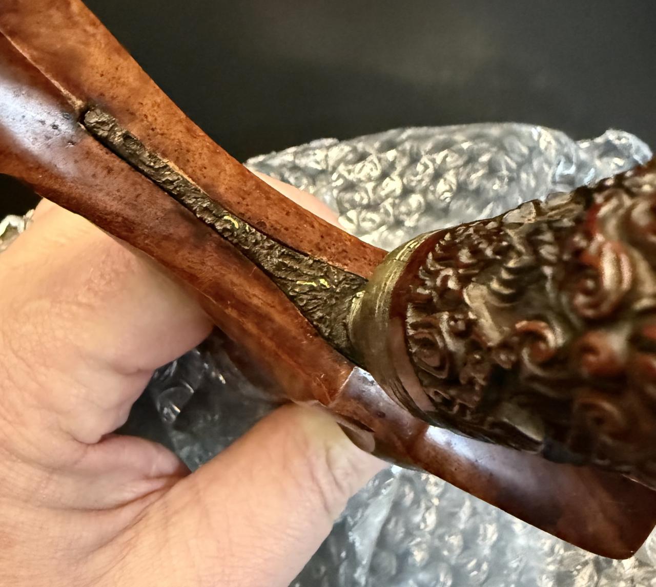

So I am in the train back home after picking up the Keris. And could not resist to share two pictures of the fitting of the Keris and the last remains of the Kinatah.
I think the fit is beautiful.

It seems very likely indeed that this Palembang style sheath was indeed made for this blade. As for the hilt, it could have been a later addition given it's North Coast origin, but since the selut is clearly a Sumatran style i would be inclined to think that this ensemble is a legitmate Sumatran one rather than a dealer marriage. Have you determined the material of the selut yet. Could be silver. Seems you got yourself a fairly nice Sumatran keris there with a nice Ganesha hilt. Shame the kinatah is gone, but not the worst thing. Congratulations!

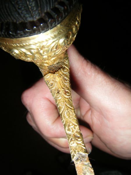

Martin, I do not know what the "best" method is to derust ferric material, I only know what i have been using for about 70 years now, & that I find to be unfailingly satisfactory, & that is vinegar. I believe the complete method has been put into this Forum a number of times, so I will leave it at that.
However, if you do use the vinegar soak method, it is probable that you will lose those last remaining little specks of gold. This would not concern me at all, but it might possibly concern you & some other people.

Thank you Mr. Maisey and yes i was thinking maybe to cover the gold with a varnish before soaking it. Detlef also advised me to use a diluted vinegar.
I will see this week what i will use,

Well, one way opr another i would say that you must attend to the rust problem as it will only get worse on it's own, not better. I have never tried covering with varnish, but it might be successful. For me, preserving the iron from further destruction through rust is more important than saving the last bits of gold. Trying the varnish may indeed be a good solution. There doesn't seem to be much rust where the last bits of gold are on top of the gonjo.
Old 7th February 2026, 01:28 AM   #17
Posts: 7,263
Martin, all I use is just ordinary household white vinegar.
I get the blade as clean and oil free as possible first by washing with dishwash liquid, then I put it into a wall paper trough --- that which is used for hanging wall paper --- cover it with vinegar & take it out daily to brush under running tap water. Any little bits of hard rust I pick off with a sharp tool, a little pocket knife blade works OK, I use a saddlers awl.
I have tried cleaning vinegar , its supposedly stronger, but to me they both seem pretty much the same & cleaning vinegar is twice the price of the cheapest ordinary white vinegar.
I can see no point at all in diluting the vinegar, but in the past I have added a bit of hydrochloric acid to it, didn't seem to make much difference, if any at all.
When all the rust has gone I rinse thoroughly & drench with WD40, that is, if I do not immediately stain with warangan. Sometimes an old blade will come through the vinegar clean process with the pamor already good enough for viewing.

Electrolytic derusting is a safe, effective, and non-destructive method for removing iron oxide from steel and iron using a 12V DC power supply (like a car battery charger), water, washing soda, and a sacrificial anode

I've just AI'd it, & it does seem to be pretty effective, however, boring down into the details, it does seem to have some limitations.
It is something that I would never use, simply because of the playing around that needs to be done, the power source & etc & etc. What I do with vinegar is safe, effective, & no problem, the vinegar definitely does not cause any deterioration of the unrusted material.
However, for somebody with lots of time who enjoys playing with these sort of things, I think it could be quite an interesting method to use, & it does seem to be quite effective.
HARD RUST
the hard rust that we often encounter on an old blade is picked off with a sharp tool, see Post #17. This does not damage the blade surface in any way, the rust is simply gently removed & the blade goes back into the vinegar to clean up the residue.
I once spent about 12 months cleaning a Balinese blade that had very beautiful, original warangan, but was peppered with tiny pinholes all of which had rust in them. I worked an hour or so at a time, most nights, using magnification, strong light & various needles, I picked all the rust out of every hole. I still have that blade, still with its original warangan.

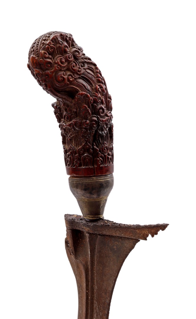

Last week I washed with a friend the Palembang Keris I showed above.
I am very happy with the result
Pendita65 is offline   Reply With Quote

This is just a vinegar wash? It looks like the result of cleaning a lightly rusted blade with vinegar. Is this correct?
If you intend to stain it with arsenic you should bring the blade back to white before you begin the stain process.
