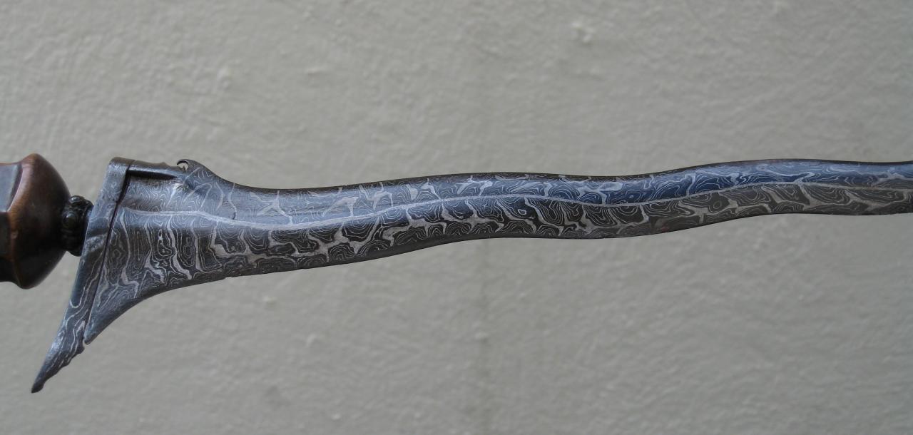

Default Twisted rods

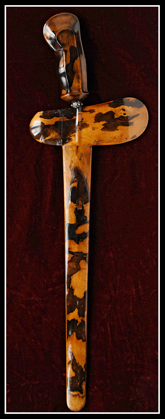

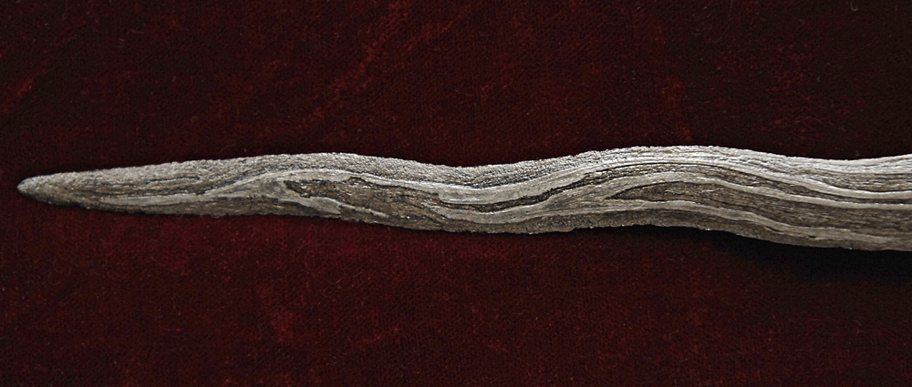

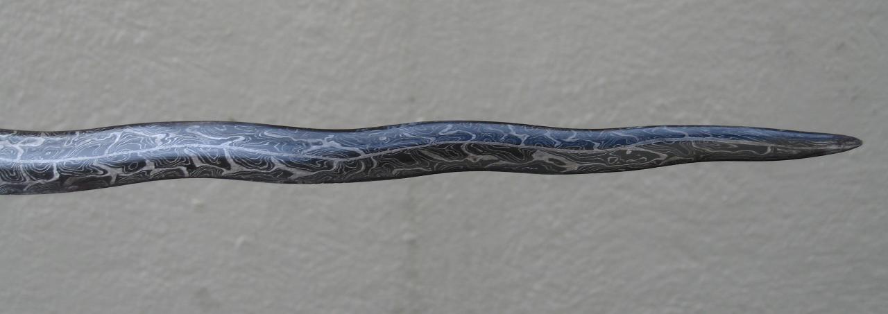

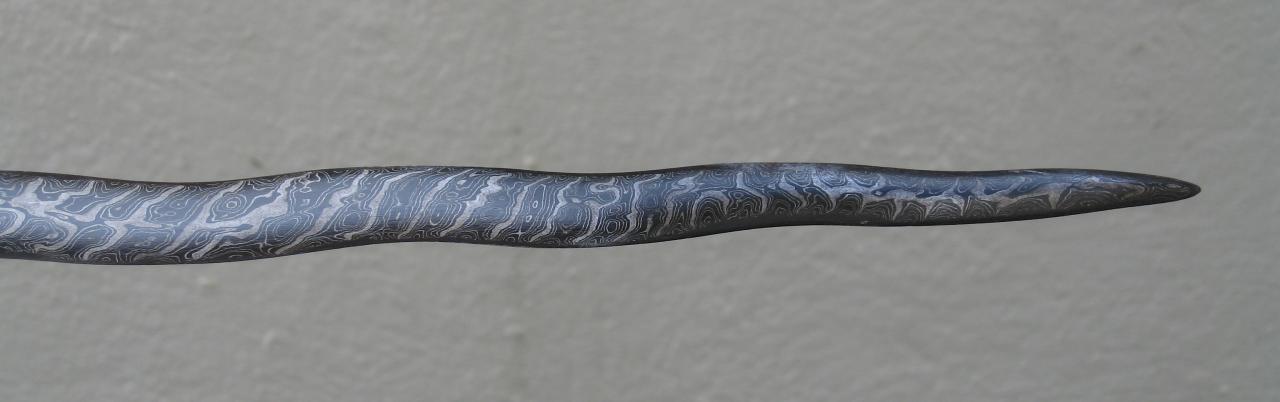

Dear Kerislovers,

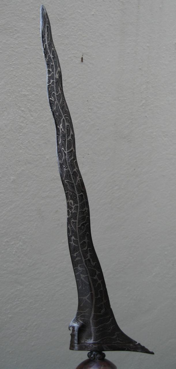

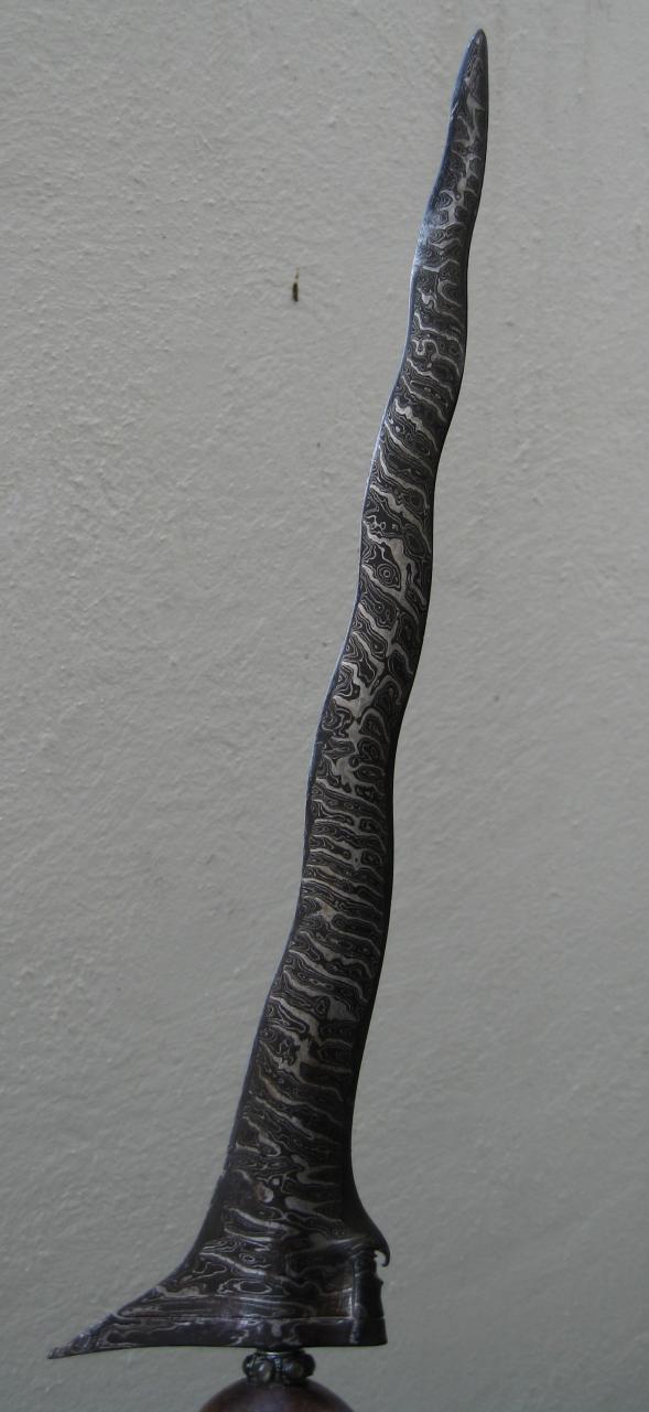

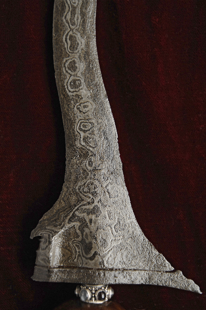

today an interesting blade was auctioned. The sheath likely is not made for it. What are your thoughts about the origin of it - East Java, Bali, or Lombok?
Is there something about such Pamor Tangkis, with two rods on one, and one rod on other side?
Old 21st November 2025, 09:16 PM   #2
Posts: 7,413
Based on what I see, I was thinking on Bali.....
Old 21st November 2025, 09:32 PM   #3
Posts: 7,235
Interesting thing you've posted here Gustav.
I'm sorry, but to make any comment on this I would need to handle it, & even then I might not be able to understand what I would need to understand before commenting.
In respect of overall perceived point of origin, yes, this does imply Bali.

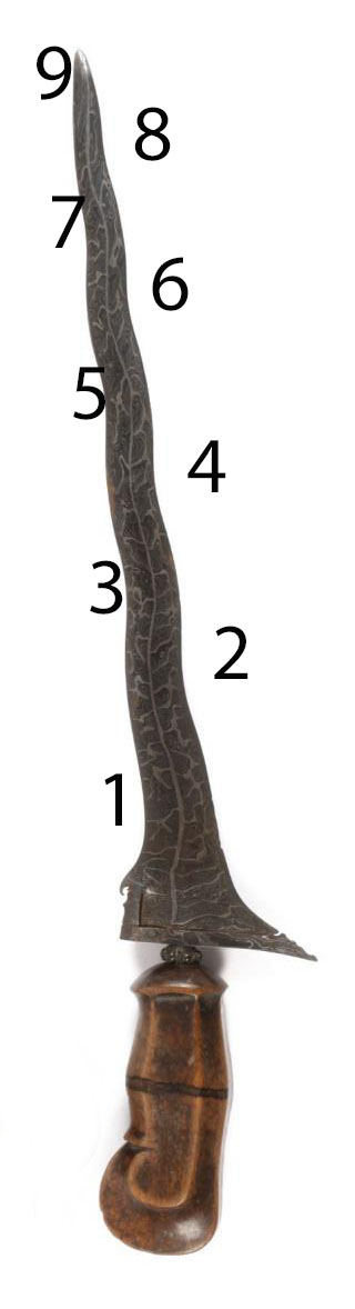

Default Perhaps Naive Question
Hi All,
Please consider this observation in light of my relative ignorance of Indonesian keris but I count 8 luk and the center ridge appears to wander off point. Could the blade have been shortened?
Sincerely,
RobT
Old 22nd November 2025, 12:50 AM   #5
Posts: 7,235
Rob, like a lot of other things with the keris, what you see is not what you get.
The picture shows how we count luk now.
But luk have been counted in different ways in different times & places.
A bloke by the name of "Maisey" has hypothesized that the keris as it had developed during the Mojopahit era in East Jawa had waves (luk) introduced into its form as a type of hierarchical indicator. This hypothesis was founded on information provided by a Bali-Hindu priest, and comparison with still existing ways in which hierarchical indicators within the Balinese socio-cultural fabric are applied now, & have in the past, been applied.
After the Islamic domination of Javanese society, and the separation of Balinese socio-cultural norms from Javanese socio-cultural norms a different method of wave count was introduced by the now Muslim overlords. The reason for this was that it was now necessary to wean the populace of Jawa away from the old Hindu-Buddhist & indigenous systems of belief and bring them under the new Islamic umbrella.
The keris was not only a weapon, it was very much more, and its symbolism was far too intertwined with the old systems of belief, so certain things needed to change. One of those things was the way in which the waves of a keris blade were counted. The new overlords did a similar thing with the Javanese wayang, & for the same reasons.
The above is an over-simplification of a simplification.
This will give a slightly better picture:-
https://kerisattosanaji.com/interpre...e-keris-page-1
even this more complete text only gives a part of the story, there is more in a chapter I contributed to a book of philosophy that was published a couple of years back, but really, I, or somebody else, needs to give some time to trying to get the whole story out there in one piece.

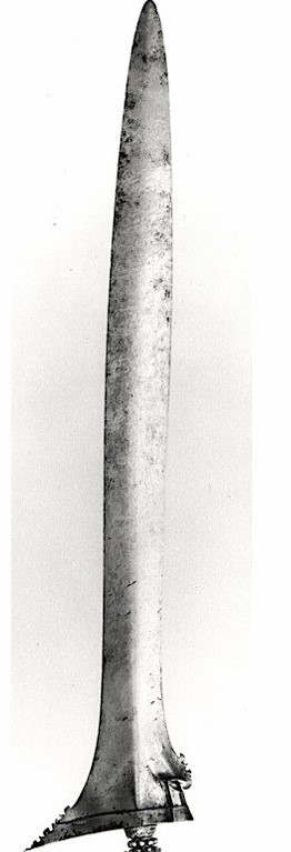

Gentlemen, thank you!
There is this blade in the National Museum of Denmark, EDb 16. Alan, we once argued, if it has one rod on one side, and two on the other. Difficult to see, because the blade is polished in Europe. If yes, it would have the same configuration of Pamor - one twisted rod on "outside", two on holders side.
Of course it likely comes from different cultural context.
Old 22nd November 2025, 11:02 AM   #8
Posts: 7,235
Possibly.

I don't know. I am inclined NOT to see a Balinese blade here. I would be interested in knowing what aspects of this Blade point to Bali for those that think so.
Gustav, do we have a blade length for this keris?

RobT
RobT's Avatar
Join Date: Mar 2005
Posts: 651
Default The Reason for My Question
Alan Maisey,
Thanks for your response. I realize that there should be a ninth luk as you indicated. The problem I had was, although the center ridge appears to curve to show luk nine, the blade edges don’t. That was what prompted me to wonder if the tip of the blade hadn’t been modified.
Sincerely,
RobT

David, there was only the overall length given - 61 cm. So I think, the blade length could be about 40 cm or just a little bit more.
Old 22nd November 2025, 10:59 PM   #12
Posts: 7,235
Rob, there almost never is a visible 9th luk in a keris, Javanese, Balinese or otherwise, the final luk at the leading end of the blade is an imaginary luk, put there because the number of luk MUST be a MALE number, that is, an uneven number. It must be a male number because the keris itself is a male entity.
If the luk of this blade were to be counted in the Hindu-Javanese manner then the luk count would be 7, which is the number of TRUE luk in this blade, but because Javanese society has been the dominant society in the region for so long, Javanese societal norms have replaced some other norms over time, this is something that other peoples in the region have been complaining about for a very long time.
So now the Islamic count dominates.
When this blade was made, the maker would have been following a pattern that would have required the point of the blade to be offset a specific distance from a vertical line beginning at the center point of the pesi (tang) at the point of its entry to the blade body (or alternatively, the gonjo) and proceeding to the point of the blade. To achieve this offset it would have been necessary to return to the forge and use hot-work, or if he was lucky, to use stock removal only. In any case, the offset dominates the required work.
This blade has suffered erosion from the time it left the maker's hands, that erosion has taken a few millimeters from its original length, but it has not been intentionally shortened by a sufficient amount for it to lose a full luk, this can be very easily seen by simply looking at proportion & what we refer to as "pawakan" (overall visual perception).
The above is the reason that the central weld line is not central to the blade edges.
A keris maker, be he an empu/Empu/mpu or a pandai keris or a pandai besi will in 99.9% of cases be working to a required pattern. This might not have been the case more than 500 years ago, but in more recent times it has been the case. Keris makers do not just pick up their tools & make whatever they please, they always have certain parameters to work to, & have had for a very long time.

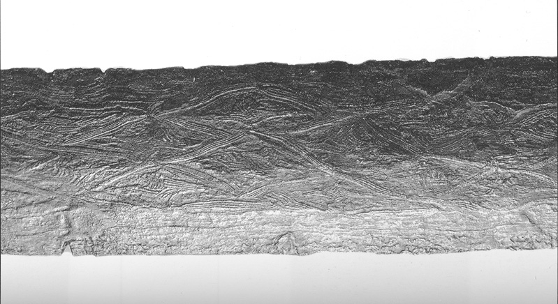

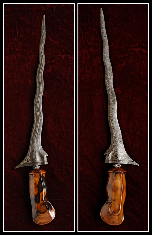

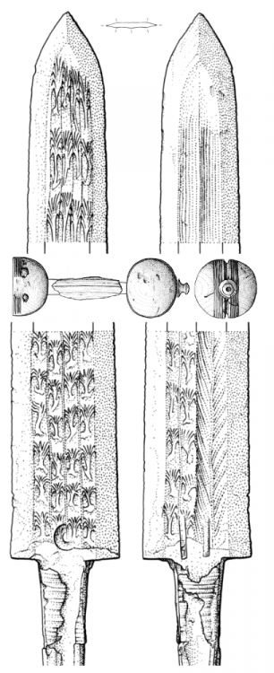

Gustav, in respect of your post #7.

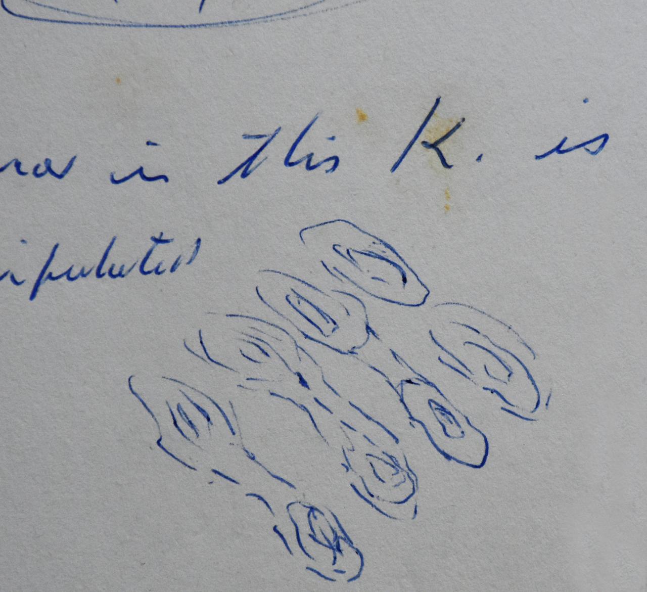

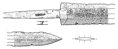

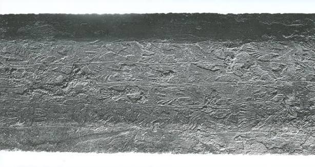

I have now had a chance to examine my photographs and notes of EDb16.
I cannot recall that we had an argument about the way in which this pamor had been produced, but we probably did discuss it, I say this because in my notes I commented:-
"The pamor in this K. is skillfully manipulated"
as you have remarked, this pamor pattern was very difficult to see, it did not come through in my photographs, which were not particularly big images, I was using a Canon S95 & in raw, this produced images that were adequate for what I was doing at the time, but even with more modern (this was 2012 I think) & more sophisticated equipment, I doubt that the pamor could have been captured.

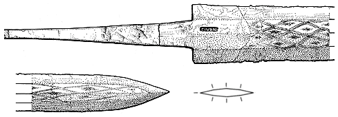

In fact, that pamor was so difficult to see that I sketched the motif, & here below is that sketch. I've forgotten what my impressions were at the time, but looking at the sketch, my impression now is that if a bar was used to produce this pamor, that bar was probably tightly twisted & then bent into a series of "S" bends, something similar a lawe setukal pamor, but in different orientation.
This was a large, strongly made keris, ample evidence that by the 17th century smiths in Jawa did have more than adequate skills to produce very refined blades.
After that visit to the museum's stored collections I did exchange some correspondence with the curator there, & in that correspondence I was advised that this keris was in the collection from at least 1674, possibly earlier.

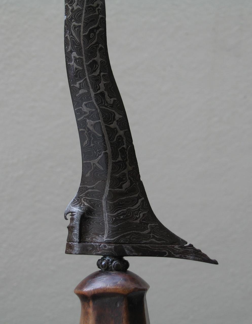

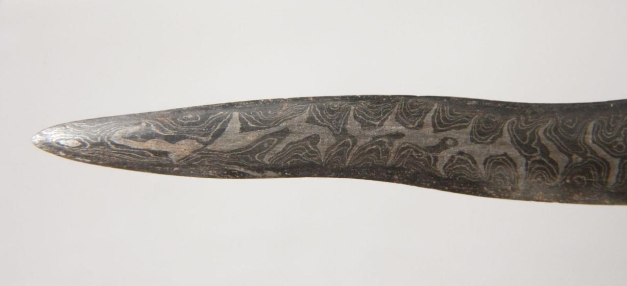

Alan, thank you for the insights on EDb 16.

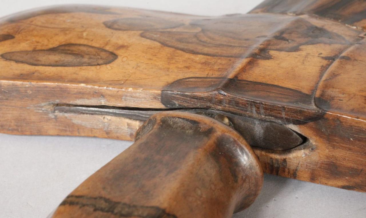

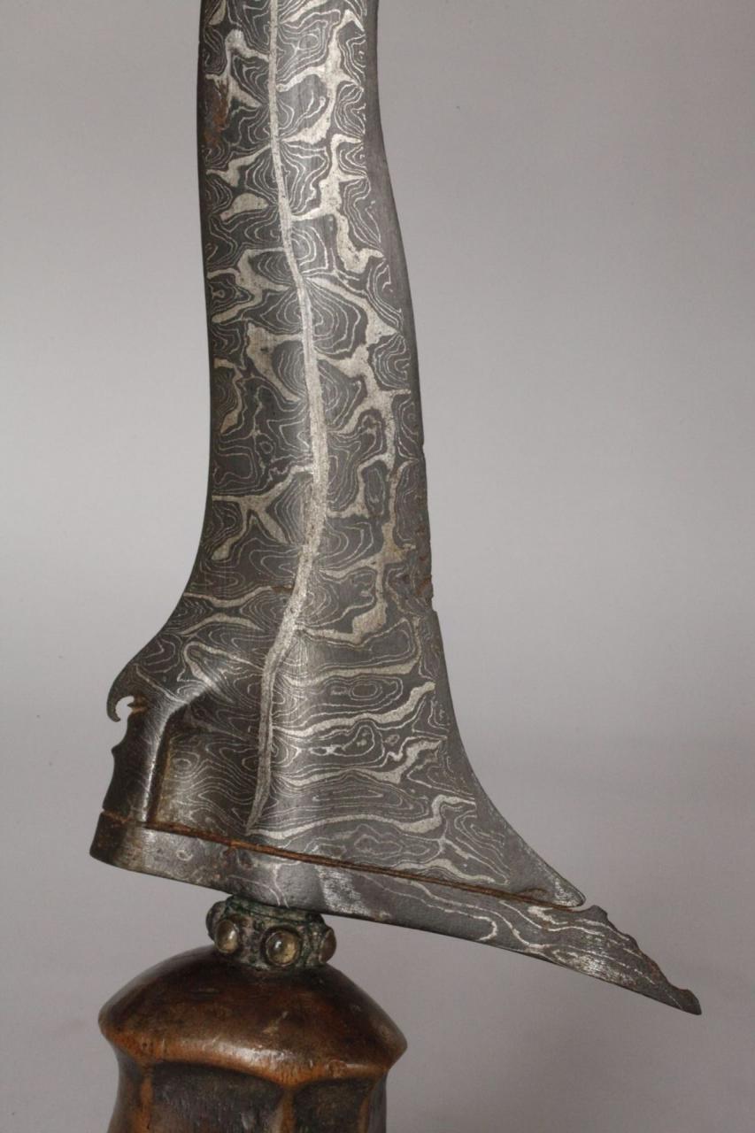

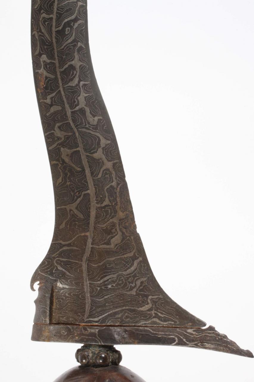

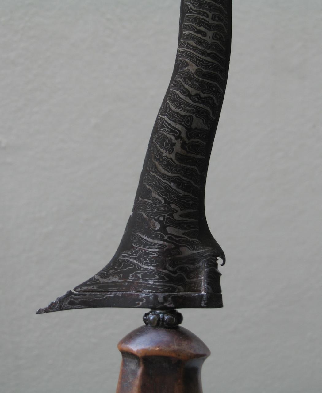

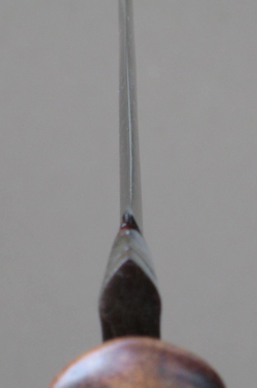

Two more pictures from the auction house, a better view for the grasp of Blumbangan side, and the Walang Sinudhuk side of the tip.
Old 4th December 2025, 12:14 PM   #15
Gustav

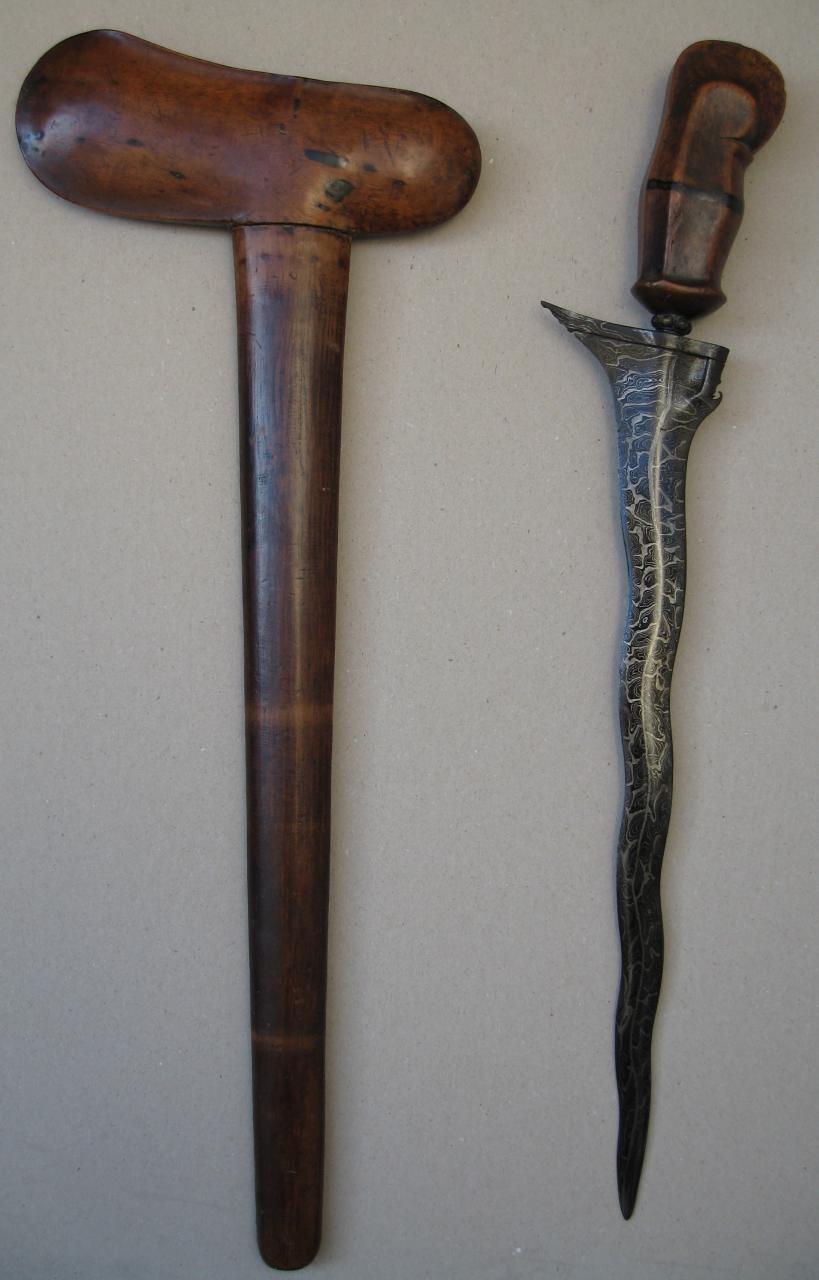

Join Date: Jun 2009
Posts: 1,346

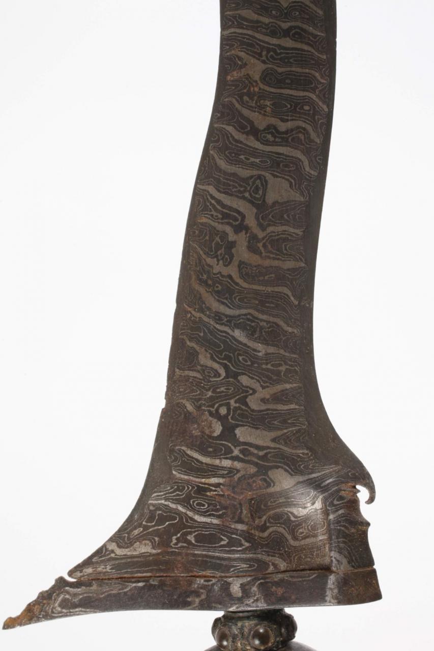

An update:

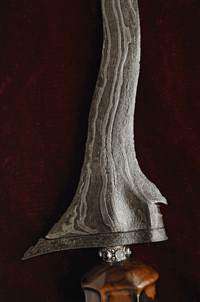

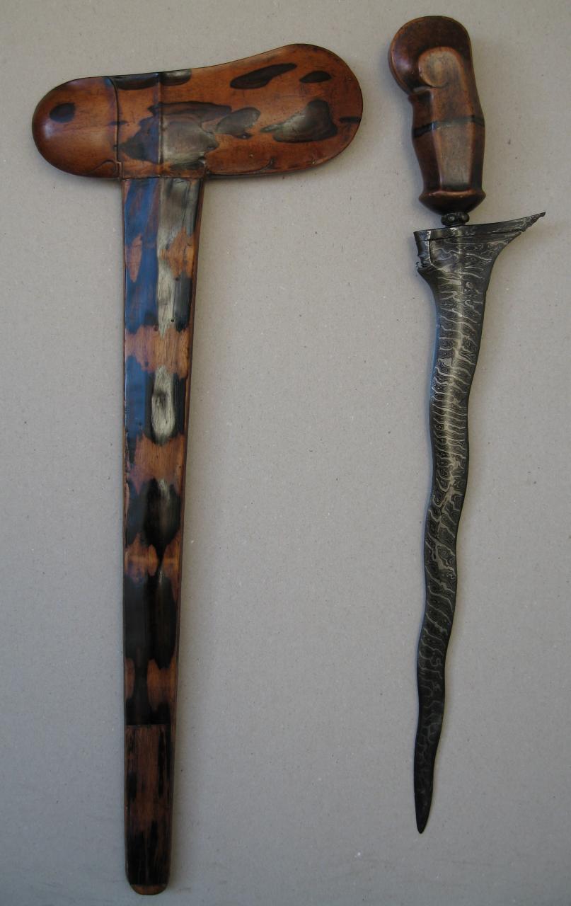

blade length: 36,8 cm. Gonjo length: 8 cm. It isn't Keris Lombok, the question is - East Java or Bali?
It has an old, very smooth finish, which is commonly associated with Bali, yet in the first part of 19th cent. such finish was possible also on East Javanese Keris.
Sheath likely is made for the blade, blade is evenly sunken in, inside of sheath is not fiddled with recently, sheath is on small side, yet acceptable for Balinese Keris.
Kendhit on hilt is natural.

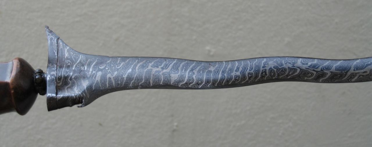

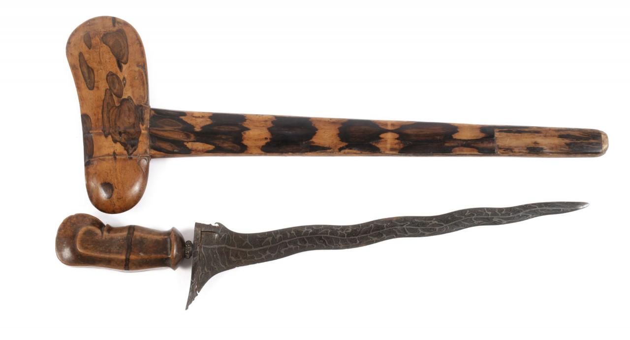

Old 4th December 2025, 12:43 PM   #16
Gustav
Join Date: Jun 2009
Posts: 1,346
With sheath.
Old 4th December 2025, 08:57 PM   #17
Posts: 7,235
If I apply the Surakarta tangguh indicators to this keris blade, it is unmistakably Madura --- which makes it East Jawa.
Old 4th December 2025, 09:58 PM   #18
Posts: 7,300

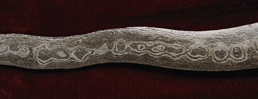

Here is another Bali dressed keris with pamor tangkis. I am curious what the consensus might be on the origins of this blade. It is perfectly fitted to the sarong so clearly this dress was made specifically for the blade. Length is jusrt shy of 38cm.
Old 4th December 2025, 11:25 PM   #19
Posts: 7,235
This is a brief summary taken from Surakarta sources of indicators for a keris blade made in Madura:-
coarse iron,
thick pamor, distinct step from iron to contrasting pamor material ( this is not evident when a blade is polished),
rotan (rattan) shaped cross section,
rather upright,
penitis/penatas (this is the absolute point) is too small,
distance from final luk to point is long,
gonjo is ugly-rather straight, looks awkward, buntut urang narrow & small,
gandhik is short, low, small, thin,
usually no tikel alis,
very small kembang kacang,
blumbangan not well defined,
odo-odo rarely found,
kruwingen shallow if it exists at all,
wadidang runs on middle line
Madura work is overall very poor work, only the work of Mpu Koso is any good, Mpu Macan was also good, but his production was very small.
This is a summary of a summary, & that initial summary was compiled from my notes for my guidance, more as memory hooks than as a guide book.
The above is the way in which a very highly respected ahli keris in Surakarta during the period from about 1970 through to about 2010 would look at and assess characteristics in order to form an opinion on whether or not a keris blade had been made in Madura. It was not, is not necessary to get a 100% agreement, the opinion is formed upon balance of characteristics. The period I have named is what I know for certain from personal experience, but if we go back to earlier sources we will find similar indicators mentioned.
Historically Bali has had strong ties with Madura, & still does. King Baturengang had the desire of conquest & colonisation, but this did not eventuate, however, from the late 16th century, & seemingly continuing for a very long time thereafter, there were a number of small Balinese incursions into Madura, and there are some small areas of Madura where the inhabitants are of Balinese mixed descent.
It is not at all unusual to find Madura & Javanese keris in Balinese dress. Additionally, Bali had a large part of Lombok under its control for many years, and Balinese keris made in Lombok are virtually impossible to differentiate from Balinese keris made in Bali, keris used in Balinese dress but not made by a Balinese mpu can sometimes be identified, or rather given the probability of having been made in Lombok.
Old 5th December 2025, 09:40 AM   #20
Gustav
Join Date: Jun 2009
Posts: 1,346
Yes, I also thought - East Java/Madura.
Unusual in that Madura context for me actually is the Pamor - from what I see from Madura it normally is coarse, broad thick layers, somewhat wild even if well controlled. This one is really minuscule work.
Also Kanyut seems a bit long, but this is likely an older blade.
Old 5th December 2025, 10:47 AM   #21
Posts: 7,235
In every keris classification there are variations from maker to maker & from period to period within the life of the same maker, and over a period of time that covers the entire classification, in addition, we do not seek 100% compliance, we seek a dominant presence. It is perhaps taking a note of everything & deciding if a single piece fits within the total population, to do this one must have a lot of background experience.

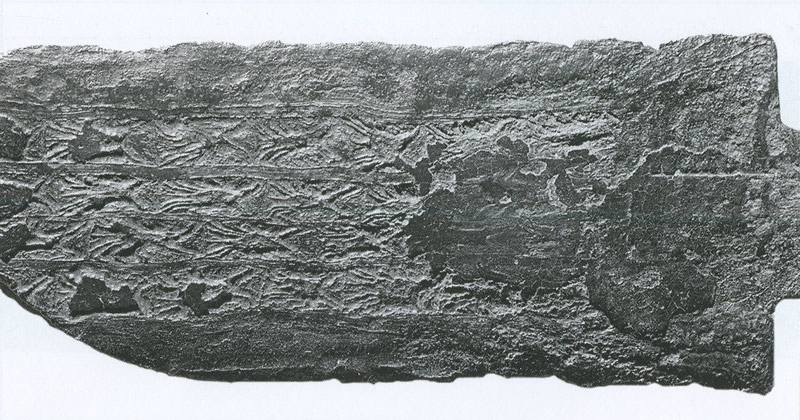

Alan, I asked specifically about Pamor because the execution of it is not very typical for Madura, as I mentioned above, and also the configuration of patterns is not something one sees three times a day. So there is a possibility one has encountered a related blade, especially if he has an experience going long back, and is able to draw conclusions, which possibly allow a more secure placement in a certain time period.

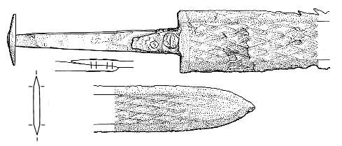

Regarding twisting&welding, probably the first people in Europe who did it, were the celts, already BC, possibly already around 300 BC. At latest around 200 CE Romans could do quite complex pattern welding. There is a possibility it all started in South-East-Europe or Middle East, together with longer swords, which displayed such twisting&welding.
The revival started in the 16th cent. somewhere in Middle East, the earliest known dated yataghan with twisted pattern is from end of 16th cent., around 1600 twisted pattern reached China, and, at the same time or shortly after, what today is Indonesia.

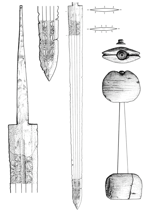

Bearing this in mind, & being aware that twisted bar patterns have been made a great many times, by a great many smiths, over a great many years, and with those smiths having variable levels of skill, both as individuals & in the same smith over his working life, it becomes obvious that we cannot really use a particular pamor pattern to fix the point in time when it might have been produced.
In respect of the blade in post#1, my immediate impression is that I am looking at Madura post 1980, patterning of this & similar designs is not at all uncommon in recent Madura blades, but when I look more closely at some other characteristics of this blade I am reluctant to place it as late as recent Madura. I’d really need it stripped down & in my hand to provide an opinion that I could defend.
As for having seen a keris blade with similar pamor work to this one, yes, I have seen a great many, but none that could be regarded as particularly old, so if this is an older blade, & for the sake of this discussion I think we can take it as an older blade, then I cannot recall having ever seen a blade with pamor similar to this blade that could be reliably dated to earlier than 19th century. Even in the period up to beginning of WWII, keris with pamor similar to the pamor on the blade in post #1 is scarce.
I estimated this post #1 keris as 19th century, & the reason I did this is because stylistically it is old Madura and most of the old Madura blades that we encounter seem to be 19th century. However, keris makers from our current era & from previous eras, have made blades that were copies of earlier styles. Pauzan Pusposukadgo made quite a number of keris that were copies of earlier Mataram blades, I myself made a copy of an old West Jawa blade.
In respect of the working of iron in the forge to make it usable, that has been a part of producing tools & weapons from iron from the very beginning. However, there is a big difference between the processes used in welding to clean iron in order to make it usable & manipulating and welding iron in order to produce a pre-determined pattern. The cleaning process is simply piling & twisting, & although this does produce a pattern, it is a random pattern not a pattern that has been produced intentionally, nor that can be copied. The work involved in producing a pre-determined pattern requires far greater skill than the skill required to simply produce iron that is adequate for use as a tool or weapon.
As Gustav has commented, patterns in welded iron had been produced in Roman times & before, but the welded blades of the Merovingians were deliberate essays in producing predetermined patterns as an art form, proof of the maker’s competence & an assurance of quality.

Alan, thank you for the elaborate response!
I believe the blade from #1 surely is 19th cent. and perhaps could be earlier. The Warangan finish on it is an old one, surely pre-WWII.
Regarding Roman swords and pattern welding - there is a series of books dedicated to Illerup Adal finds. Illerup Adal is a bog in Danemark with spectacular deposit of offerings, and one of the most important sources for well preserved elite Roman spatha. The spatha from the site can be dated around 200 AD, along with 90% of weapon finds.
Pattern welding with twisted rods, often more than two, is among the less complex patterns found there. Others include welding of separate, pre-forged parts, similar to Pamor Poleng, or using braiding. Work of such complexity did appear again only since the second half of 19th cent., true for many things Roman.
Pattern welding with twisted rods did appear even on foot soldiers Gladius and Pugio. The problem is the possibility to recognize the pattern. Illerup Adal is an unique situation, mostly blade surface of Roman, not to speak about earlier swords, doesn't allow to see any traces of it without using X-ray.

Not at all an elaborate response Gustav, what I have written, I consider to be very simple & very basic. It took me a long time to write it, because my initial response was far too long and far too detailed, I needed to keep cutting & cutting to bring content down to a level that could be both easily understood and that would (hopefully) clear the fog that surrounds the creation of pattern welded motifs:- it is not just forge work, the real art, the real work in revealing those motifs is in the cold work.
In fact, now, & in the past, in Indonesia, although the mpu or pande keris might direct or oversee the hot work, that actual hot work is mostly left to a common smith, the work requiring the real skill is the cold work. I do hope that I have had some success in assisting a little understanding of how pattern welded motifs are created.
At the present time there is a lot of play acting going on in Indonesian keris work, what we call "sandiwara". From what I have read of reports on Javanese work in an earlier era, I think the same applied then too. Maybe it always has applied. In any case, one thing is certain:- what an outsider is permitted to see is a long way from the reality.
Smithing in general seems to have acquired some sort of mystical reputation, there has been a heightened interest in smithing work in recent years, but really, it is just work, & pretty hot, dirty heavy work at that.
I had never heard of Illerup Adal until I read what you have posted. I've followed up on your lead, & it does give a slightly altered perspective on the time frame, still within the long established parameters, but it certainly does appear likely that in later Roman times a good degree of control over pattern welded motifs had begun to appear. But I'm still not clear on whether this controlled work from Illerup Adal can be attributed to Roman workers or Danish workers. Still, this is not really material, the progression remains as previously understood, even if the parameters might be a little different.
The graphics you have posted are really quite informative, can you advise the place & time of manufacture to which they are attributed?

Alan, those pattern welded swords which can be attributed to roughly 200AD (the latest coin found there is from 187 AD, one can only speculate, that the swords were not necessarily new when their offering took place) are absolutely certainly Roman and absolutely certainly not Danish. Swords with no pattern welding could be of different origin.
To reach such a level in pattern welding seen in those swords - there should have been a way longer then a generation or two from simple piling of rods to pattern welding displayed here. These are patterns, of which a Merovingian, 2 centuries later, didn't even dream of, not denying the mastery working with twisted rods from 5th cent. onwards.
The people who till now are of oppinion complex pattern welding started in 5th cent. are repeating information, which is more then 80 years old and certainly outdated. According to Arbesman...
The drawings I posted can be found in this fantastic publication, which should be in the library of every person with deeper interest in the history of pattern welding:
https://www.abebooks.de/978878841538...qfFM7ZJ-_9rwqw
Vol.11 - text, vol. 12 - drawings and photographs.
