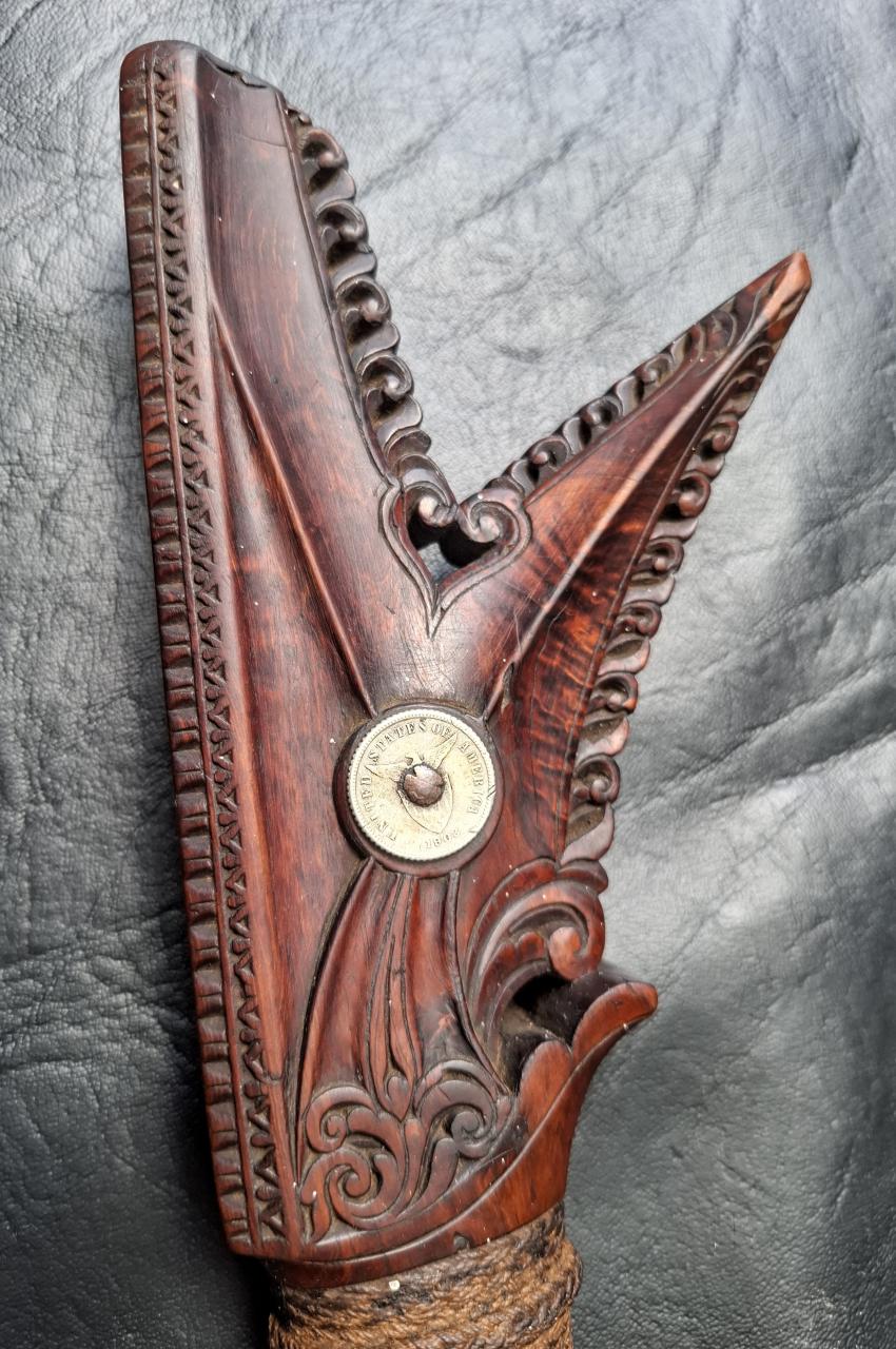

It's pretty rare for a well-preserved piece to pop up in the Philippines (most of the nice pieces are in US, EU, etc) so I jumped at this opportunity. This kampilan is a good example of how a Moro traditional blade can have mixed components.
I believe the Maranao-made blade is mid to late 1800s, while the hilt is late 1800s to early 1900s (either a replacement or an upgrade). The postwar scabbard is Lumad-made, possibly T'boli. There's a 1903-S US-Philippine one peso silver coin pinned to the "eye" of the pommel, and a square silver insert on the blade part towards the hilt, a talismanic protection against black magic or hostile spells. Blade length is 30.5 inches, overall length is 41 inches.
I tested the kampilan on some soft targets using the proper one-handed wield: https://youtu.be/HUc8xdV3NLs?si=FHcobhjD3lkEUd1v

I really like the carving & the grain on that hilt

The carving is truly wonderful and not like more recent mid 20c examples.

Very nice example! The hilt looks pristine.
Is there anything in particular that leads you to assign a Maranao origin to the blade?

Thanks for the kind words everyone!
Ian, I'm betting it's Maranao because I've been observing a trend of Maranao-provenanced blades (kris, kampilan, panabas, etc) having silver or brass inserts, sometimes in the form of okir or Koran verses. The design at the tip is also something that Maranao would do.

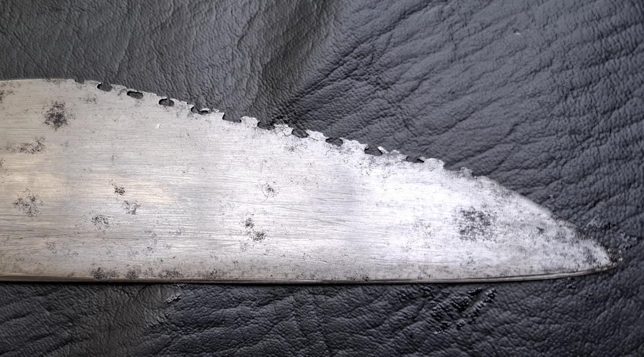

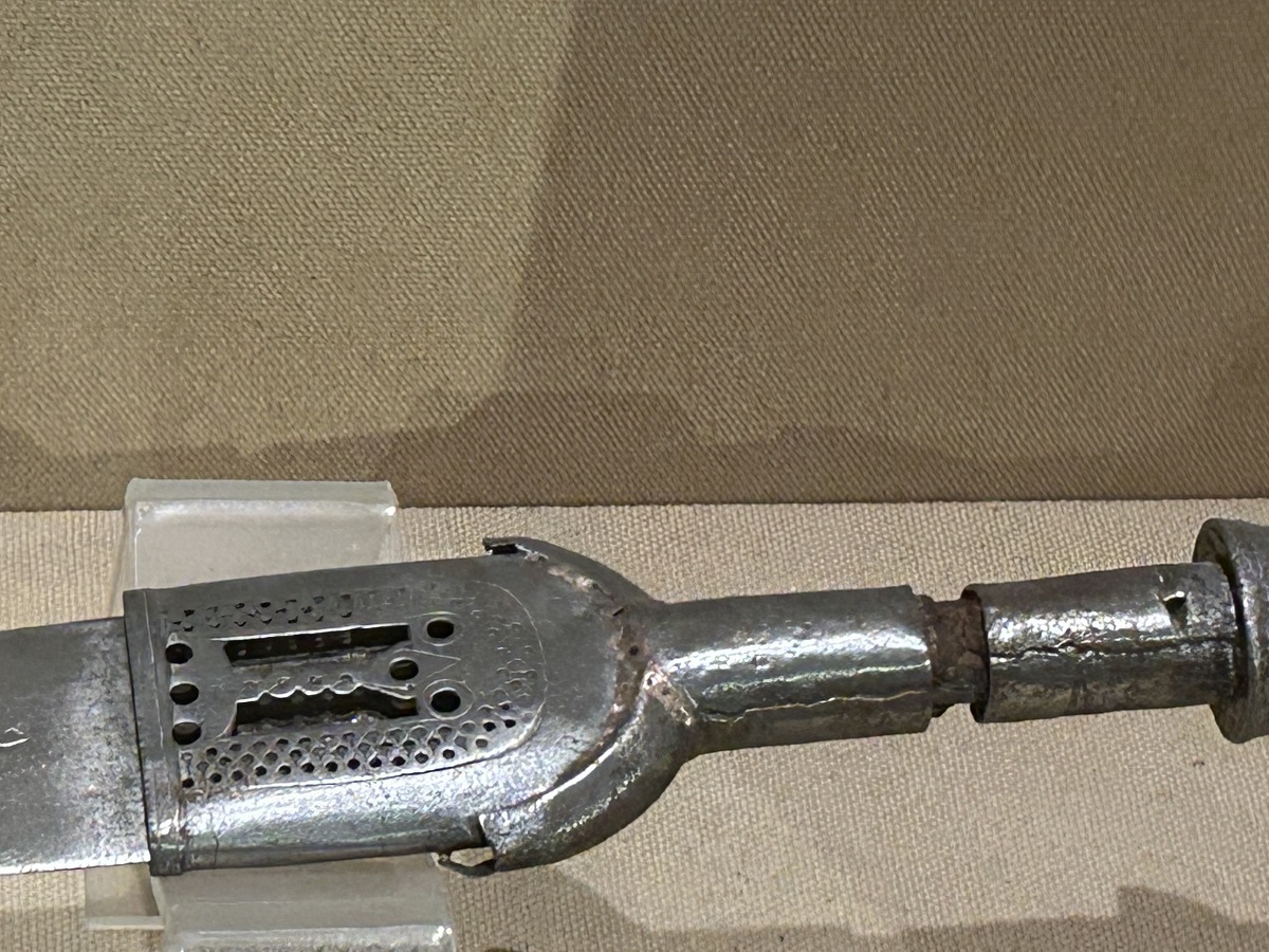

The file work here looks like the ron dah on Indonesian keris. It is interesting to see how the "open" form of the ron dah developed on this blade. If we look at the examples towards the spine of the blade, they are "closed" at the top. But as we progress towards the tip they become more "open." This must surely be due to greater corrosion towards the tip, resulting in loss of the thinner areas that enclose the space.
Alan Maisey has commented on a similar phenomenon occurring on a decorative piece of metalwork he acquired. He thought that the "closed" form may have represented the Hindu "om" while the corroded form ended up looking like ron dah.
