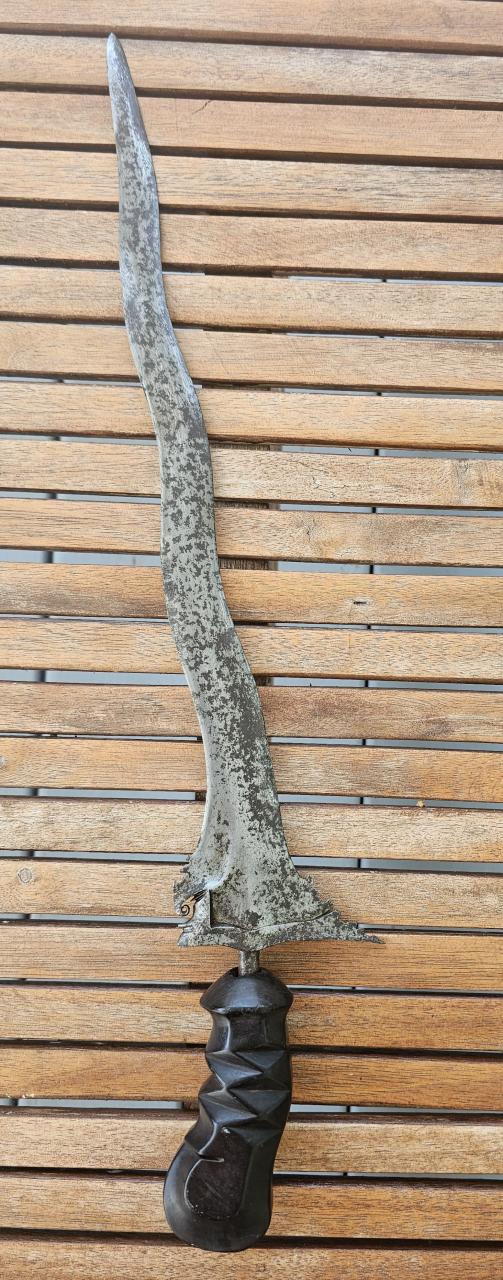

This just arrived. I am looking forward to cleaning up the blade, there appears to be interesting pamor. To me it feels old based on the worn greneng and other general erosion. The gandar is pegged together, not sure if I have seen that before, missing pendok.

Some of the pamor is visible here.
#3 |
Posts: 7,217
Jeff, this keris never had a pendok, it had veneer(Bali:-penabeng) glued to the front of the gandar (Bali:- penyejer). This veneer might have been a single strip of figured veneer, or it might have been made up of smaller pieces of pretty wood, as in the attached photo.
The use of pegs to keep the gandar together is, to the best of my knowledge, unknown in Bali, but it is sometimes encountered in Jawa, Sumatera, & Malay/Bugis scabbards. In this particular scabbard it is my opinion that this is a repair to the scabbard that was done in Peninsular Malaysia or Singapore. The hilt looks nice and of a traditional interpretation, I am inclined to place it later than 1900. I'm not going to take any sort of guess at blade age, there are conflicting indicators & I would need to handle the blade to form any sort of defensible opinion. |

Thank you Alan. I purchased it for the hilt (needed for another Bali keris in my collection), but will clean this up hoping to have a rough, but honest old village keris with attractive pamor. I may circle back after it is cleaned up to see if I can learn a bit more, but understood this is not a particularly interesting keris for this board. A veneer would be easier to replace than a pendok if it turns out to be worth the effort.

Not sure how you will clean it but if you do a vinegar soak it will remove the old pamor and leave it shiny bright. Then you may want to restain it. If you want to pick away at it you'll be there till Christmas I reckon. Would be interested in how you will do it.

With the licence of ignorance, to me the blade easily looks like it could be from the 19th century. I looks decent to me and pleasing to my eye.

It is difficult to be sure what the pamor is on this keris, but it looks something like pamor santa or some related pamor. Washing and restaining the keris will make identification much easier. If you have the skills to place new veneer on this sarong, stain the blade and get a nice uwer you could end up with a pretty decent keris. Please update this thread if you do indeed restore it. |

This keris will restore well. The blade is not at all a clunker, it is decent workmanship, my doubts about the blade only relate to age, but as far are workmanship goes, it is pretty decent. The blade clean up is white, household vinegar, combined with scraping & picking, after the rust has gone, a polish with wet & dry paper, finishing with worn 1200 grit will give a foundation for staining. The veneer does need to be replaced, & if you ca source some veneer this is not a big job. You clean off the old adhesive, it might be shellac, so try metholated spirits & steel wool first, if that doesn't work, soften with water & use scraper/paper, but do not get too heavy handed. You can put the veneer on with PVA adhesive & you bind a stocking(s) around to clamp it in place until dry & cured. Then you finish the job. This keris definitely has potential. |
