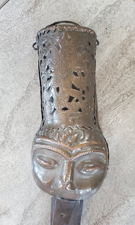

This pata example I acquired over 40 years ago, in circumstances which are somewhat intriguing, but irrelevant. In those days of my collecting, naturally I saw this as a fascinating ancient Indian sword.
Today, it is clear that while it in indeed a 'pata', it is likely a fabrication from Victorian times at best, and likely intended for use in Mahratta festivities and martial arts exhibitions. These demonstrations are using these in pairs and in the windmill style slashing in which they were most typically used in warfare in the 17th-18th centuries by Mahratta warriors. These were apparently termed 'dandpatta' in the Mahrathi language.

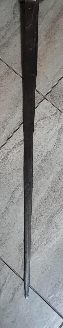

Returning to my example , the blade, well worn, has the central triple fullers resembling those found on kaskaras, and with the astral symbols (sun, moon etc) and as noted has clearly been sharpened down over many years. The metalwork resembles such work in India in items of Victorian period, thus use of very old blade, European, mounted into a likely traditional ceremonial item.
