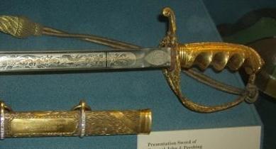

Gen.Pershings sword a M1902 officers

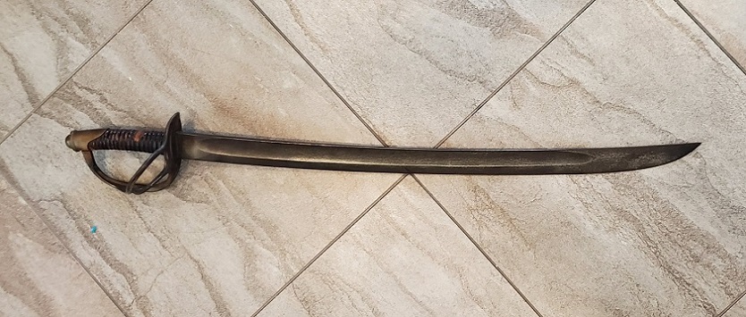

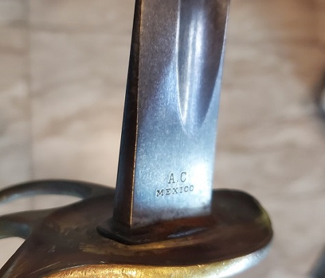

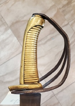

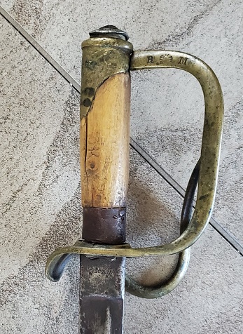

As previously noted, the quasi military frontier police formed by Diaz in the 1860s, the 'Rurales' while heavily armed with revolvers and carbines, still wore cavalry type sabers (typically) through the late 19th c. and certainly into the 20th. What actual use of these took place is hard to say, as accounts of combats, battles etc. simply presume use of guns, and seldom specify if use of sword(s) was part of any action.
The cavalry sabers were typically of the three bar hilt form familiar from US Civil War examples from the M1840, M1860 types. These often had blades marked A.C., which while often presumed to mean 'armeria centrale' for the Mexico City armory, it is suggested these were the initials of Acier Colubuzier, who held the monopoly on imported swords into Mexico.
Often there are the RM stamps representing Republic of Mexico.
While these were used of course from 1870s onward, swords, like most arms in Mexico, remained in use for decades if not generations.

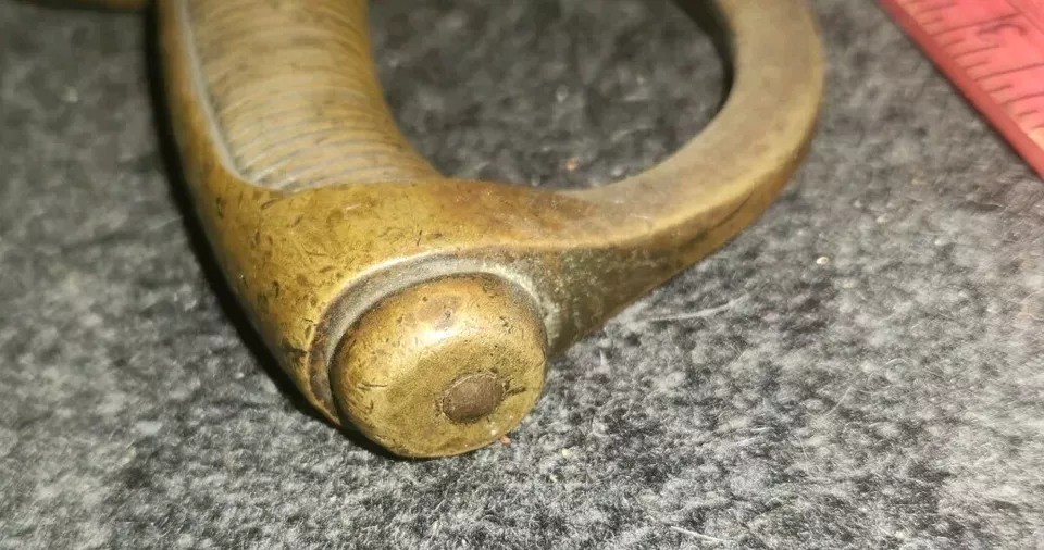

This example reflects the rugged condition from such years of use on the frontier, and the hilt is misshapen possibly from being trampled by a horse?
There is a centavo (date obscured) hammered onto the pommel, perhaps a good luck amulet? or simply decoration.
Note: There are numbers of three bar hilt sabers of British M1821 form which have turned up in Mexican context, usually with an oval cartouche with PDL, Luneschloss of Solingen.

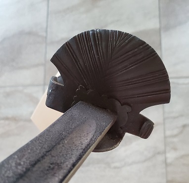

Default Espada ancha hilt with Brazilian blade 1880s.

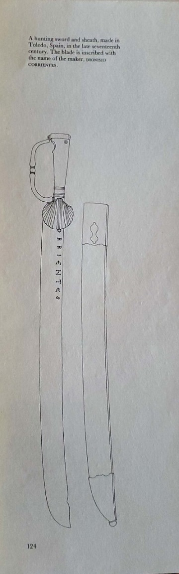

This unusual example was acquired many years ago, along with the common presumptions which often accompany Spanish colonial swords where little tangible information was available, but fanciful lore was handy.
The complication here was that the hilt form was clearly from very early Spanish hilt styles, which reflected distinct 'Moorish' influences (the 'hand nock' in the grip familiar on Maghrebi nimchas). In this case, the typical espada ancha hilt style of the late 18th century, incorporated with hilt styles from South America and the 'Spanish Main' (Spanish Caribbean, and the ports through Central America and the South American coasts......is joined with those identified as Brazilian.
What is notable here is that the blade appears distinctively like the Brazilian cavalry sabers of 1880, supplied by Coppell of Solingen, which were in turn copied from the British M1853 cavalry sabers (thanks to Midelburgo for these ohservations, 2024).
Interestingly, other 'espadas' from Brazilian context seem to favor 'shell' guards and have the 'Moorish' hand nock.
Many arms for Mexican factions came from South America, though mostly Argentina, but of course certainly Brazil as well. These swords may be presumed from anywhere in the 'Spanish Main' (which prevailed well through 19th c) in Caribbean regions and many arms came to Mexico through the port of Vera Cruz.
The illustration is from "The Lore of Arms", William Reid, Sweden, 1976, p.124, showing the earlier Spanish (Moorish) influences with the hand nock (from nimchas etc). Corrientes was a maker from Toledo, then Madrid, 1730s (Palomares) but likely earlier.
While it would have been exciting for this sword to have been a 'pirate' sword of late 17th c. as suggested when I acquired it years ago, this hilt may still be from the early to mid 18th century as suggested by Reid (1976) and perhaps a heirloom from an old Spanish family in the colonies of New Spain. At some point it was mounted with a newer cavalry blade, and may well have become involved in the actions in the Revolution, perhaps among Zapatista forces. Obviously pure speculation but with these elements of plausibility.

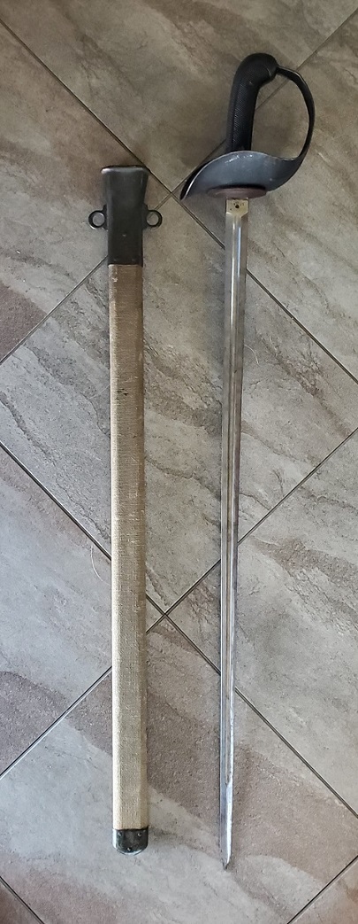

Default Another Brazilian form

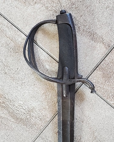

This is another example concurring with that of previous post, again with the notable shell guard, the serpent appendage coiling around edge seems an affectation popular in hilts of S. Mexico into Central America.
The grip again, with the Moorish 'notch' hand nock from North African hilts (Maghreb).

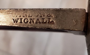

The blade is marked LYNDON & WIGNALL, sword cutlers at Minerva Works, Fazely St. Birmingham, and in registers 1833-1839.
Swords with these type hilts have been associated with Brazil as one with inscribed blade c. 1850s is known, thus suggesting that provenance.
These again, are known to have been fancifully hawked as 'pirate cutlasses' some years ago, but of course, now that more study of these weapons has been forthcoming, it is good to know the actual identity of these.
As with the previously mentioned sword likely with Brazilian provenance, these type swords may well have entered the theaters of the Mexican Revolution in some capicity, in southern regions.

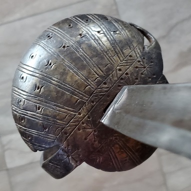

Default Mexican cutlass

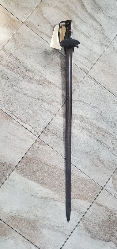

This is another example of the cavalry three bar hilt saber, but with heavy, shorter blade which is tempting to associate with the earlier espada anchas, but seems colloquially termed 'cutlass'. While these seem pretty uncommon, they fall into same contexts as the Civil War type cavalry sabers, and have the 'liberty hat' symbol and RM, Republic of Mexico.
It is unclear which forces might have used these, and as yet no direct connection with navy. Regardless, virtually all types of arms of these periods may be viably considered as potentially available for use by virtually any faction.

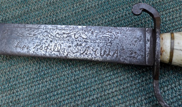

In examples of swords from later in the 19th c into the 20th, there were often 'dichos' (mottos, sayings or phrases) inscribed into the blades. In some cases there were names such as on this example (from Drac2 a year ago) which is a remounted blade and fabricated hilt.
The name is Luis Padilla and SAYULA, which is a town in Jalisco (south of Guadalajara, and could be the name of an individual, or perhaps the person who fabricated the sword.

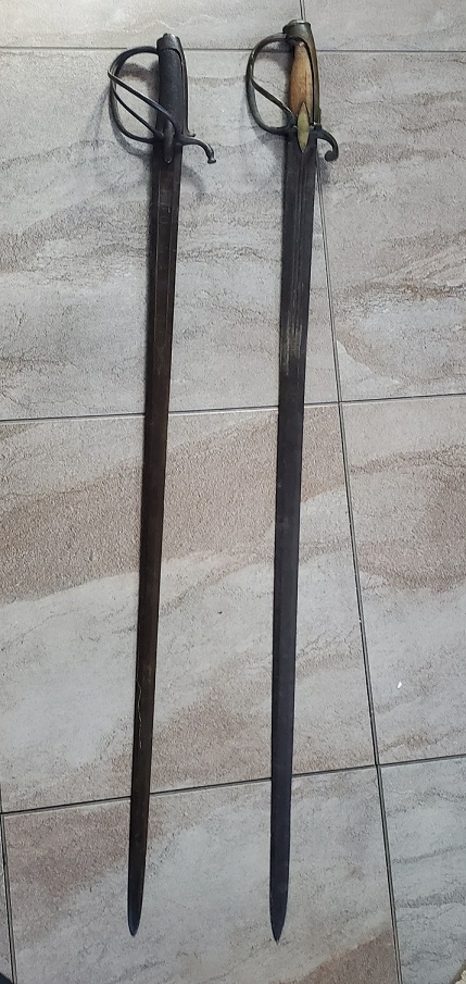

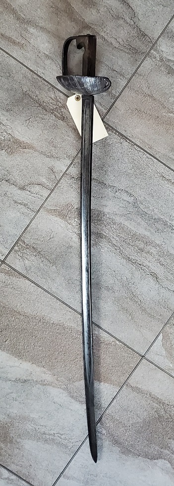

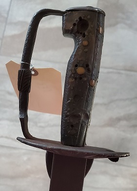

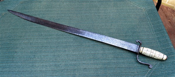

Figure this one I adopted. A federal period blade in what looks like a Spanish briquet hilt.

Posts: 10,851
THANK YOU GLEN!!!
Yes the 'militaria' stuff 20th c. is pretty much verboten, and I had always been curious whether the 1913 Patton had made it on Pershing's expedition chasing Villa in Mexico since Patton was with him. But that was the singular element of military swords I was interested in.
Its the many forms of swords and edged weapons in use by the factions of Revolutionaries as well as forces with Federal troops. through 1925.
This is a great example you show! and it seems there were many such unusual compositions using old briquet hilts.

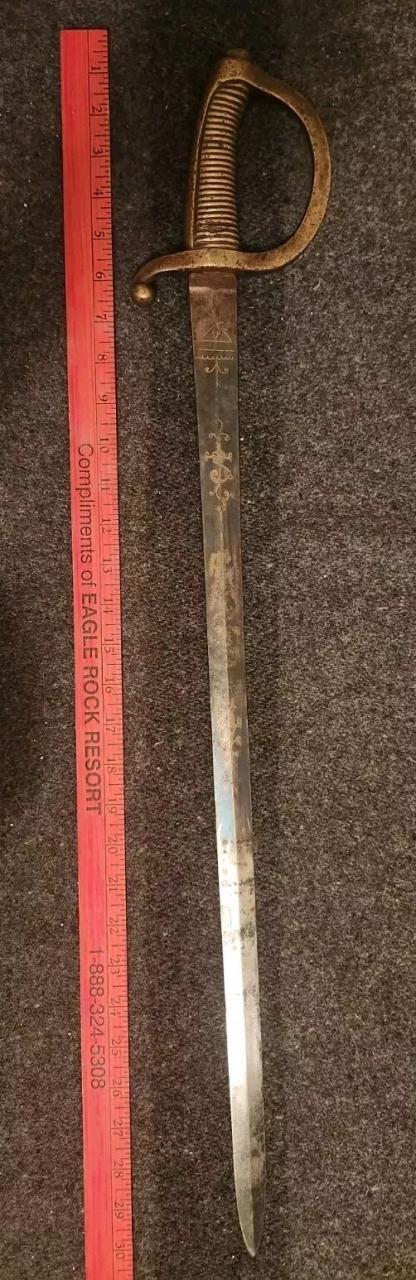

This is one I found with cut down old dragoon blade from 18th c. with three bar cavalry hilt and the BRIQUET hilt. Blacksmiths in remote little towns were very creative and everything was recycled and used as required.

Neat Mine has that boat anchor feel but still seems like a 'get out of the way' for getting as job done.

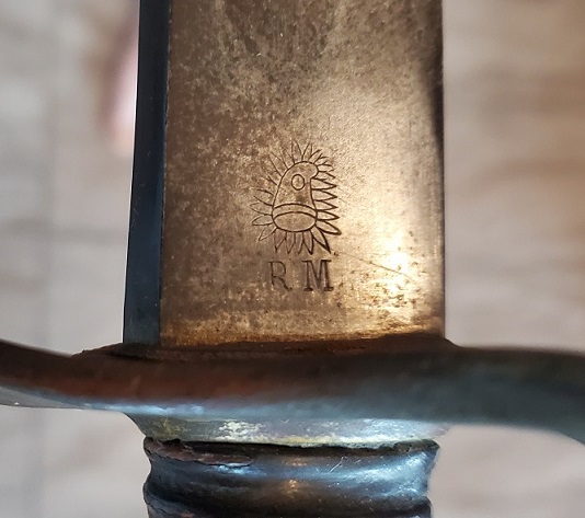

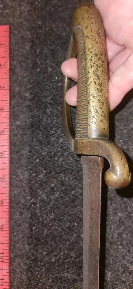

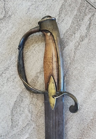

Default 19th Century Mexican cavalry swords potentially still in use in Revolution
In the late 1820s well into the 19th century, Mexican cavalry swords became more familiar with European cavalry hilts, and the long straight broadsword blades that had long been mounted in the 18th-early 19th c. 'bilbo' swords were remounted into them. These blades obviously had very long working lives!
I am still seeking more pictures of these sword types worn in the Revolution by various factions and often a matter of course of personal preference.
