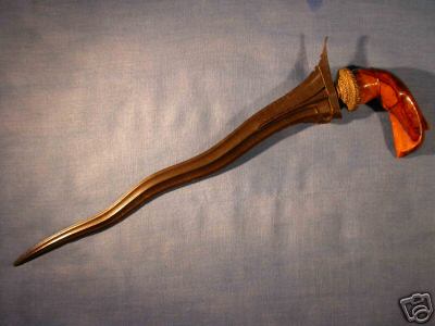

This auction just ended let me know what you think?
http://cgi.ebay.com/Kris-Sulawesi-wi...QQcmdZViewItem
Lew
Old 28th August 2006, 02:41 AM   #2
Posts: 7,303
Nice catch Lew. Thanks for reminding me to occasionally look under the spelling "kris" on ebay.
I'd say you did well. I am sure the peninsula gang will chime in here with better info, but this keris blade does not look Sulawesi to me. Peninsula or Straits perhaps? Hopefully Kai Wee will check in on this one.

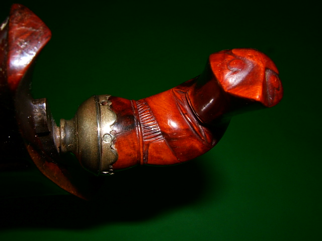

A nice keris from the Terengganu, Northern Peninsula Malaysia.
The hilt is in the Anak Ayam Teleng form, typical of Terengganu style.
The matching hilt ring is made of turned brass with 6 petals, also typical of Terengganu styled.
The blade, a bugis-influenced sepokal blade with a hexagonal cross section.
The type of wood for the hilt, sheath and sheath's end piece cannot be confirmed. If you could provide clearer pictures later, it will be nice.
Overall, a lovely complete piece. Congratulations!

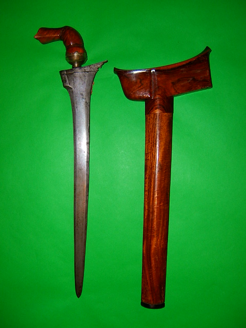

The keris arrived today and it's a beauty! I had to stabilize a couple of cracks in the hilt near where the tang enters the hilt but otherwise a very good buy.
Here are some pics.
Lew

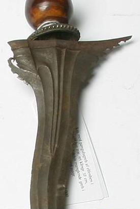

Bugis/Peninsula/Sumatera keris are not my forte, however, may I suggest that we are looking at a Bugis blade in Terengganu dress?
Note the flat faces to the blade, and the decline in the joint of gonjo to blade.
I may well be incorrect, but I do not believe these are typical Trengganu blade features, whilst they are typical of classic Bugis form.

The Bugis diaspora ended up in many parts of peninsula Malaysia and Sumatra, including Terengganu. Hence, it is not wrong to say that this is a Bugis or Bugis-influenced blade made in Terengganu. The Bugis blades made in Peninsula Malaysia tend to be 'finer' than most Sulawesi Bugis kerises, and 'sweeter', having absorbed the Malay sense of aesthetics. It may not be as macho, but it is more pleasing to the eyes.
On Peninsula Malaysia, I see 2 major forms of kerises - the Javanese-influenced forms and the Bugis influenced-forms. The more south you go, the more predominant the Bugis-influenced forms. The more north you go, we see greater presence of Javanese-influenced forms. Apart from this common Bugis Sepokal form, there is the carita and melela forms which excel in terms of the refinedness of the dapur and perabots.
Keris melela from Terengganu:
http://www.kampungnet.com.sg/modules...view_photo.php
Keris Unduk-unduk from Terengganu
1st pic - Dave Henkel's keris melela
2nd and 3rd pic - Dave Henkel's keris carita

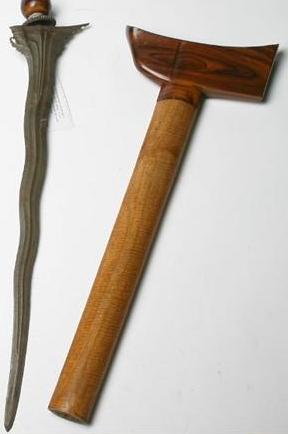

Another carita, again from Dave Henkel's collection. Exceptionally long and fine example. Some collectors refer to the carita in the post above as a melela.
The difference between a melela and a carita is the subject of much disagreement. Most would agree that a keris with deep "double fullers", meaning double sogokan and kruwingan reaching the tip, or at least covering 3/4 of a blade, is called a melela. A carita is supposed to have shallower fullers, and in certain cases, no fullers. The confusion comes in when a keris a set of fullers that is neither shallow nor deep. Would that be a melela or carita?

This is a straight carita from Pattani.

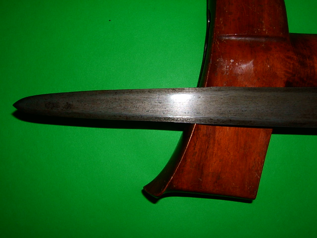

Question about the pamor? It seems that there is two types of pamor on the blade. The lower half of the blade looks like a scattered rice pattern but it changes half way up the blade to a fine linear pattern?
Lew
Old 3rd September 2006, 06:00 AM   #15
Posts: 7,303
Yes Lew, it's nice to see that it is a pamored blade after all. My inclination would be to stain it to bring out the pamor, but i have been led to believe that warangan treatment is not traditional for blades from this region so i don't know if that would be the proper course of action. But it sure would make it easier to read the pamor.
Nice catch!
Old 3rd September 2006, 08:28 PM   #16
