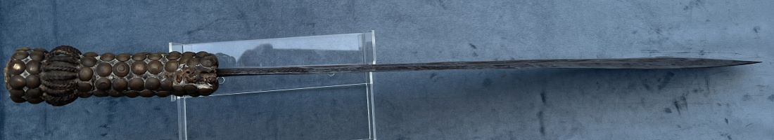

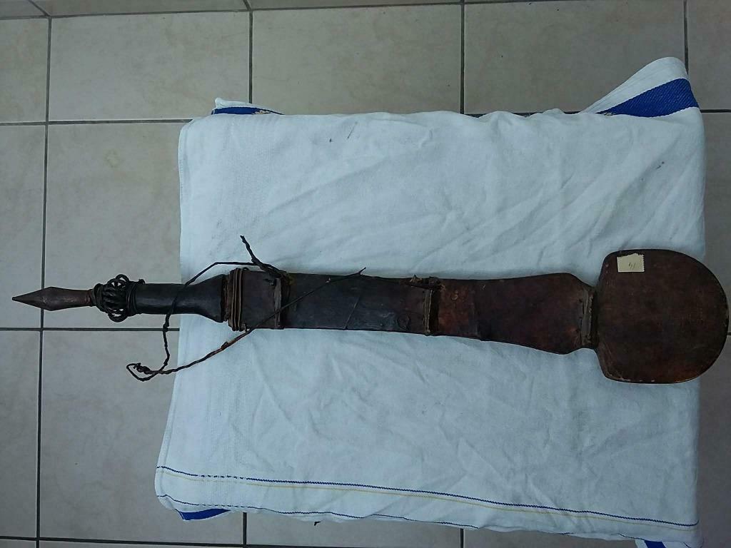

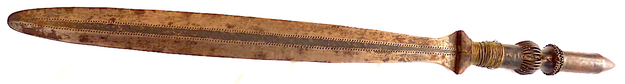

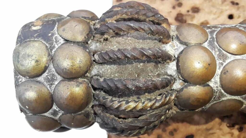

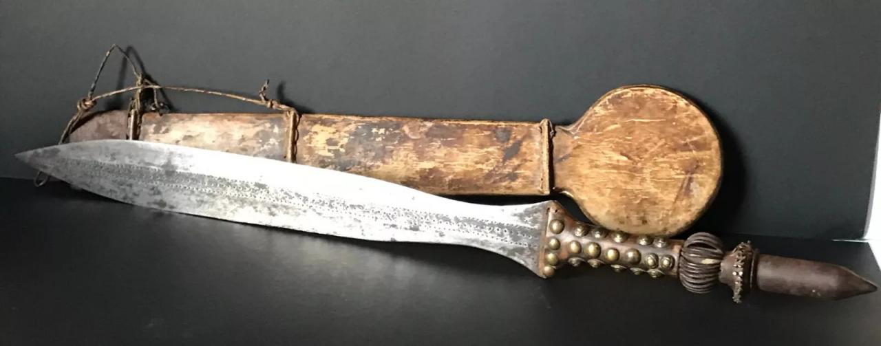

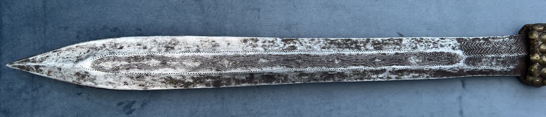

Default Sword from Angola. Chokwe, Salampasu?

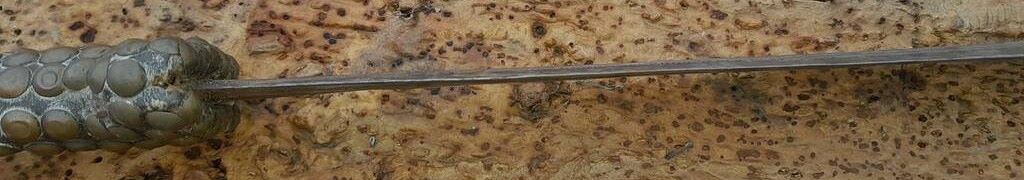

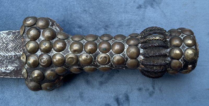

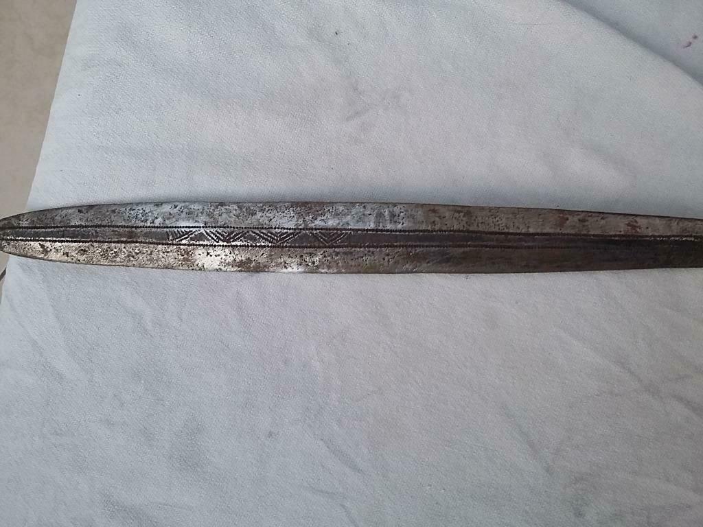

Won the auction, the seller claims that the sword was brought from Angola in the 70s of the 20th century.
Characteristic round copper plates are found on Chokwe and Salampasu swords and knives.
I will be grateful for any help in identification. What versions will there be?

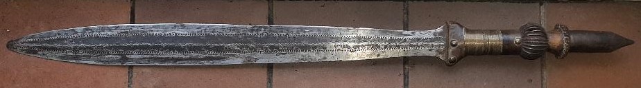

Total length 58.3 cm
Pertinax is offline   Reply With Quote

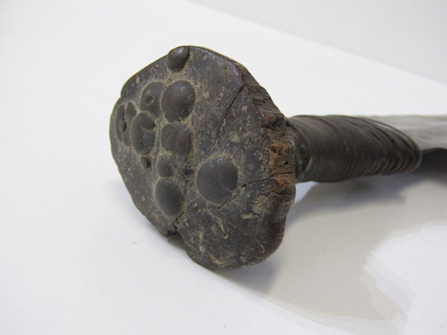

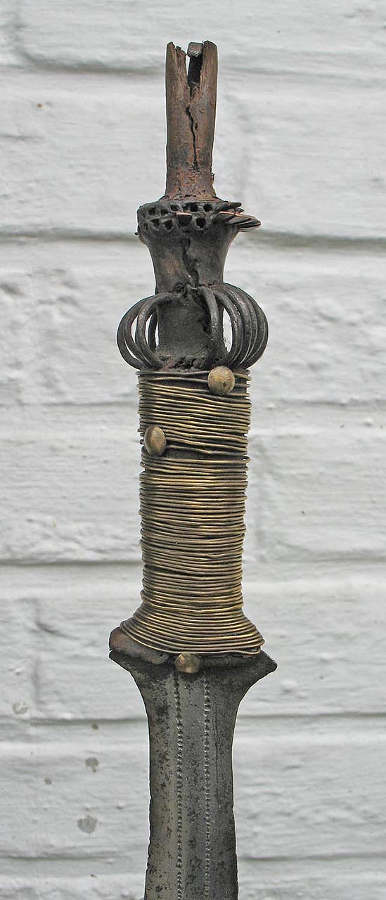

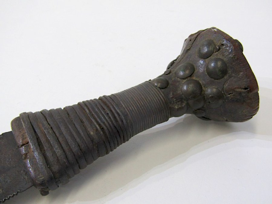

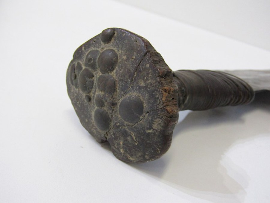

could indeed be Chokwe...
although the top of the below Chokwe handles are not round, blunt but both below have a tube-like ending

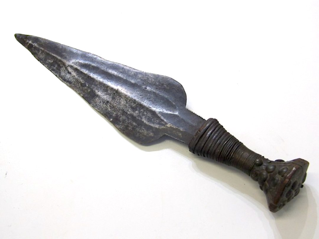

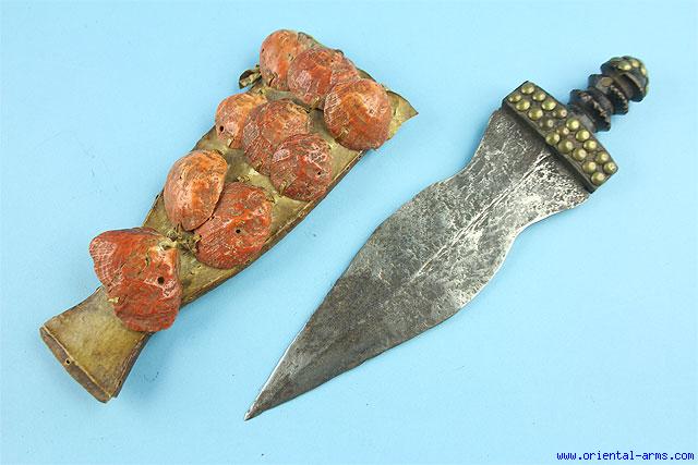

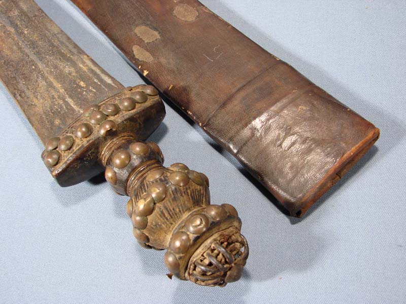

As an alternative hypothesis, my first thought was Baule, based on grips on the sword in this thread,
and the dagger shown below with the following description:
Very Rare Dagger of the Baule Tribe, Ivory Coast - 13207
The swords and daggers of the Baule tribe are quite rare and sought after by collectors of African weapon / tribal arts. The Baule people reside in Ivory Coast and Neighboring Ghana and known to be masters of wood work and wood engraving. We offer here for sale a classical dagger / short sword of the Baule. The blade is leaf shaped, 10 inches long 3 inches wide a bit crudely forged. The handle is carved hardwood set with brass tacks. The scabbard is wood, covered with hide and set with red painted shells, which were added only to weapons of highly prestigious owners. Total length 14 inches. Very good condition. One of the shells is partially loose. The seam of the hide on the back is open due to hide shrink. Small wood chips on the handle. A very rare authentic piece.
But I am very far from an expert and maybe the Chokwe grip gp posted is a better match.
Hi gp!
Thank you, very similar swords, there are differences in the handles, but the blades seem to be from the same workshop.
Yuri.

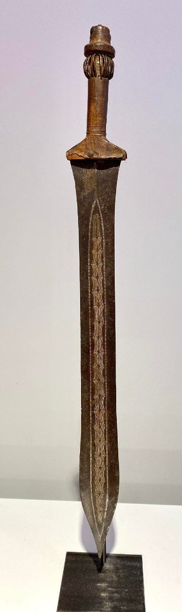

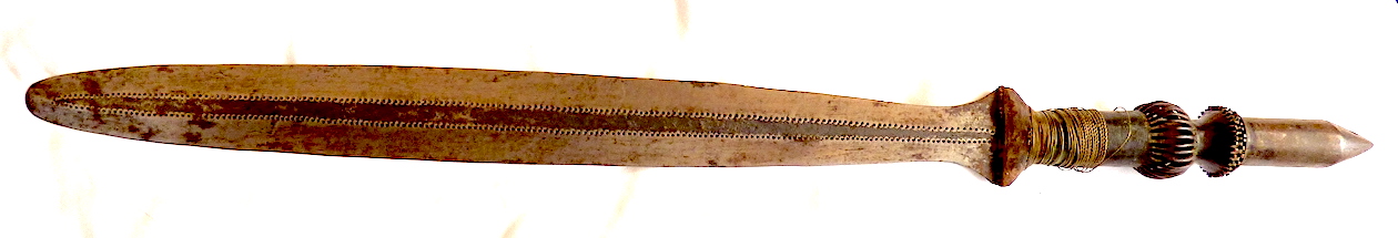

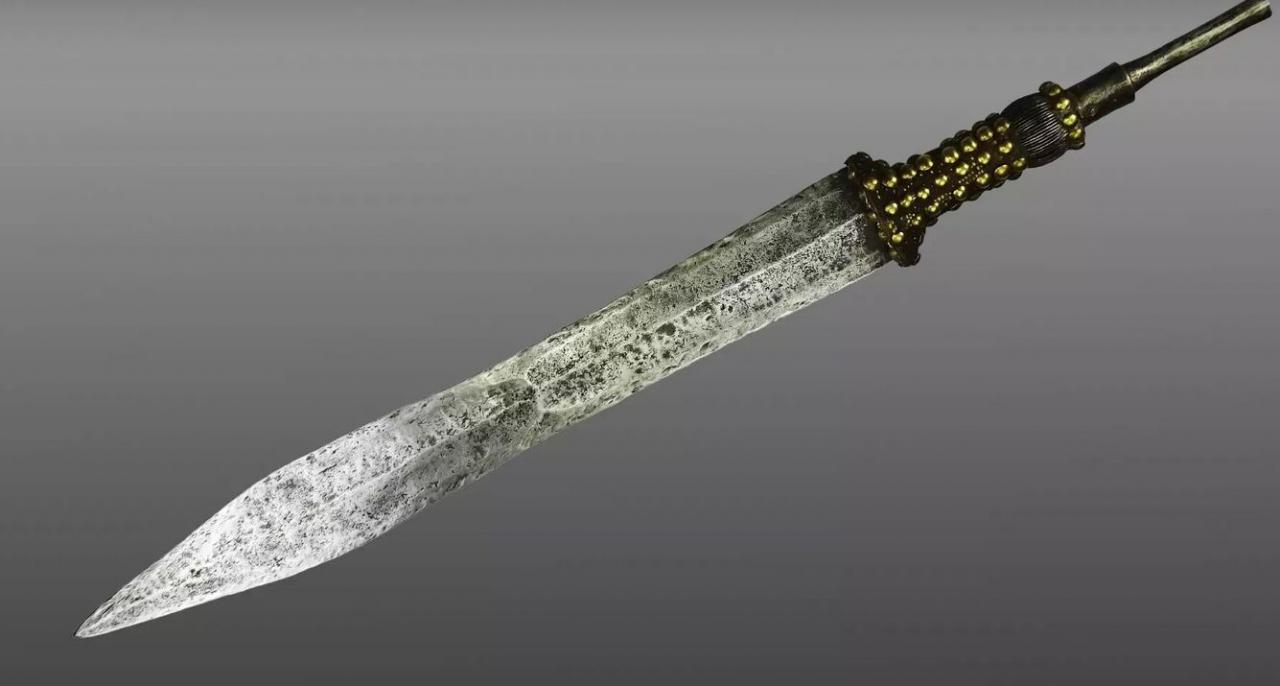

To muddy the waters a little more. This Kwango sword has many of the discussed features though the blade is more decorated and the Kwango area is the opposite side of Africa to Angola.

Yaka, Suku, Tshokwe, Lunda and Kaniok are possibilities. The end of the handle seems to be missing a piece.

And of course there's also the Yaka knife:
EDIT: Ah, Marc beat me to it.

Interesting. Museum fur Volkerkunde Africa-sammlung3 Waffen aus Zentral- Afrika.

With a little research you can find that the Lunda Empire stretched from Angola, Zambia and the Kwango river people in the DRC today. So all suggestions illustrate the extent of cultural influence. What a good place this is.

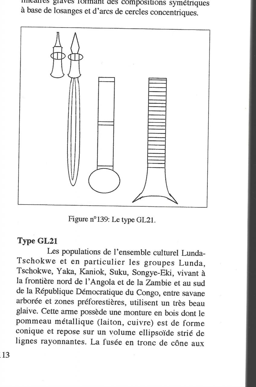

it is a little more than the Lunda empire....
Although I am not native French speaking, the French text expands into more peoples:
"the populations of the cultural connected Lunda-Chokwe and in particular the populations of the Lunda, Chokwe, Yaka, Kaniok, Suku, Songye-Eki living on the border of north Angola, Zambia and the south of the DR Congo between the wooded savannah and pre-forest region use a very beautiful sword,
This weapon has a wooden mount whicth a metal pommel (brass, copper) is conical shaped and rests on an ellipsoid piece streaked with radiating lines"
So it seems many forum members were correct !

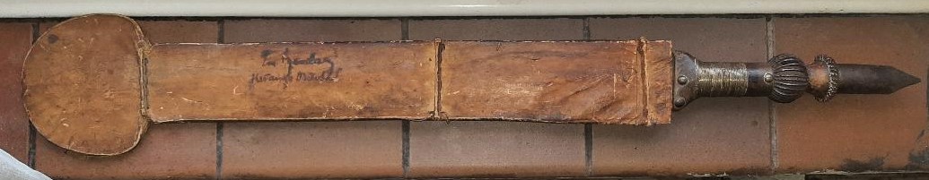

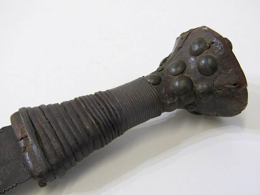

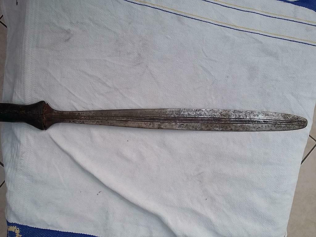

Old 16th February 2025, 12:41 AM   #16
Posts: 4,747
I have one that is very close to Tim's museum example. It appears to have some age. The leather is very thin and covers a light wooden sheath. The leather work was well done but has split in places with age.
The blade has a longitudinal groove down the middle on each side, flanked by multiple small linear marks. The metal (bronze?) hilt is constructed similar to other examples shown here. In hand, I estimate the age of this sword at about 100 years, so early 20th C or possibly late 19th C.
The weather was not very cooperative today for photographing today. If anyone needs better quality pics, please let me know.
This one came from a Swiss auction house in Basel. It was listed as a Yaka Ceremonial Sword and said to be called "mbeeli ya phoko."

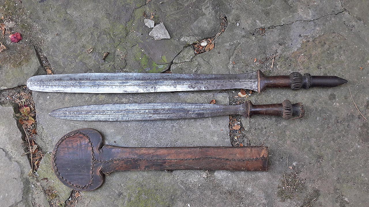

Mine is similar as well (seller's pics since it's too dark here to take pictures atm).

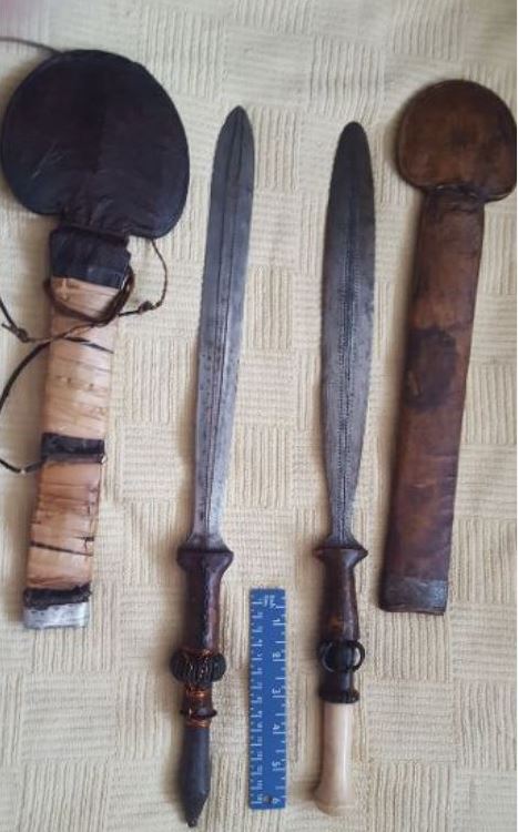

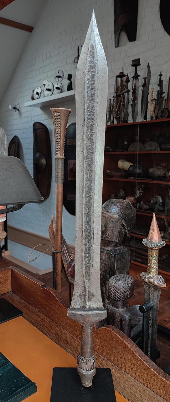

here are 2 nice Yakas from my collection, although the one on the right has found a new owner ( happy to transfer it to a fellow forum member where it fits better in his collection)

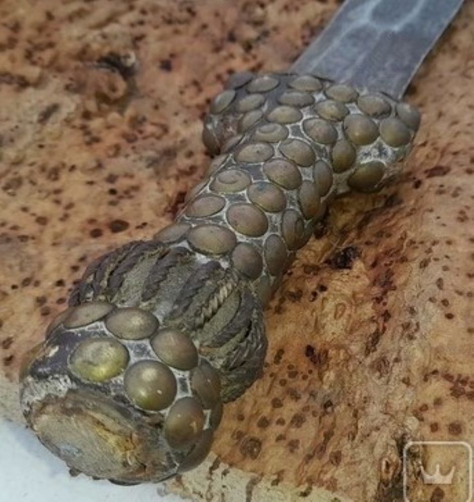

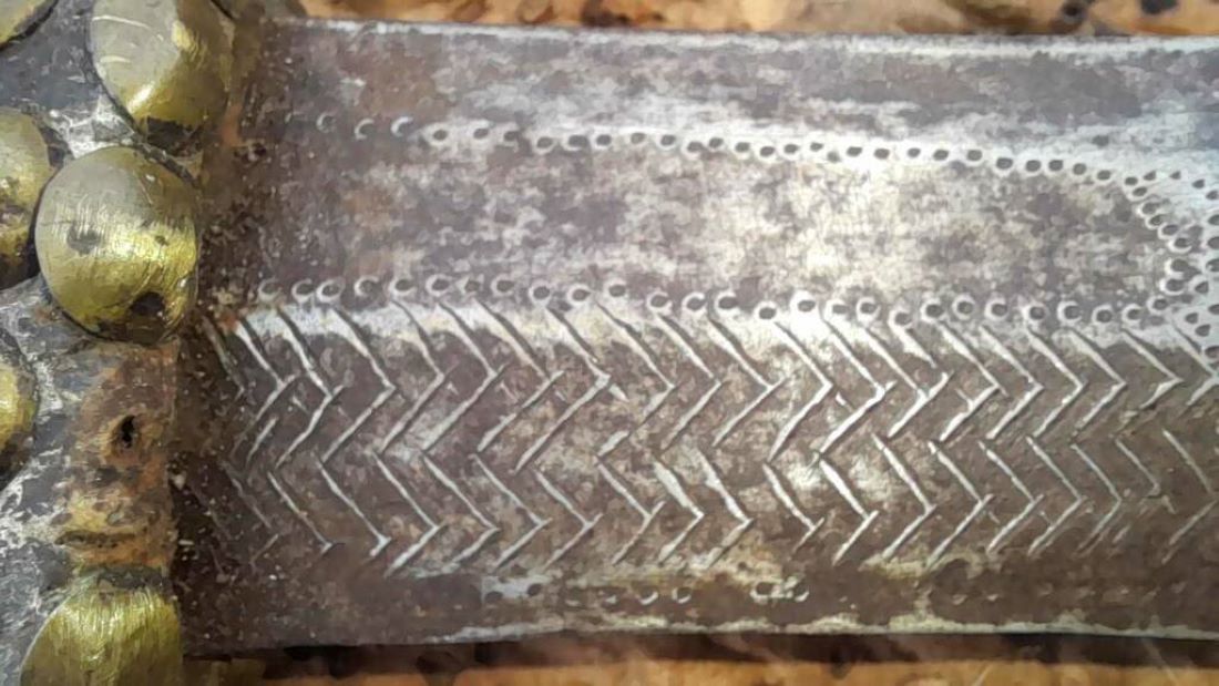

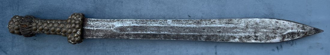

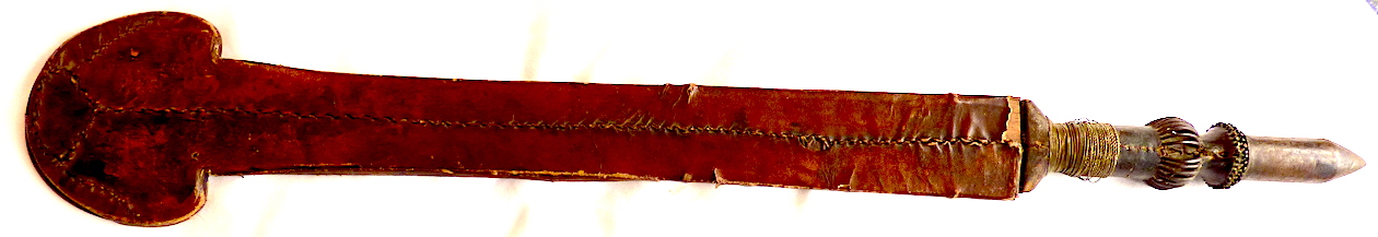

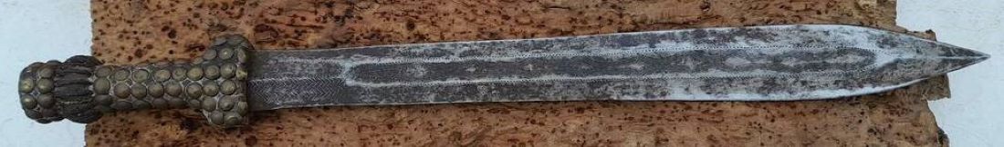

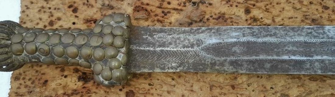

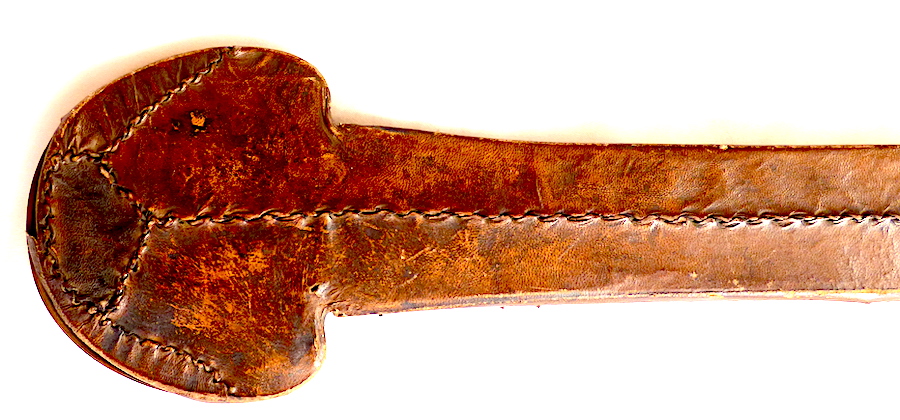

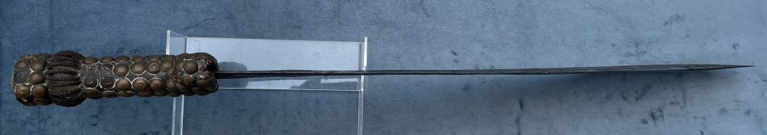

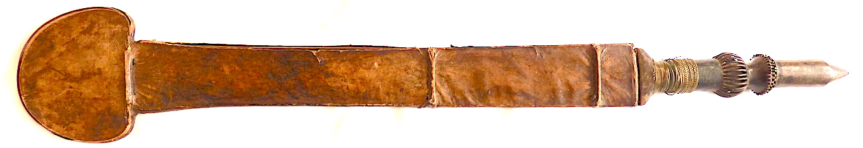

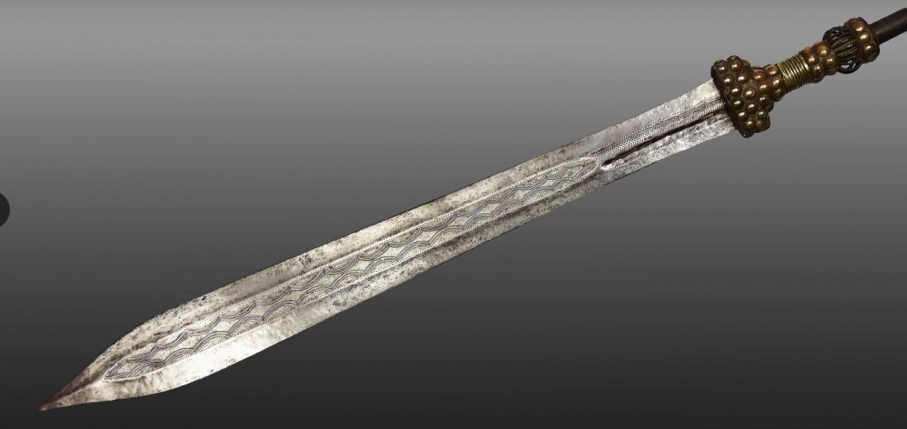

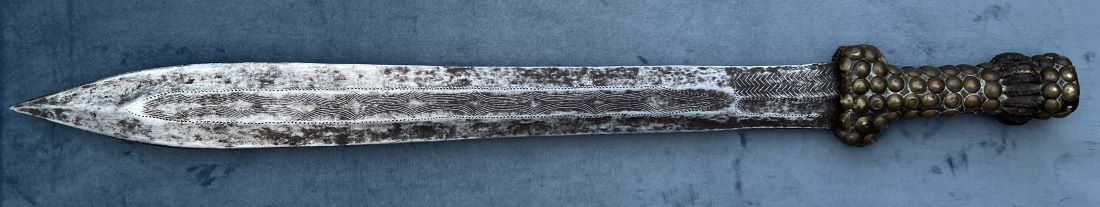

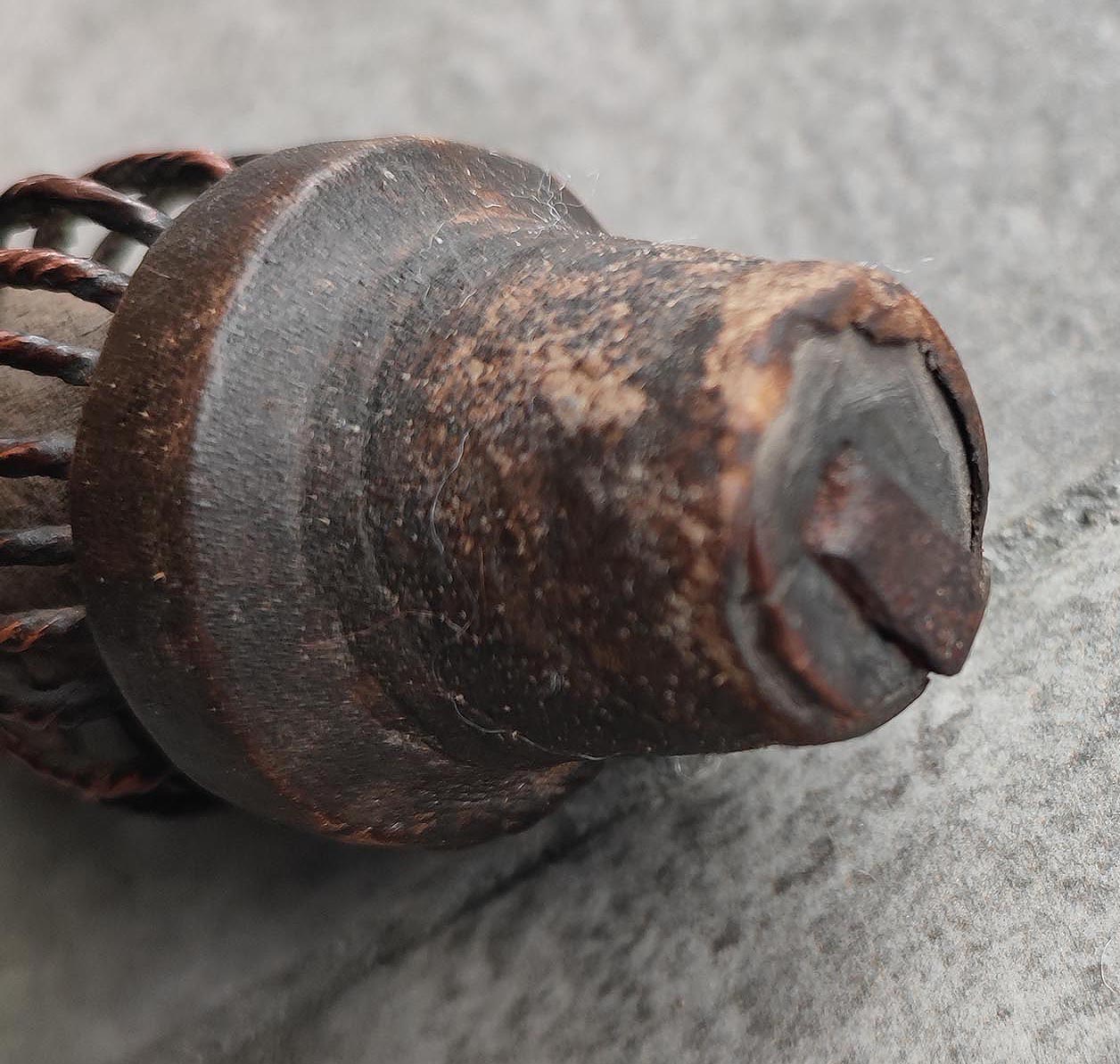

Got the sword.

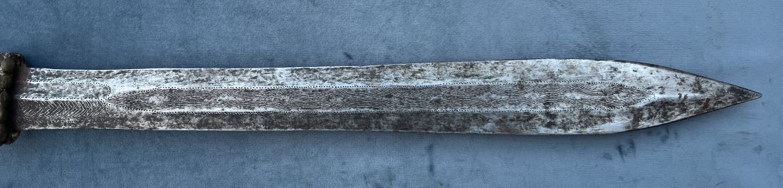

Well, what can I say – a real African gladius.
In general, the sword pleasantly surprised me with its quality of manufacture. If you don’t take into account swords with European blades, then, perhaps, such quality of forging is rare for Africa, except for Berber fleece.
A fully functional item, definitely not a souvenir.
Overall length – 580 mm, blade length – 455 mm, blade thickness – 6-7 mm, weight – 508 g
The wooden handle is covered with leather. Upon careful inspection, I came to the conclusion that the pommel could have been in the shape of a cone, but was broken off during use.
In the thread about Baule http://vikingsword.com/vb/showthread.php?t=8143, participants expressed the opinion that the handle has nails for upholstery from the 19th century, clearly of European manufacture. Looking at swords with similar decor on the handle, I thought that the items were made +/- at the same time and in the same region, by different tribes. Such nails are not found on later items.
As a version - at the end of the 19th - beginning of the 20th century, traders brought a batch of nails for upholstery to this region, and local blacksmiths began to use them in decorating swords.
What are the opinions?

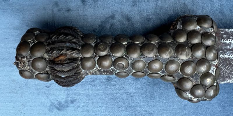

Nice sword Pertinax, and the patina on the hilt and blade do suggest some age. The presence of these upholstery nails does seem to indicate a late 19th/early 20th C foreign influence. Perhaps it was simpler (and cheaper) to use brass nails to embellish the hilts rather than some of the traditional cast brass/bronze elements. There appears to be residue from an old polishing compound between and around the nails, again an influence from outside the culture.

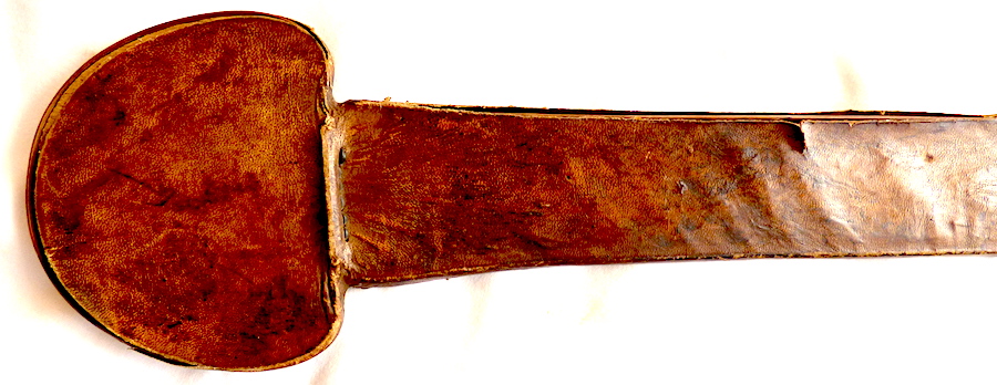

This is not an old polishing compound, this is leather. The handle is wooden, covered with leather.

I was referring to the white material that surrounds many of the nail heads. I realize that the base is leather, but the white material is not leather. Another possibility is mildew resulting from some moisture on the hilt.
This is mold on old leather.
Do you think, Ian, that we can determine the age of swords like this by the upholstery tacks?

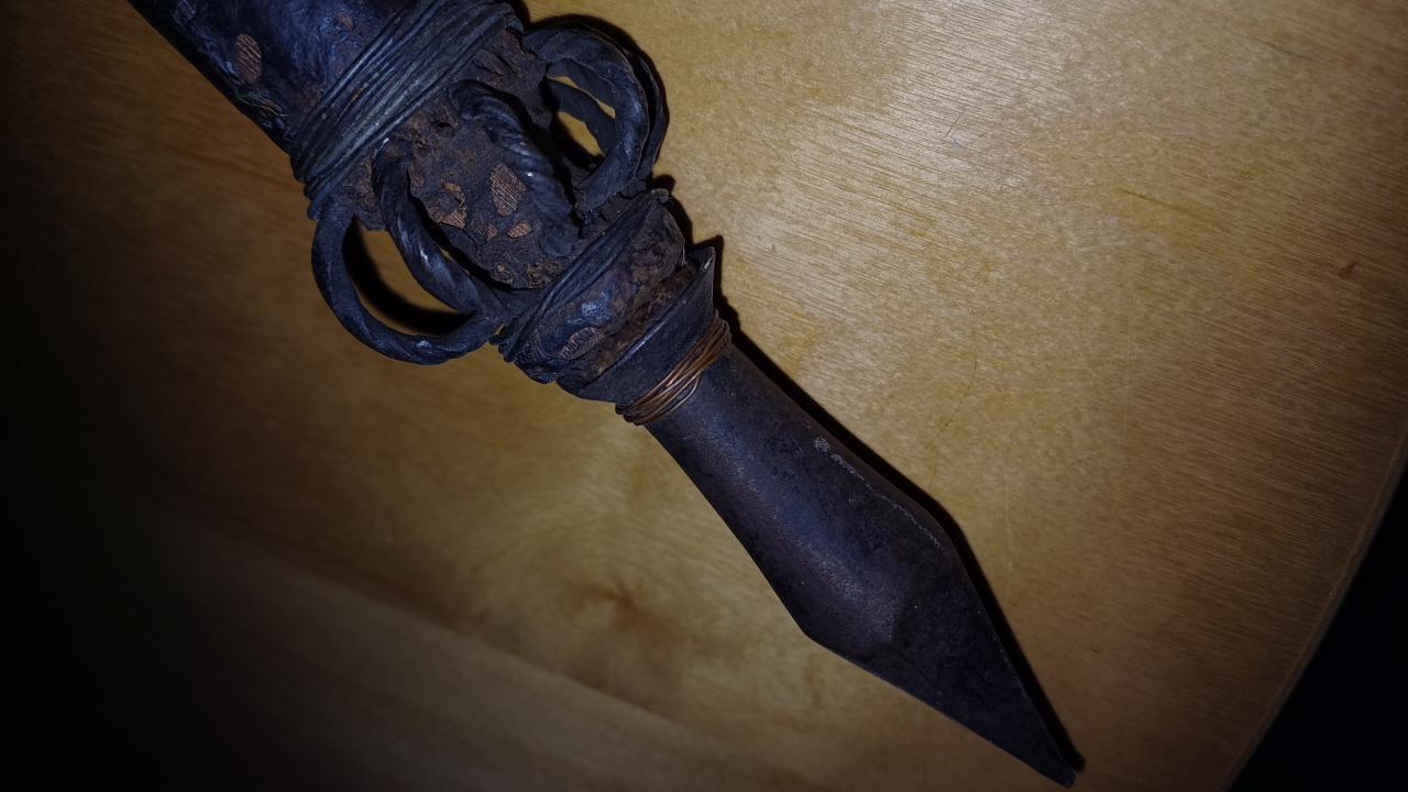

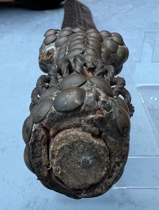

Hi, I'm late in seeing this thread.

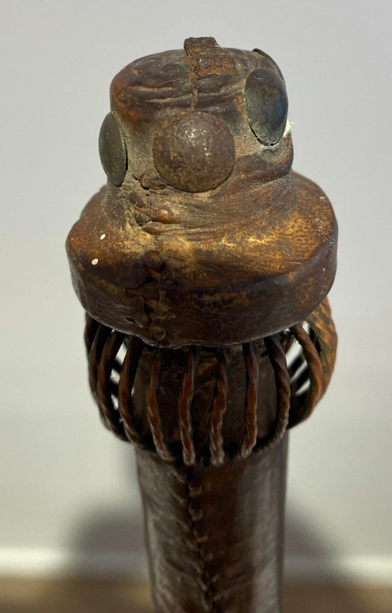

I have a sword that looks like the sister of the one in Pertinax's post, except for the end of the handle, which actually has a cone-shaped tip.
The cone is very small, however, and different from the one found on classic Yaka hilts.
This sword was sold to me as being made by the Chokwe people.
Duccio is offline   Reply With Quote
Old 28th March 2026, 07:37 PM   #28
Duccio
Duccio's Avatar
Join Date: May 2020
Location: Florence, Italy
Posts: 68
Probably also in the case of my sword the terminal cone is small because the larger metal cone has been lost.
Old 30th March 2026, 12:15 AM   #29
Pertinax
Pertinax's Avatar
Join Date: Dec 2023
Location: City by the Black Sea
Posts: 351
Hi Duccio!
The swords are very similar, apparently made by the same artisan. Yes, the metal cone is missing, but now the design is clear. Before, I couldn't figure out how the metal cone was attached to the hilt.
Thanks for posting.
Sincerely,
Yuri
Old 1st April 2026, 08:40 PM   #30
Pieje
Pieje's Avatar
Join Date: Mar 2012
Location: Belgium
Posts: 143
I didn't read the whole topic, but it's a very nice southern Congo sword (Angolan border). Imo late 19th C, but could be very early 20th C.
Attached one I had in my collection once.
Mostly these are attributed to the Tchokwe or Lunda (or Kaniok).
This type is much less common than the classic Yaka swords.
Pommel may be original, they do exist with and without cone.
I attached 2 classic Yaka swords with damaged pommel (don't have better pics). When an original cone is removed, it's ugly, not like the sword of the OP.
Pieje is offline   Reply With Quote
